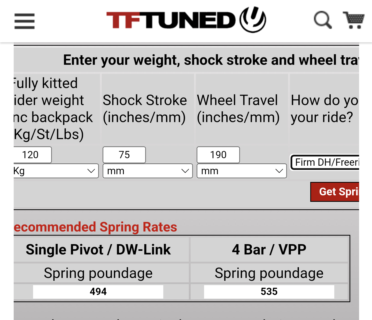

Any advice on coil sizing?
I’m 6’4” 245lbs kitted up and TFtuned calc is showing 475-500lbs for 4-bar. Does that sound right?
Should I be adding another ~20lbs for the added weight of the motor/battery etc.?
Probably going with a RS SDU as it looks like getting an EXT E-Storia built to 250x75 will be a science project. I guess I could just go with their Arma DH shock - doubt I’ll be using the climb switch on an ebike (?).
Lightme
Jul 17, 2020
167
153
Sydney
I find tftuned too light. This one seems one seems pretty spot on. Good shop too.

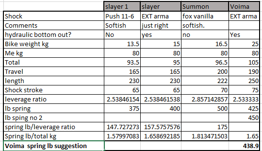

I'm speccing up a ext right now.....
My own calcs gets me to a 438lb. That's based on my 3 other bikes which have coil shocks.
The slayer with using the 1.65 spring lb to total kg ratio my spreadsheet spits out 438lb. I'll spec a 425 and a 450 spring.
The EXT spring calculator has me at 375/400
Cyclinic calculates 500lb
TF tuned suggests 357!
Suspension lab
Gets me to 422 depending on the riding style.
This calculator seems to be a bit better because you can option riding style as well.

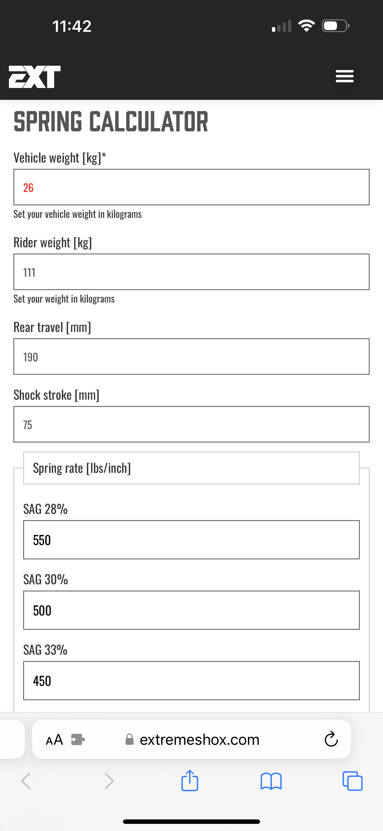

I’m 245lbs / 111kg
EXT calc (26kg vehicle weight) shows 625lb @ 30% sag
TF Tuned (+9kg for ebike) shows 525lb @28% sag
That’s 100lbs delta.
Can anybody confirm their weight + spring + verified sag? With those numbers I can back out what my spring should be.
Thanks!

I’m 245lbs / 111kg
Thanks!
Ext calc shows me 500 for your weight for 30% sag, you sure input is correct?
I started on voima at exact same weight as you with 600 spring. It’s a bit too stiff but still very nice.
Now I’m 105kg at 500 spring, it’s a bit too soft but I’m going to slim down more soon.
For your weight I’d aim for 525 +-25 depending on stiffness/sag you prefer.
Blownoutrides
Mar 22, 2021
239
173
Oh geezus I had swapped travel and weight. Metric system got me all twisted up lol.
You’re spot on - thank you
