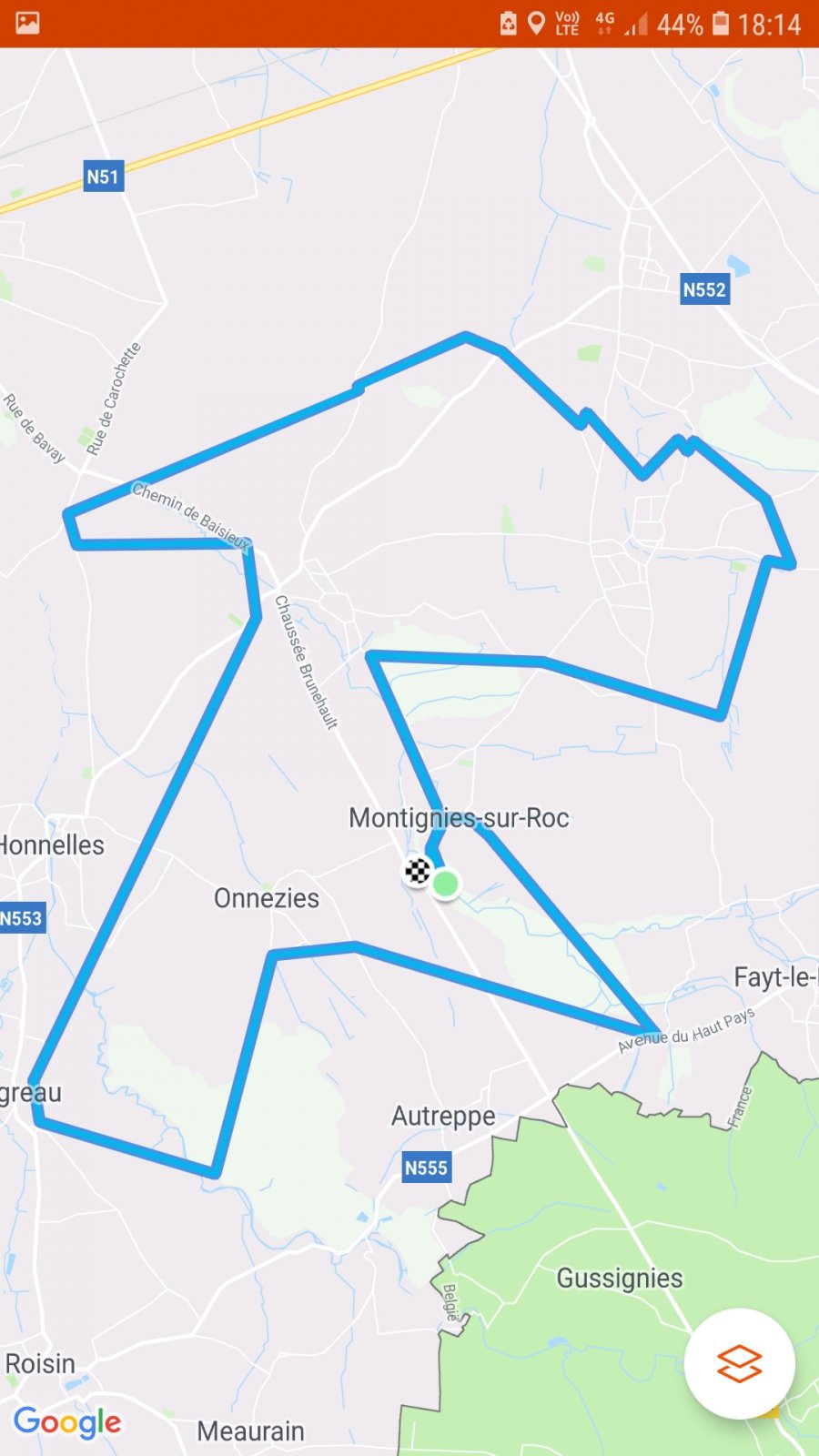

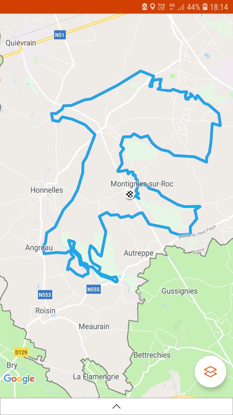

KrisFl
Mar 4, 2019
17
8
Leefdaal
Android.
Phone was in a front pocket, so I can hear the voice info.
So second ride this weekend to get the correct tracking from Blevo. All of my battery saving feature in the Samsung turned off. When looking at the track at end if ride, it seems Blevo picks up only certain points. See below first result from Blevo, second from navigation device.
I have no clue what to do....

Simon
Maastricht
Oct 3, 2018
646
655
M
View attachment 12526 View attachment 12527
Can you please try the settings metioned in the post below? They might resolve your issue...
The Official BLEvo Thread - EMTB Forums
Also please close all other apps and run BLEvo only. Everything should work fine.
PaoloBLEvo
Trader
Jun 13, 2018
1,457
1,191
Varese
Very Strange... Could you sent to me the CSV file to [email protected] ?
Thanks.
