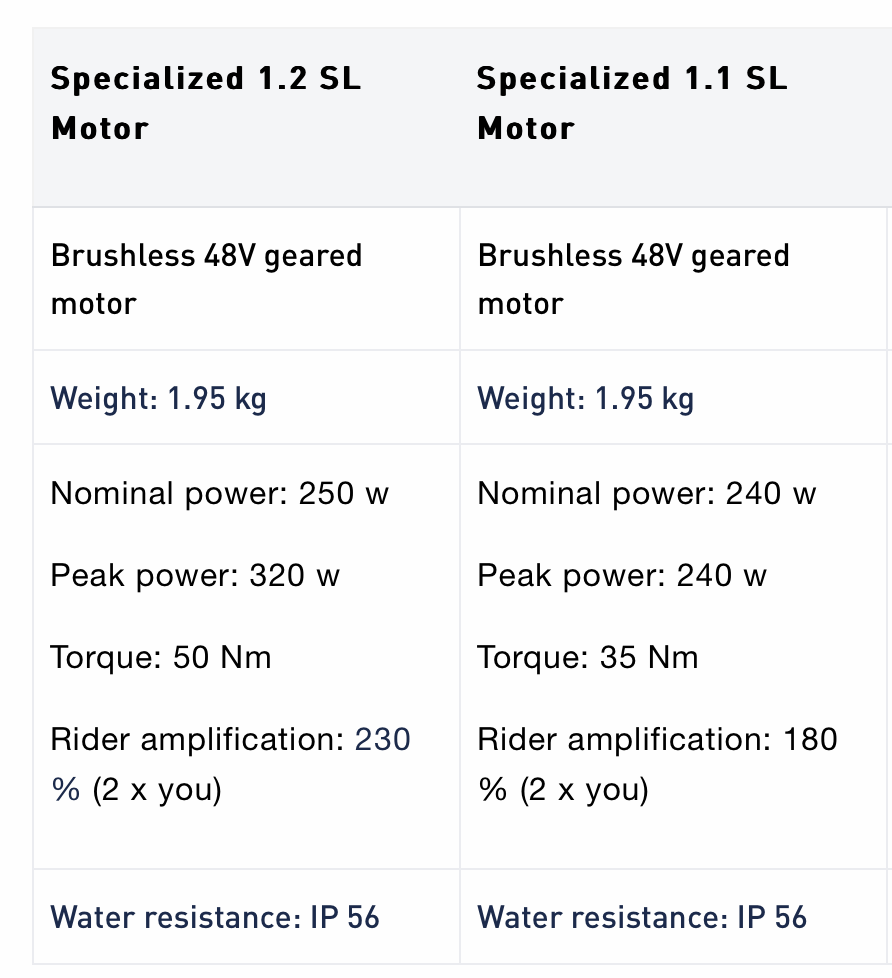

Here's what Specialized say:
QUOTE:
So they are claiming the 1.2 motor is outputting what has been found in the data; peaks of 320w, but still, 250w of nominal power, which I think is what @Fit_Fat_almost_50 is seeing in his data?
They claim the 1.1 puts out 240w nominal and 240w peak
Source:
Yes, but no … ;)
In the German lab test peak power has been measured over different cadences and they did pick up the highest power output which is 278 watts and not 320.
Even though this is one of the most controlled test environment we have so far to asses real SL1.2 power output, it doesn’t mean that every bike/motor will peak at “only” 278 watts in any given scenario/conditions.
What this test tells though, is that the 320 watts marketed by Spe is a very best case scenario, and clearly not the norm.
I was surprised seeing the guys at Loam Wolf saying that the SL2 was less powerful than Trek EXE going up technical climbs. Now I see where it might comes from.
Numbers are just numbers, especially when Marketing can announce what they feel is right without any compliance regulations in place.

The reason the data is important is that what you feel has many inputs. In the case of a motor there are two main drivers to what @knut7, @Doomanic and @p3eps are experiencing being Torque NM and Power W.
My tests have shown a noticeable increase in Torque (proven at lower speeds) and the German Lab verified this.
Torque and power are both fundamental concepts in the field of mechanics, particularly when it comes motors.
  1. Torque in eBikes:
    • In eBikes, torque is the force that the electric motor generates to turn the wheels. It's essentially the twisting force that propels the bike forward. Higher torque in an eBike means more force at the pedal or wheel, making it easier to start pedaling, climb hills, or carry loads.
    • Torque is crucial for eBikes because it directly impacts the bike's ability to accelerate and climb. For example, an eBike with higher torque will be more capable in hilly terrain or when starting from a standstill, especially with a heavy load.
  2. Power in eBikes:
    • Power, measured in watts (W), represents the rate at which the eBike's motor can use energy. It's a function of both the torque the motor produces and the speed at which it operates. Higher power means the bike can reach and maintain higher speeds more effectively
In summary, for an eBike:
  • Torque is more about the immediate pulling power - essential for quick starts, hill climbing, and carrying loads.
  • Power reflects the eBike’s overall performance, affecting top speed and how efficiently it maintains speeds, especially under varying conditions like we experience mountain biking.

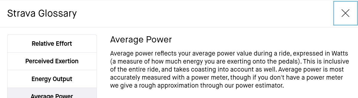

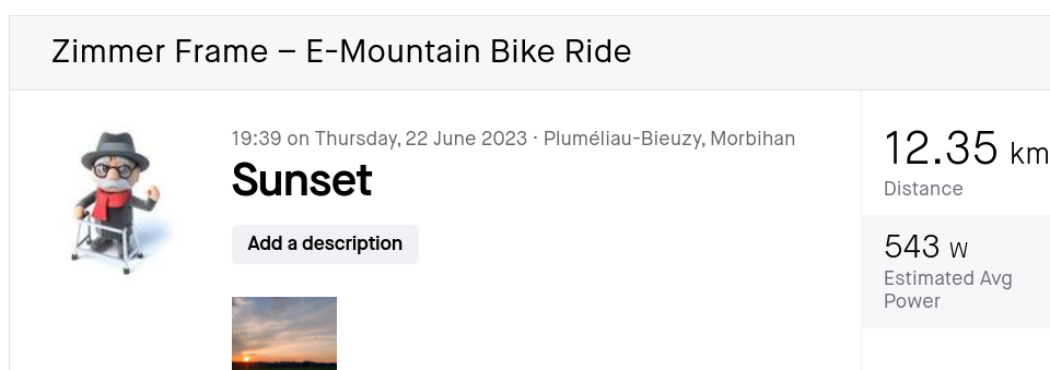

For anyone not using Strava :
This really can vary hugely depending on the terrain and how you ride, ease off here and there for a few moments and the average plumets.
Interestingly it should be noted that this is "ESTIMATED". So leaping up and down and throwing all of your toys out of the pram because other peoples experiences and Data they've recorded from TCU's doesn't fit with your scientific "ESTIMATION" seems a little ludicrous.
