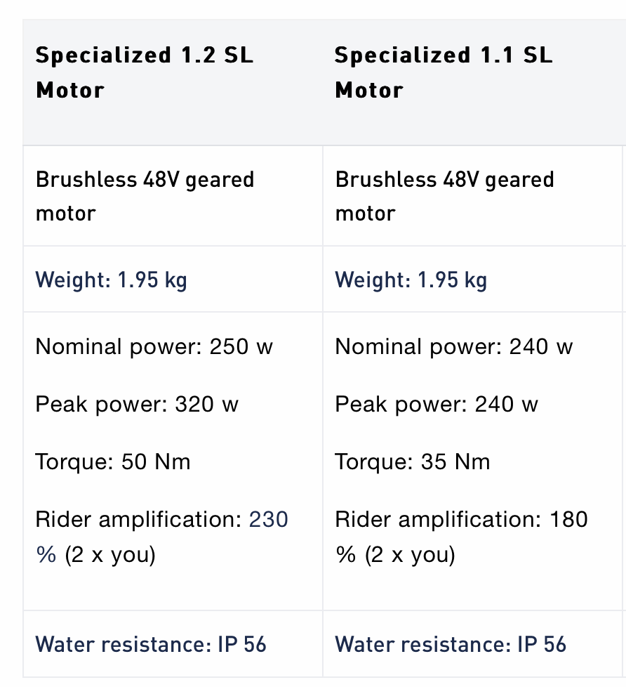

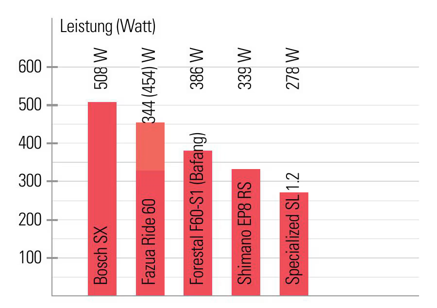

I have investigated what could be the real (peak) power output (watts) of the new SL1.2.
Aside your personal analysis, it is difficult to find some good evaluations (with scientifically measured data).
There is well @EMTBReview channel on YouTube who's trying to bring some more tangible comparisons between lightweights motors (including SL1.1 and 1.2), and those are definitively using less hazardous testing protocols compared to other well known websites/magazines. But at the end I can still feel kind of a biased for Spe... ;)
I finally found the "scientific" information I was looking for, visiting this website:
The tests are performed in lab (less variables at stake), and protocols look legit. Data are corroborating yours (to some extend). Indeed SL1.2 delivers 278 watts of peak power (instead of the 320 advertised), which is in line with your 40 watts power increase (vs 1.1) you assumed.
Note: The site is in German (Edge, Chrome extension might be helpful for page translation)
My 1.1 can sometimes push out up to 310w (peak). 🤐
Thank you for sharing this information; it's certainly reassuring to receive confirmation. I ceased my evaluations upon recognising the marginal uplift compared to the proclaimed figures.

Here's what Specialized say:
QUOTE:
You can measure the power of a motor in the maximum watts it can produce. A motor that produces more watts will make it easier for you to maintain a certain speed while riding. All Specialized motors offer optimal support over a broad range of pedaling cadences – even beyond 100 rpm. This helps provide a more natural feel.
  • The original SL motor provides 240w of nominal/peak output and 35 Nm of torque
  • The SL 1.2 motor provides 250w nominal power with 320w of peak output and 50 Nm of torque
This is equivalent to about 180% of rider power or 2 x you.
So they are claiming the 1.2 motor is outputting what has been found in the data; peaks of 320w, but still, 250w of nominal power, which I think is what @Fit_Fat_almost_50 is seeing in his data?
They claim the 1.1 puts out 240w nominal and 240w peak
Source:
Source:
Yet the tests dont support this. @Rob Rides EMTB we are all very aware of the claims. How about you give us a view on the discussion and data here?
Are you suggesting in your tests you've not seen peaks of 320Wh? From what I can make out from your posts, on the 14th august with the 1.2 motor you achieved 253w of power over 4m53 of riding. Which would be in line with what they claim:

From the graph you posted from that magazine, do we know the duration of the test?
