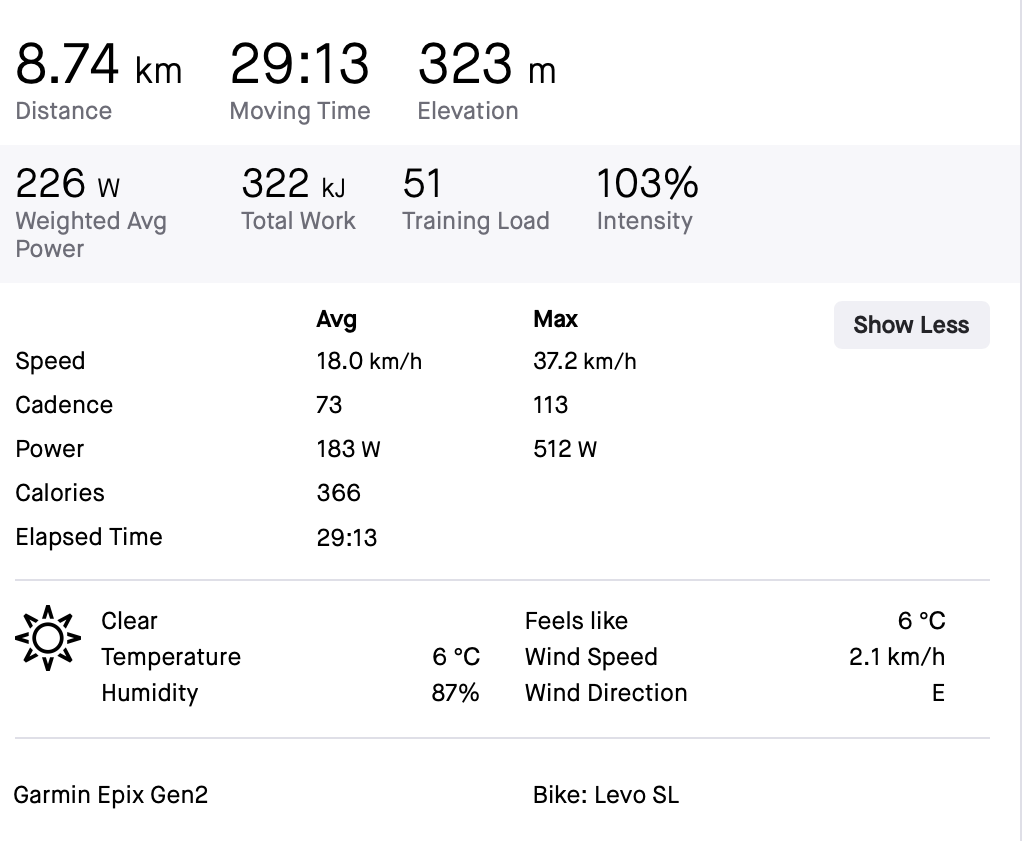

This is the data from my ride 18 April 2023 with the SL 1.1 motor:
To normalise the data from the Strava segment, which I use to gauge my fitness, I rode 29:24 on this day.

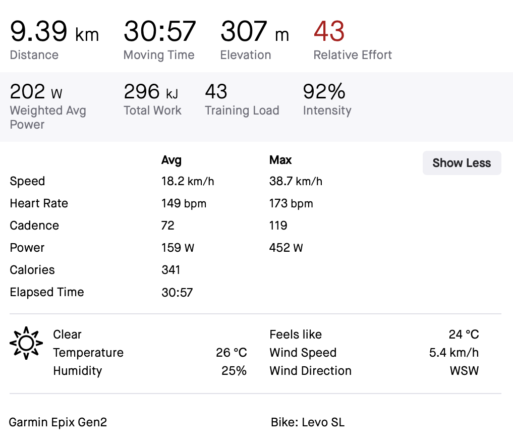

Here is the data from today, 14th August 2023:
As you can see, I'm fitter and produced 20 watts more average power resulting in a time for the same segment 27.51, which is about right with me producing 10% more power.

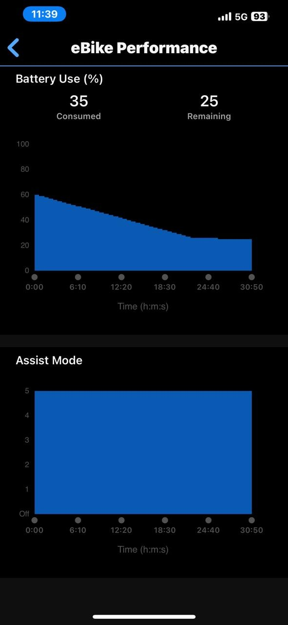

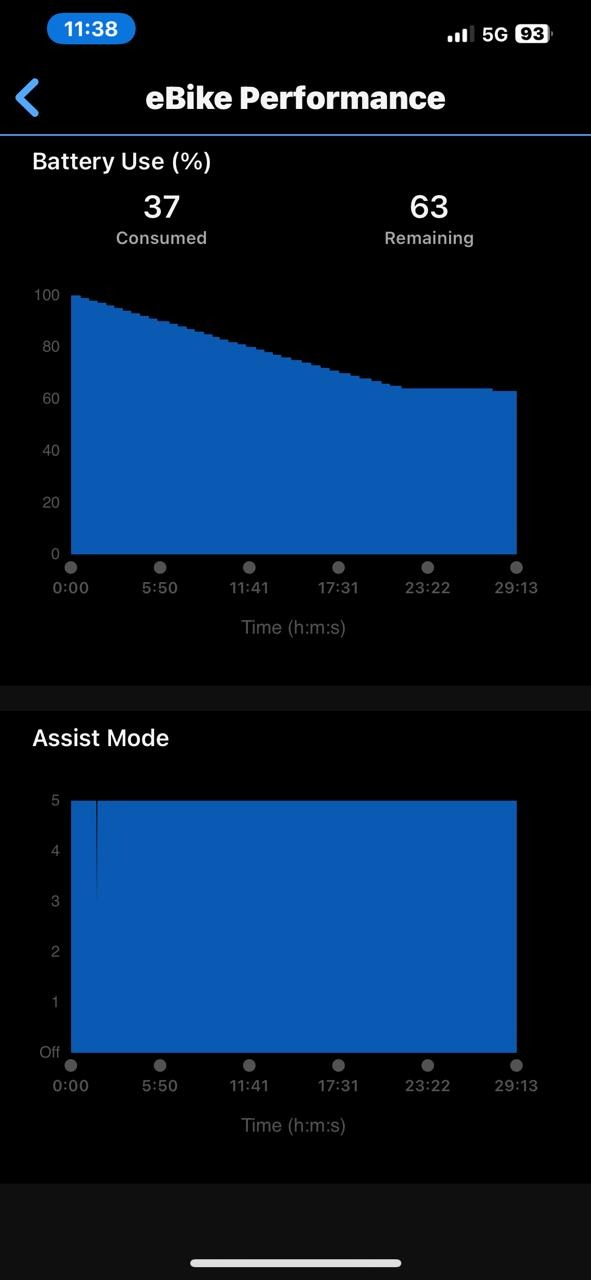

I then dug further into the data and found that my Garmin records battery consumption:
Here is the data from 18 April:
And here is the data from today, the 14th of August:
What am I missing, has Specialized completely misled us with the 1.2 motors?
How can a motor that produces 80 more watts only use 2% more battery?
Based on me riding a trail that I know exceptionally well, I would expect to see a 20%-30% increase; why am I not?

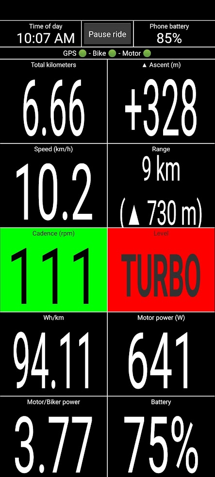

I was out on Saturday on my LSL 1.2, riding in my Trail mode - which is currently 15/45, and I covered 27.5 miles and just over 3000ft in 2hrs 55mins. I had my RE plugged in, but I finished the ride with 92% - so I only used 58%.
It's not often I get the chance to go out 2 days in a row... but there was a green light from my wife - and despite my legs feeling ruined, I grabbed the opportunity.
I went to a place with a fire road up the middle, and a few singletrack runs off of this. I used my Turbo 100/100 to get up, and then used my Eco to come down. I thought using it as a shuttle would give my legs a bit of a rest.
18.35 miles / 3850ft over the course of about 2 and a half hours.
I had my RE on drain first, and once I got to just over 110%, I swapped my RE for my second one (the car was at the bottom of one of the runs). Once it was at about 115%, I removed the RE completely. I finished the day with 38% on the internal battery. When the RE is using the last 5-10%, it seems to put the bike in a slow mode - which is why I bailed at 110-115%.
I generally don't use Mission Control for anything other than setting the assist levels since I use a Garmin 840... but yesterday I was continually checking / recording the voltages / current used after the experiments last week.
When in Turbo and climbing, I had a fairly steady 7.6 - 8A, and saw peaks of 8.80A.
Like mentioned in the other thread, I'm positive I wasn't getting full power out of my SL1.2 motor for my first couple of rides, and as time has gone on it has increased. I can now climb 2 specific steep rocky technical climbs that I'd never managed on my SL1.1... and I can assure you that's not down to my fitness or technique improving 😂

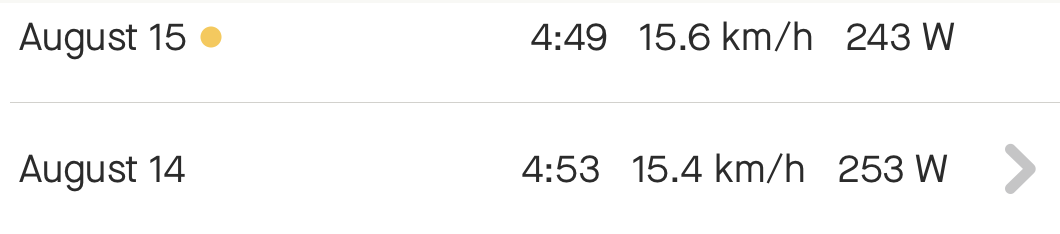

From the piece of this jigsaw puzzle known as the "big climb", my performance today was a sizzling 243W with a time of 4:49. In comparison, yesterday, with my raw unbridled power, I churned out 253W, at 4:53. It felt like my bike and I had a heart-to-heart: I gave a bit less, but the bike, in a dramatic soap-opera twist, decided to give more in the tight turns.

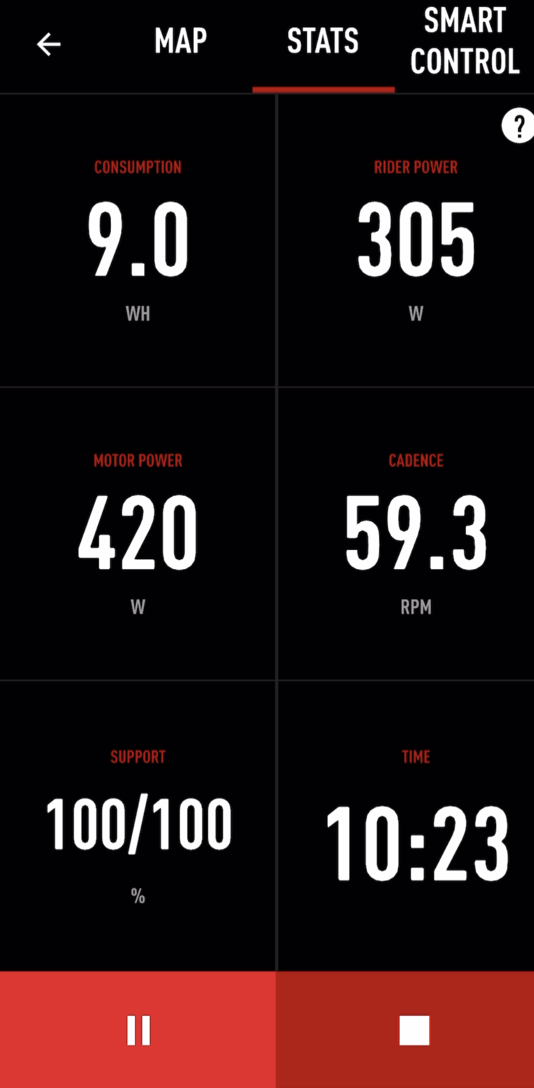

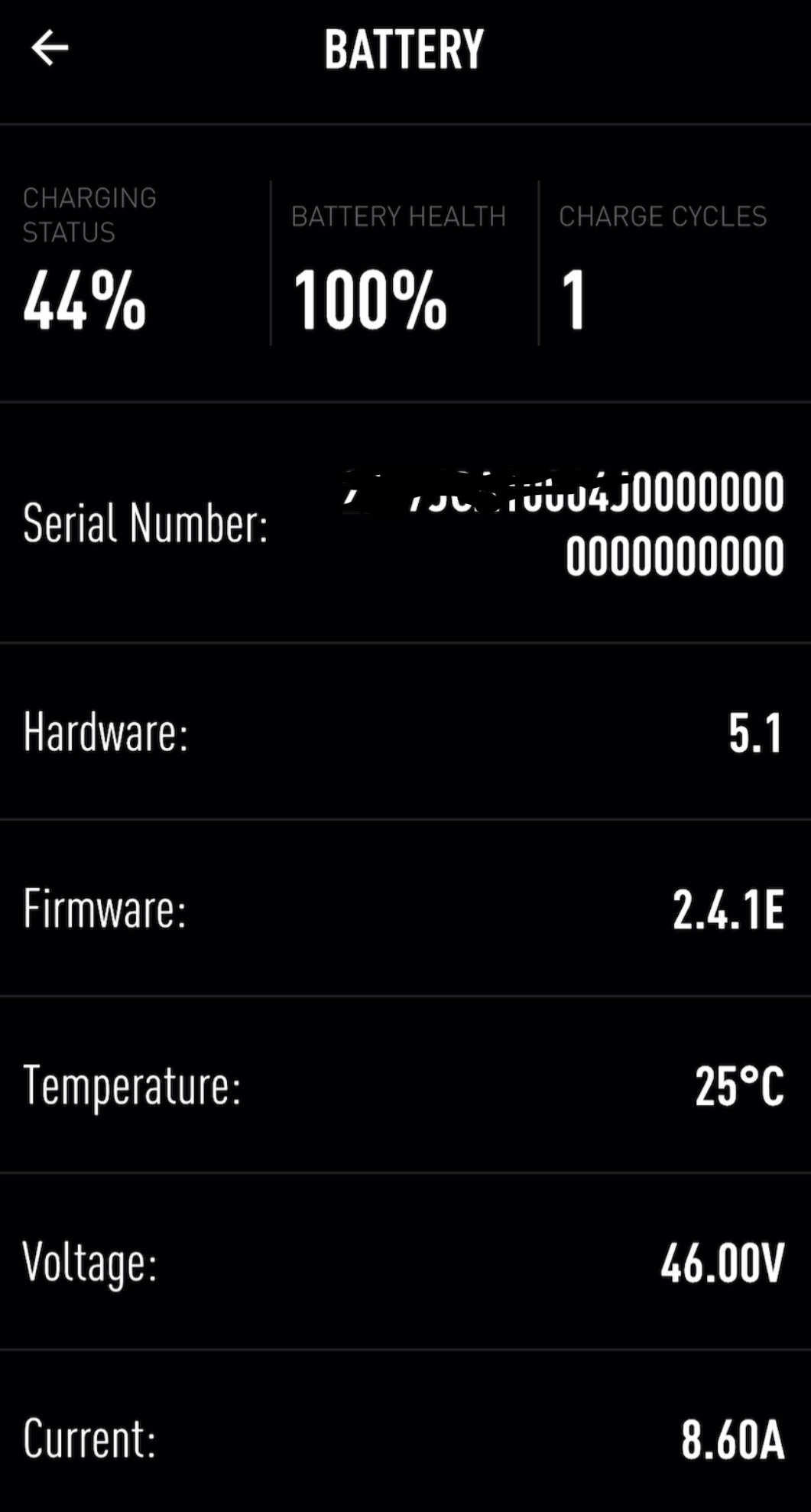

Hey @CjP, here is the battery data:
And my 2 cents (which, let's face it, probably resonates with millions, give or take a few):
  1. The Motor? Same old dude with a new hat. They've jazzed it up mostly to serenade us less.
  2. Specialized peered into its crystal ball (or warranty data), took a leap of faith, and added a bit more zing to the power.
  3. That zing? Somewhere between 10W and 40W.

Seems down on voltage compared to others with similar amps. Which would explain your lack lustre reaction.
A 50% torque increase and 30% power increase would be immediately noticeable.
Somethings not right with these Gen 2s and they need to sort it out asap. A real let down for an otherwise great product!

Do you have any of the data from your old motor?
According to your screenshot, you're getting 46V x 8.60A = 394.6W from the motor.
With Specialized's claimed 80% efficiency, that's 316.5W from the motor... which is not far off the claimed 320W from the 1.2 motor... and almost 80W higher than the 1.1 motor.
I believe this underscores my point regarding "Apple-type" marketing strategies. While there might be select cases—when one cherry-picks the data—that support this view, it doesn't hold consistently. My expectation was that this would be evident across the power curve. However, I can assure you, backed by data, that this is not the case.
From my analysis, at low speeds and a specific cadence, the motor might produce 80W, but this occurs less than 5% of the time. This means for 90% of its operation, the motor's performance is only marginally better.
I really want this not to be the case and iv tried hard to prove otherwise. However, the data simply does not add up.
I used to ride my SL1.1 predominantly in 30/80. When I tried my SL1.2 bike on this setting, the power seemed massively more. It felt more like what 60/80 would feel like on the 1.1.
Over my first few rides, I kept dialling the SL1.2 back - trying to find what the equivalent (feeling) setting was... and I've settled on 15/45. 15/45 'feels' about the same level of assistance as 30/80 did on the 1.1, and also uses slightly less battery.
To me, my SL1.2 has much more power all across the range than my 1.1 ever did. I've said before that the first few rides on Turbo 100/100 didn't feel much different from my 1.1 to 1.2... but now there's a significant difference.

Why dont you simply add the motor wattage on to the TCU screen and just look at it in real time?
My 1.1 maxes out at about 305W

People are confusing power drawn from the battery and power produced by the motor. As @p3eps says, the motor is approximately 80% efficient so to produce 320w it needs to draw 400w.
The numbers you see are the battery draw numbers, not the motor power output.
Roughly, this would be 50 volts * 8 amps = 400w.
The Mahle motor has voltage compensation, so as you can see in @Fit_Fat_almost_50's example with his voltage low (46v) because the battery is discharged to 44% , the system then allows a higher current draw (amps) to "compensate" so you get the same power through the voltage range. Otherwise he'd have 8*46 = 368w draw and the motor would feel less powerful as the battery depletes.
There are potentially two issues with the 1.2 power.
The primary problem, for some reason, certain motors only draw 6 amps at full charge (300w battery/240 motor). This can be seen on the display when you ride the bike. The LSL2 was delayed considerably, so it might be that some bikes only had the provisional/1.1 firmware installed on them and were missed when the correct 320w (motor) firmware was deployed. Or there's some other issue like certain TCU's not supporting the power levels correctly/certain batteries have physical limits on or incorrect firmware.
The second problem is considerably harder to prove, which is for examples like @Fit_Fat_almost_50's. The numbers would appear to show that in theory his motor is performing as you'd expect. But his "external" power figures show it as not providing any more power. In this case it looks like the system is saying ok, have 8 amps and it's displaying that, but for some reason the motor's only actually drawing 6 amps. Which could be a faulty motor or battery.

From my tests and observations over the past few days, I've derived some key insights about the performance dynamics of my bike, particularly in relation to its battery and power management:
  1. Performance Comparisons: When I contrasted the bike's operation on the 14th of August (with the old battery) against the 15th of August (with the new battery), there was a discernible change. This shift was even more pronounced when I compared the 15th to the 18th of August, during which I incorporated the Range Extender.
  2. Battery Limitations: I've researched standard specifications for 18650 battery cells, which I assume are being used in the SL's battery. The 1C discharge rating indicates a maximum continuous output equivalent to the battery's capacity. In the case of the SL, with its 320Wh battery, this translates to an output limitation of around 320W. However, it's worth noting that this doesn't mean the entire 320W is available solely for driving the motor; other system functions or reserves might be consuming a portion.
  3. Burst Capabilities: While there's a continuous power limit, batteries often have a burst capability that allows them to momentarily provide power beyond the continuous limit. The specifics of this burst capability, I found, vary depending on the battery manufacturer.
  4. The Role of BMS: Drawing from my data and understanding of battery management systems (BMS), I suspect that the BMS in place might be actively limiting the current to ensure battery longevity and safety. This means the real-world performance of the bike could be curtailed by the BMS rather than the actual motor power.
Now, a question lingers for me: What are the exact settings or limitations Specialized has programmed into the BMS? This information is crucial, as it could provide deeper insights into the performance constraints I've observed. While I understand that manufacturers might keep such details proprietary, having this knowledge would offer a more comprehensive understanding of my bike's behaviour.
In essence, my data and research emphasize that an e-bike's performance isn't just about its motor or battery capacity in isolation; it's a holistic system where each component, including the BMS, plays a significant role.
More data will give me more insight so once the levociraptor arrives we can go deeper into this rabbit hole.
