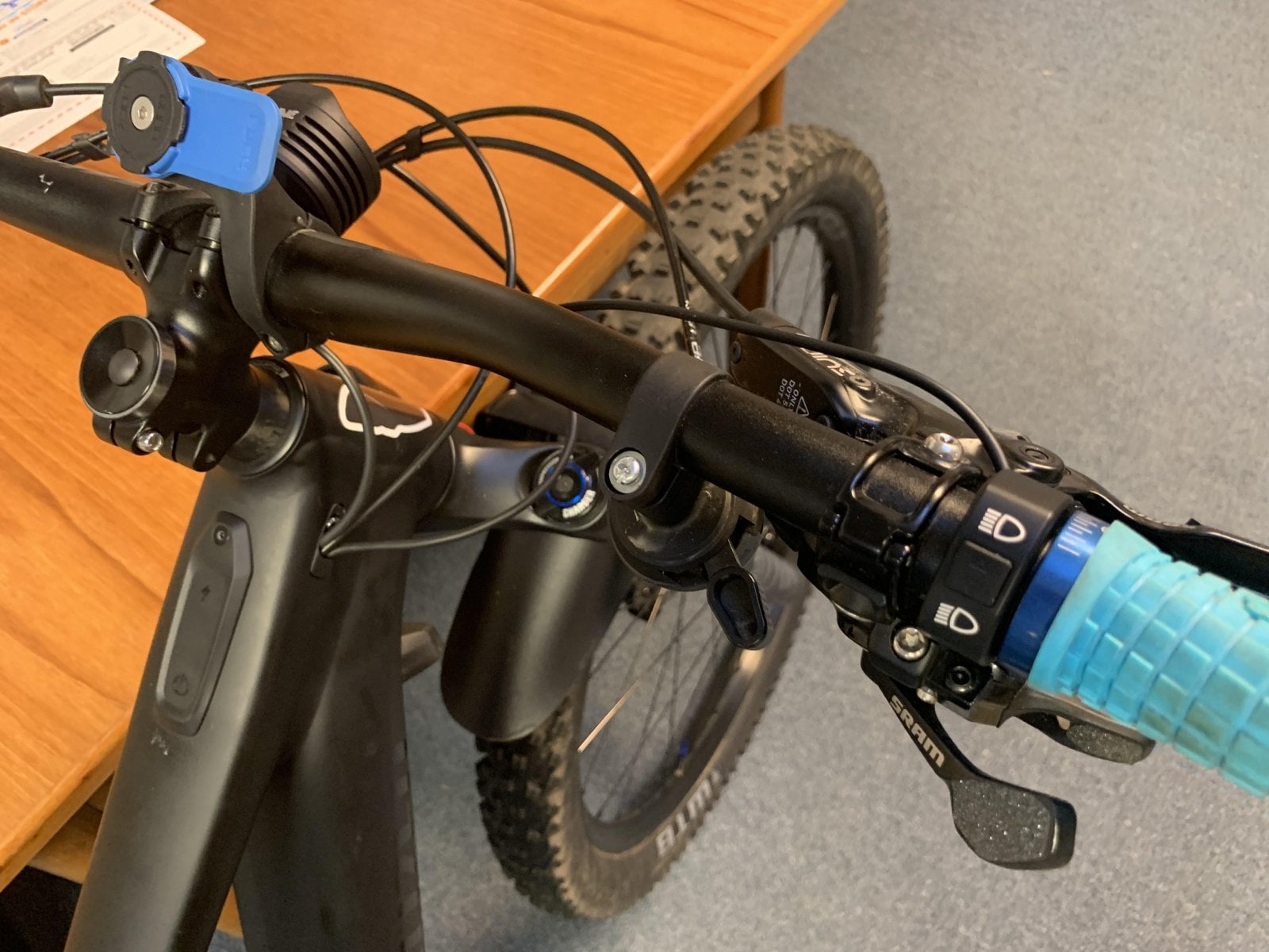

Nice. Did you use DC to DC converter to lower the voltage near 8.4 Volts? Or just connected the wires and running with 12 Volts?

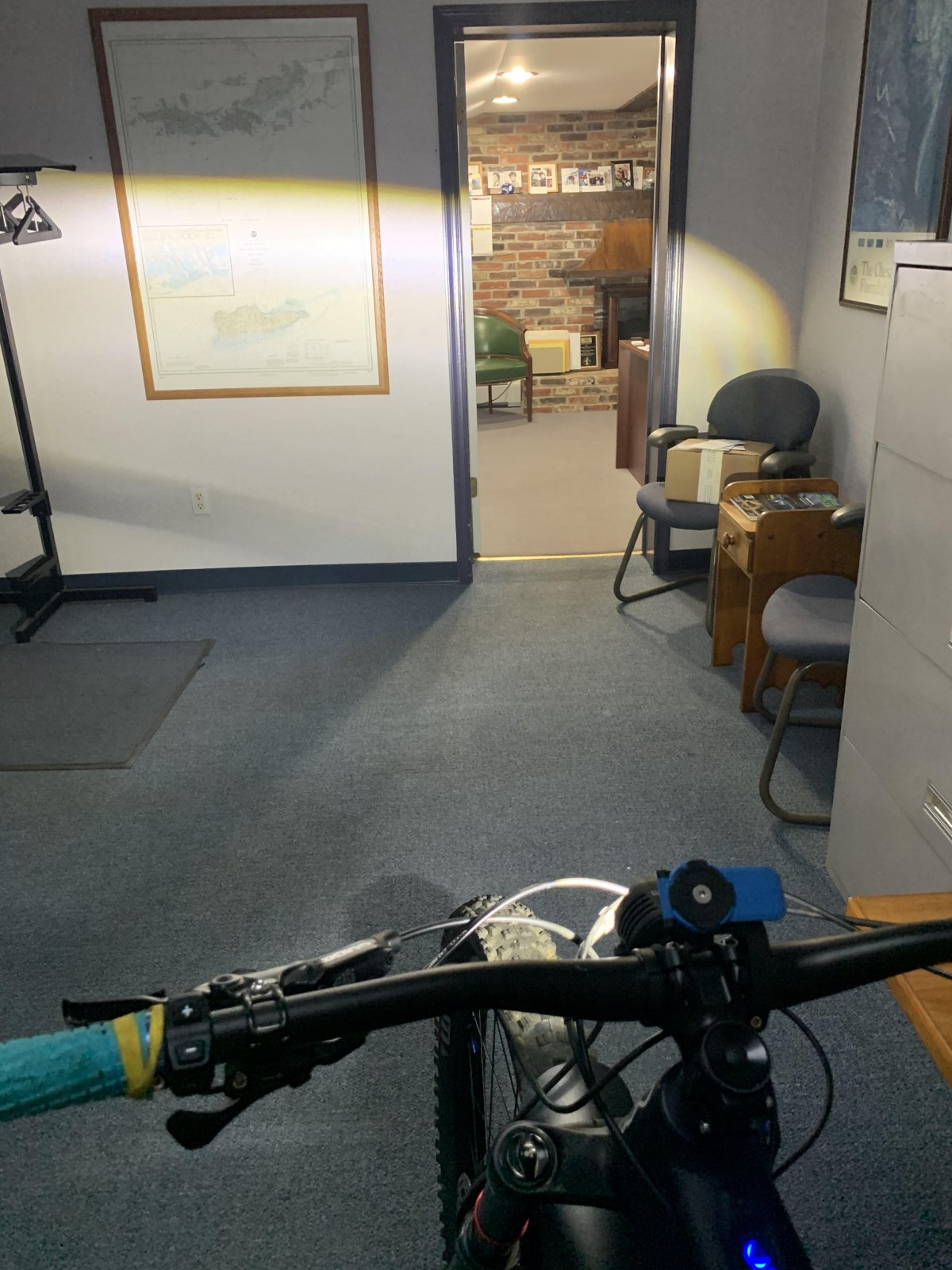

I just tested it with one of the light heads with three LEDs connected at the same time and both worked at once. So I ordered a second dual-LED one and will try both of those at once.
So it will probably be, I am guessing, 1400 lumens. I can point one closer to the front wheel than the other one.
Still for some reason it cannot drive my Duo 1500 or MagicShine.
But yeah, I agree that it is hard to tell lumens. Especially given wide vs narrow beam patterns.
Tomorrow I will make up a custom cable to measure current draw and find out what it is pulling.

Today I tried the light called: "Bright Eyes Fully Waterproof 1600 Lumen Rechargeable Mountain, Road Bike Headlight, 6400mAh Battery (Now 5+ Hours on Bright Beam). Comes w/Free Diffuser Lens and Free TAILLIGHT"
It was slightly less bright than the light I selected, so not worth the additional money. Also, it stopped working, so I don't think it has internal voltage conversion.
rsilvers
Dec 2, 2018
283
244
US
I tried *two* of these units at the same time using a Y-adaptor. It worked! Power draw was 1.95 amps at 11.5v, which is 22.4 watts. Fantastic! For some reason, these heads stay within safe limits without a startup surge that is making other light heads go over the limit.
rsilvers
Dec 2, 2018
283
244
US
Yes, you can see the large power switch on the back of each light, as well as the three brightness settings. The enclosures are aluminum with heat sinks. If you are concerned you could open them and make sure there is thermal paste, but having two means if one dies, you have a backup.
I am pretty sure two of these is the ultimate Turbo Levo light setup since it seems to draw right up up to the limit, and still came to under $70, plus included in that price you get two battery packs that are useful for other things.

They could easily be fake. Spreading the heat among two housings should help reliability.
I just compared both to my MagicShine MJ-906, and the MagicShine was still a lot more output (that light is amazing). Both of these Chinese heads combined was about equal to the MagicShine on the second from lowest setting.
I think both are totaling around 1400 lumens, which is decent when combined with the helmet light.
