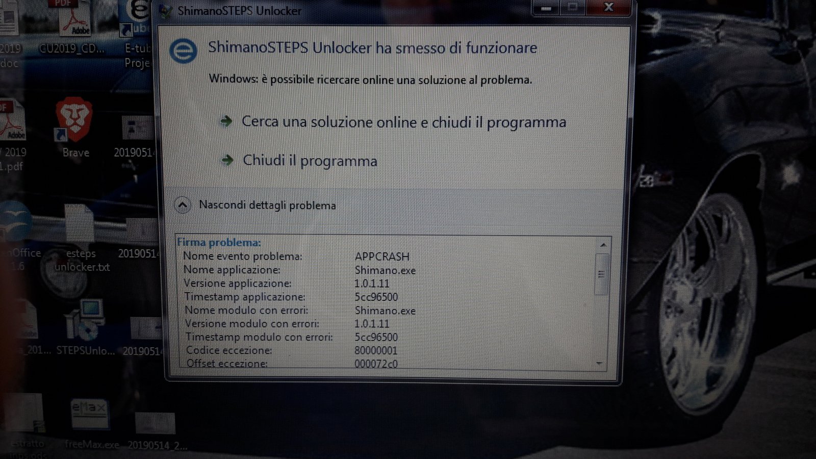

hi VadII, this morning I tried to connect the mtb to the app but it doesn’t work, I have a system consisting of motor and display series 8000 and command 7000, the bluetooth, doesn't connect, while following the instructions of the app.
Then I have another problem, with the window version and pce-1 interface,the program does not start , I use old window 7..
What App says? Does it crush?
Program works fine on any Win system. I don't know why you can't start it. Try to re-install it. Try to switch off Antivirus software for a while
the app say "e-bikes not found" and after it crush
ok I try without antivirus
