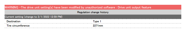

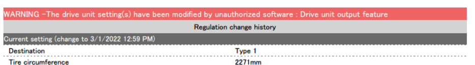

my shop has produced the attached report it still says its been changed, i can see it mentions the circumference, do you know what circumference is required to make it not show?

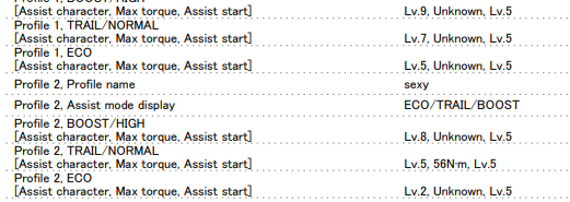

my shop has produced the attached report it still says its been changed, i can see it mentions the circumference, do you know what circumference is required to make it not show? View attachment 129094
I´m not absolutely sure, but I think it is not the destination (region) or tire circumference which is "bad" in your case - it seems like the problematic values are related to the "drive unit output feature" of your motor, like mentioned in the red warning of your report.
So, please check that the Assist character, Max. torque and Assist start of the eco, trail and boost mode of both profiles are programmed to values on your bike which are "well-known" for Shimano, otherwise these values will be shown as "Unknown", see this section of your pdf - report:
Most probably if there is any "Unknown" value in the report, also a red warning will be created like in your case.
So, if the region/circumference would have been "manipulated" in your case, then exactly this would be shown in the red message, not "drive unit output feature". So, always check this red warning carefully and you will find the real reason for this red warning.
In your previous post you did mention "i didnt change any area settings, only power settings as didnt want to change the software on the bike." So this will match to my preceding thoughts and so just set these "power settings" back to the original or default settings. Or if you e.g. will set all "Unknown" values shown in your report (which are only values for max. torque) to 56Nm, this may work (because 56Nm is not "Unknown") and your red warning most probably will be gone.
BTW.: "sexy" as profile name for your bike sounds perfect. :LOL:
Did you only use STUnlocker or other software as well?
Also, what region are you in? MY report says Type 1 under destination but in STUnlocker (the Windows version, I have a cable) it’s actually undefined or not defined. I have never used the mobile version of STUnlocker but the software I used on my old motor had no option to go back to undefined.
You’ll probably want to find someone with the cable so you can try to fix things before you go back to the bike shop as well.
Fatbez
Nov 1, 2023
I used ST unlocker when i first got the bike, and also the standard shimano software later. im in the UK, so i dont know what region that should be? i havent changed region.
the bike shop is a friend which is why theyre happy to help me chekc things before sending the report to shimano.
does anyone knwo what the standard torque settings should be? i changed them to default, in the ST unlocker app, but perhaps these are not the shimano default?
Don´t change region, because the region / destination setting is absolutely fine for your (UK) bike.
If region setting would not be fine, then you would have gotten a different red warning, see e.g. in the situation of another biker where in fact the destination setting is not matching the current programmed setting, see here and following:
Also don´t mix the red warning with the regulation log data which is shown below the red warning in the report your dealer has created with the interface and Windows E-Tube.
The regulation log shows the original settings of your bike which were done most probably from your bike manufacturer on January 3rd, 2022.
Default values for max. torque for an EP8 drive unit are:
profile1: Eco: 34Nm, Trail: 85Nm, Boost: 85Nm
profile12 Eco: 27Nm, Trail: 85Nm, Boost: 85Nm

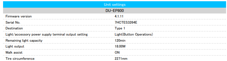

thank you, i'll give that a try tonight. do you know the standard tyre circumference? in case that is incorrect?
Backflip
Nov 6, 2023
102
73
Austria
There is no "standard" tire circumference, because each bike manufacturer may use different wheel sizes and tire types.
The initial wheel circumference which was programmed by the bike manufacturer will be shown in the regulation change history log:
So, your bike manufacturer was programming a wheel circumference of 2271mm on January, 3rd of 2022 to your bike and this is exactly the same tire circumference your bike is currently programmed to, see here in the report:
So, everything is absolutely fine with your Destination and Tire circumference settings currently, because these settings exactly match your regulation log.
So, don´t bother with tire circumference or destination settings, because these settings are absolutely fine on your bike. Otherwise, "Destination" or "Tire circumference" would have been shown (additionally) within the red warning. So, again: Always read carefully the red warning and you will exactly see what the real reason for this red warning will be. If there would be multiple reasons for this red warning, ALL reasons would have been shown within this red warning, separated via comma.
