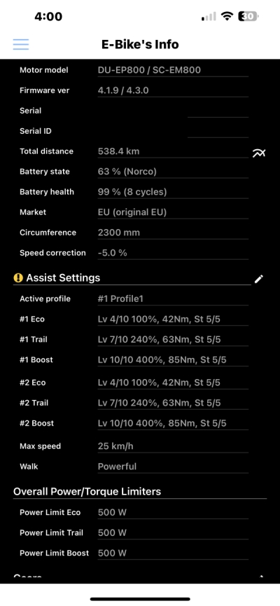

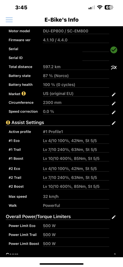

Hi all, new member here.
Just wanted to share my experience using ST Unlocker. I have a Norco Fluid VLT A1 and was not happy with the 25kmh cut-off as it is right on cruising speed.
I followed instructions found on the internet to downgrade the firmware via Android, connected ST Unlocker and requested a licence (which arrived promptly) and changed the region to US. I then reconnected E-Tube on my iPhone and upgraded to the latest firmware.
I'm happy to report everything worked smoothly and I've now ridden ~70kms and from my perspective, it has transformed the bike.
View attachment 112950 View attachment 112951
I have kept the older versions of E-Tube and firmware on the Android phone (dedicated for this use) in case I ever need to revert the changes for whatever reason.
For those who notice the change in battery health, well that is another story. I purchased the bike with a 900Wh battery but discovered the LBS had installed a 540Wh battery so they had to order me a new battery which I had just installed prior to capturing the screenshot, hence the 100% (0 cycles).
