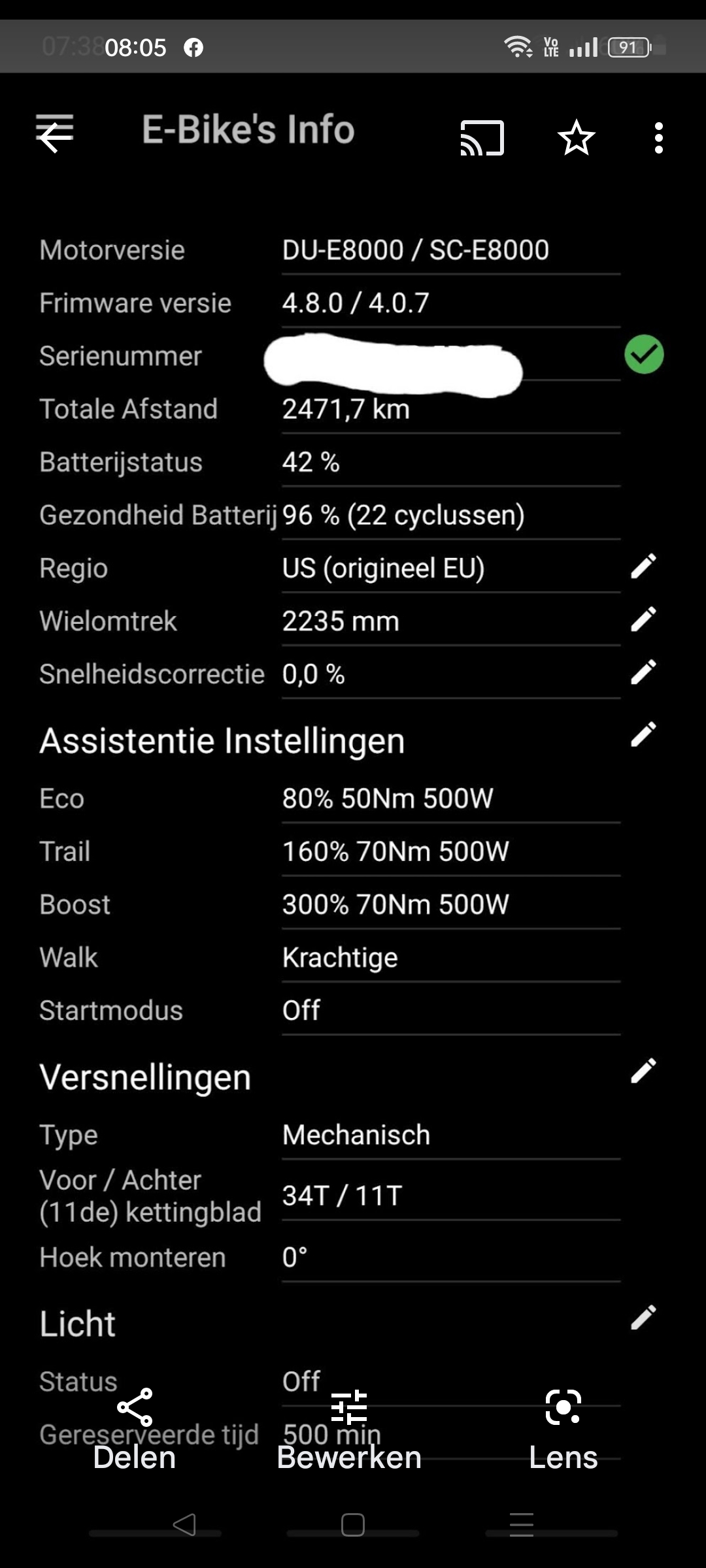

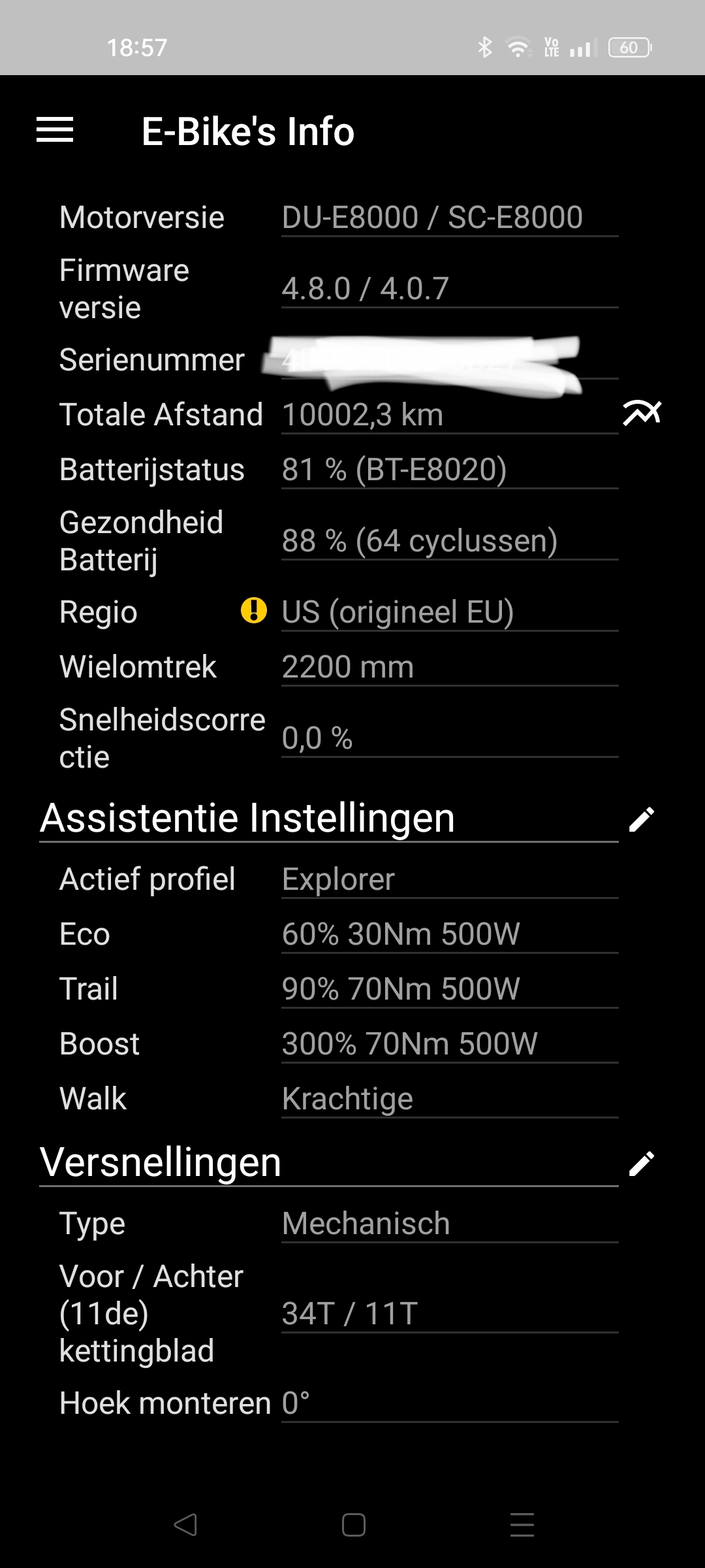

JanSan333
Aug 28, 2020
16
9
Belgium
Does the licence expire over time?
Using stunlocker several years now and I'm no longer abel to change the wheel circumference or restriction area.
Screenshot_2023-04-27-08-05-31-02_965bbf4d18d205f782c6b8409c5773a4.jpg IMG_20230426_185844.jpg

When you bought the Premium license - you got the email message with the license and instructions how to apply it
Yes, But that was years ago. Don't think i still have that mail.
Any idee why the premium license has stopt.?
Still same battery's, still same motor.
Thanks for the reply.
