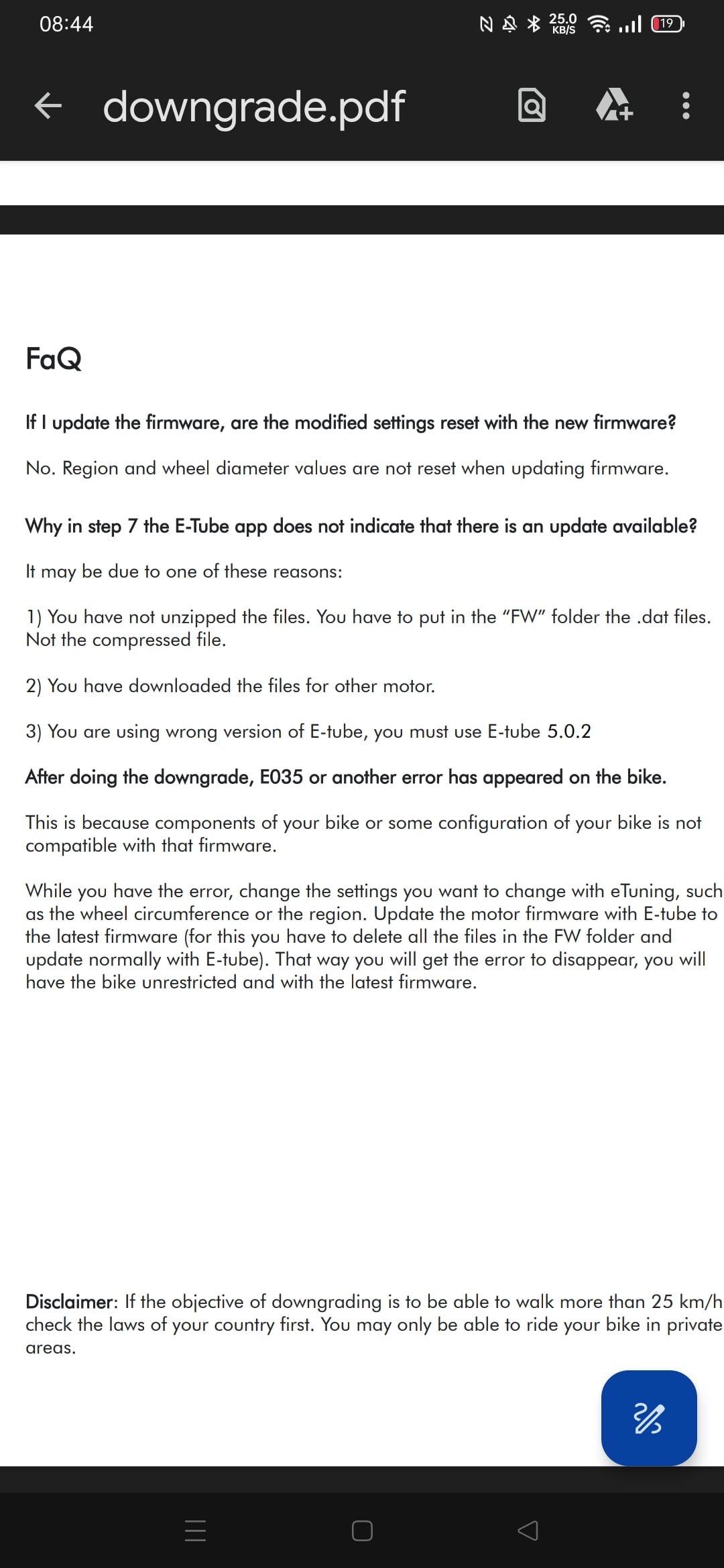

Yes, because when shimano got into the fight against de-restriction, for EP8 there was only 4.0.2 firmware (actually an alpha version), and all subsequent firmware for all motors was with "derestriction" blocking via Bluetooth. For all older engines there was already quite working firmware. EP8 (non RS version) motor works on 4.0.2, but shimano made many fixes/improvements so there is no reason to use 4.0.2.

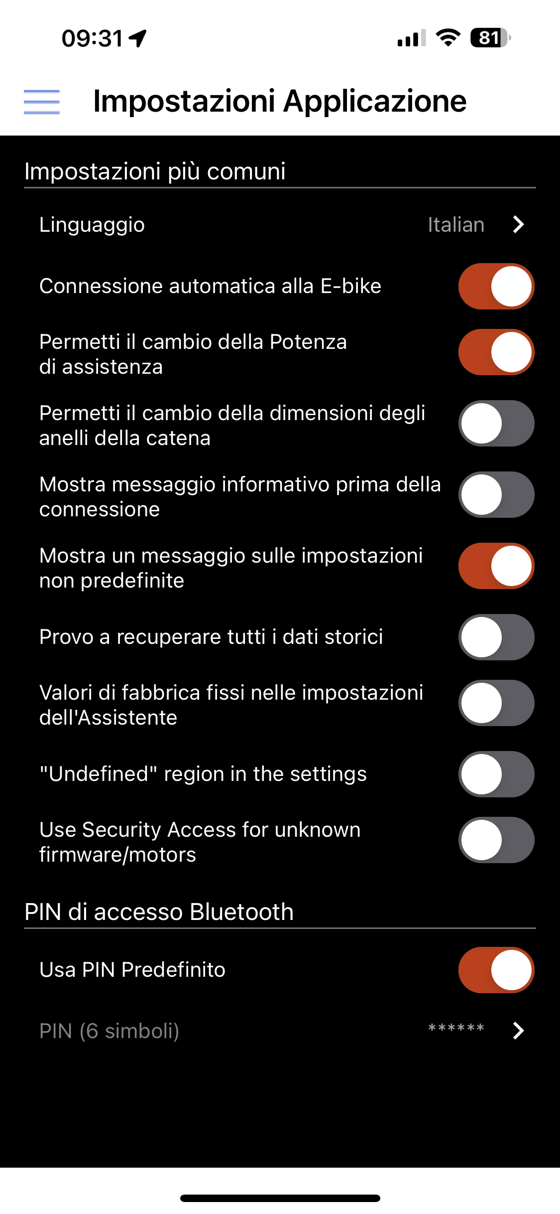

So, I have tested the STEPSUnlocker - thanks a lot to Vadll for the great program and sending a free valid licence key!
I had 4.6.1 firmware and modified to US version (32km/h) and increased power in Boost mode to 600W yesterday which worked perfectly on the first run.

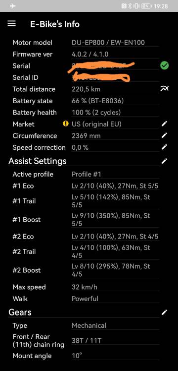

ep8 4.1.10 ( latest) flashed after gone deristrict with 4.0.2 ( 32km us market and 2000wheel size+5%spd) seems seems to work
ep8 can pull 100nm and 600w peak ? (settings can go to that)
my old trusty e8000 can pull 75nm 600w
So you want to say, you have derestricted on older motor firmware and then upgrade the firmware to latest version and derestriction stayed as was before upgrade?
What is your GPS speed with this setup? Are you on 29 inch wheel?
