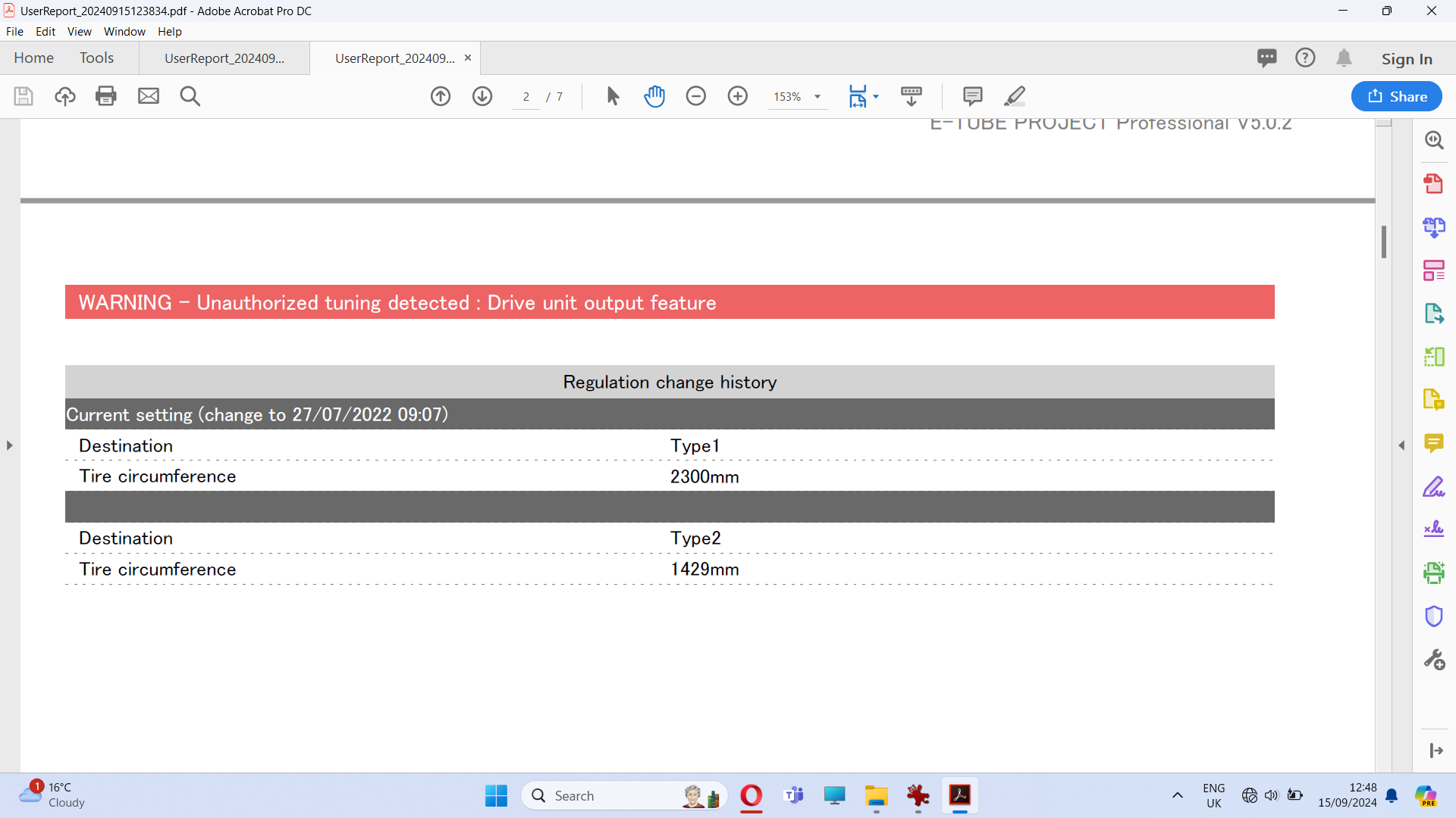

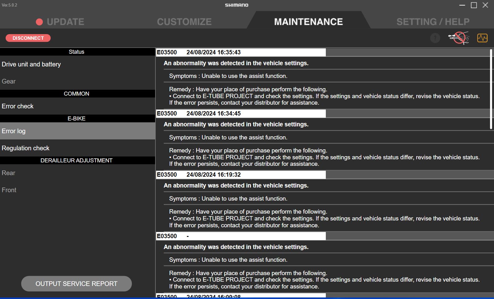

I've been running my EP8 rs with region changed from EU to US and 85Nm/ 500W for past 18 months and it's been working great. I originally use android STunlocker pro with 4.0.2 firmware to do the changes then put it back to V4.1.8.
Last week I reverted firmware to v4.0.2 and changed tyre circumference to 1429mm then upgraded firmware to v4.1.10
On the first ride the bike performed very well with the increased speed limit but it shut itself down about 5 times.
On the 5th shutdown the bike bike refused to switch back on.
I stripped the bike and checked for loose connections/ broken wires but everything checked out fine. I tried to revert the settings with STunlocker but as the bike will no longer power on and the screen is totally blank there is no bluetooth connection for STunlocker to connect to.
I then ordered a PCE02 connector and that connects with shimano Etube windows program and it says error E03500 Abnormality was detected in vehicle settings. Symptoms: unable to use the assist function.
I then connected directly to the motor with PCE02 and rolled back the firmware to v4.0.2 but couldn't find a way of returning the settings to default. I then tried V4.1.8 firmware but no difference. I tried to connect STunlocker windows version but it won't connect without the motor powered on.
Has anyone got any ideas how to fix this or is my motor bricked?
What about a settings backup from somebody else's etube windows program, would that load onto my motor or are the backups specific to individual motors?

Change settings back to default (to EU region and 2300mm circumference) using STUnlocker for Windows and PCE Interface. If you still have 4.0.2 in your motor - you can use STUnlocker App for that (via Bluetooth). EP8 RS does not work on 4.0.2, this fimware version requires for the derestriction via Bluetooth only. After the derestriction you have to upgrade firmware back to the actual version (according downgrade instructions)

It seems as though V4.1.10 has detected the circumference change and locked the assistance out.

There are no any "locks" in EP8 available. Power ON your motor first - fix this issue somehow. It's not normal that you can't power ON your bike.

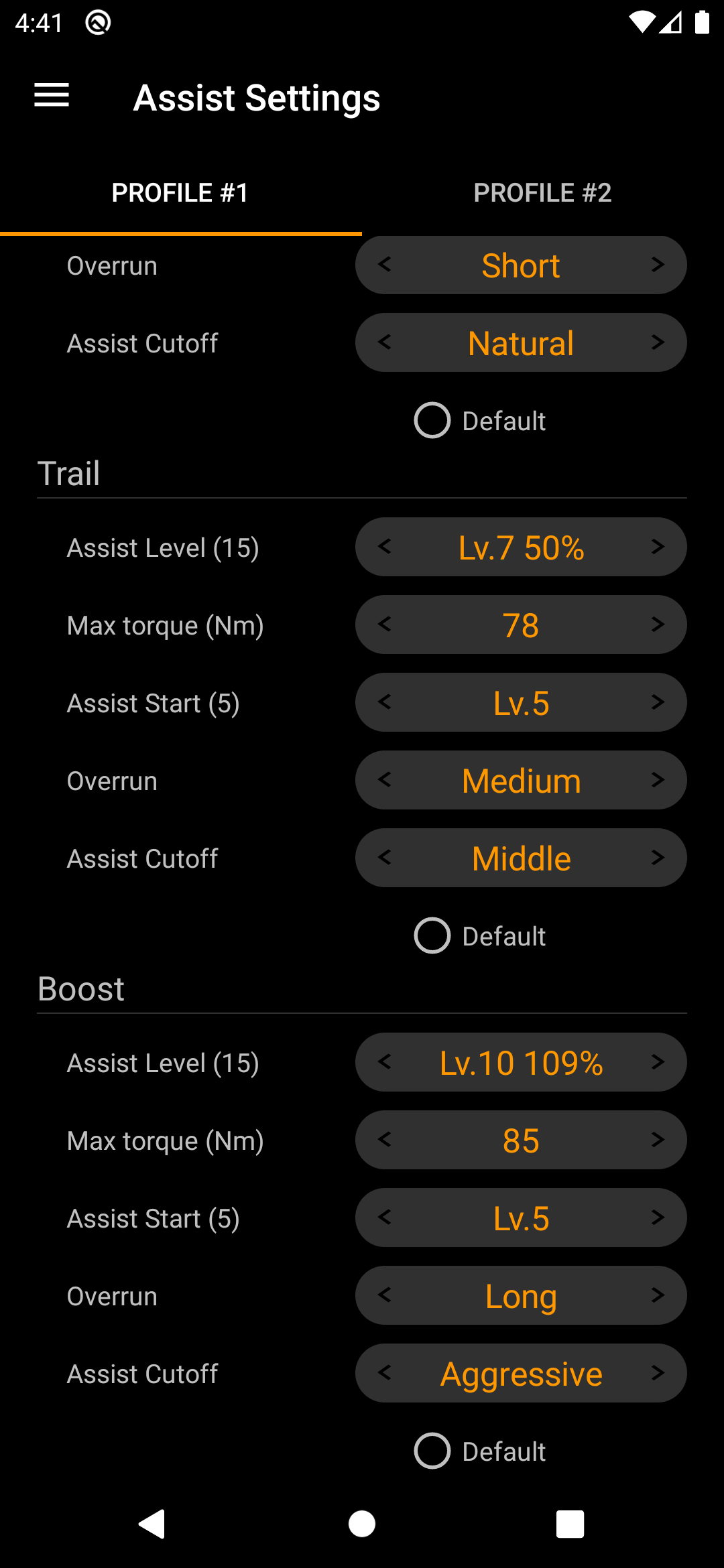

What did you set your support, power, assist etc to? Maybe post a list. That’s what it’s complaining about, not destination or circumference. Also, has the new circumference and destination been written to the regulation log? AFAIK, STUnlocker does NOT write to that log and you should get warnings for those as well.

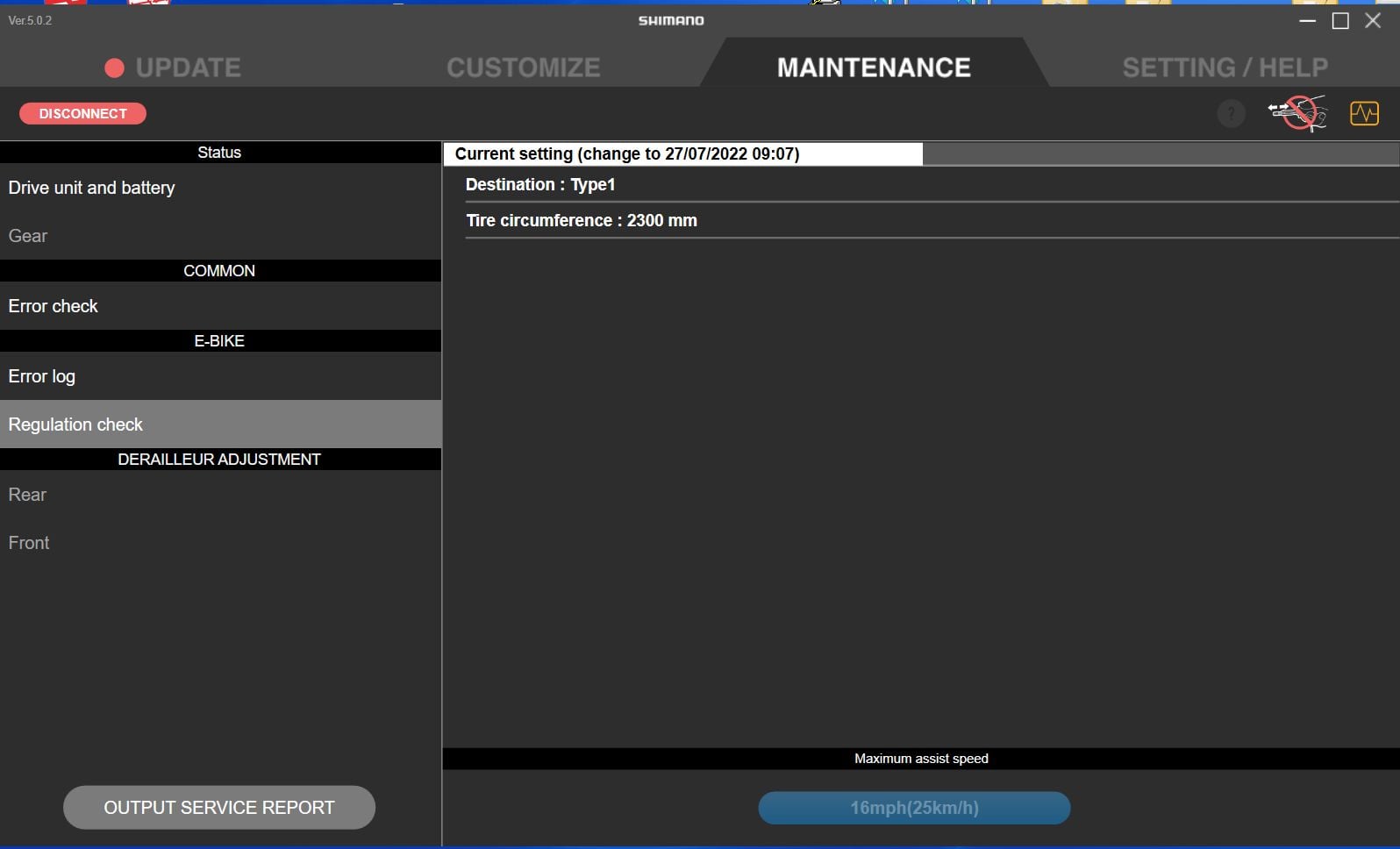

I'm still don't understand why can't you use STUnlocker for Windows to change the settings back to default?...
You can use ETube Professional to turn ON the bike by connecting to it. After that, you can click "Disconnect" in the ETube software and your bike should stay ON. Now you can connect STUnlocker for Windows and change the settings.
Added: the new version of STUnlocker for Windows is available. It no longer requires a bike to be switched ON. You can use the same link to download the new 2.6 version

Thanks Vadll,
I installed V2.6 and it did allow me to change all the settings back to factory without powering on the bike.
The regulation log is now clear.
It still wont turn on so it must be an electrical/ mechanical fault.
