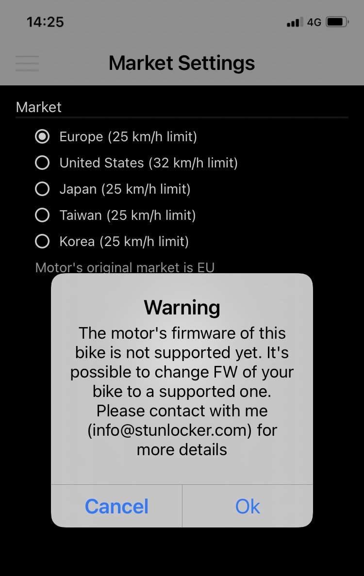

Supported for a what? All non-premium features are 100% supported for 4.9.0.
4.9.0 was released by Shimano to avoid derestriction, it's only one goal. So it's not possible to derestrict motor with 4.9.0 via Bluetooth
[mention]vadII [/mention]
Will I be able to change market setting from EU to US with 4.9.0?

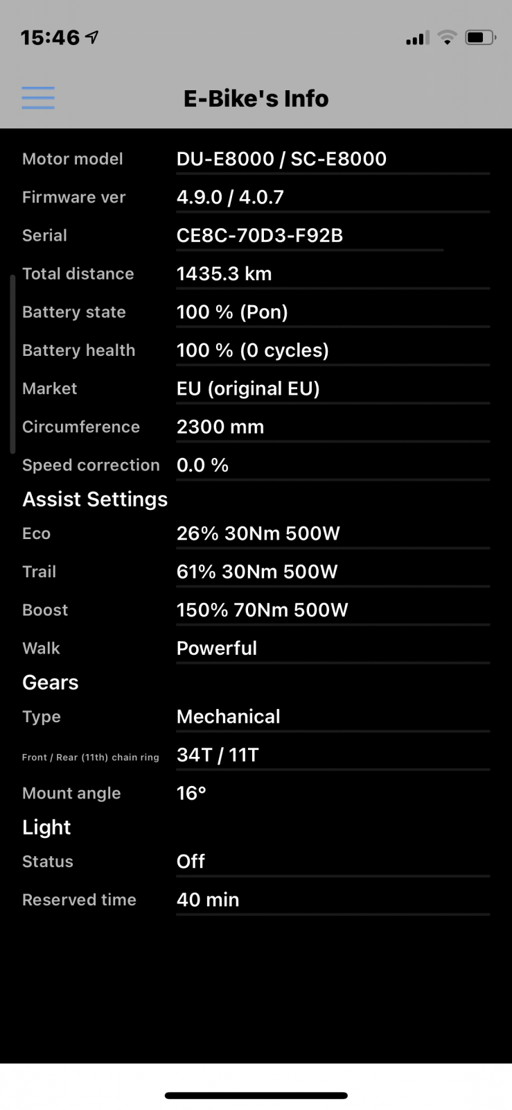

On Focus Jam2 I’m using the app which is saying the max power output is 500w , is this right as the spec of the unit is 250w , do I need to turn it down to 250 on the assist settings ?
I have been asking on numerous occasions if the ST-U app will be able to change market settings on f/w 4.9.0
It appears that it doesn’t. If you only bothered to answer my question, I wouldn’t waste my time upgrading and now having to downgrade.
vadII
Feb 19, 2019
813
583
Earth
Latest FWs (4.9.0-E8000, 4.6.0-E7000/E6100, 4.4.2-E5000, 4.1.1-EP8) do not have "derestriction" features via Bluetooth. There is nothing to support.

Like a few others wanting to change the EP8 location to US I have asked several times on how to down grade the firmware explaining the reason (not great on a computer)
I have paid for licence and have been sent instruction BUT there not easy or clear to follow as it’s been led to believe (maybe they are if your good on your pc) but I like many others am not.
I’ve asked for help and a better / simple explanation to get it done to be told to “find someone else to help” .....

Hi , I’m doing something wrong with the connection to the st Unlocker app on ios
motor ep8 - screen sc-e7000
Bike Merida e one sixty
I downloaded the app, followed the instructions but the app can’t find the bike :s
when I use the E-TUBE app it finds the bike almost directly.
I can’t wait to try / use the St Unlocker app. But I fail at the first step. Can someone point me out what I do wrong or how I do it properly.
It fails or didn't find your bike? Did you read the "Troubleshooting" section of the App's manual
