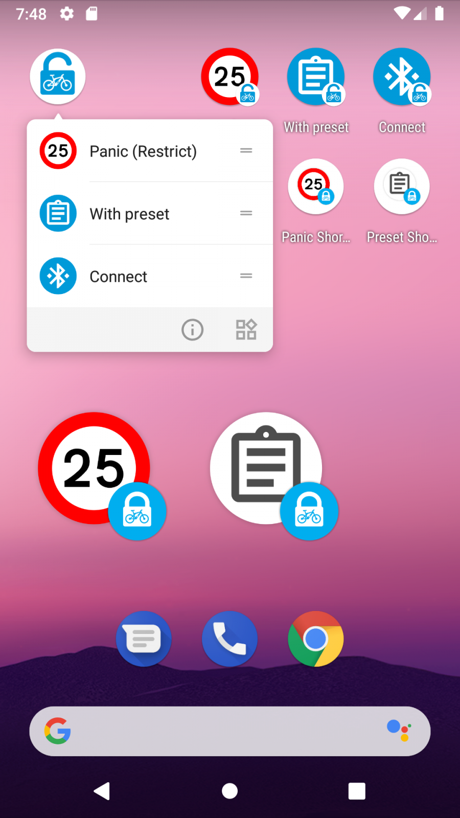

New version with widgets and shortcuts for quick applying settings available at Google Play
"Panic" widget/shortcut for applying "Stock" settings
"Preset" widget/shortcut for applying custom Assist settings for bikes on which assist settings are not savable.
Updated manual includes all latest changes

Yes, it's supported
Thanks for the reply @vadII .
I tried it this morning and it worked, although I had to do the procedure outlined by @Johnnie by going back into the eTube app and manually changing the speed to 32km/h, then back to STUnlocker and use the widget function (which is VERY uselful btw).
It's definitely a much more pleasant ride now.
Thanks again :)

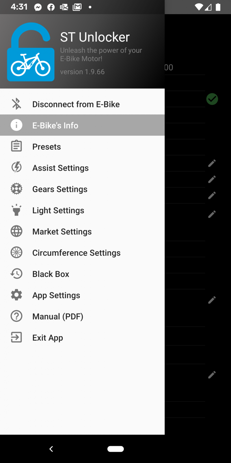

Hi guys, stunlocker app works a treat! I am struggling to find the request a license function though. It's not appearing in the menu, have tried connected and not connected to Merida e160, no luck. Tried uninstalling and reinstalling the app as well. Any ideas? Oh and Android pixel 3.
