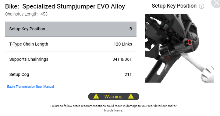

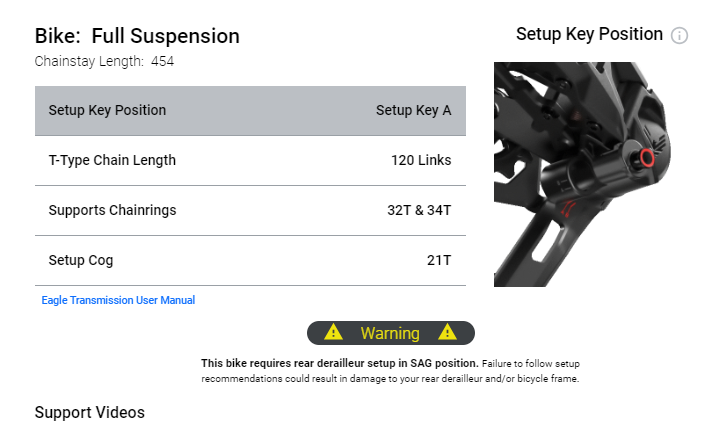

I am about to install the transmission, but the chain and setup key guide works strangely. The Reign is not listed in the guide and has a chainstay of 454mm, and this setting is suggested (in my case 34T chainring):
If I take for example the specialized stumpjumper evo which has a chainstay of 453mm, the following setting is suggested:
1mm difference in the chainstay length is not relevant and a different setup key position is suggested, for one the setup in SAG for the other not.
What is the difference?
Setting the setup under SAG position alone seems to be difficult for me ;)
That is what it saying but are you running a 34 or a 36? My E2 2022 is 36 and in the high position so 122 links and says set key position A .As far as setting it up in sag you can find it with the o-ring with you on it . Note what psi it is and then just either just put something under your rear wheel and let air out till it touches the O-ring or set the rear wheel on the floor and do the same thing. Then when your done just put the same air pressure back. where you able to confirm all the information as this is different from when I setup my 2022 Reign E2? As I said when I just looked it up it did say key position A under sag and 122 links as mine is a 36T
kgoran79
Apr 9, 2020
12
Hungary
As I said, I have a 34T chainring. The draining the air won't work for me as I ride a coil shock... ;)
My problem is not how many links the chain must have, but setup key position and once set in SAG once not with the same chainstay length

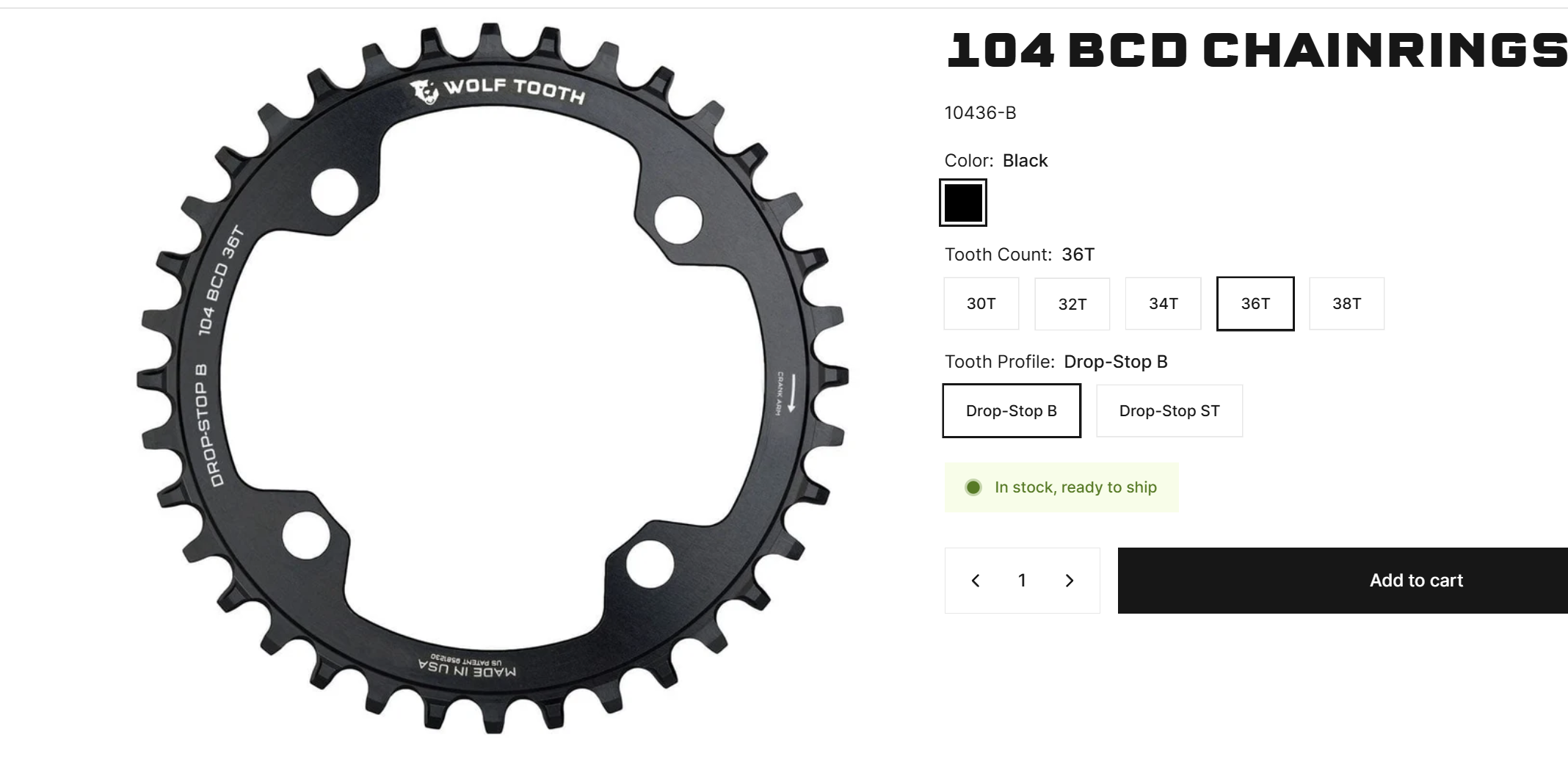

Looking to possibly upgrade to the transmission drivetrain. Does anyone know if the "Wolftooth Dropstop B" chainring will work and will I need to purchase the spider nut removal tool?
Nomad1
Apr 2, 2023
247
81
03818
The kit comes with a new front ring so you won't need that wolf tooth chainring. Also you won't need spider nut removal tool but you will want the ones for four nuts on the chainring.
