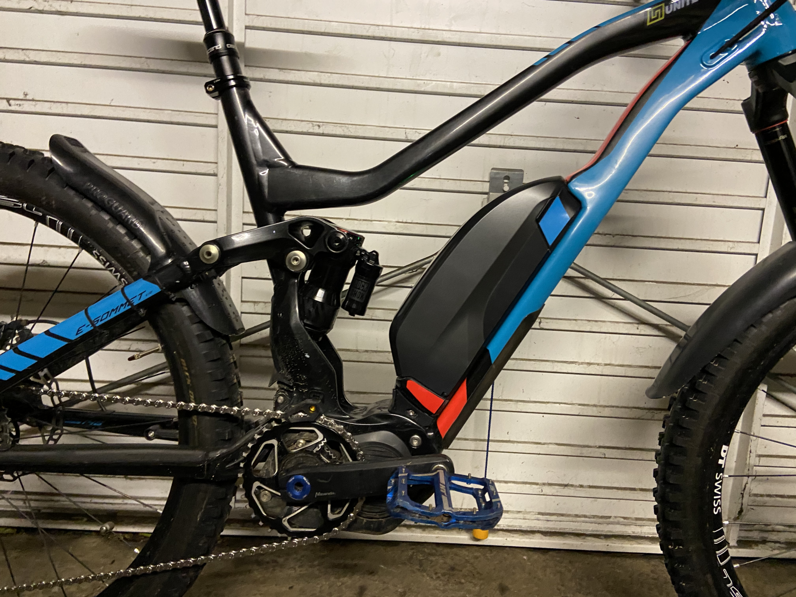

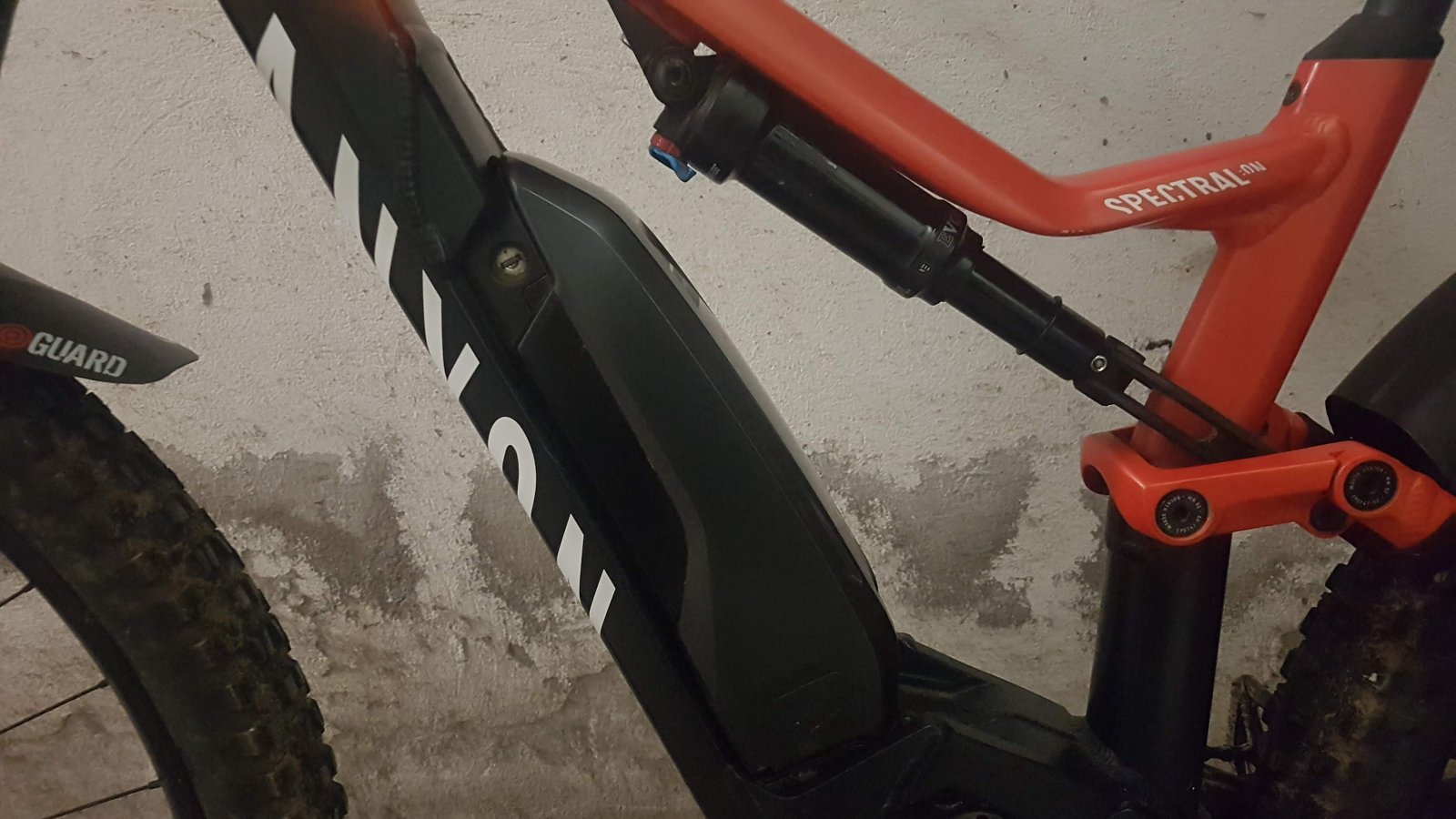

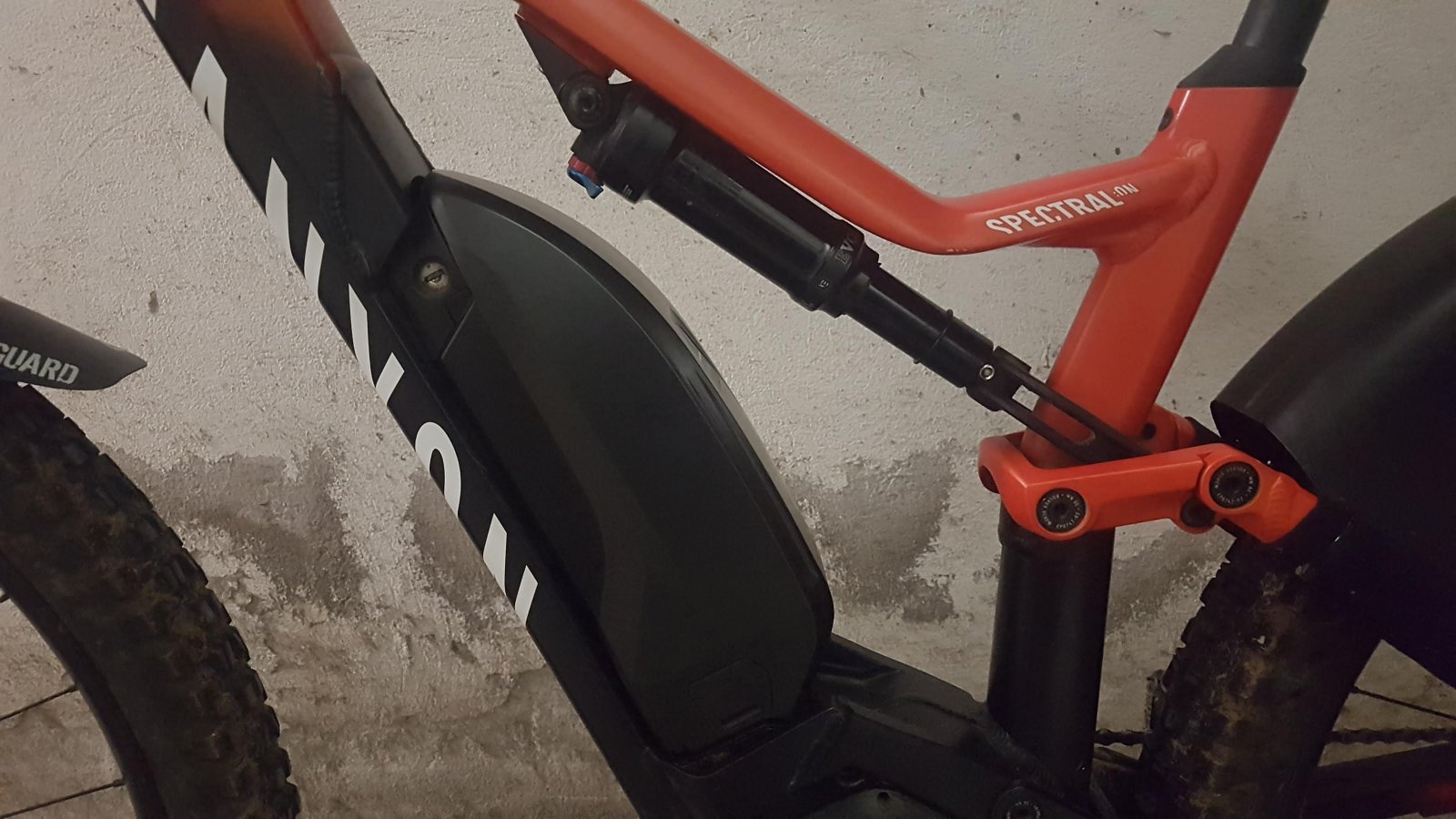

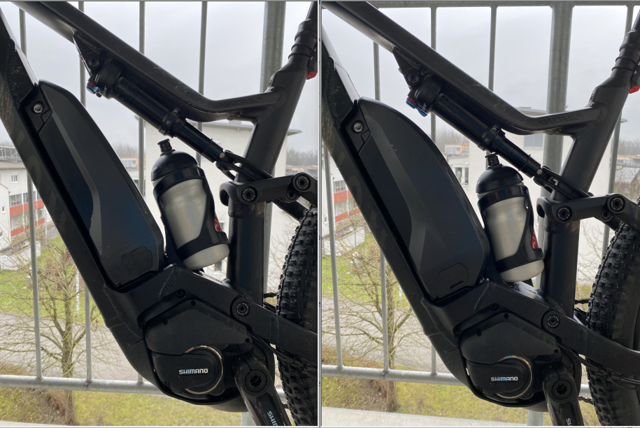

I can say that after a static test the 504 Wh battery stays absolutely firm in the modified holder, just like the 630 Wh one.
In addition, yesterday I tested it with the 630 Wh battery and the old holder modified with my first ride with them. The ride was a good test, with long very bumpy descents that stressed the coupling between battery and holder. Excellent result! No rattling noise, no vibration and, of course, the confirmation of a 25% range increase with no penalty in terms of driveability!

Hope these pictures help: the first one with the 504 Wh battery, the second one with the 630 Wh battery:

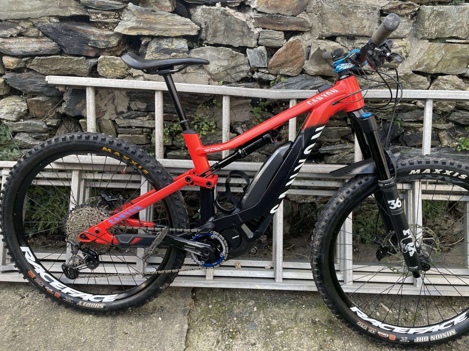

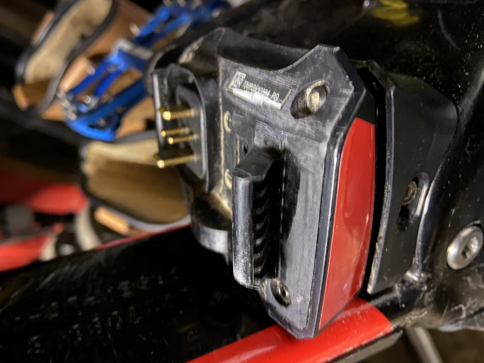

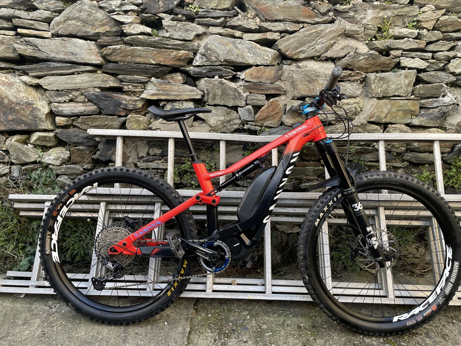

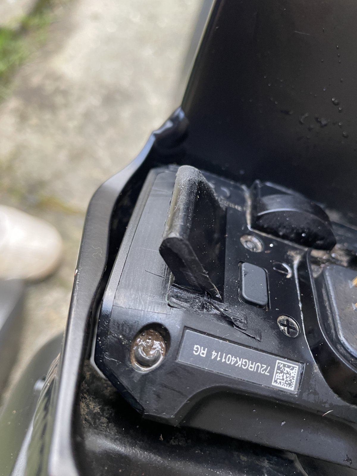

I converted my Canyon Spectral On today to take the eternal 630 battery and my frame size is the XTRA SMALL so was worried it would not fit.
IT FITS PERFECT. ????????

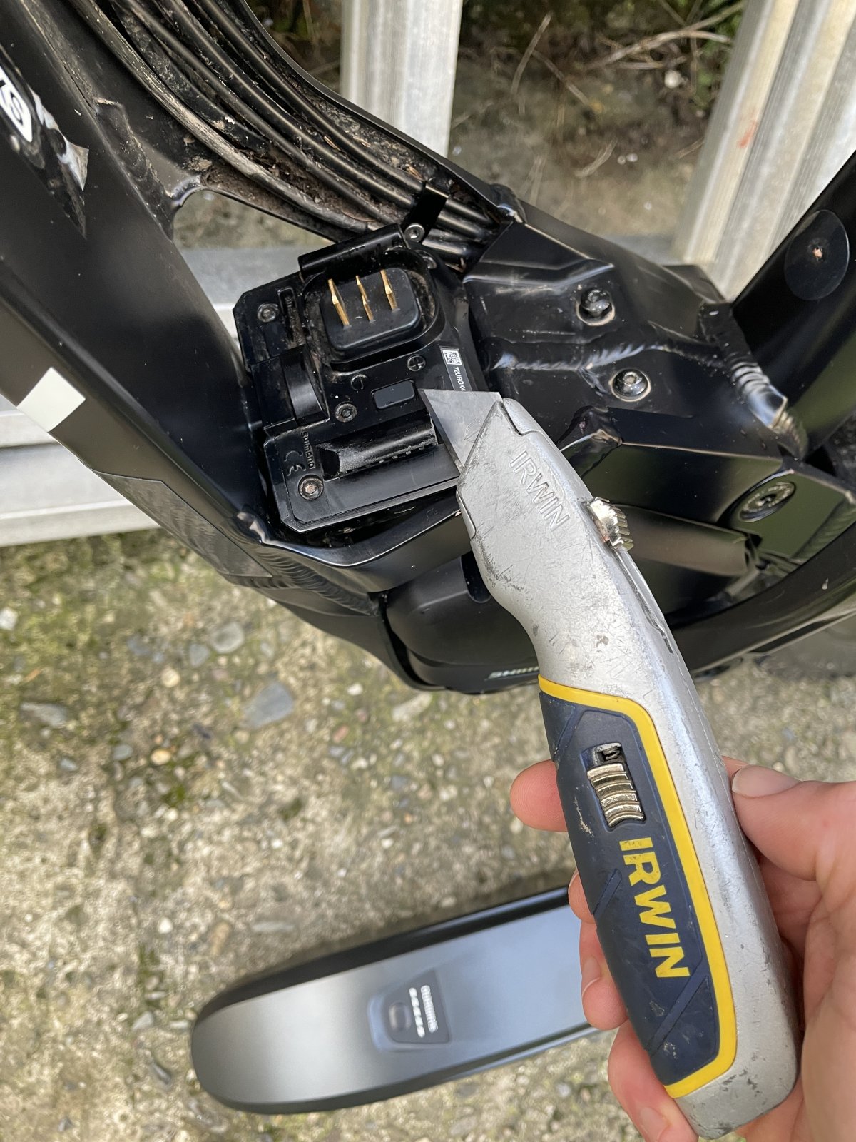

I also only trimmed down the lug on the mount with a stanly knife to allow for the smaller location hole. Really simple to do. Just sliced at the next spline in the lug.
Had to loose my bottle holder but that’s no issue. EPIC RIDES HERE WE COME.
still takes the old 500 battery too so be riding all day with that in a backpack. ??
7D0EAAA9-7DB6-4A01-89EF-F40782387263.jpeg 5AB8D005-52F6-4D29-9DFE-EA4D61E4592B.jpeg
still takes the old 500 battery too so be riding all day with that in a backpack. ?? View attachment 50685
View attachment 50690 View attachment 50684 View attachment 50687 View attachment 50689
Sh*t. I've no escuses now. I was still apprehensive as I've a size S and the other people who had tried it had bigger frames.
Now I know it's OK on a size XS I'm gonna have to go for it...

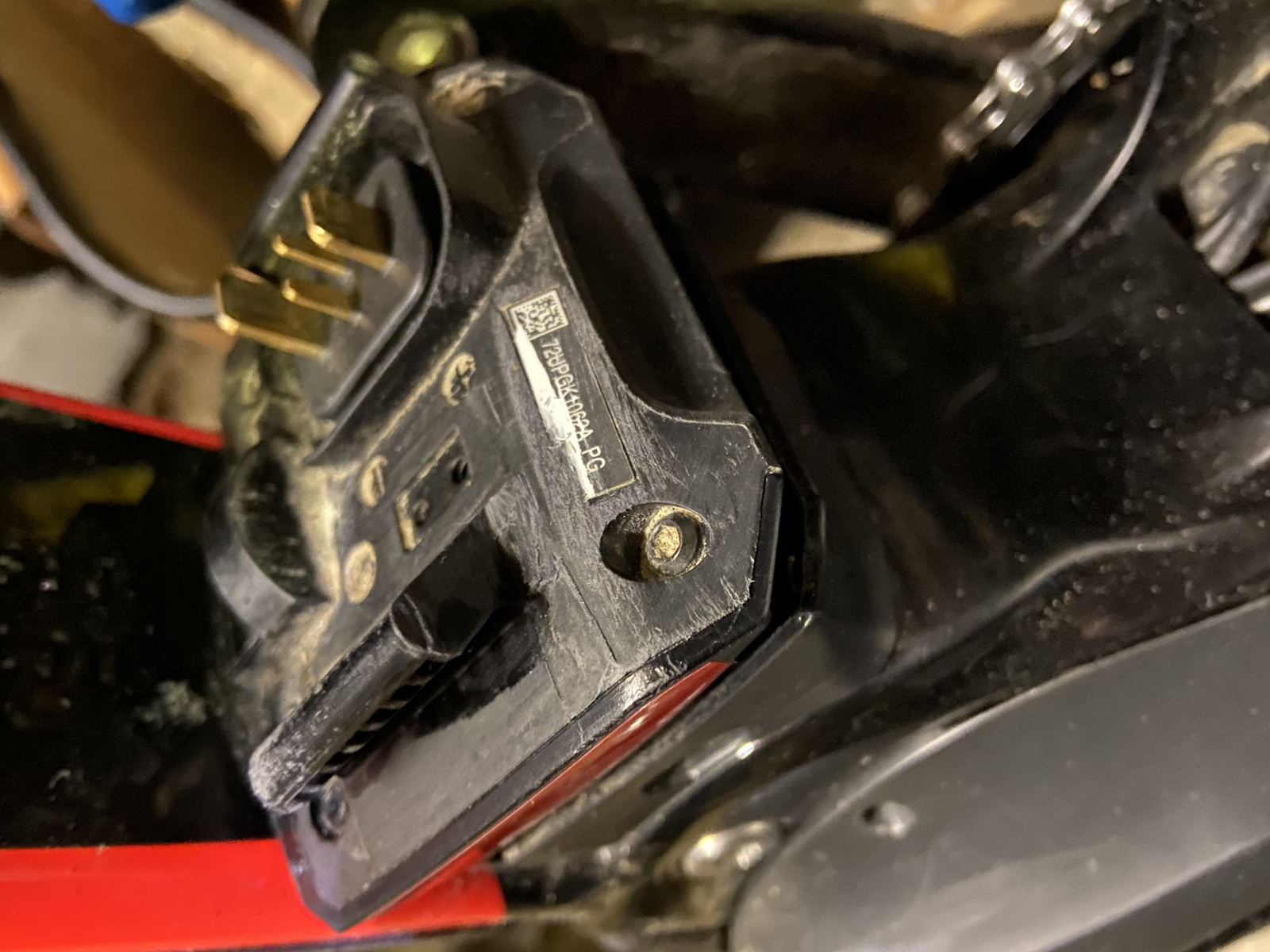

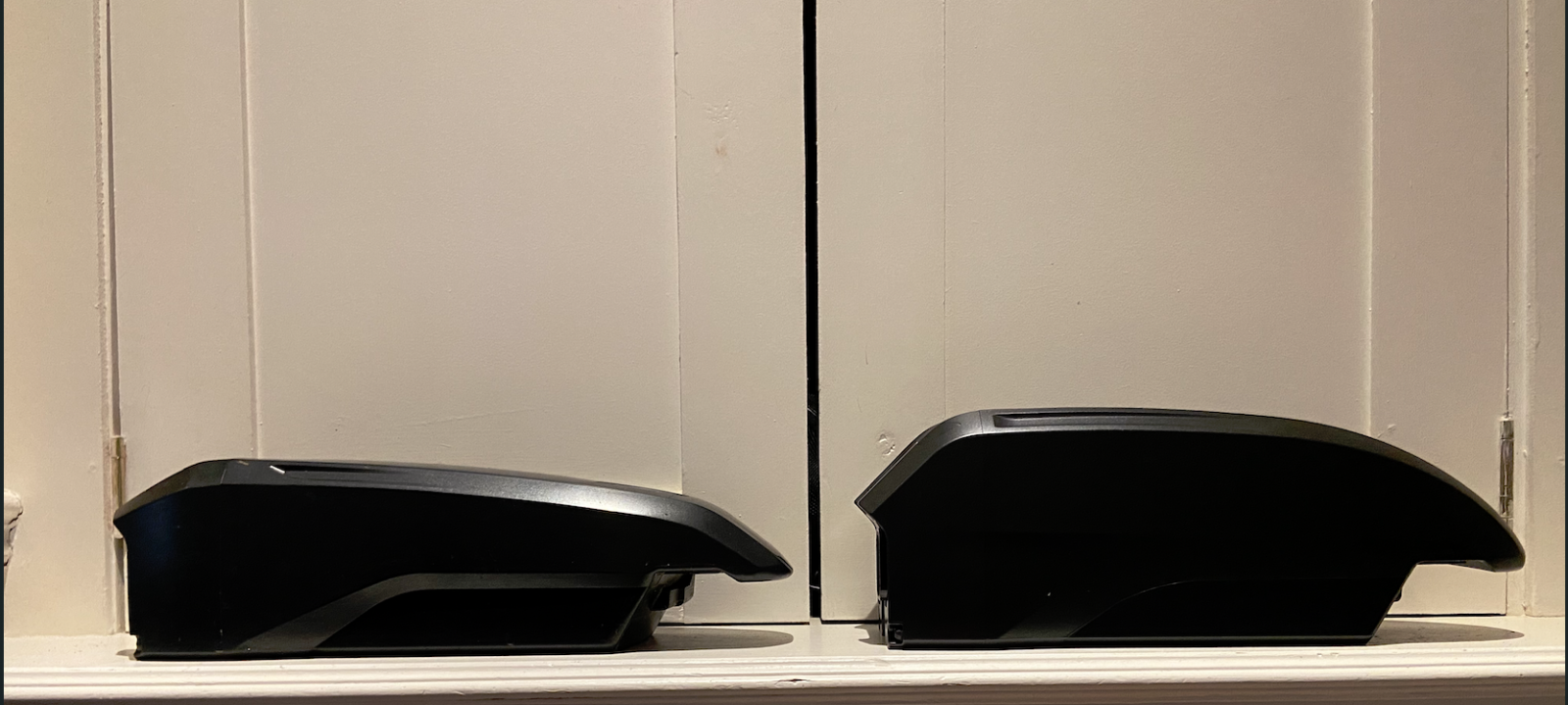

9,190

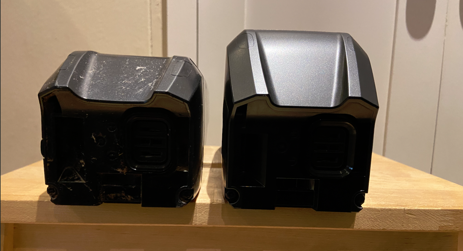

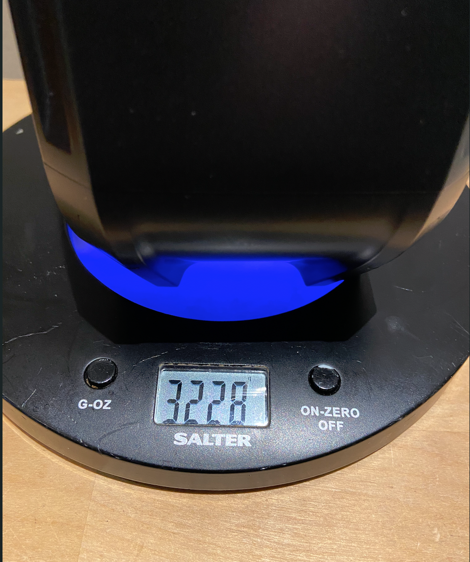

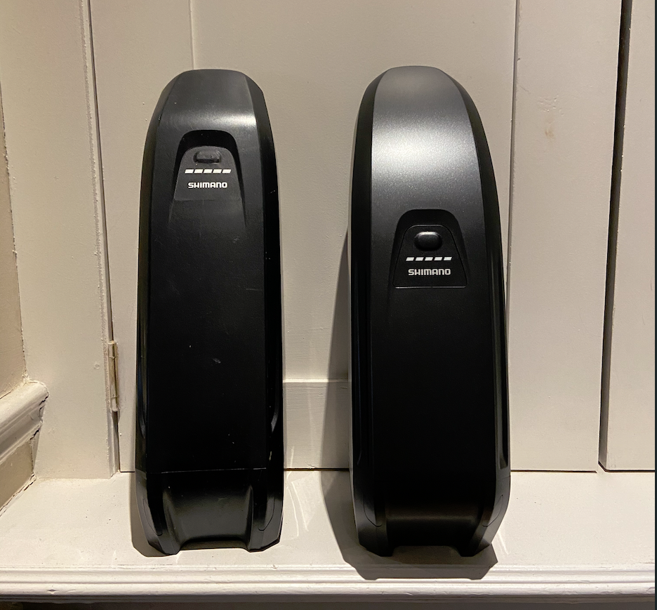

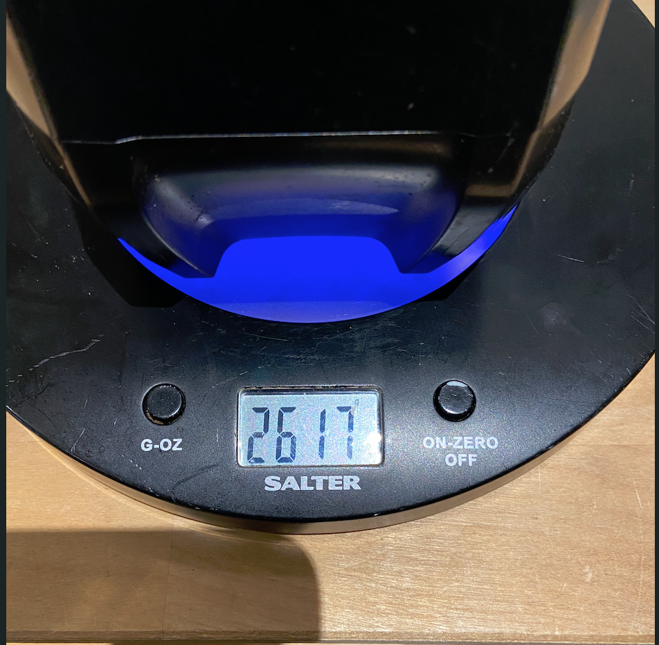

Got it back home now and will attempt the mount surgery later. Weighed one of my 504wh batteries and the new one. 630wh is about 600g heavier, which tally up with what @norrit measured his at.
Its a big old lump for sure!

9,190

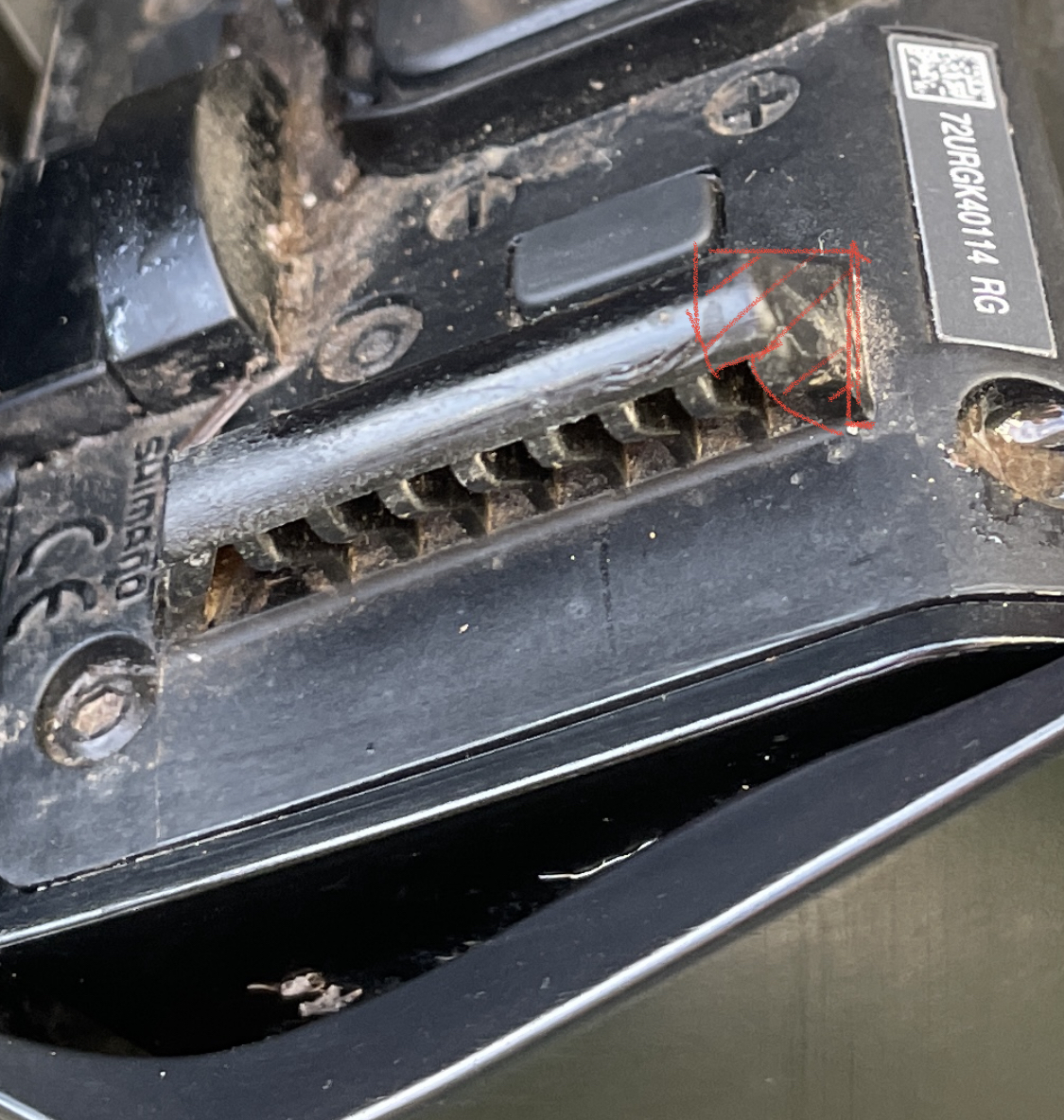

So five minute job to hack saw, tidy up with a Stanley, and a bit of light sanding, mine is not the neatest attempt though! - fits super tight which is good.
