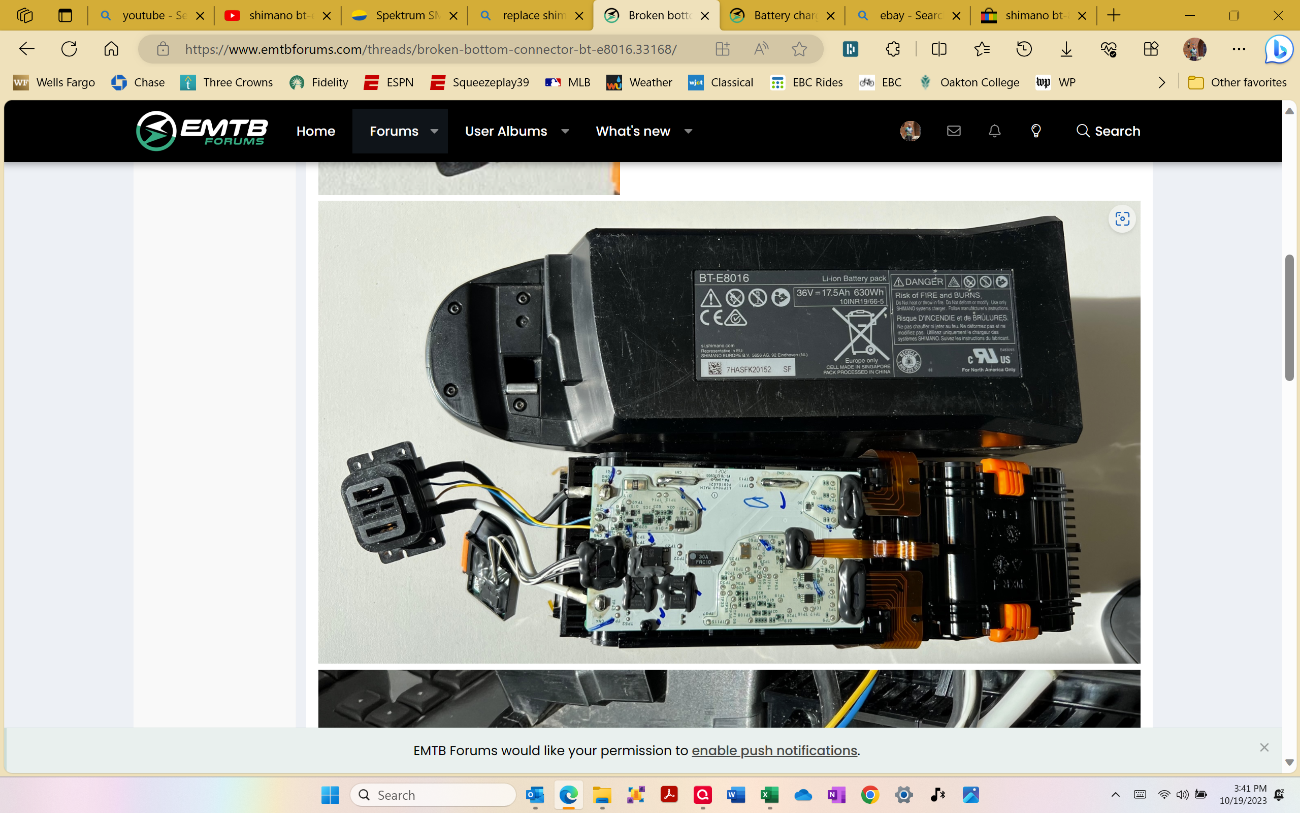

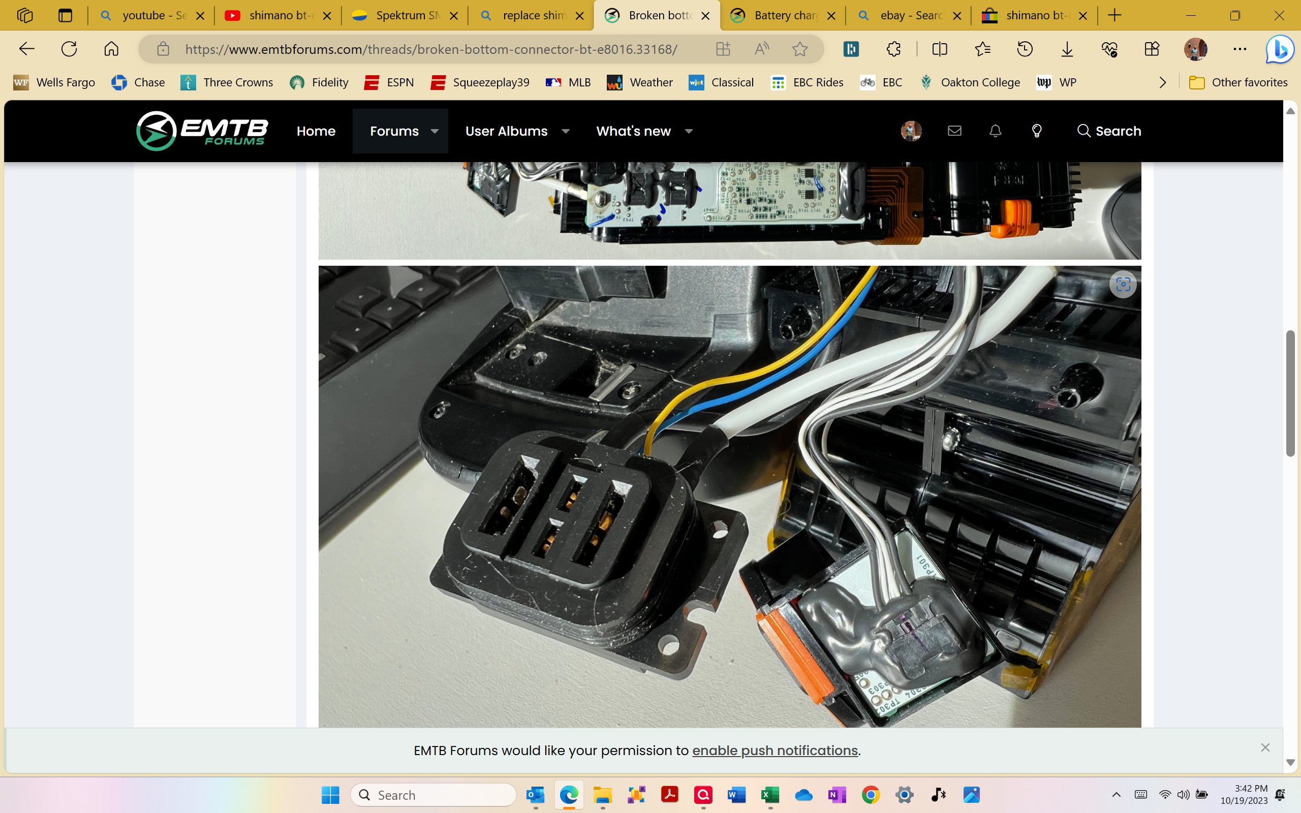

Norrit, earlier I saw a post you had about repairing a Shimano BT series battery, so I thought I'd reach out. I have two such otherwise good batteries but with worn out connectors in the front where the battery plugs into the mount. Did you ever find a source for a replacement part?
norrit
Aug 11, 2020
30
19
Austria
Unfortunately I couldn't find a replacement part.
If you find a source, please let us know.
In my case, only the contacts were bent downwards. I was able to bend them back and it has worked without any problems since then.
I now only change the battery very gently.
