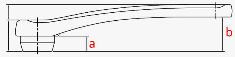

But how do you know which / if they fit the Levo?
You want the ISIS mount and have to check these 2 measurements :

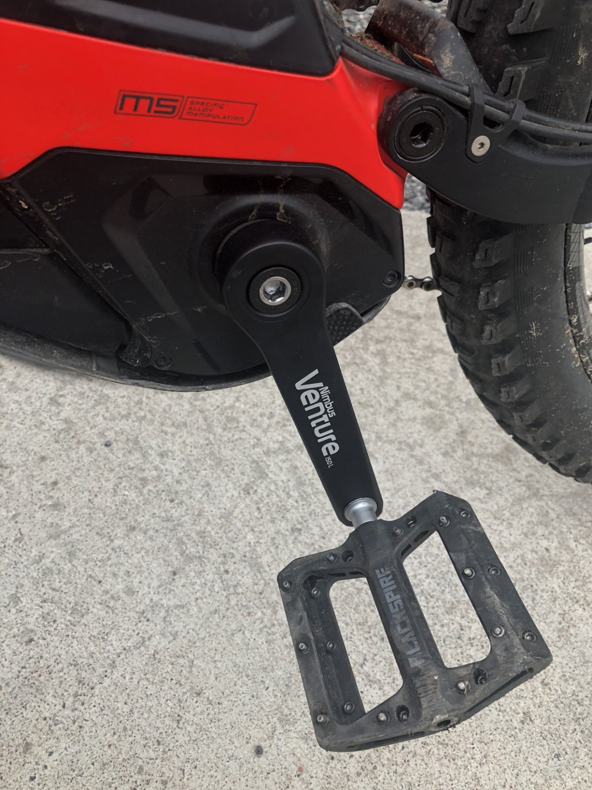

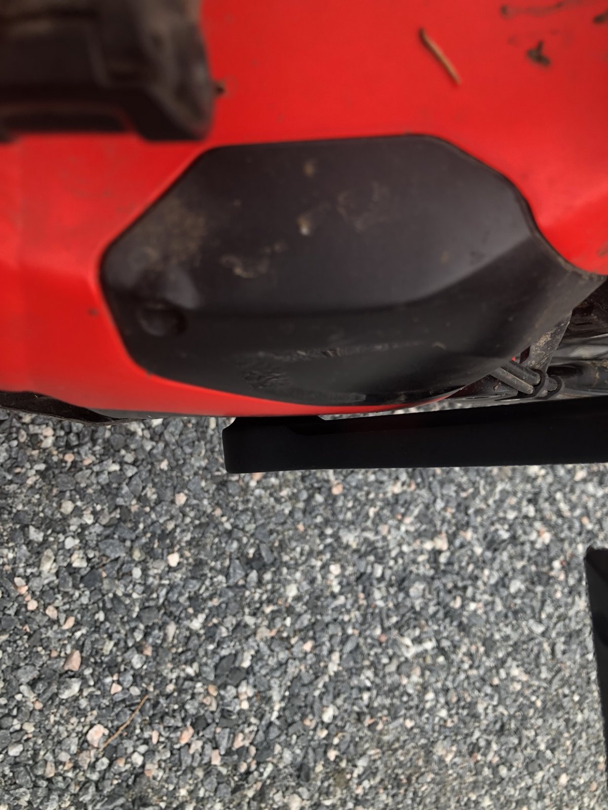

I got mine 150s installed yesterday. Didn’t require any Dremel work, but the clearance isn’t big A short spin around house and yes, it feels like you are pedaling quicker, but not in a bad way. Jury is out there until I get to take a proper ride on trails.

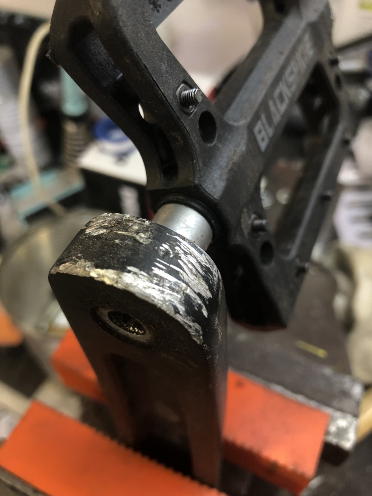

I took a photo also of the stock cranks that have gotten some abuse during 1,5 month of ownership.
