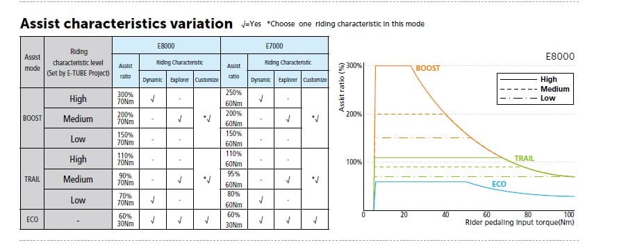

I don't think there's anything funky about the way the power comes in, other than the fact that it doesn't seem to start until about 5 Nm or torque are detected. The graphs drop off because the users input increases after the motor has reached either the maximum output, or the maximum output setting for that mode. BTW, I really appreciate your sharing these charts, I really get into that type of info.
RickBullotta
Jun 5, 2019
1,849
1,579

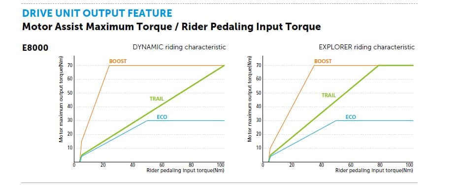

Well, there's clearly a fundamental difference between how Trail mode works vs Eco or Boost. The other two modes are quick step-up to a peak setting, whereas Trail mode is linear through the whole range. You can of course tweak the "peaks" on all modes, but the "curves" are quite different for Trail.
OldGoatMTB
Mar 24, 2020
423
253
27284
I don't think you understand the graph. The graph isn't of how much torque the motor is putting out, it's how much assistance it's giving. If the rider is putting out 10 Nm then the motor can give you 30 Nm (300% assist), but if the rider is giving 30 Nm the motor cannot give 90 Nm, because the max output is below that. As the rider produces more torque the percent that STEPS give is less, which is why the curve goes down.
Timochka69
Jan 31, 2018
143
101
Helsinki
Not quite. In fact when set to HIGH, TRAIL reaches full torque when rider inputs 63.6 Nm, in LOW setting needed input is 100 Nm.
All modes seem to have pretty much linear ramp-up, just different values (ECO ramping up the slowest and BOOST very much faster). The max percentage of assist is different between different modes and can be adjusted. On TRAIL setting the curve seems to be linear all the way (on DYNAMIC setting), because Shimano decided to limit the chart to 100 Nm rider input value. Since 70 % assist and 70 Nm max torque of the motor are achieved at 100 Nm rider input, the assist curve will in this case be linear. This is of course only a (marketting material) representation of theoretical values, not from measured real values.

According to the charts posted by Iamommie (pg 27 https://si.shimano.com/pdfs/sm/SM-SHIMANO_STEPS-002-ENG.pdf), the modes are all linear with a max. Boost hits a the max almost right away because the assist is so high. I wish they would update the document, we can adjust eco mode now, but they don't show that in the table.

Look at the power curves above - basically Trail tries to modulate assist relatively close to linearly through the whole range (based on rider input), where as Eco and Boost ramp up quickly to a plateau (with Boost typically being set to a high power output and Eco to a lower plateau). Trail will feel less "abrupt" when getting on and off the power. Eco will also feel that way, but for different reasons, in that it won't spike like Boost will (feels more like a "normal" bike).
Ultimately, I base my assessment of how I wanted it tuned on how it "feels", and how it actually performs on the trail, not what the curves say. For that reason, I've gone with a more aggressive upper limit on Trail mode.
