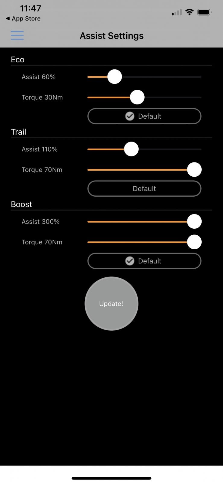

So if one was looking for outright performance from the motor in trail and boost what would be best setting ?
Std trail is nice and I obviously wouldn’t want to try and turn it into boost but will changing it make it stronger but still retain the linear feel and the way it’s delivers the power as in giving you what you need / ask for as designed ?
Also is there an app that can lift the speed limit higher ?
Motohawk75
Dec 30, 2020
173
111
U.K.
So i have changed trail to max assistance (torque was already max std) and it’s superb ! I ride on this now all the time.
the only thing im slightly confused on is Boost (now and before I changed trail) doesn’t feel as strong as trail for some reason on the new std EP8 Santa Cruz Heckler ......?‍♀️
