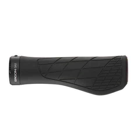

Grips like the Ergon GA3, (more compliant) carbon handlebars and adjusting the brake levers all helped and together solved my hand problems… until I raised the seat on one of my bikes and now I get pins and needles.

As I said an SQlabs swept back bar which has a 31.8 dia and a RISE IN MM15 / 30 /45, WIDTH(S) IN MM780.
The Ergon GA3 winged pair of grips are not as bulky as some.

I've got similar Ergon grips at home, but never really got on with them. I prefer the round ones...

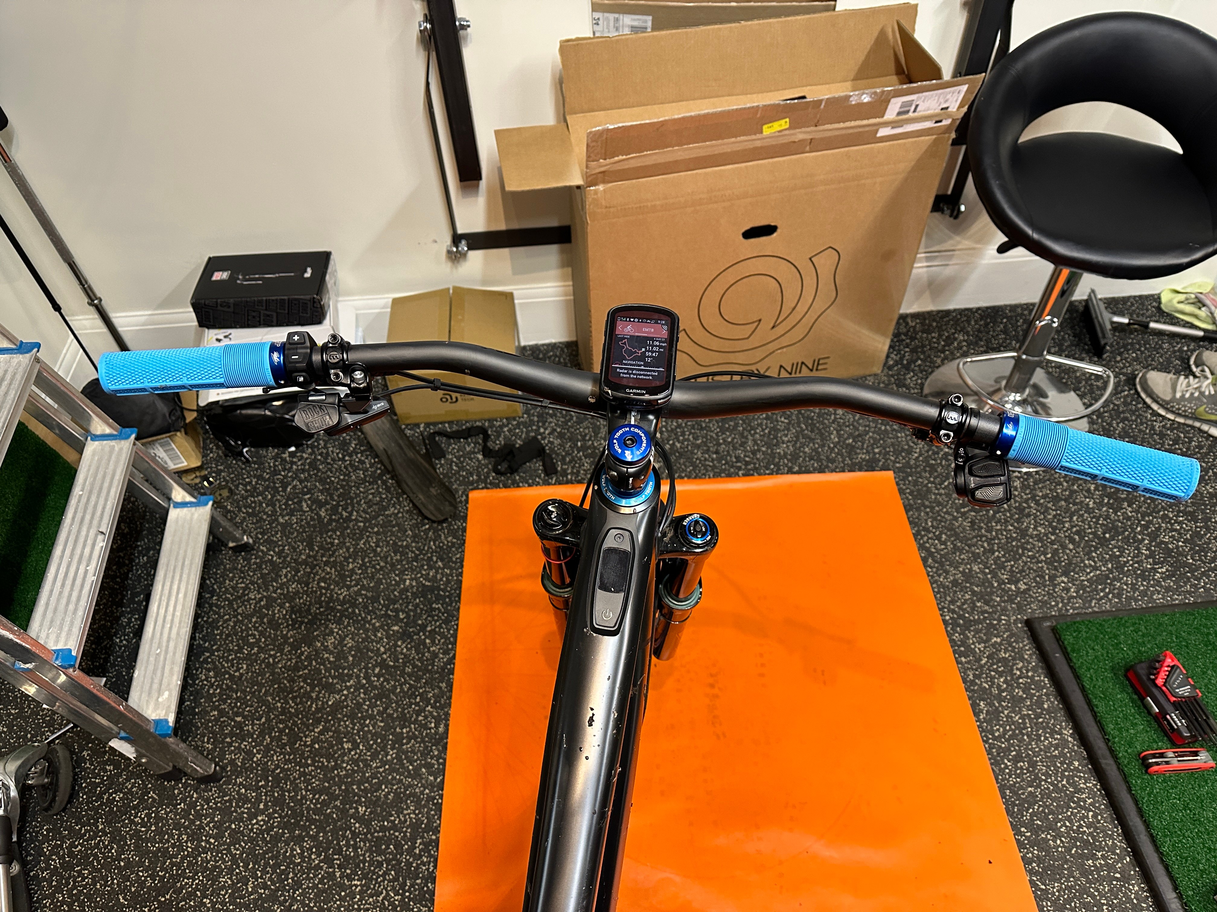

First ride with the SQ Labs X30’s today. I went for the 12deg back sweep 45mm rise.
Got the kids to bed, and went out at about 8.20pm. Only managed an hour / 11 miles / 800ft due to the lack of light… but my initial thoughts are very positive.
I had no pain or pins and needles on that ride, and felt I was able to hold the bar on the bumpy trails with less ‘gripping’ than previously. They don’t look nearly as wacky as I was expecting - and to be honest, the 45mm rise doesn’t look significantly more than the 23mm on my previous ENVE bars. I believe the ENVE bars are really stiff, so perhaps that’s something that wasn’t in their favour either?
Hoping to get out for a 20 mile / 2+ hour ride over the weekend to give them a real test, but after today I’m hopeful it’ll be £200 well spent 👍

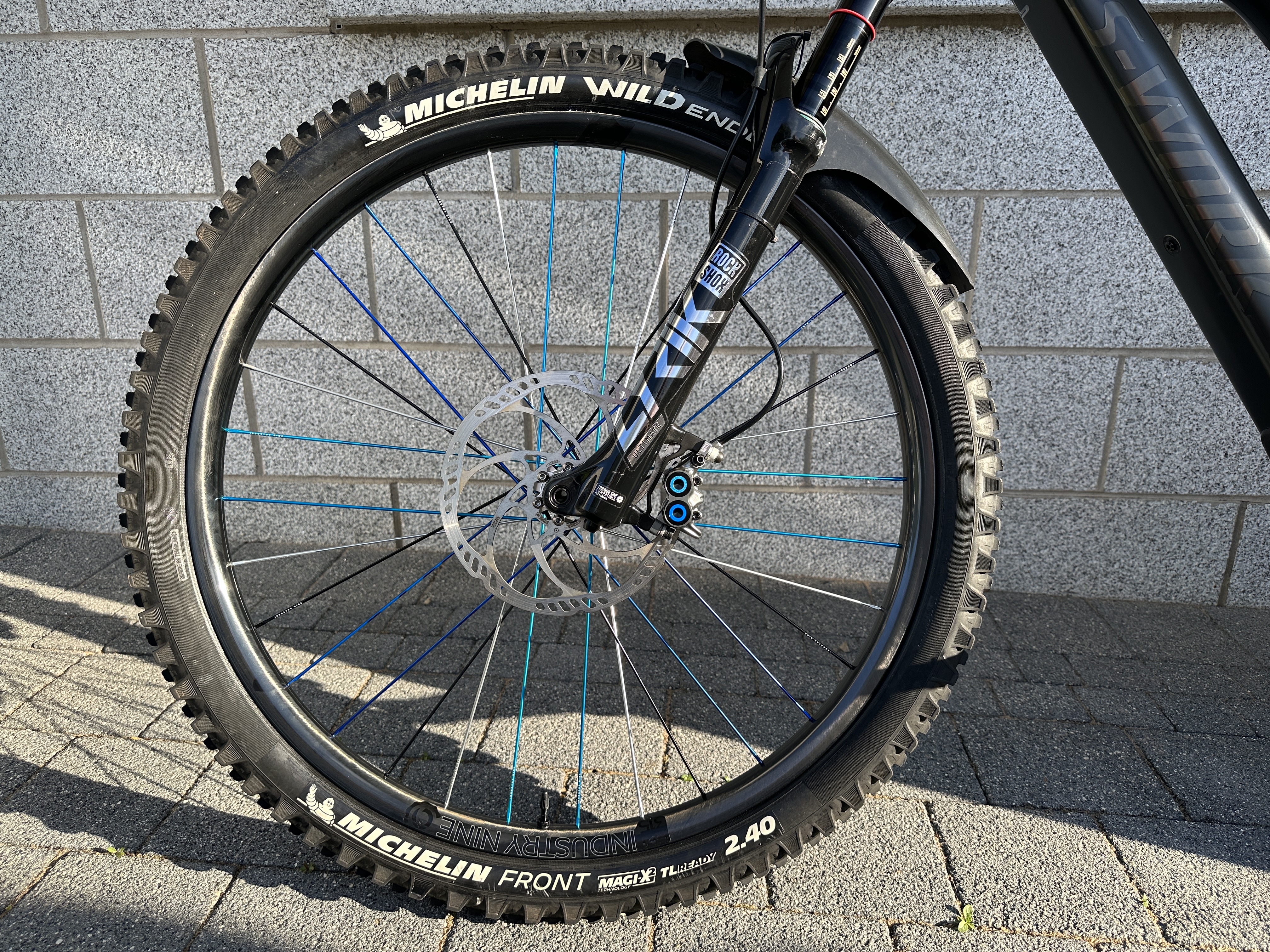

Much is explained -. All those blue bits were a sign - you were Subliminally aware the problem was circulation , not nerves. And the slightly higher head stem cover suggests you KNEW it was cervical outlet syndrome
Easy fix - buy red bits.
The slightly raised stem cover is only because that’s what came with the Wolftooth headset. It’s such a bad colour match with the bottom part of their headset, that I’ve ordered an i9 one (and some spacers) to try and get everything the same colour.
Never thought about the blue / red thing. I’m a Raynaud’s Syndrome sufferer… so I’ll have to look at some red bits for winter when I have perpetually cold hands!!
Might be an expensive project though… especially since I got these 😂😂🤷🏼‍♂️

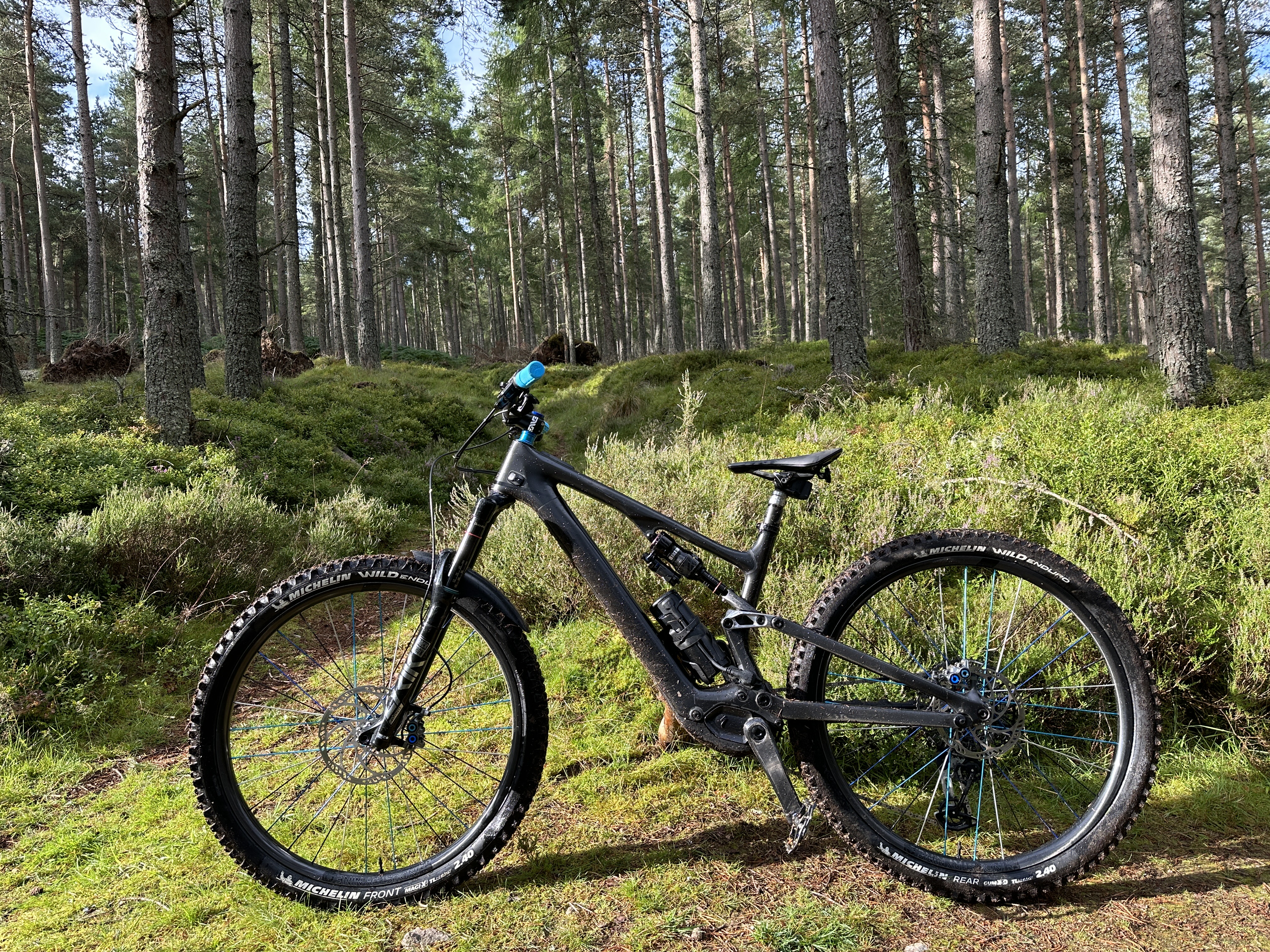

Another update - just back from a 20 mile / 3500ft / 2 hour and half hour ride.
No pain or pins and needles on that either. A couple of miles worth of ‘death gripping’, but the bars seem to be making all the difference.
