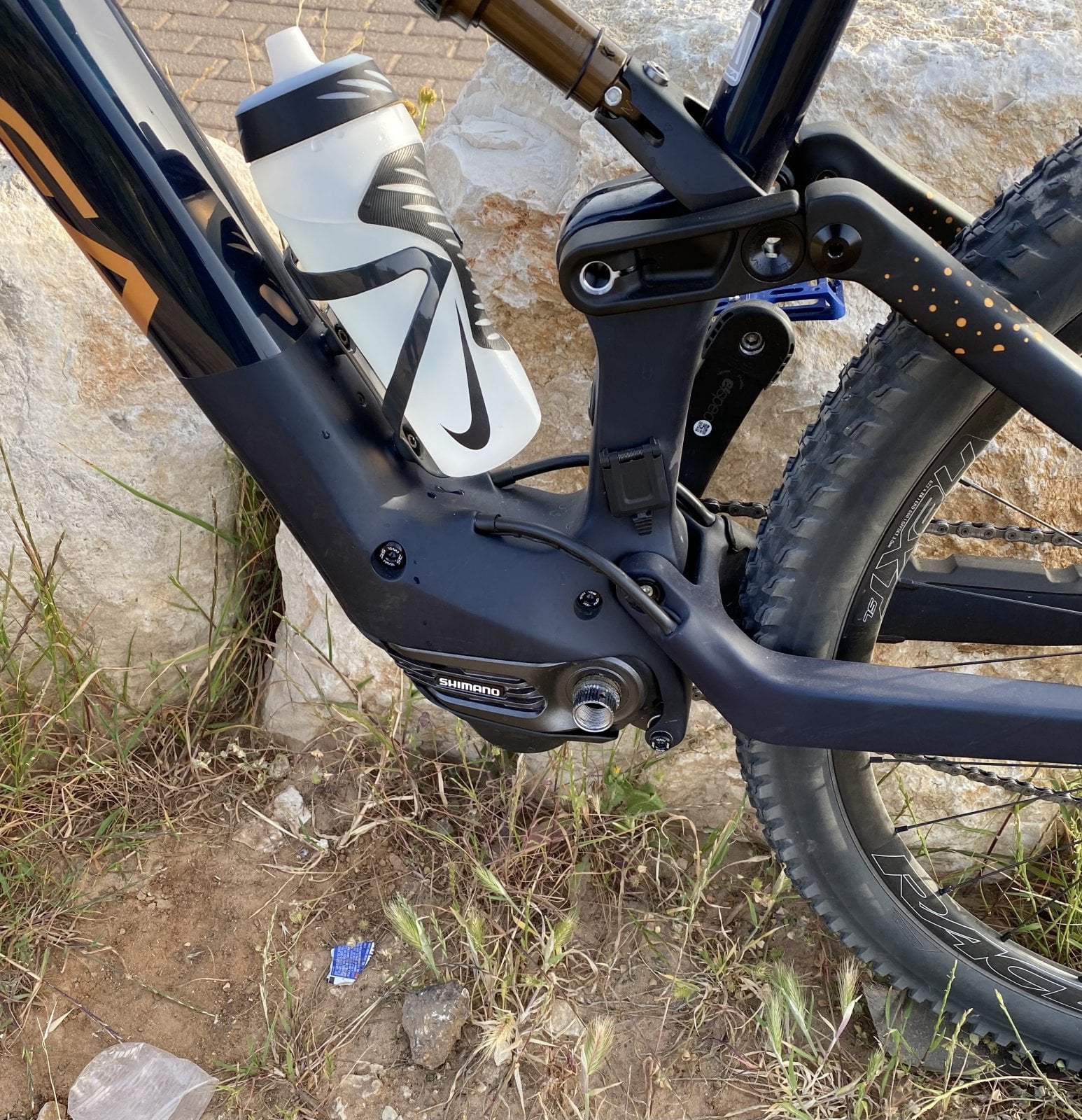

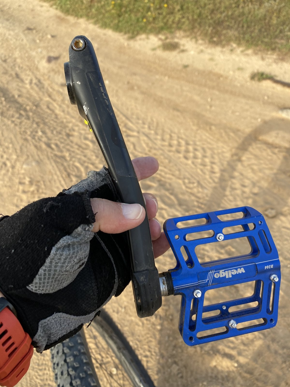

4 weeks ago me and my ridding friend received our brand new Orbea Rise M-LTD. What an excitement! A week later while ridding on a steep trail my left crank arm fell off, I lost the cap and luckily did not harm my self. Next morning I went to the shop where I bought the bike from and they in turn talked to Orbea in Spain to understand better the issue. Orbea recommendation were to use a 14 Nm torque and thread locker/ lock tite. Unfortunately they have not mentioned that other buyers had the same issue!!! Well enough two days later my friend had exactly the same issue; the left crank arm fell and the cap was-lost.

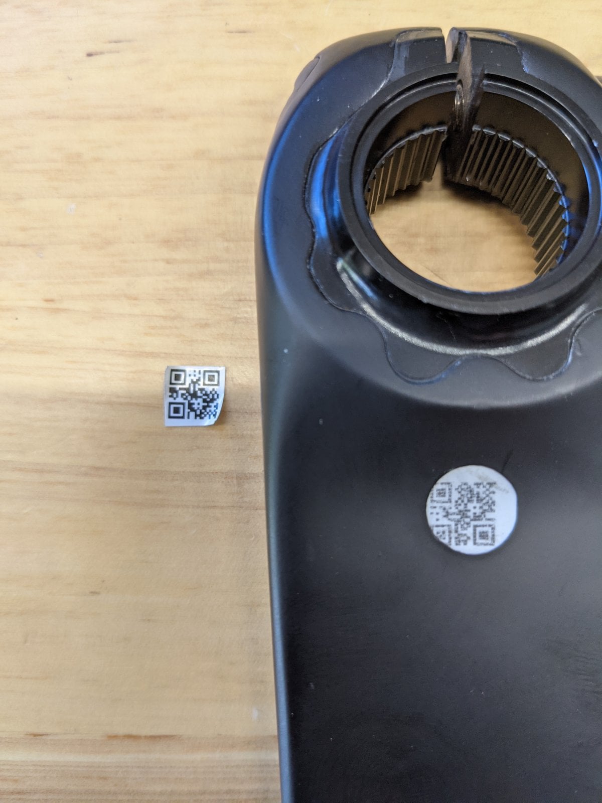

My cranks have QR codes embedded on them, but those codes just point to User Manuals – ethirteen support, which of course has no manual for these cranks.
One of my crank arms had a flimsy QR sticker placed over one of the embedded QR codes. Unfortunately it doesn't go anywhere :(
