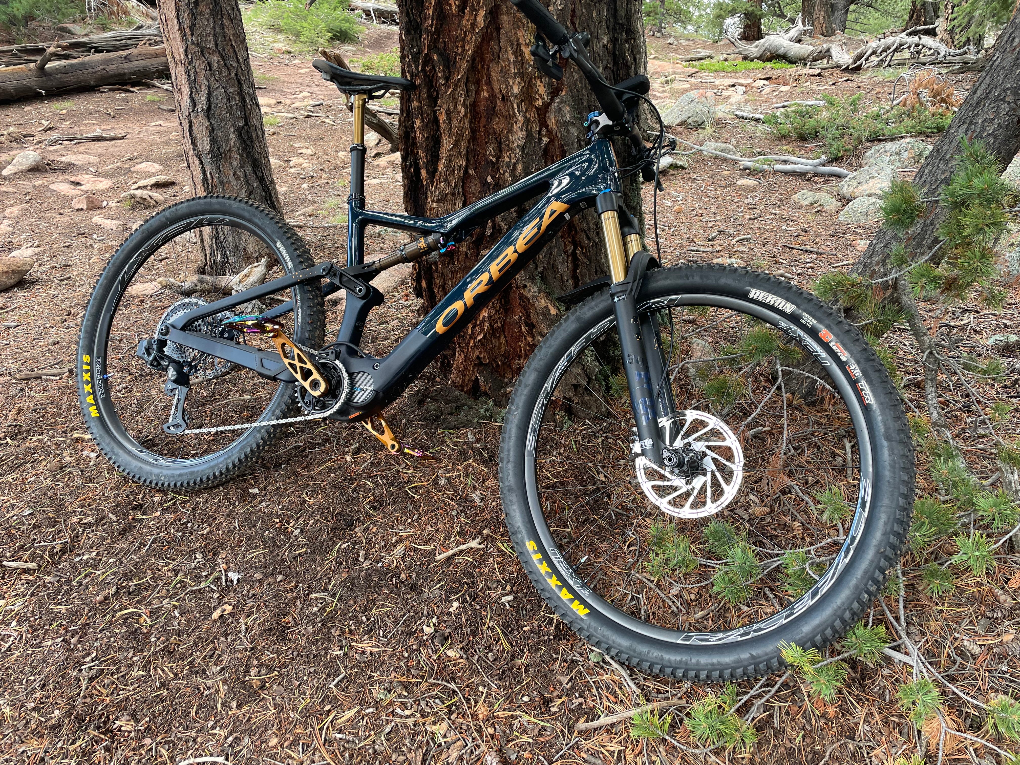

I’ve been using the 5DEV on my Rise for a little over a year. Installation was easy and I’ve had no problems or issues with them. I went with 160’s and it’s been great as far as reducing pedal strikes.
