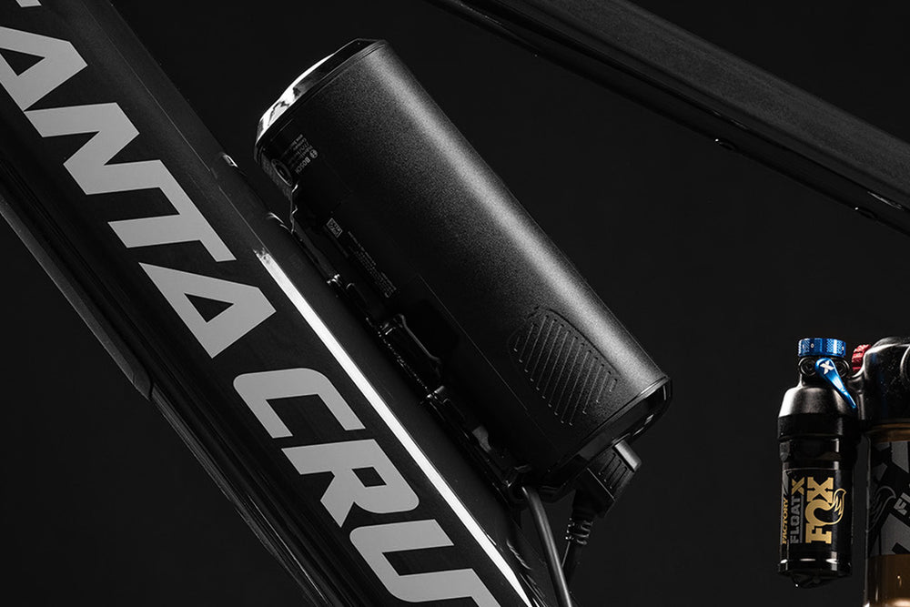

More of a Bosch question, but in regards to the range extender for the Vala, can it be plugged in once the main battery starts running low or does it need to plugged in from the beginning of the ride?
cykelk
May 15, 2023
180
227
Cascadia
Santa Cruz addresses this in the bike FAQ. It can be done but it’s recommended to run them together from the start, as bike will likely be short on power using the range extender with a depleted main battery.

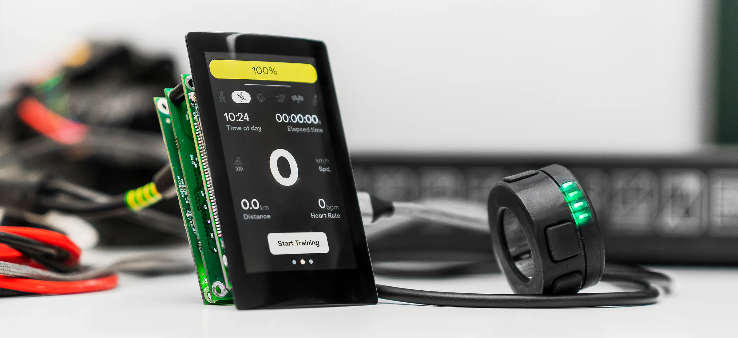

Interesting, it looks like a built in Android device now that’s running the Flow app. Curious how that will be to interact with since it’s much smaller than a phone and looks to rely on touch interactions instead a controller. You can see it in motion in one of Forestal’s IG reels here!
Same screen as the flow app,good idea to put it on the bike instead of looking at your phone.

Spy pics of the new Bosh screen, makes the DJI look really outdated.
So basically,they have put the flow app screen on to the bike,good idea i think.
