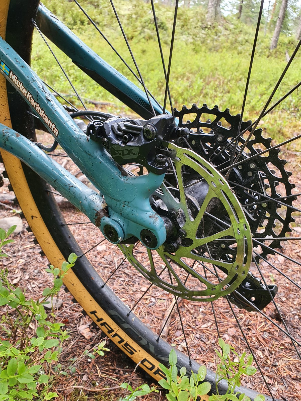

As for the brakes guide r 4 pot on my carbon comp when i first got the bike i was very underwhelmed by them very vague feeling and no bite at all! was going to swap them out but had a set of 203mm ice tec rotors front and rear so installed them, purchased a set of copper free pads from disco brakes (their top pads) and could not be happier with them now, had guide re on my 2018 levo carbon comp and they were good, and now the guide r are as good if not better! solid feel on the lever and nice bite point good modulation and can lock up at will. found the sram pads to be crap so try this first before swapping out might save some time and money.

pads without a doubt obviously the rear going to 203mm helps but as soon as i swapped out the pads the lever feel went from pulling nearly to the bar to the bite point half way and firm feeling can lock both wheels at will (i got disco brakes copper free their top pads very happy with them also have sintered both i can recommend).
