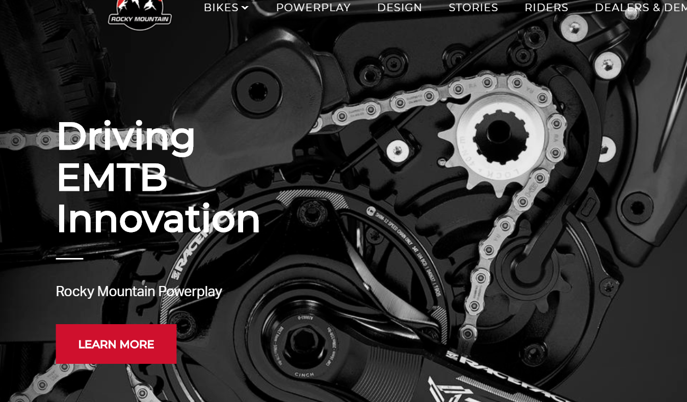

OK about to pull the pin on a 2019 Altitude C70. Looks like one of the last Large bikes left in Australia and reduced by $3000 AUD. Seems I cant justify a 2020 bike now especially with the redesign of the chain guide on the RM. A dealer told me today that RM went through 12 different designs before they settled on the one they are bringing in for the 2020 model and can be retrofitted to 2019.
New Guide
Any advice before I go ahead?

I see the 2020 have a bit larger battery and different chain setup.
The 672Wh battery should retro-fit the earlier models (if you ever need to), and only the top chain guide is different, which also can be fitted to earlier bikes. Personally I like the sound the chain and associated guides make. It's only when-on-the-power and gives an audible note of how hard the motor's working.
