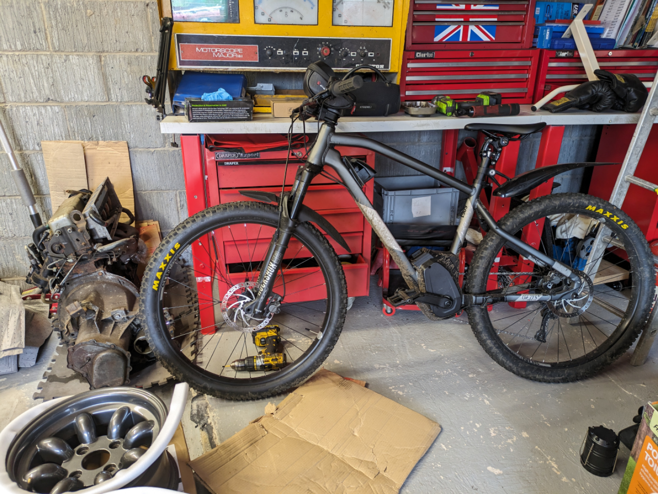

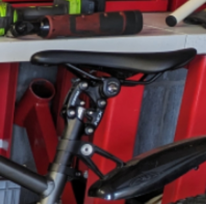

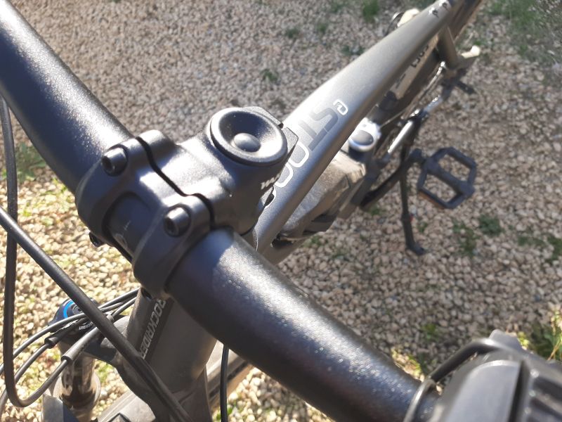

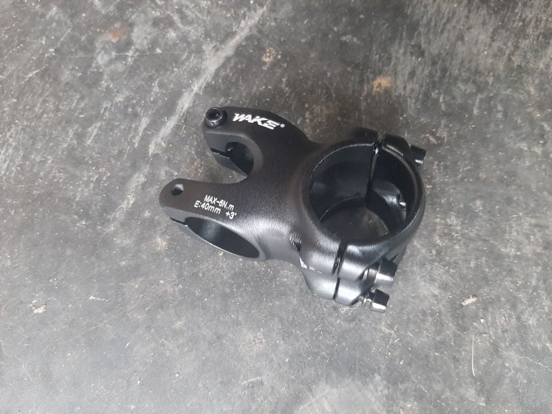

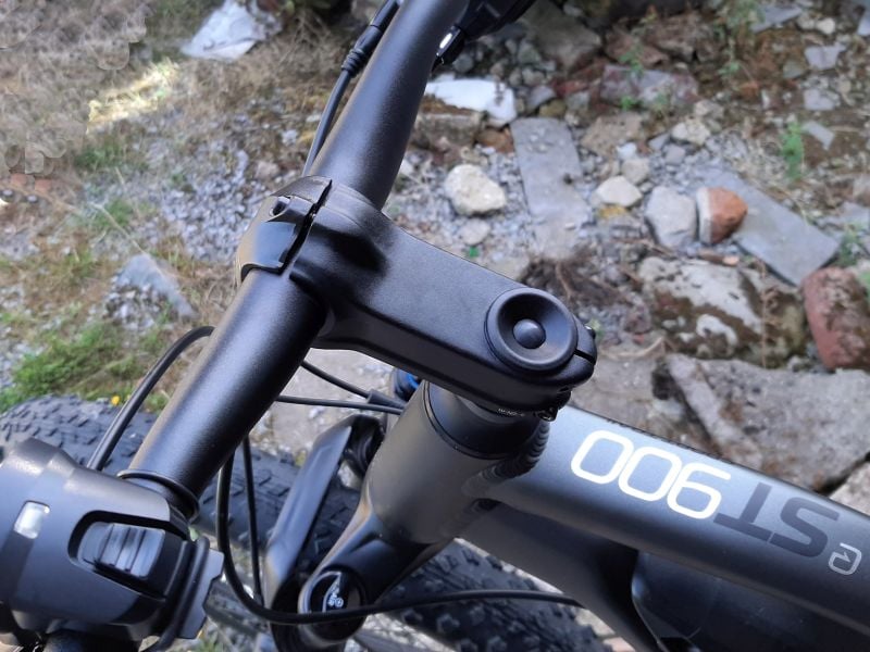

Been a couple of weeks now since I picked op the 900. Decathalon accepted the return of the 500 with barely a look and the money was refunded to my account the same day. Excellent service !
The only Mods I have done so far really are to replace the normal head to a raised version to suit my somewhat elderly situation.
The second being the fitting of the excellent Suntour NCX saddle suspension device.
My riding style although not Dick Danger ( or at my time of life, not even Danger Dick these days) is still quite sporty.
Did 28k yesterday over some rugged terrain and the suspension unit performed beautifully.
Best money spent so far !!
Trying to source a 38T Chainring now.
Ignore the lousy phone mount. Work in progress :)

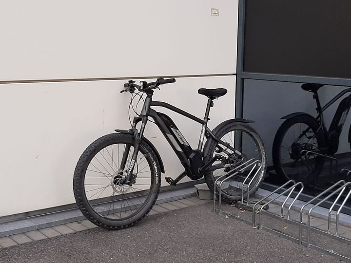

At it again !!!
This is sure to pixx off the purists !!
Fitted similar to my old Muddy Fox over 35 years ago and found the great when returning from a pretty heavy ride out.
Real relaxing just to cruise along in the breeze, with an almost straight back when the traffic on the Road or Cycle Path is quiet.
If I like them, then they remain. If not, it is only a case of 2 Allen Bolts !!
End Plugs not yet fitted until trial period is over.
Prob go for a better set of handgrips as well. Had to butcher the originals.
El G.

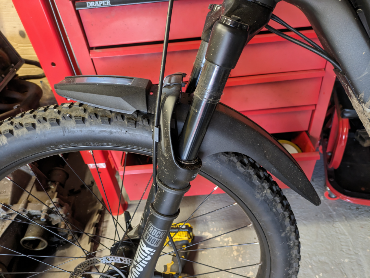

Hi,
how did the fenders last over time? I am thinking of buying this model as well but I'm not sure if I will be able to fix the fender for the front wheel in order to keep it steady. Could you post a picture of the setup detail please? Thank you!

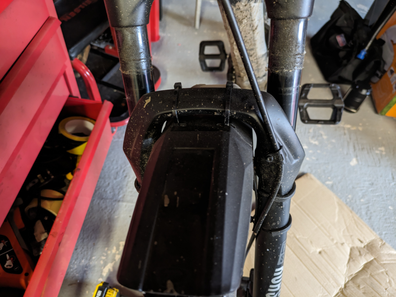

Have you considered a tie on front mudguard?
I have had a Zefal fitted for over 2 years now and it's been absolutely perfect. Very easy to fit. Would recommend :)
See the back spray/mud on my frame, which was from a very wet and muddy trail this weekend.
When I didn't have the mudguard fitted I found a lot of the spray was coming up onto my face. Now it doesn't.

Hi,
Still Ok, still as new.
The mounting is a metal bracket with one bolt.
At the back there is already a hole, in the front you will have to drill/tap a hole

In the front did you full drilled thru the middle triangle? (it seems no so thick)
