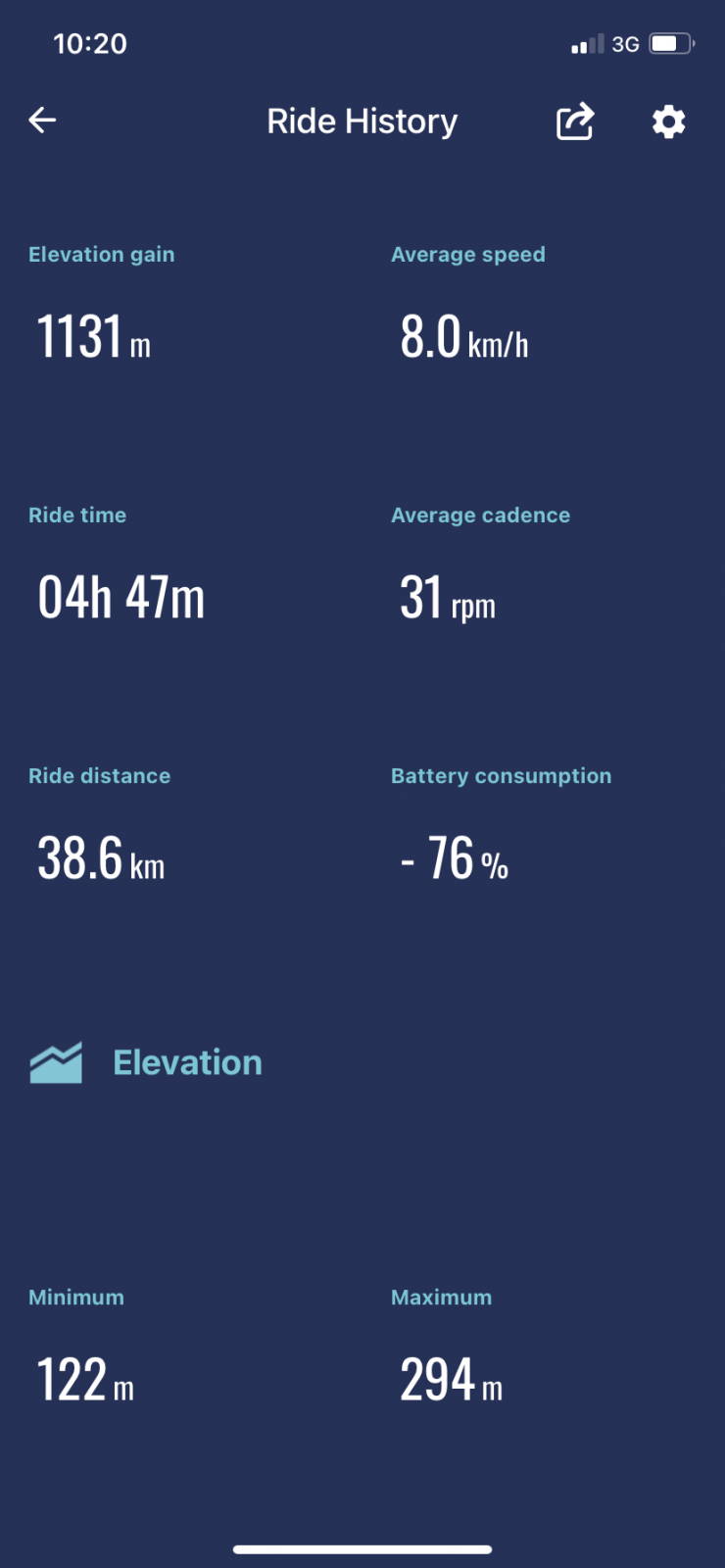

This is a ride I did in peaslake between Xmas and new year was probably about 8 degrees and was seriously wet and muddy. Most of the ride was mostly on the 2nd setting apart from the last 5 miles or so on the way back to the van.
I would say that is very good. On my analog bike I do maybe 25-30km and 400m elevation. Guessing range will not be an issue as I ride with non-ebike ppl :).
