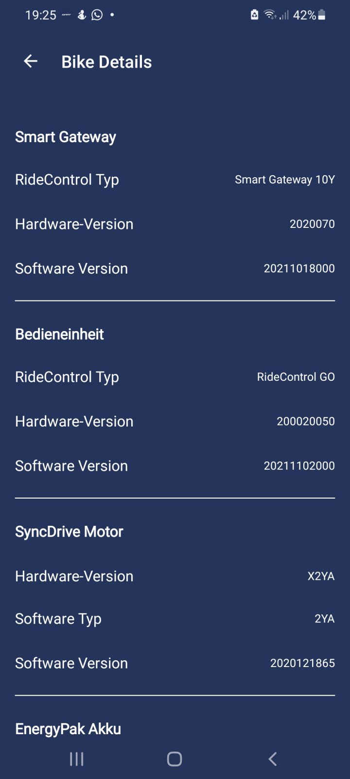

So guys. I didn't go to my shop to fix the problem in hope that I will be able to "click" through it myself and write how I did that. I managed to do it but the bad news is that I don't know what is the algorithm. I started and shut down the bike several times yesterday morning. After that I left it with battery inside and waited till the evening. I started playing around with switching on and off the bike, trying to change the motor power etc. Finally it just worked. So I don't know what exactly works. But it's the 2nd time clicking like a monkey and leaving the bike with battery inside worked.
My bike's details:
Smart Gateway:
  • Device type: Smart Gateway 10Y
  • Hardware version: 2020070
  • Software version: 20211018000
SyncDrive motor:
  • Hardware version: X2YA
  • Software model name: 2YA
  • Software version: 2020121865
EnergyPak battery:
  • Hardware version: 2021415815
  • Software version 24PF
Zero answer from Giant support till now.
