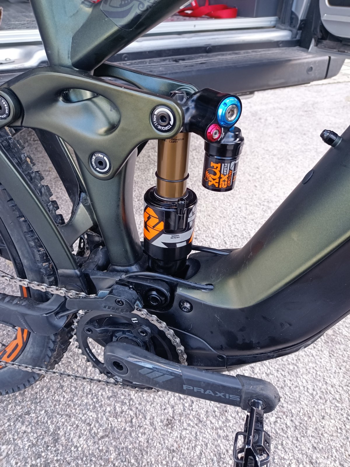

Barely fits and rubs on the shock at compression. No way a top-loader would fit as clearance is extremely tight, even with a 600ml sideloader, the shock is gonna rub a hole in it eventually.

whatever one they gave me (same thing, threw in a shop bottle and cage) has slots to position it up or down. tight fit, but easy enough to get the bottle in and out and avoid contact with the shock.
