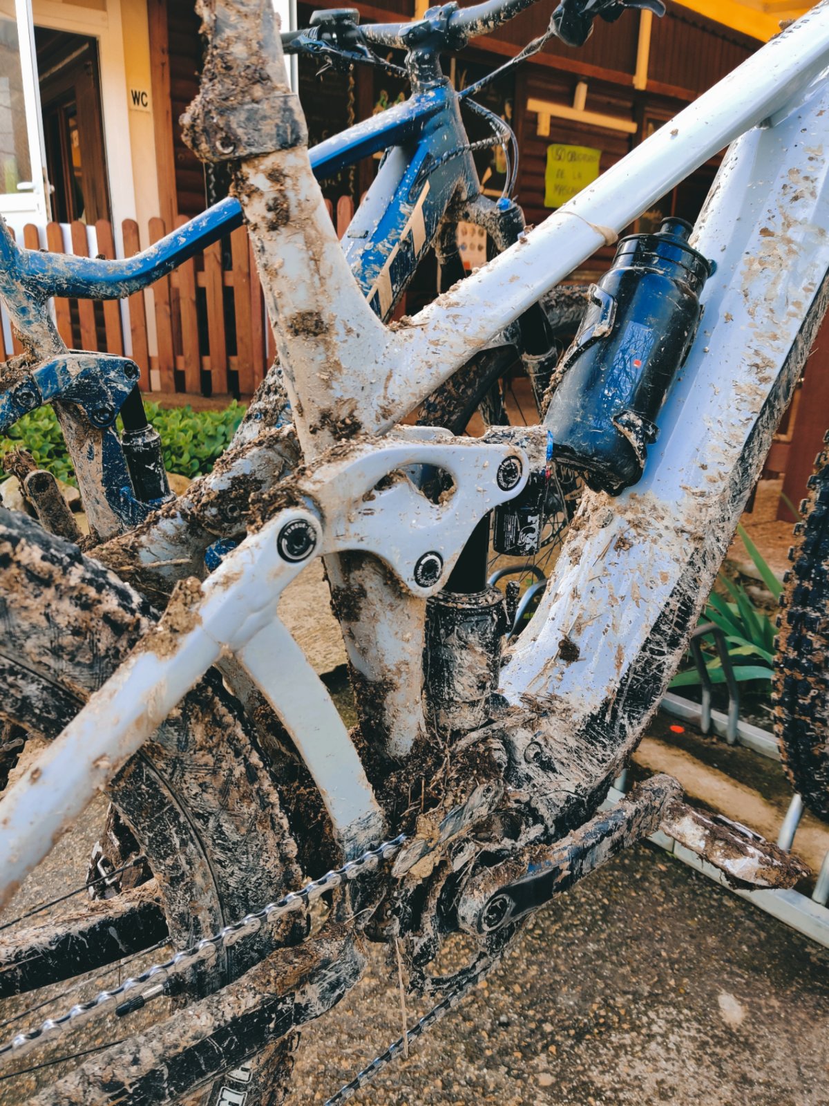

question: the shock rocker link is off center, asymmetric as it were. is this a design feature for the shock, or do i have a huge misalignment? i have no trail time as of yet so it's not like i can detect anything. looking down you can see it here:
DrStupid
Jul 10, 2019
1,464
2,129
Pleasureville Ky
This is normal. The entire shock and linkage is shifted left to provide more room for the chainring. Giant have been doing this for some time, even on old fashion pedal bikes.

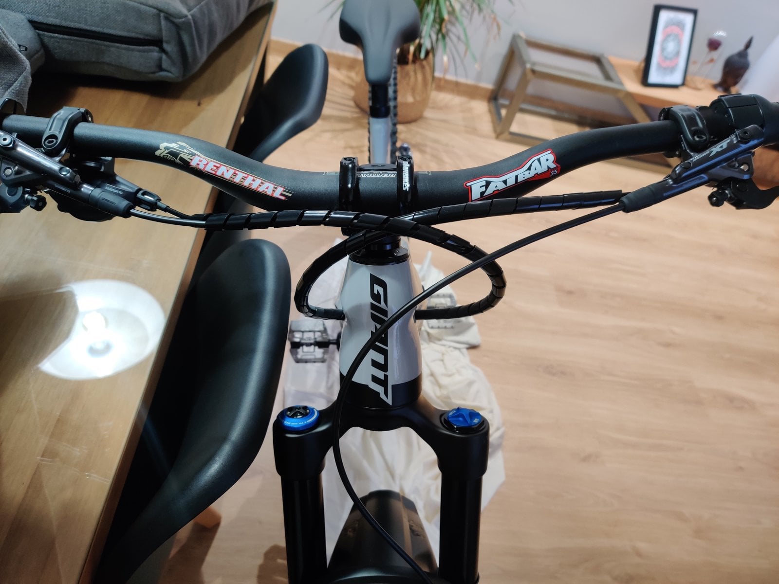

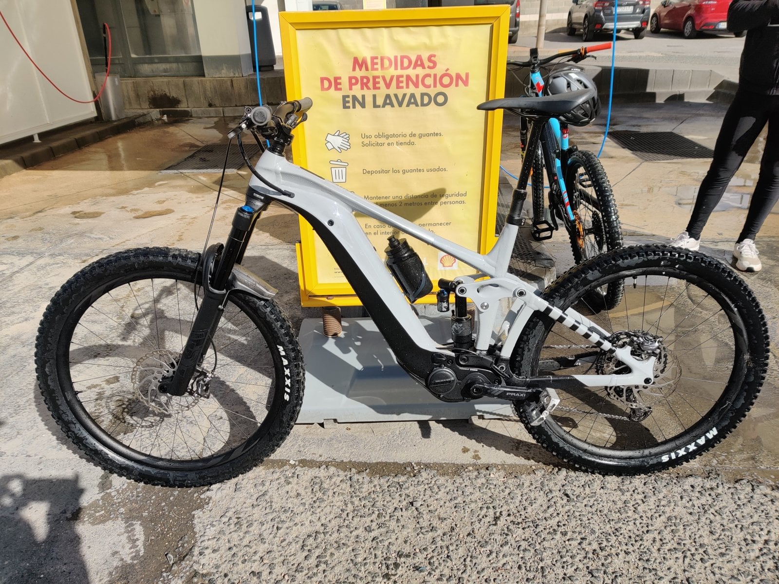

Hi, I leave you a mini review of the bike after 500Km with it.
Rider of 191cm and 88Kg.
Giant Reign e + 1 XL
Overall it is a very agile bike almost more than my previous muscular Giant Trance x 2021, I imagine due to the 27.5 at the rear. You immediately follow it, it gives you a lot of confidence on descents and it only asks you to release the brakes and float over obstacles. In technical climbs it will not be the best but nothing resists you either.

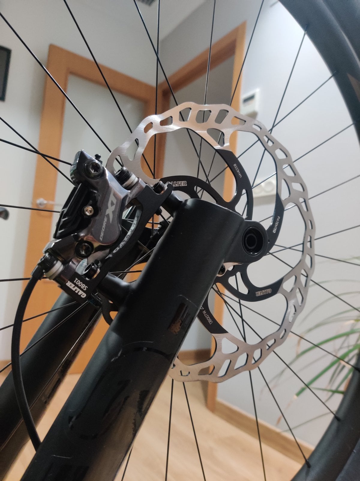

Brakes - They fell short, on long and demanding descents they ended up heating up and braking just enough. I have changed to Galfer discs and for the best moment, I have put the same one at the back and the 223mm and 2mm at front.
Suspensions - From factory adjusting only the SAG comes a little too plumb for my liking. A few rebound and compression settings and the bike becomes much more lively and agile. In the fork I added the token that comes.
Modes - I usually use only the first 3, the 4 and 5 is too much power and unnecessary battery consumption. Sometimes I use the AutoMode but is a little over power.
The first 3 modes are 75%, 100% and 150%. At 75 you go up any track effortlessly no matter how steep it may be, at 100 and 150 for technical trails up and down or descents.
Autonomy - I have done 37Km 1200m and I have left 18%, that if abusing to use 75%, the increase in consumption is very noticeable according to the mode and the terrain through which you climb. To do enduro more than enough.
Handlebar - I swapped the handlebar and stem for a Fatbar 30mm rise and 35mm stem. I already had them from before, I feel comfortable like that, that stem gives a lot of rigidity to the whole. It also becomes more agile, better to play down but worse in technical ups.
Wheels - I've already eaten the rear. I live in a rocky area and I like to go skidding but it was still very fast. I think that the house wheels seem to be made of another compound to lower the weights, I have changed to Magic Mary 2.4 superGravity Soft to see how they go.
FlipChip - In my area (Alicante Rockland) always in High, if you don't go hitting from stone to stone. It is a bike that even in High is the host of thrown and downhill. I'll keep Low for BikeParks.
Engine - Delivers power in a controlled manner. It is not very noisy but it does make a noise when "clutching" which is supposed to be normal but leaves you a little pissed off.
Like bugs Giant could fix
- The buttons of the remote control are too sensitive sometimes you touch it and change it without wanting or realizing it.
- The Walk assist is very poor and on steep steps you end up loading the bike earlier. It would not hurt if it could be configured as the modes. In addition, the central button + the top one is not very logical, his will be the central button + the bottom one, a more natural position when pushing up.
- Some water enters the battery hole, they are only drops and at the moment it has not failed, but it is difficult to see traces of water in that area. I also have to say that I got very muddy and went to the gas station to clean it up.
I am attaching a couple of photos, they are not new with all the changes, and a link to videos going down with it, to see if I do more filming and make a review type video.
