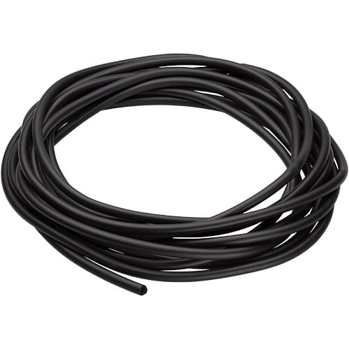

I used this on my Yeti build........... Works really well. Just be patient installing it! It is also a little spendy, but comes with enough to do several bikes.
Internal Housing Damper | Jagwire
