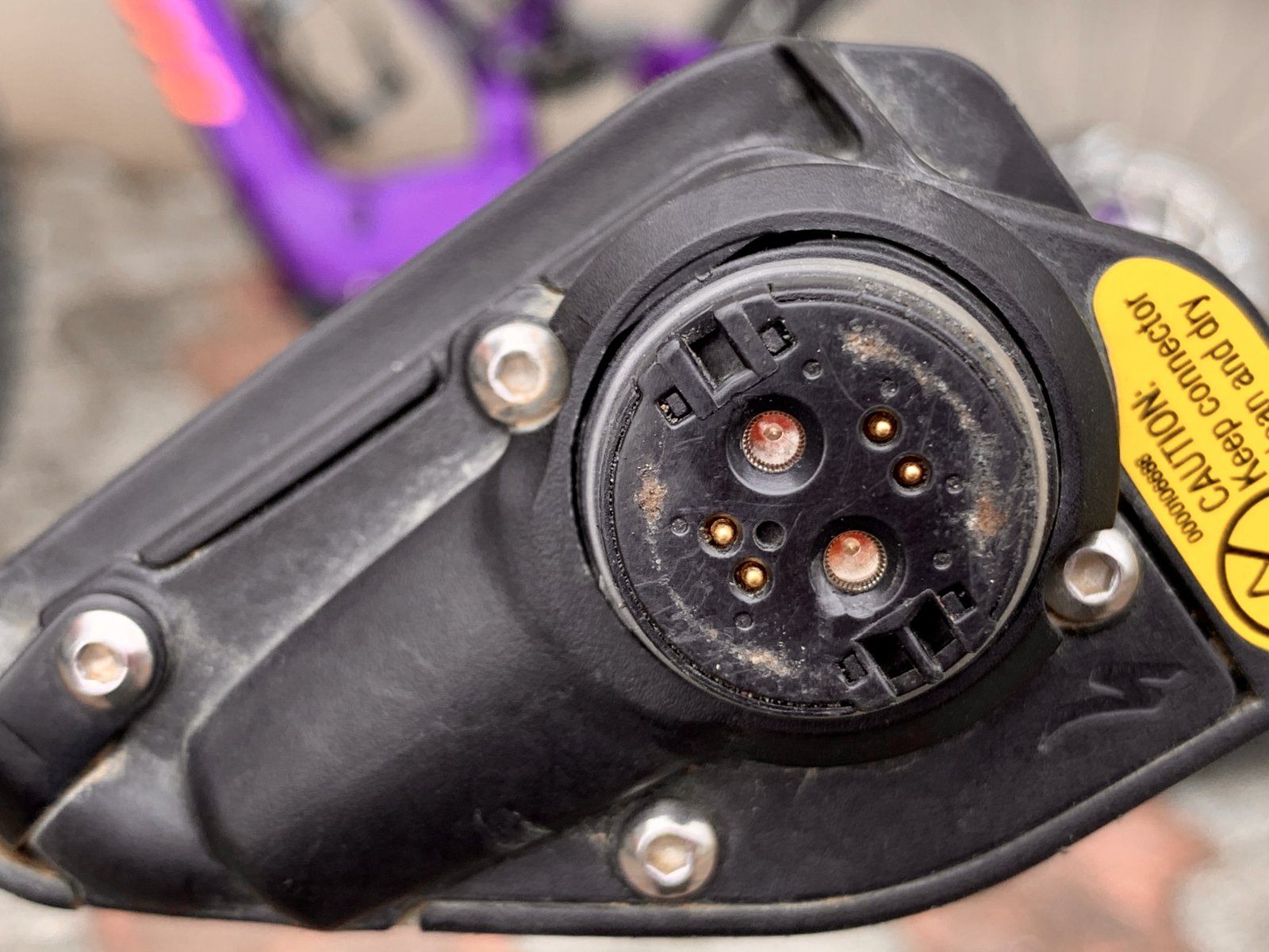

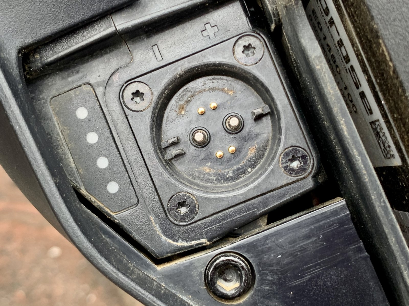

1) Water/grit in the battery charge connector. Usually happens when washing the bike with the cable disconnected (please don't!) - but if grit/dirt HAS got in to this area it may compromise the rubber seals or stop the connector fitting tightly. Solution is to dry the area and blow out any gunk with compressed air.
2) Water/grit in the Rosenberger connector. This has two possible effects that are quite different a) water causes a short between some of the 4 small pins - which are very sensitive and typically put the battery into protect mode (The four LEDs on the battery will flash in alternating pairs to indicate a short). It will get you home, but once you turn the bike off it won't turn on again until the short is resolved. b) grit in these sprung pins will prevent a good connection with the battery pins - most sensitive are the data pins. Visually inspect these and really gently depress the four sprung pins one at a time with a small flat-bladed screwdriver, clean with compressed air if they seem stuck (a small amount of contact cleaner won't hurt if in doubt).
3) Metal in this plug or socket is unhelpful - especially if it is magnetic it will stick to the socket and prevent the plug from fitting tightly. Check carefully as compressed air may not always remove metal. Small shards of metal are often on workshop floors - so don't rule this out.

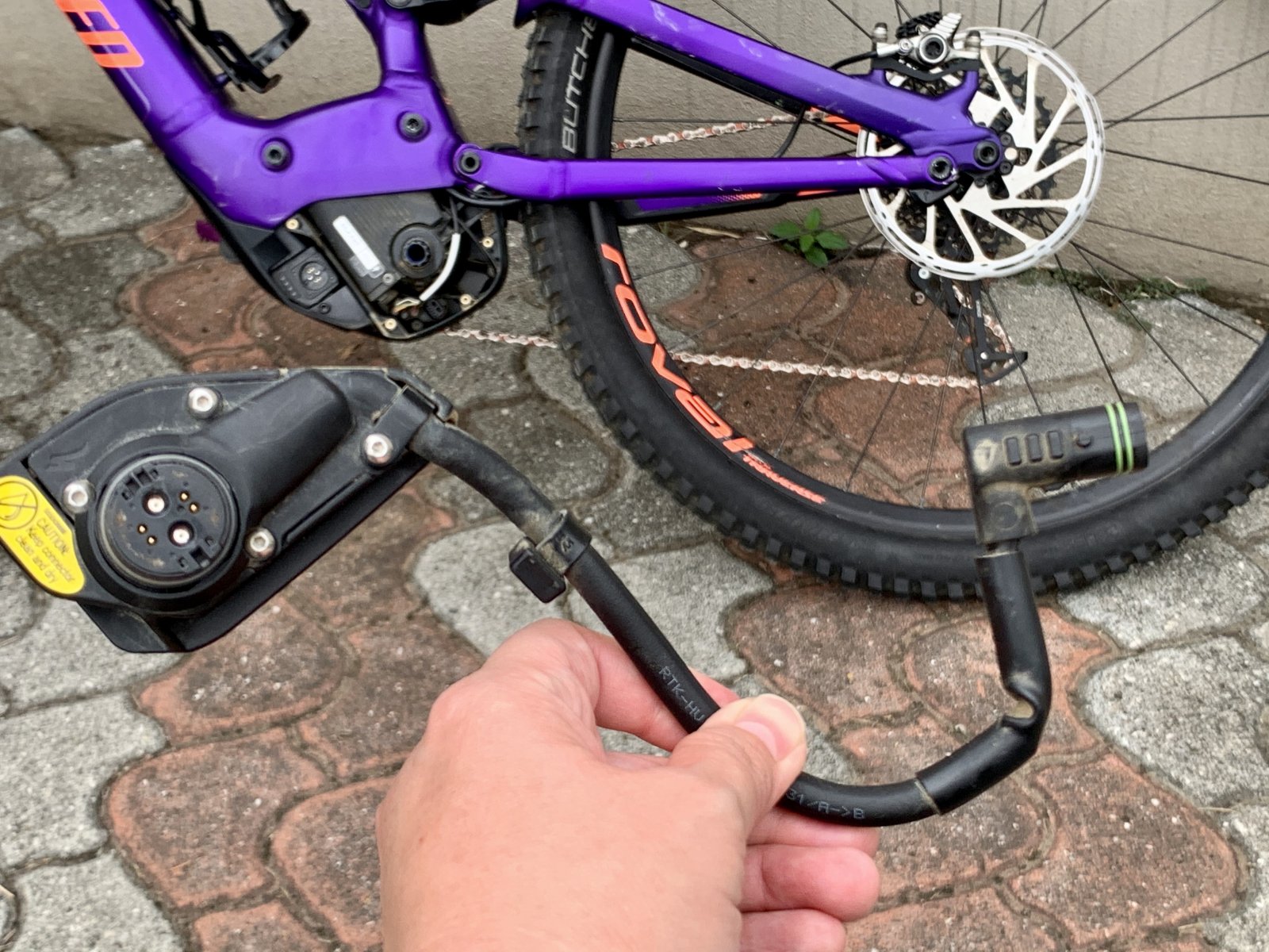

Hello @SpecializedRiderCare, tonight my Specialized Turbo Levo Comp 2019 stopped turning on, it doesn't make the beep sound, just faintly blinks once the red led on the TCU, and then nothing. I notice that the four LEDs on the battery flash as you mention on your post: "2) Water/grit in the Rosenberger connector. This has two possible effects that are quite different a) water causes a short between some of the 4 small pins - which are very sensitive and typically put the battery into protect mode (The four LEDs on the battery will flash in alternating pairs to indicate a short). It will get you home, but once you turn the bike off it won't turn on again until the short is resolved."
I have two exact Turbo Levo Comp 2019, so I was able to exchange batteries and TCU and nothing changed. In case that there was a short in the Rosenberger connector, what is the solution? I live in Ecuador, and I bought the bike in Miami, Florida.

Hi @Gabypb - really sorry to hear this. It does sound as though this cable could be your issue - but you'll need to find a retailer local to you to check the bike over. I'll send you a PM and let's see if we can find a retailer to help you out.

Agree with that. Swop the motor to battery cable and assuming that fixes your problem you could even see if you can do a repair on the cable whilst you wait for a new one. The usual failure on that older version of the cable is at the motor connection end which can crack and then allow water ingress.
Hello again,
These are today’s news. I changed the power cable and my Levo did turn on. Then I tried my Levo’s original power cable on the other Levo, and it worked as well, even though it hadn’t worked 15 minutes before on my Levo, today before doing the switch. Mission control app shows no alert on the motor or battery. Take a look at the power cable and the motor area, everything looks fine to me. ?

Sure, I’m going to try that today, last night it got too late, and I didn’t know what else to do.
If you find the cap at the motor end has cracked AND you have reason to believe there has been water ingress.....most probably after washing the bike....put it somewhere warm to dry out. Since each wire inside the cable has its own insulation any short will be where that insulation is stripped off to terminate in the cap....or within the cap. You may have to cut back the cap to effect a temp repair.

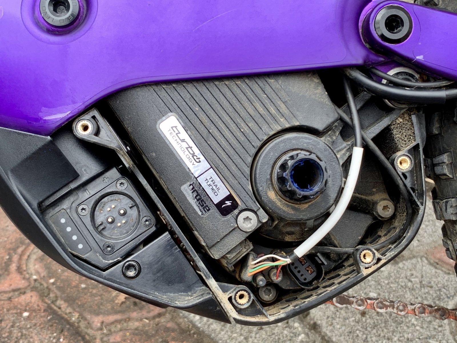

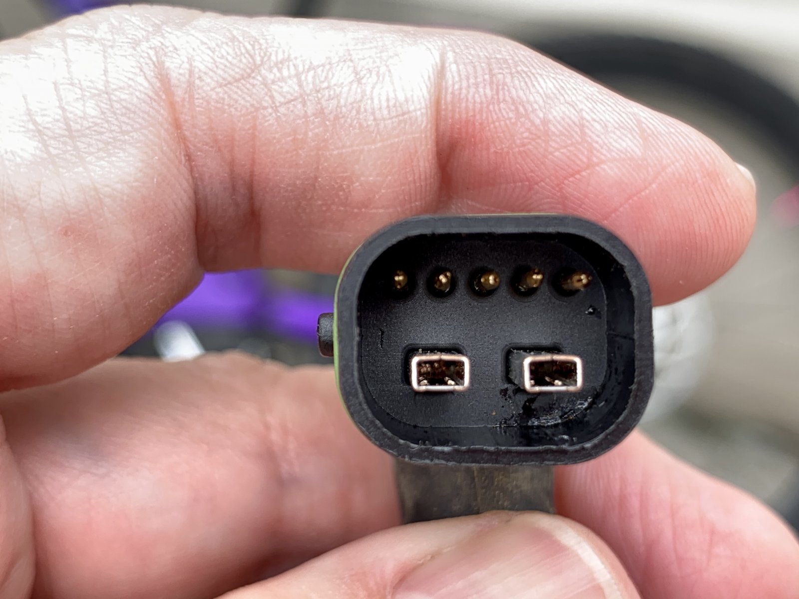

Take a look at the point where the cable enters the motor end plug. The cable sheath should be glued into the cap providing a waterproof seal. My bet is that is no longer the case. So its an easy temporary fix to wrap that entry point preferably with something like amalgamating tape.
That said your battery connection point and cable plug show signs of dirt ingress and because that connection is magnetic rather than male/female pin, it takes very little to create a short. I suggest you clean both with contact cleaner and when reassembling smear some lithium grease around the rubber "o" ring of the cable connection and the chamfered edge behind it.

The cracking of the connector at the motor end destroys the sealing of the cable just at point where the wires terminate. Typically that causes a short circuit either before the wires enter the plug or within the plug...or both. If (on a damaged cable) you cut the cap off, you can see that the 2 main power wires are stripped of insulation in order to terminate within the cap. If the cap is cracked and water gets in it is easy to see how a short across the 2 wires can be created or a short between one of the wires and the outer casing of the cable which in turn is in contact with the plastic motor cover etc. Just by removing/disturbing the cable you can remove the short...but only temporarily. The reason being that the cable moves and it that movement that causes the end cap to crack. The updated cable is more flexible at the motor cap end as well as being better sealed in order to address that problem. If you still have the old cable it is a simple job to copy the way in which the new cable has been modified....then you have a spare if you or , more likely, a mate that still has the old cable has a problem.

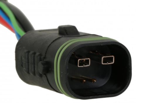

Hello Everybody,
Sorry to read all your cables issues on such expansive bikes :(:(
I'm struggling with similar issues on my Fantic - Brose S powered - bike.
The battery-to-drive cable has been replaced 3 times under warranty. But, still water ingress into the connector (drive side), locking the battery into protection mode (blinking display).
So, now, I plan to make the cable by myself.
But, I still need to identify the exact plug at motor side - see picture below...
Does anybody here knows exactly of what brand/model this plug is ?

Not sure you need to get a new cable...just seal the cable you have. The fundamental problem with the Levo version of the cable is that the individual wires are stripped just after they enter the cap in order to connect to the pins of the cap connector and there is nothing inside the cap to waterproof those connections. Waterproofing is solely dependent on the sheath covering the wires having a .....in my opinion...inadequate seal by being glued into the end of the cap. I do not know why the entire cap could not be wax filled but failing that the point at which the wires enter the cap must be better sealed. That applies to both ends of the cable.

Actually I don't have a cable from Specialized but from Fantic. And it's so poorly made, that nothing can improve it.
That's why I'm looking for the connector itself, to remake that end of the cable properly.

This look very close to what I’m looking for :)
My only concern is that they specify “ONLY EXTERNAL BATTERIES and MODEL T motor”, but I have a Brose S motor.
Additionally, I see there are more pins on the battery connector, than I have on my cable.
Anyway, I’m going to ask the vendor if it’s compatible.

Hi Tesph, any luck with making a new cable? My Fantic has just died after 40 miles! The motor end connector has cracked around one of the pins, it may be due to the cold as it was around freezing at the time.
