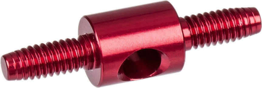

Such little bit is much helpful when pulling new housings/hoses trough the frame using old ones: RockShox Rock Shox Reverb Stealth Barb Connector - 00.6815.066.030

Just get a proper cable routing kit that has all the connectors and adapters. It's not like they're expensive. For example this one.

Well that amazon deal looks good. I ordered that reverb connector for $6 and if that doesn't work ill jump to the more elaborate kit. Thanks for the info everyone

Full kit looks good of you are installing from scratch, but you have the original in place, so the reverb connector looks good. Suggest you don't just try and pull the news cable through, but push/pull to take three strain off the connector.

I couldn't wait for the reverb barb and it wasn't that bad to complete the job without it. I tried taping the two cable housing pieces together but the hole in the rear triangle is so small it wouldn't pull through. I ended up just pushing the new cable through and then there is a nasty bend to get into the motor housing so I unbolted the lower bolts of the rear triangle to feed it easier and it went right in. From there the feed from the area behind the shock to the front of the triangle was easy and much larger of a space at the front so I just waded some tape around the two housing pieces and pulled it through the front. You definitely need to take the shock off and remove the three cable guide bolts and I would recommend taking off the front access port cover. From there it wasn't so bad.
