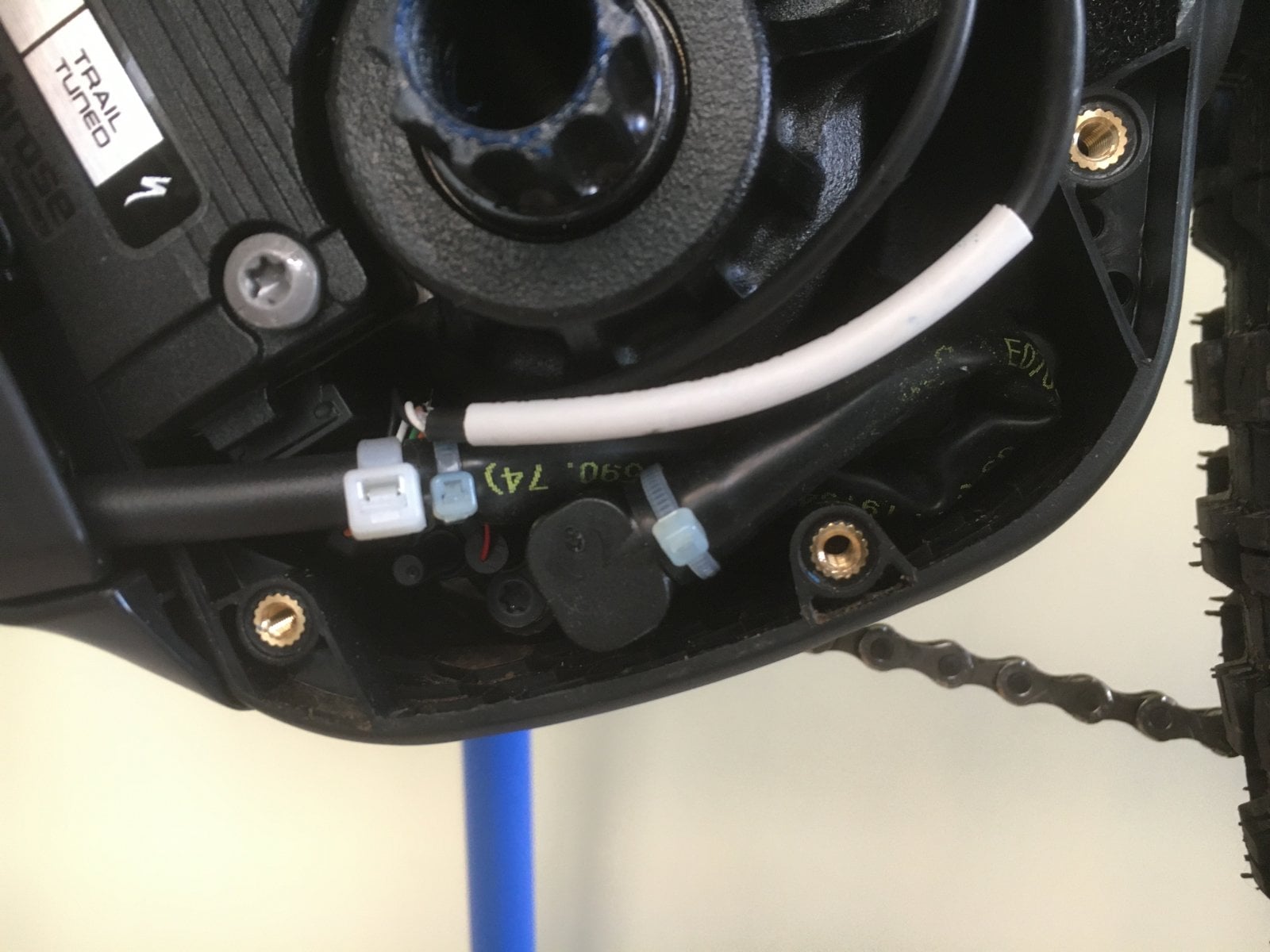

Finally had my free service yesterday, I'd asked them to supply a new cable, but they insisted on fitting it and sending the old one back to Specialised.
I had a look today, it is new, says version 3 on invoice, and its fitted as in the illustration posted. Hopefully there won't be any issues with it.

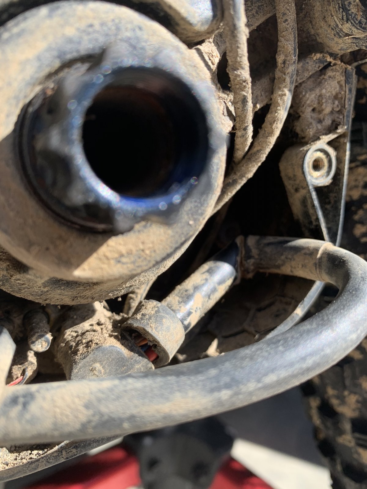

After yet another power cable failure on Saturday I had my second replacement power cable fitted to my 2019 (5 months old) Turbo Levo today by the lads at Pearce Cycles.
They fitted it with the new mark III cable, Spesh had sent them new cables to replace the older ones in all there current Levo stock.
My old one (mark II) had cracked again at the plug end where it attaches to the motor. Hopefully this new power cable does the trick, it definitely appears to fit better in the motor housing and requires less movement where it attaches to the battery.

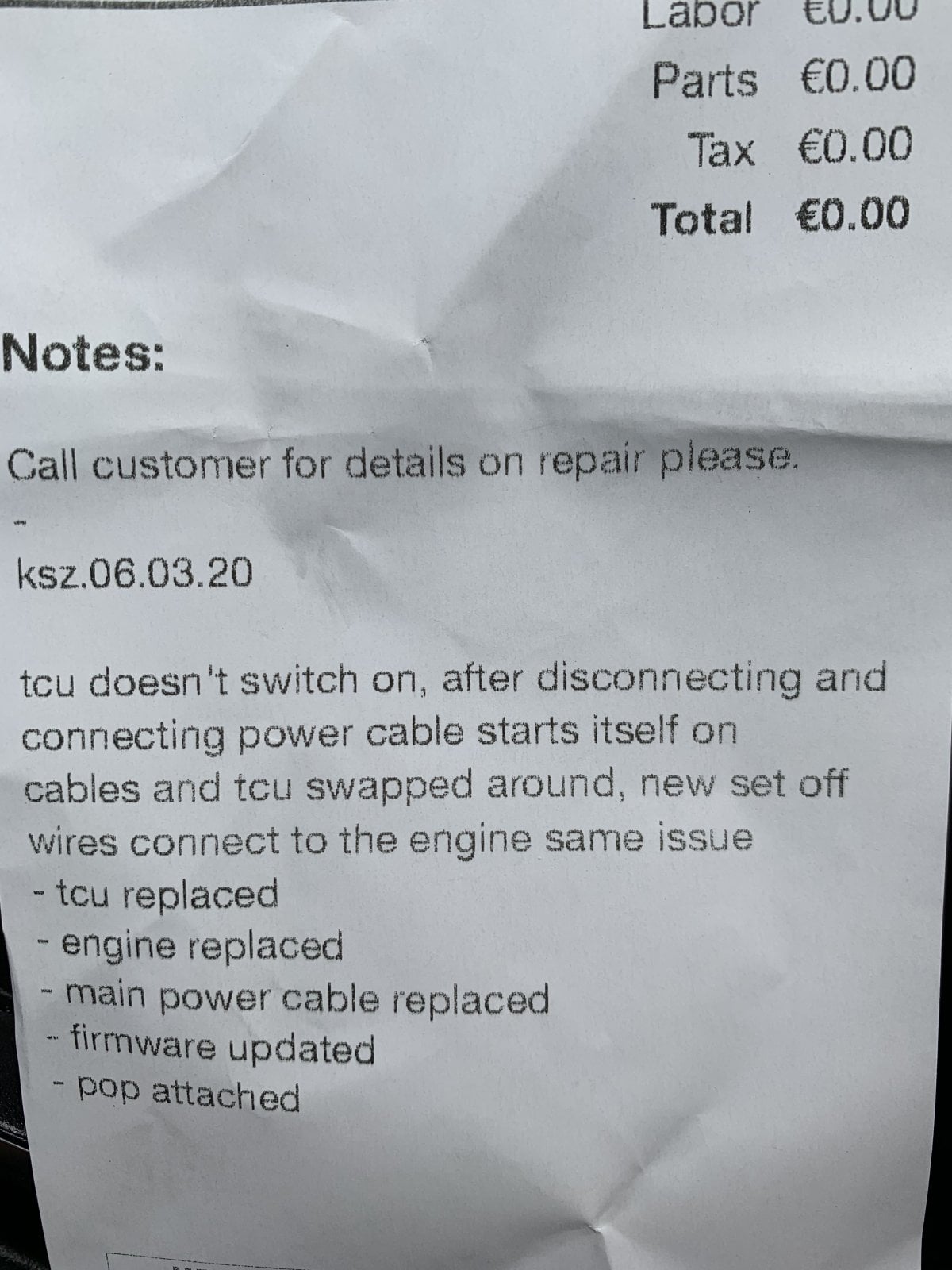

Well.....on Wednesday my 6 month old Levo finally suffered most of the faults featured in this thread! :mad:
The bike initially wouldn’t turn on. Cleaned sockets etc, to no avail.
Finally it turned on when I closed the battery plug.
Happy days! Was at a bike park doing pedal up......got to the top of the hill no problem. On the way down.....bike switched itself off.
Took some fiddling.....but eventually power was restored. It failed again heading down.
This went on for a while until eventually the bike wouldn’t turn on at all.
Throughout all this there was no visual indication of a fault at all!
Finished the morning & headed back dow to load up. Rang the local Specialized Shop & they said drop it in! While I was on the phone, the bike turned itself on showing the fault lights for “motor error”.
Dropped in at 1307 on the Wednesday.
They rang Friday to say bike was all fixed “come & get it!”
I picked it up today......I asked what they’d found & the guy on the desk said the mechanic had left notes for me......was not expecting all they did!! :oops:
Happy days! :cool:

Just had same on my 2019 levo. 5 months old, 300 miles. Put away after ride and wash (and always dry off). Got out and wouldn't turn on, faintest flash of light from tcu when pressed.
Took to local specialized dealer Tavs cycles, isle of wight Wednesday afternoon, they looked at it and let me know later in the day that some parts were being sent from specialized, called this afternoon to say all swapped and working. Superb service (albeit for something that shouldn't happen).
Asked what did when just collected it, they said replaced tcu and the main power lead! Asked to look at old lead and was same as others on here and cracked up on the 90bend on inside.
Will take side off at weekend to check got latest version of lead.

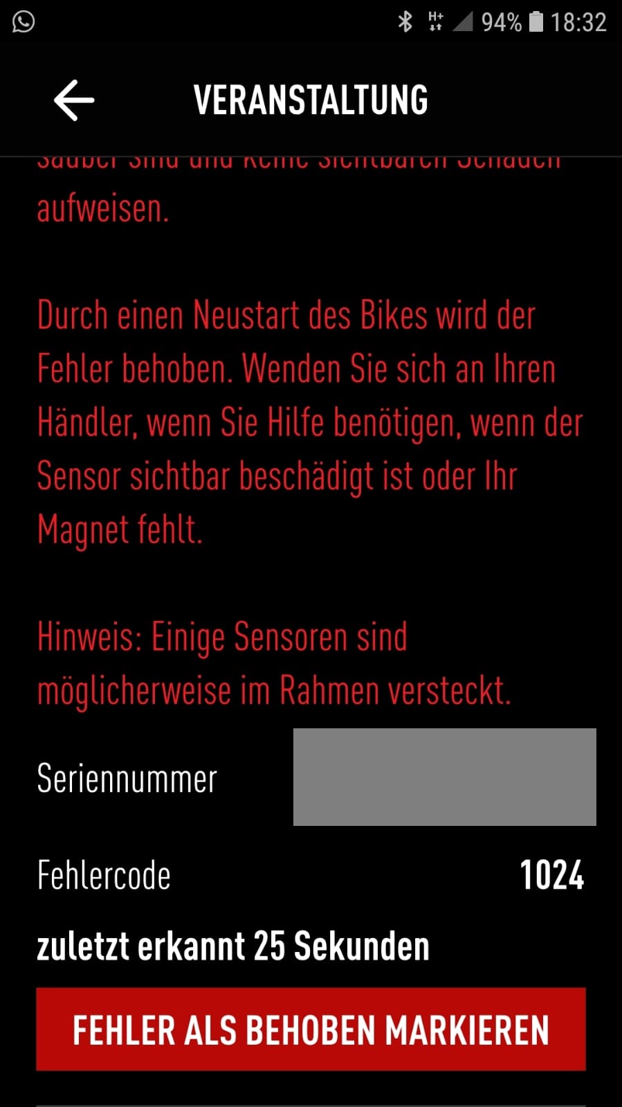

Lately I'm getting this error in MC (in combination with flashing leds), is this power cable failure related? I have never disconnected or charged the battery in less than 5 sec from switching off the TCU, honestly I'm not that fast :ROFLMAO:

But it does presumably mean that there is a poor battery connection so could be either the power cable or the cable connection to the battery. You do not say what year the bike is but if it has the older power cable it is a 5 minute job to remove the crank and motor cover to check it.

It is 2020 model bought in September so I guess it has v1 cable, the newest seems to be v3? Cable connection to the battery is clean, dry and without any damages.

Probably the v2 which tended to suffer damage at the motor plug end of the cable. Certainly worth checking

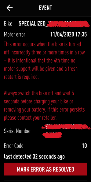

I posted this error message a few days ago, not had a response as yet.
I always wait at least 5 seconds before doing anything, but have to say I have not had any issues with the bike.
Not sure if its cable related, as mine now has the v3 cable
I marked the error as resolved and have not had the message since, or had any issues with the bike.

I have not seen any instruction like that in the manual but it makes sense that the Lan circuit needs a few seconds to shut down before the power source is switched off. The fact that it warns motor power will be removed and a reset required if the process is repeated is very similar in context to the Bosh gen 4 anti hacking script. Are these bikes hacked?
