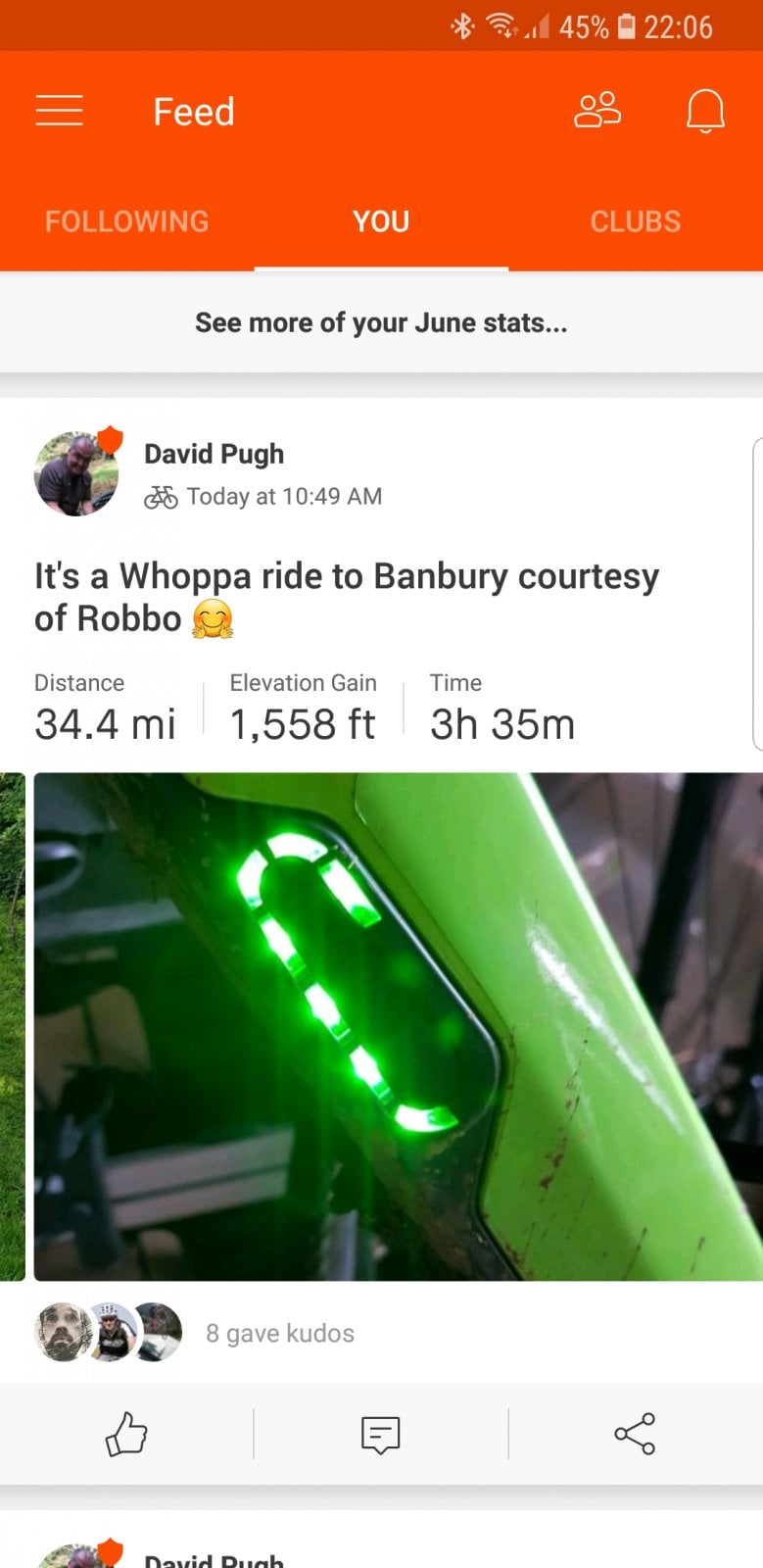

Hi all, did a long ride today mainly with the bike in ECO and only putting it into trail to help a friend get up a couple of hills - another good feature of a ebike ?
I used just under 30% battery in 34.4miles with 1550ft elevation. I am now wondering can you get 100miles range ?
The ride was about 90% off-road with ECO set to 5% and trail set to 50%.

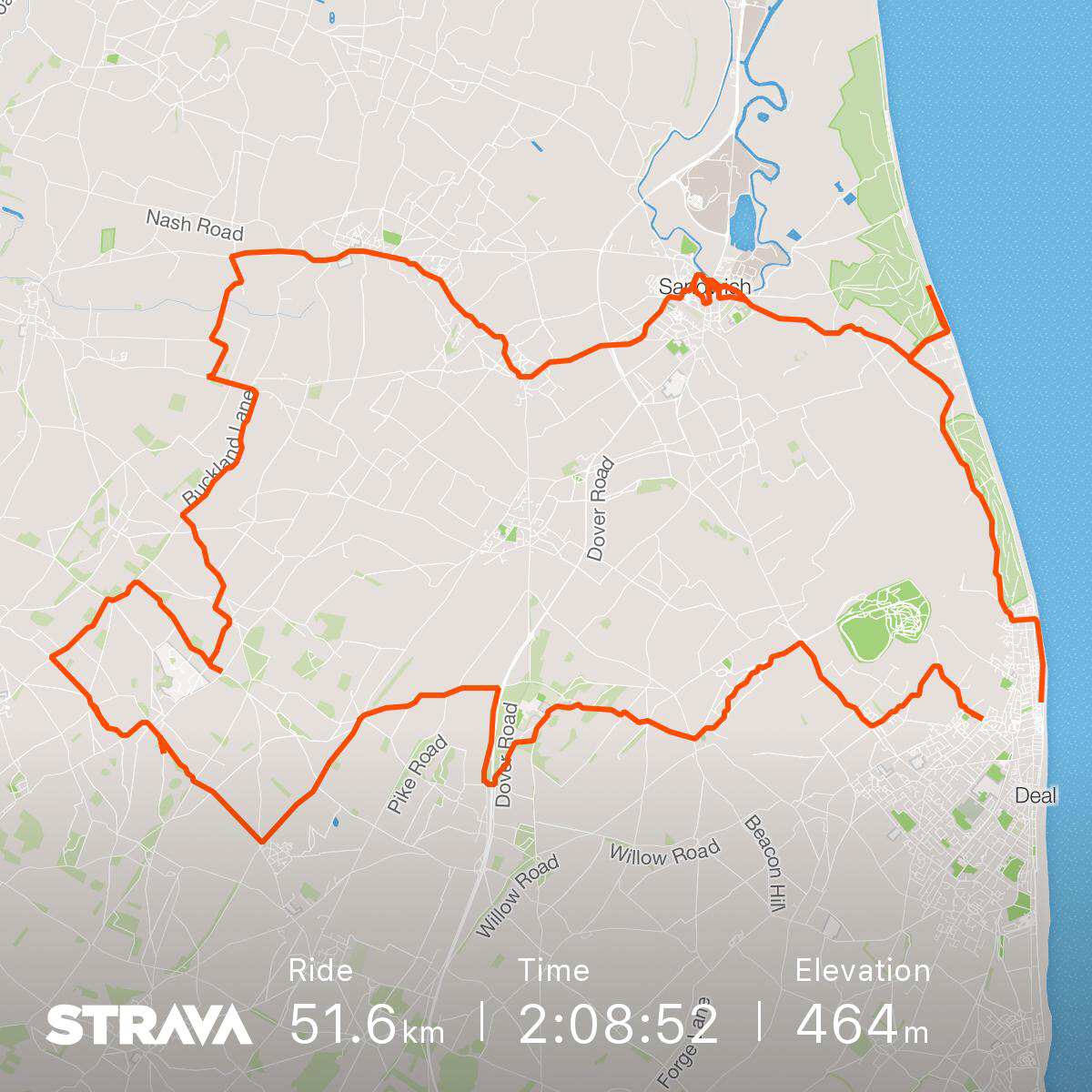

Cyclejunkie
Mar 27, 2018
140
97
Deal Kent
Totally agree that fitness is a HUGE contribution to range extension. The beauty of the emtb is you can train and improve your fitness without killing yourself on the uphills like on a regular mtn bike. Finding that the more I ride the fitter I become and the bigger the range is because of using less assistance:).
Totally agree dude
