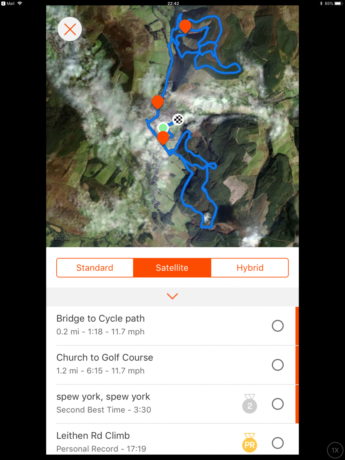

Not sure of the names of the trails used , there were 3 on the golfie side , you’ll be able to see where they crossed the fire road and easily follow the track to the top , all three went up past a huge old concrete enclosure with a hole blown in the side , what was that ? Reservoir ?
Sections one and two were off to the right side at the concrete enclosure and section 3 was to the left over the hilltop and ended along from the golf club .
There was 2 sections used on the other side The final section was used for seeding you’ll see how that ran into the car park as an arena finish . I think the stages held up well , they were drying through Sunday which helped a bit but Friday and saturday they were very slippery and wet . I think about one in 5 came out section 5 in seeding with a blown tyre or busted gears etc
This is a pic from my daughters strava
