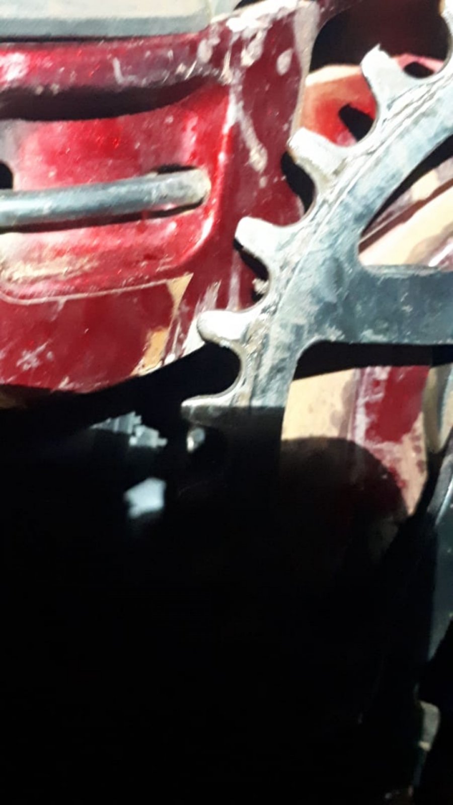

My chainring is touching chainstay. I don't know in what circunstances. The chainring is perfect. Can be a warranty case? Is too close that i think is causing on torcion, like berms, jumps... I need help. What i have to do?

What size frame? Is that the standard 34T chainring? Mine is very close to the chainstay also but that is ridiculous...?

Sim 34T

A única coisa que consigo pensar é que ele foi retirado e colocado de volta para que o compensador (prato) fique do lado errado?
[/ CITAR]
o deslocamento é 0 and never was removed.

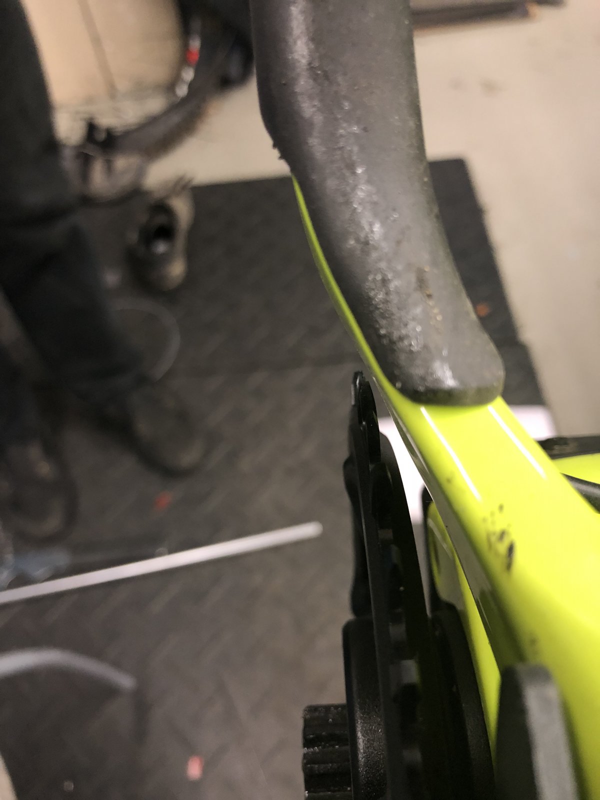

is the stock e13 the aluminum or steel version?
I tried fitting a 36t Aluminum e13 ring to my 9.7 XL, but it was way to close for comfort, see pic below. I could pretty much push the ring into the stay.
The trek website says the 9.7 comes with a sram 36T, but it is in fact 34T.

I don't know how and when this happened. When you are pedaling, the chainring has more space.

Don't know the frame - possible I guess. I've had a few frames where the rear tyre would buzz the seatstay when it flexed. Can you flex the rear triangle and recreate the issue?

I was thinking about torcion of aluminum frame. I am a heavy guy. 94kg.
I wouldn't say 94kg is heavy. I'm a similar weight. I think the frame of the Rail is pretty strong, but have you been hitting huge jumps? Is it possible you've bent the chain stays slightly?

Yes, i like to jump, but not so big. 2 meters high. I paited the place with nail paint. Lets see if happen again.

I make this, but i cant recriate the torcion of berm or jumps.
