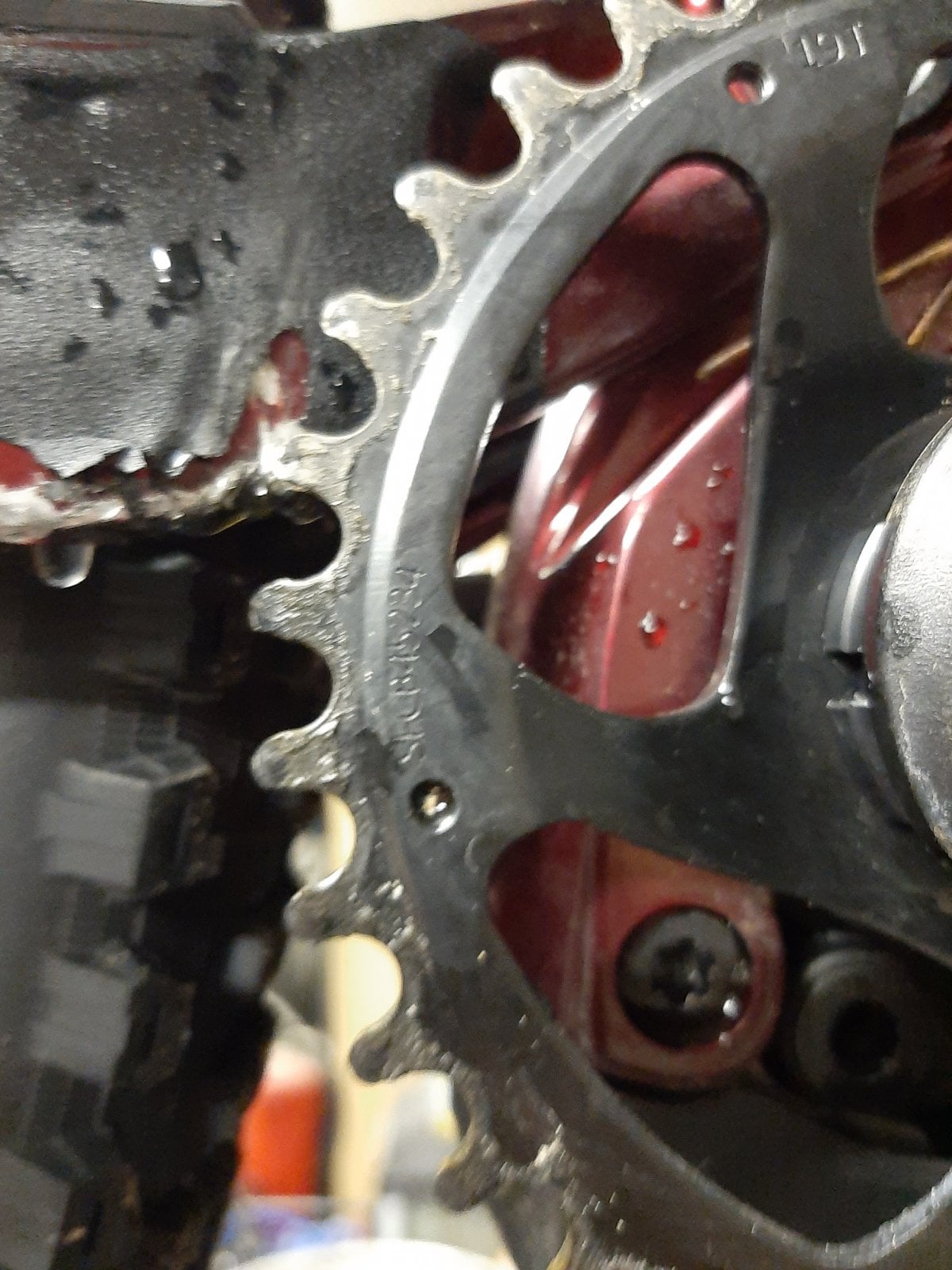

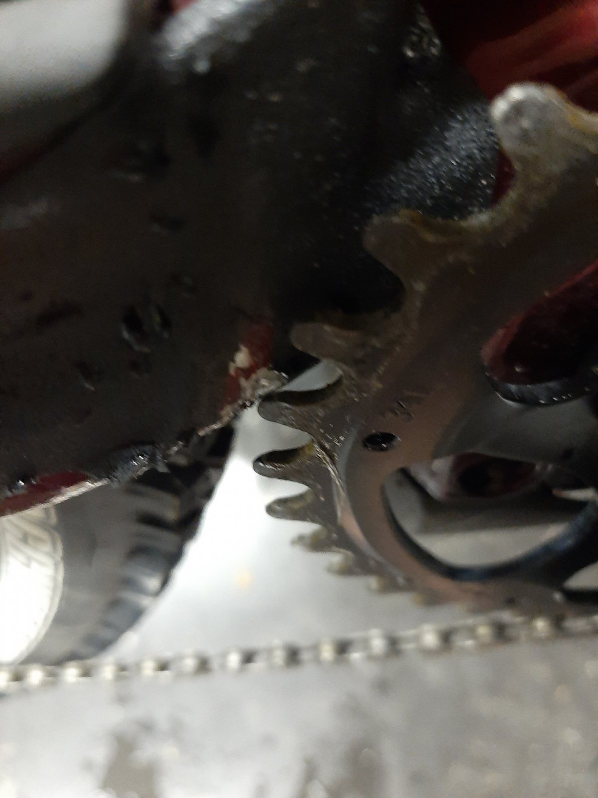

Guys, just rode my third trail with my “almost” new 300 kms rail 9.8 and got the same scratch on the chainstay... have you came to any conclusion? Here in Brazil the fix will be touching up the scratches and “find out” what is happening... seems they are pretty lost...

Ive checked the torque on the main pivot and it was loose. The wrench moved half a turn to reach 30Nm. After torquing it, the chainstay remained alarmingly close to the chainring. And when a say close, I men less (much less) then a mm close. The motor seems to be firm on the frame and the most obvious bolts seemed correctly torqued. Very disappointed with the bike with such low mileage and such right price with such annoying problems.

It does seem that certain configurations of this bike have the chain ring very close. I do wonder if the rub comes from the rear triangle flexing against the chain stay because the pivot axle is loose. If you managed half I turn, follow @Mikerb advice at the top of the page and set it properly, otherwise it will happen again and lead to more mess....

It is pretty strange though... the flexing would occur, at least in theory, when you charge it. And when you do it and the rear shocks compresses, the clearance increases... the thing is close when there is no weight what so ever on the bike. Tomorrow it will go to my LBS, But i have to say that Im pretty pessimistic, since you guys are still dealing with the problem where the thing is manufactured...I’ll check the tread you mentioned. Keep us posted, please.

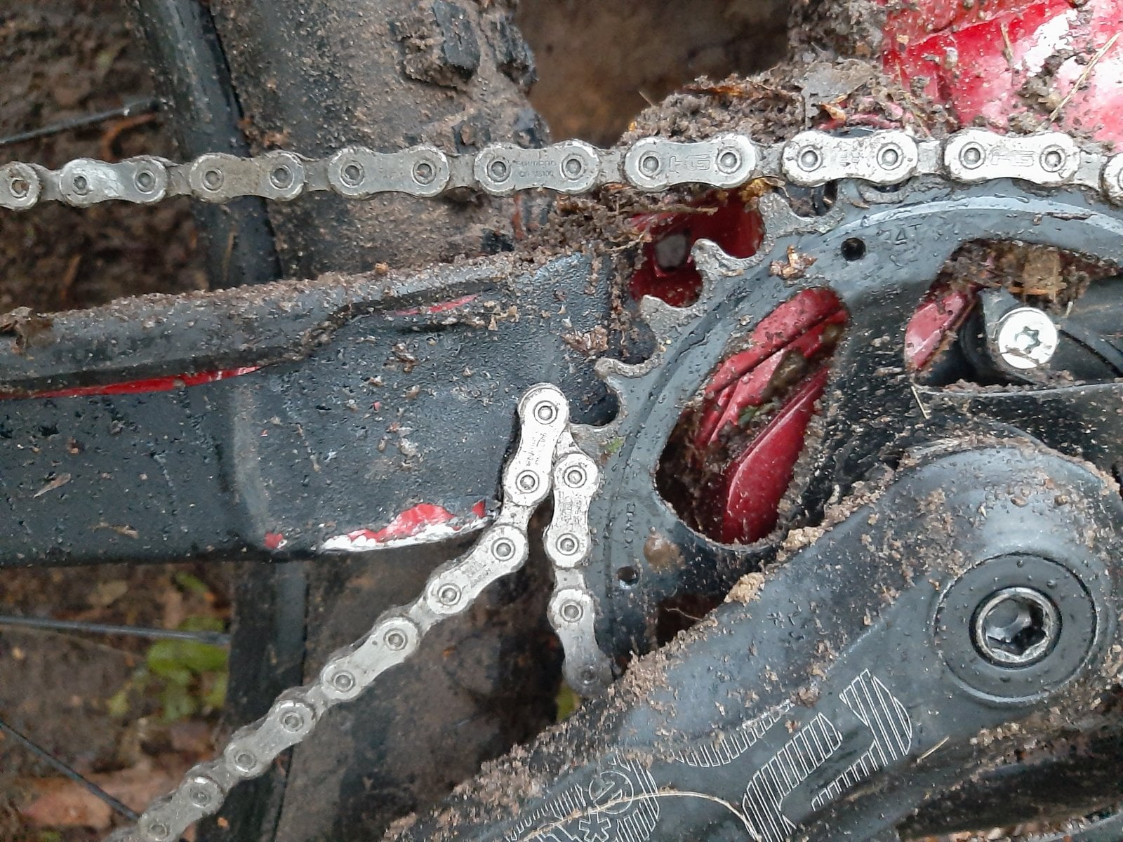

Had the same problem on my Trek rail 9.9, i found it catches when the suspension is extended. If you sit on your bike and look down you will see the chain ring has greater clearance from the swing arm, i think it catches through jumps, bad design, however it has only caught the invisiwrap on mine

I’m new to mountain biking and I had the same problem. On a trip out with my kids on a flat river bead, my chain snapped and the chainring rubbed the frame like all of the posts above. The problem was the large but had vibrated off and allowed the chainring to have about 1/8 inch play.

im sorry. The large nut that holds the crank in place had vibrated off a few turns. This caused movement which caused the chain to snap and the chainring to rub against the bike frame.

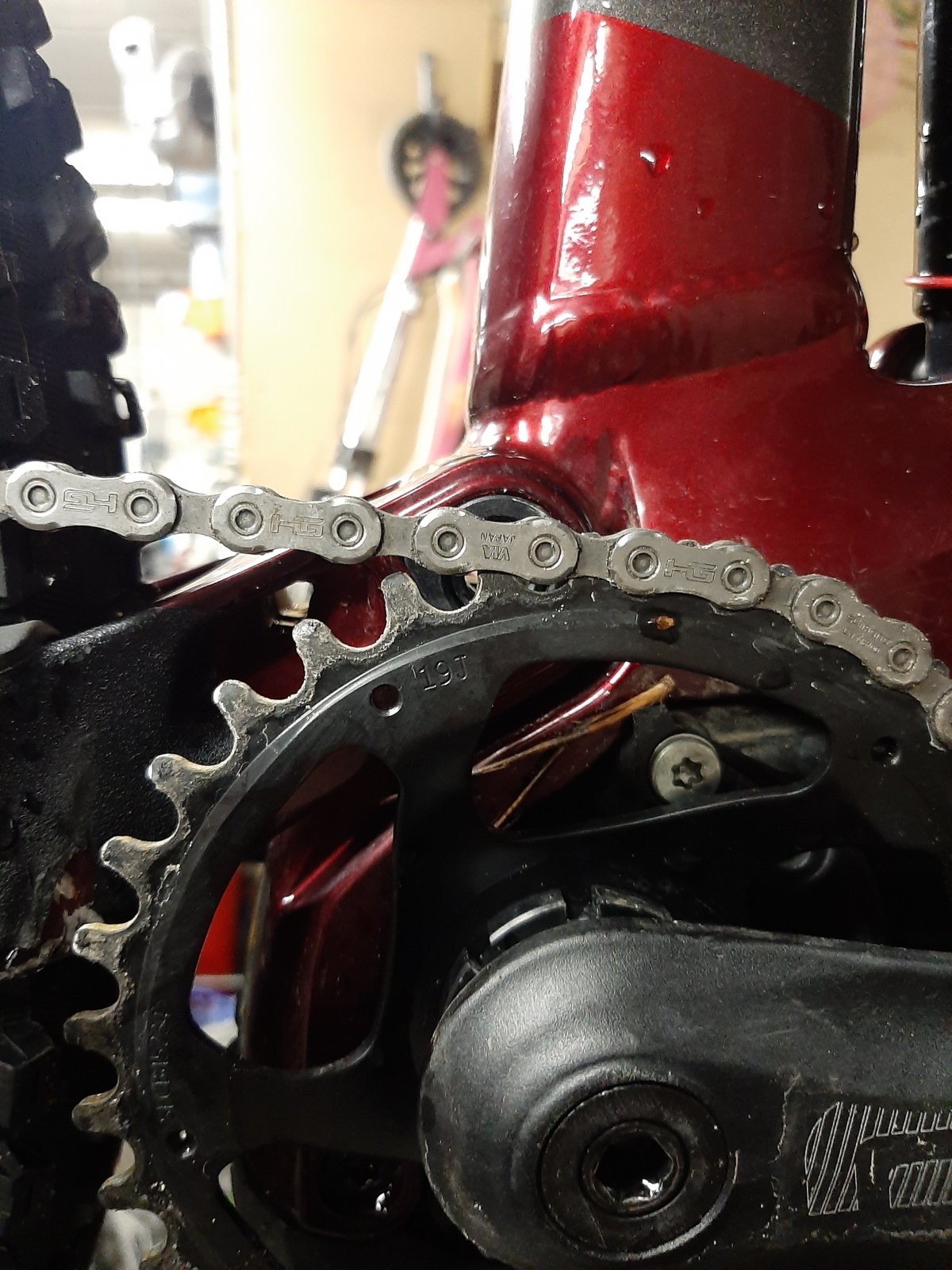

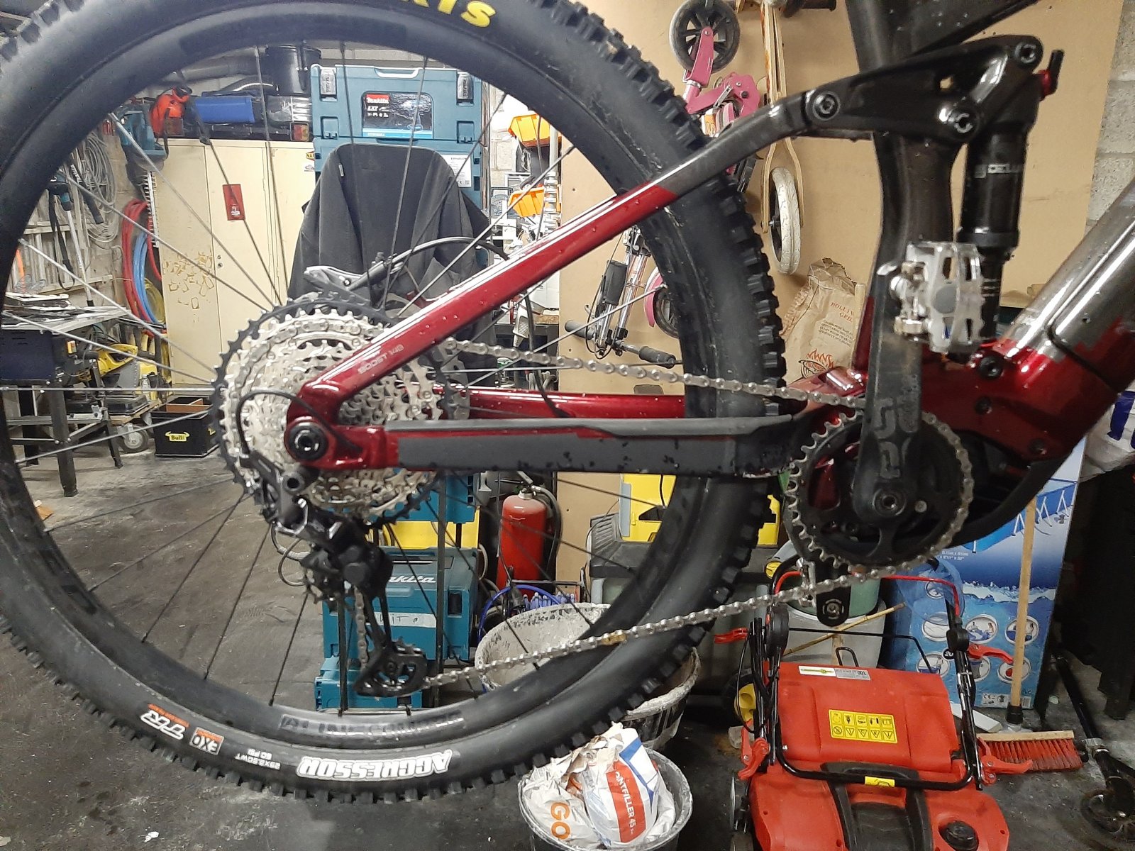

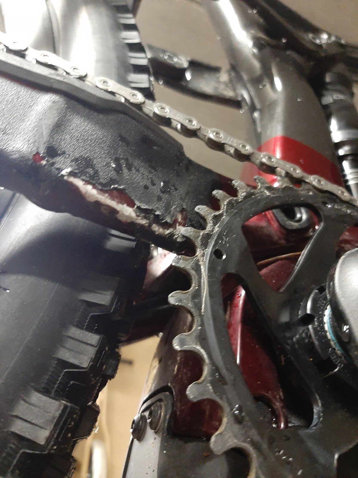

I just scrolled true all of the forums to see if anyone has the same problem.
It seams i win.?
After 120 miles the ring came lose and broke my chain. Whent to my Trek dealer and they tightend the ring using loctite.
After 10 miles same problem.
Changed the chain. Again same problem.
Then chainged the front gear. And it worked.
Last week after 600 miles. It al started again.
Today got it back from the Trek dealer and guess what. 6 miles and my new chain is ready for the trash. So is my rear fork by now.
Any idea´s. Before i go crazy?

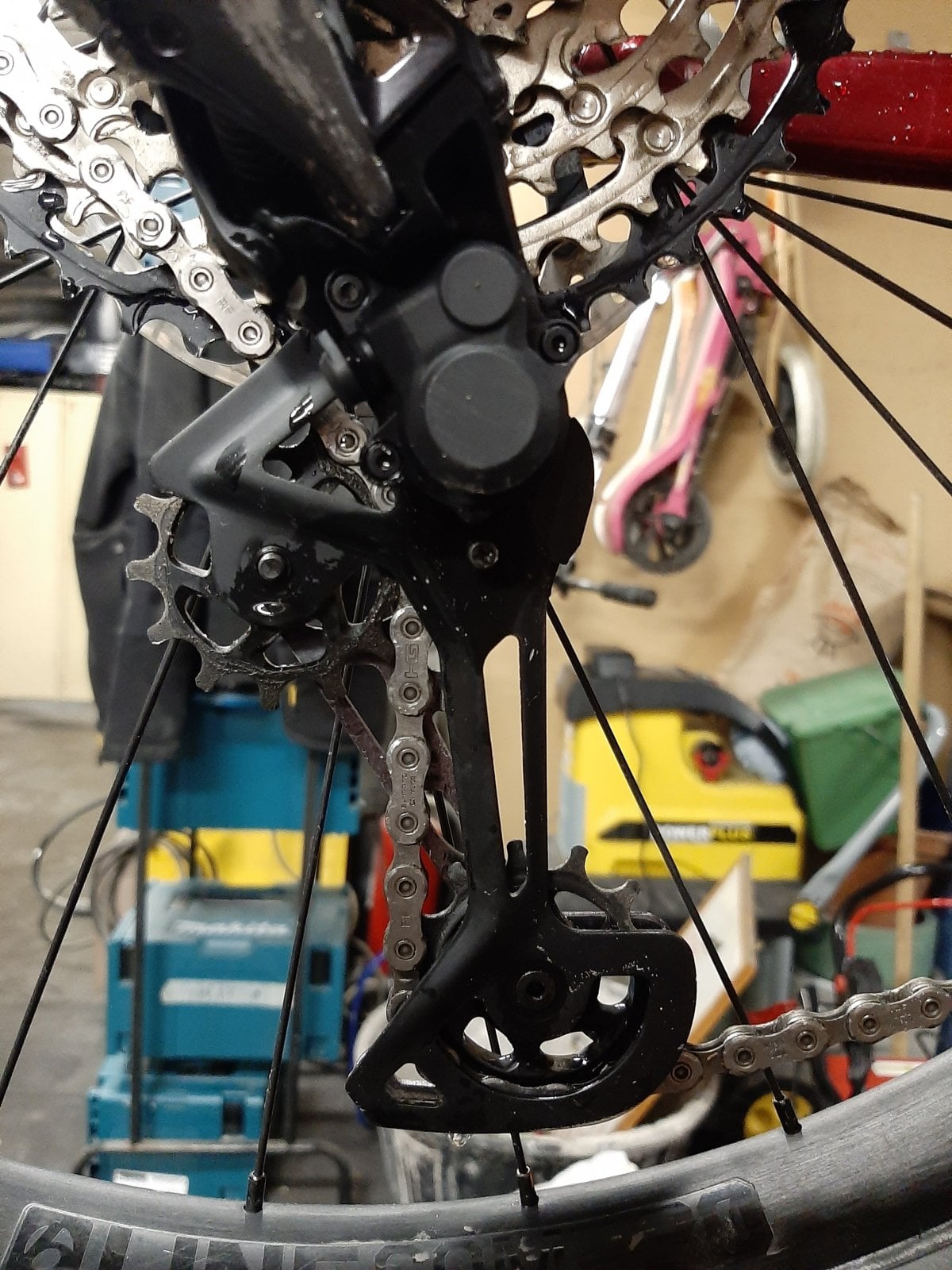

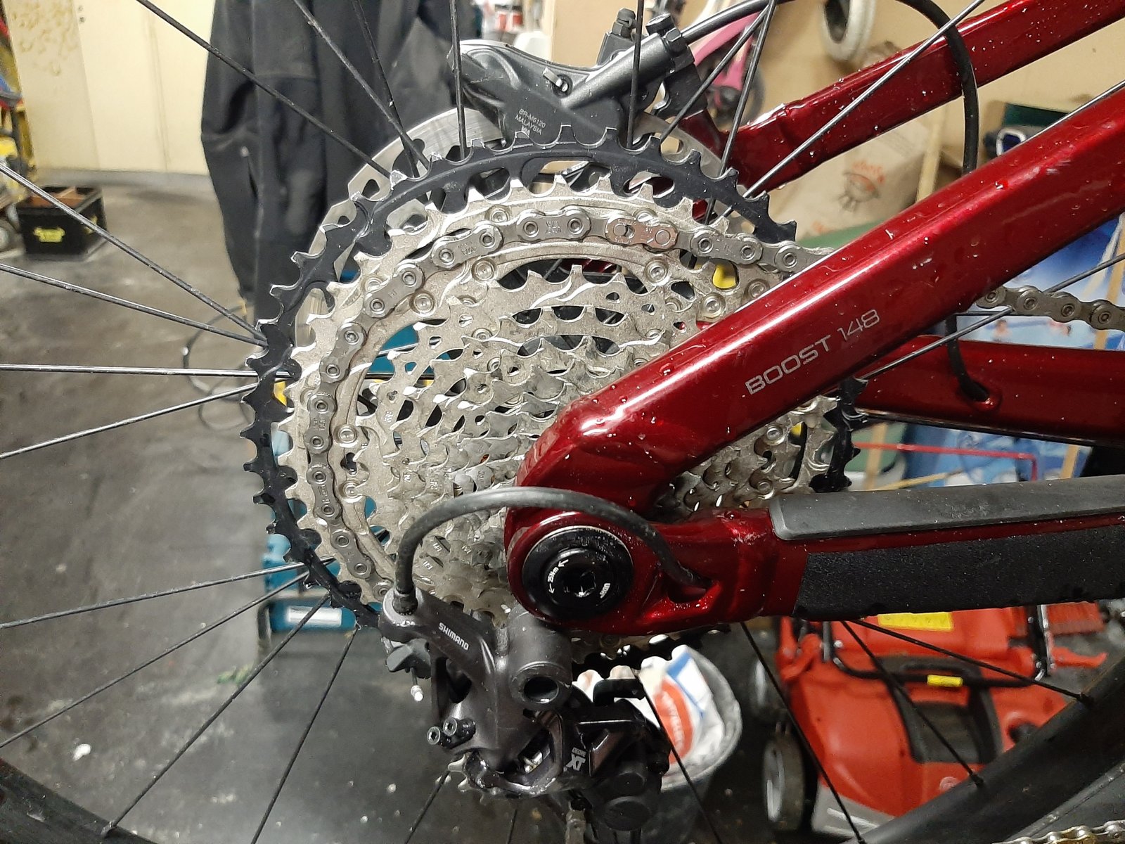

Is there a lot of tension on the rear derailleur when you try to pull the derailleur forward ?
Can you take a picture of the whole drivetrain with the chain on the smallest cog at the back ?
Was the chain shortened ?
If it all looks ok, then I am out of ideas.
neiloxford
Jul 8, 2020
124
83
Looks good to me on set up.
My guess is the KMC front chainring, but not sure as it is meant to be good for 3,500km
The black coating looks to be coming off in places, perhaps suggesting it is worn ? ( maybe the photos though )
it does appear that chainring goes with the kmc chain...
anybody else ?

I feel i’m coming to a decision after reading your post. I’ll get rid of this f&#% bike. Mine is almost 2 weeks in my LBS, they’ve painted the scratches on the chain stay, they don’t have a clue of what is going on, just tightening randomly nuts and bolts.. this issue is posted here for almost 5 month and Trek doesn’t say a word to any of us so far. Bike shop owners / operators seems completely lost. This is an expensive bike and a very poor experience! What a lack of respect!
anybody else ?
Thanks for your advice. Realy apreciate you guys thinking with me.
Are you sure it´s a kmc chainring. Because i´m sure the chain and casette are shimano. Our doesn´t brand make a difference?
I realy hope you are wrong altough it´s starting to feel you are wright.
The guys in the shop do their best but as you say they don´t realy now whats going on.
I´ll keep you posted hope we can find the fun i our bikes again.
