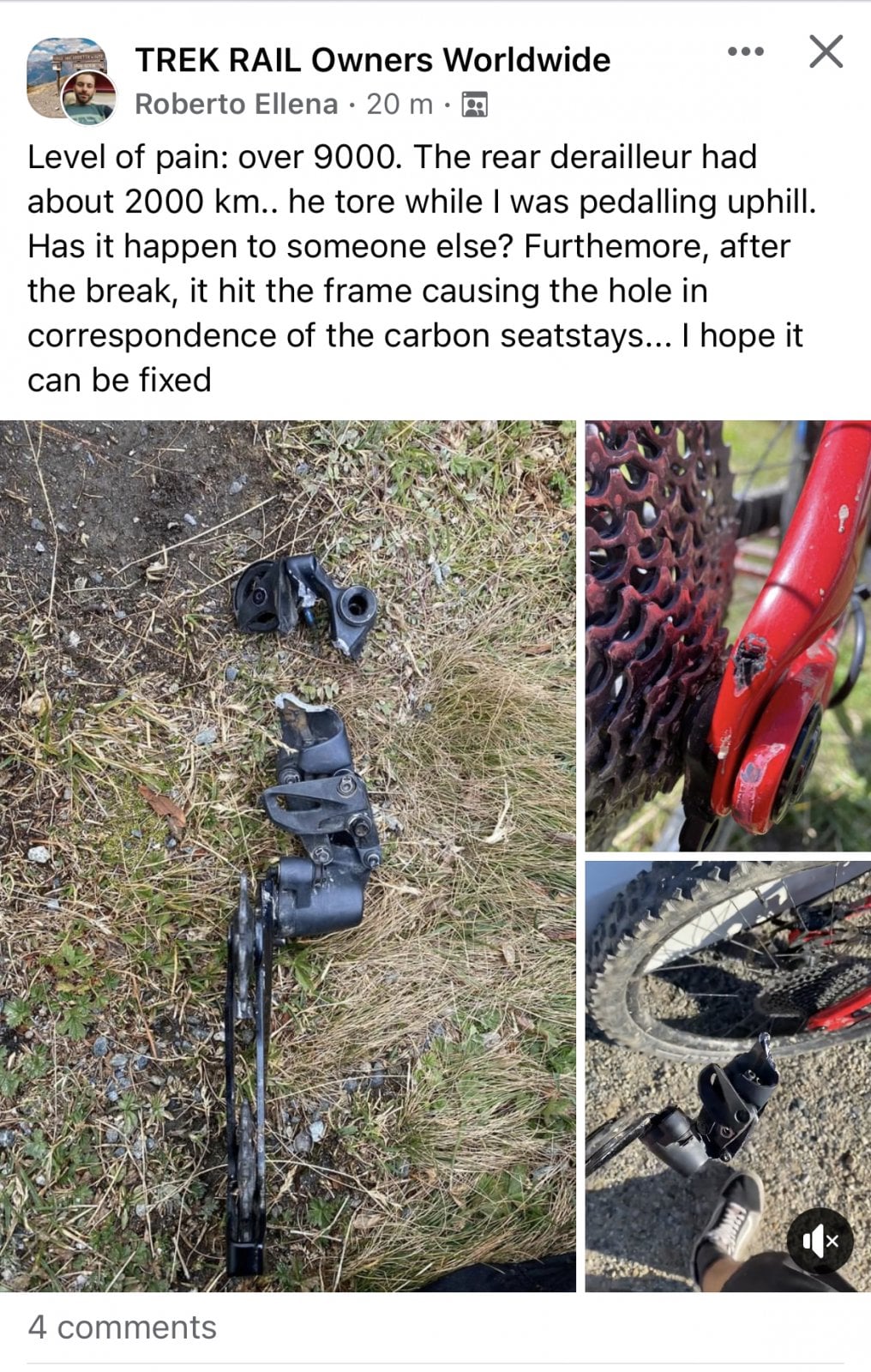

Someone on FB with the same issue.
ColP
Aug 2, 2022
8
8
Wirral
Yep. I’d say it’s a design issue. Clearly Trek are aware of it as they updated the manual to say 25NM.
I’m currently in discussions with the social media team about getting my warranty claim looked at again.
It would be good to compile a list of everyone who has had the same problem, name, date, circumstances, photos, warranty claim ref.
See if we can get Trek to take care of everyone.
