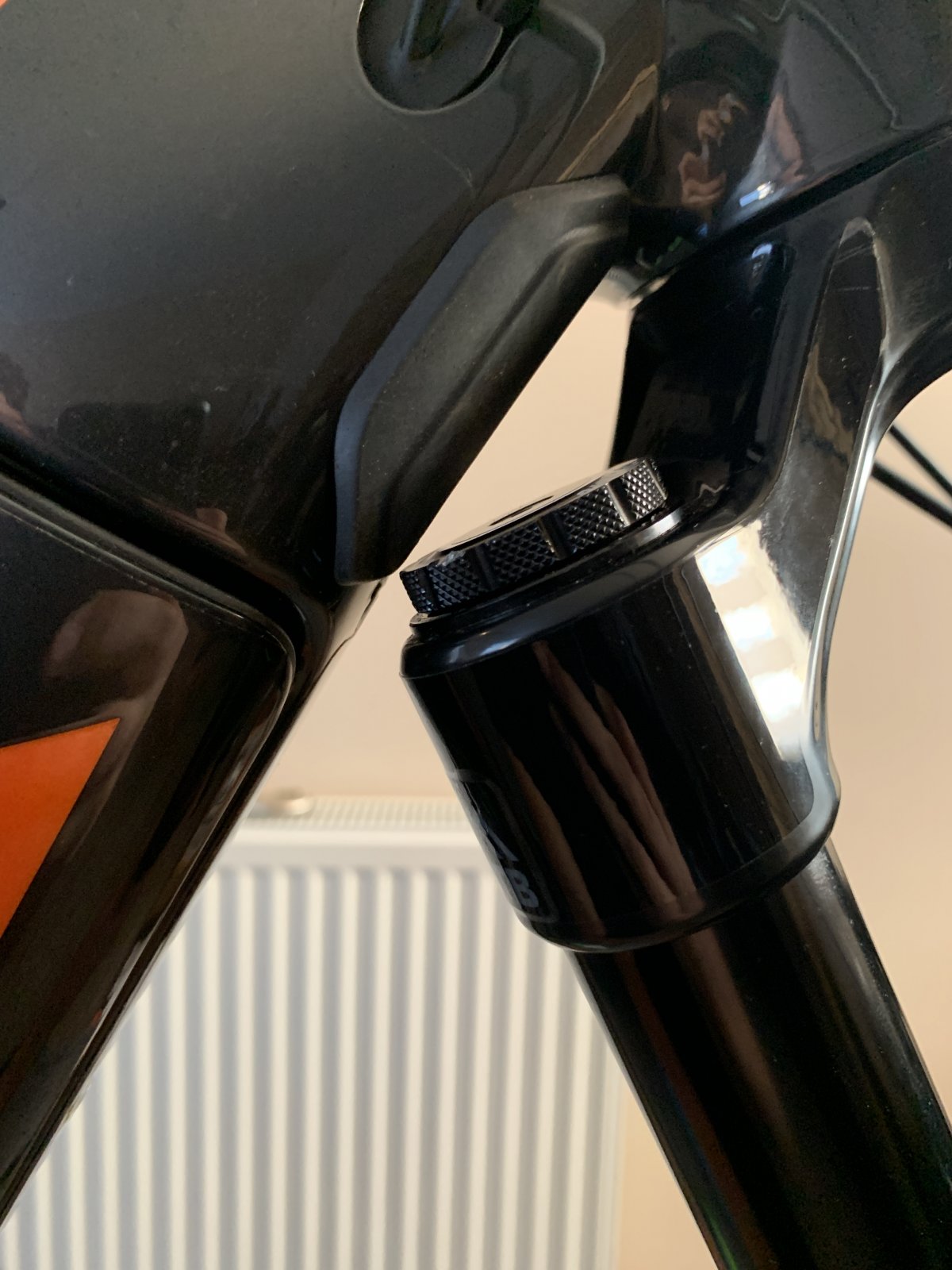

I checked on mine : 2021 carbon xl with Zeb, and the crown does touch the carbon frame... :*( by about 2mm
By the way, do you guys know if the Slash knock block 2.0 (with more range)
Part Réf. 5252160
Would fit our Rails ?

take the compression knob adjuster off the zeb and it should clear the frame.

@bluewater87 : Thanks for the tip, i just did, and it seems like it might juuusssst clear. I haven't removed my stem to properly check. At least it should do less damage.
My other question remains, do you know if the Slash knock block would work on the Rail ?
@Willie Los Angeles You have not mounted the knock block on your Slash, and i know that it clears the frame. You must have got an optionnal knock block with your bike, that have more amplitude than the one on the rail. It allows the bar to rotate a bit further. I feel limited in switchbacks, and would like to test it on my Rail if it fits.

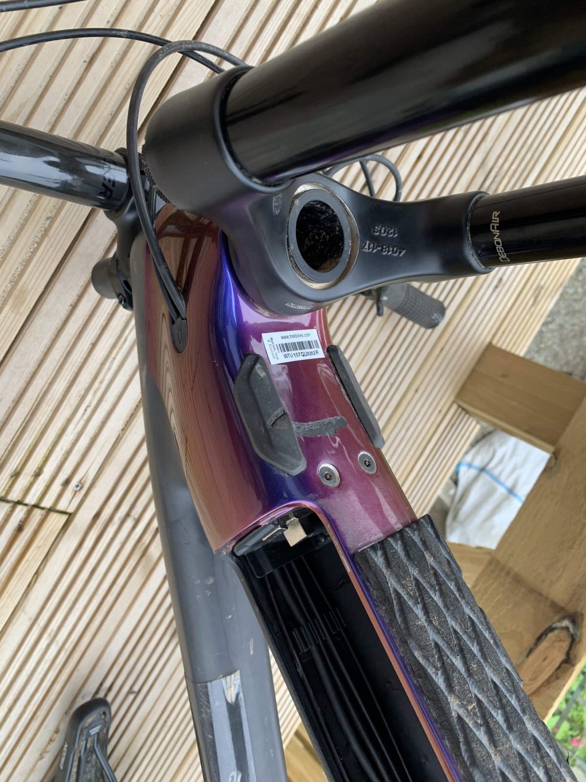

a friend crashed his bike today, same scenario the knock block failed and it's chipped the paint off the frame. its a bad design for sure, the fox 38 top cap is super sharp and angular, it just digs in to the plastic bumper and frame and chews it up causing massive damage.
Mine has a smashpot conversion so my top cap is lower and just clears, but if I were to do the same on the other side it'd likely smash the damper adjuster or damage the frame. I think I'm going to look at some sort of protection on the bottom of the downtube, it might help for a lower speed crash

Once you commit to building a bike with insufficient clearance between single-crown fork adjusters and the down tube, the options for protecting it from falls are pretty bad. If they made the steering stop chip any stronger, a big fall would rip the chip's anchor point straight out of the carbon frame. So they design it to handle a certain amount of load and then fail before that point can occur. It's a really awful compromise IMHO.
I get that they need to fit a straight internal battery and mounting hardware, and they want to fit a water bottle mount, and they need to hit certain geometry targets, but I hope enough people will make noise and get this particular solution to go away.

Cane Creek makes +3 and +6mm crown races, so those might help push the adjuster tops away from your frame.

I’ve fitted the Cane Creek +3 crown race and fork dials now clear the down tube.
It’s still a stupid bloody design fail. Just wish I was as good a rider as Wak clearly is.

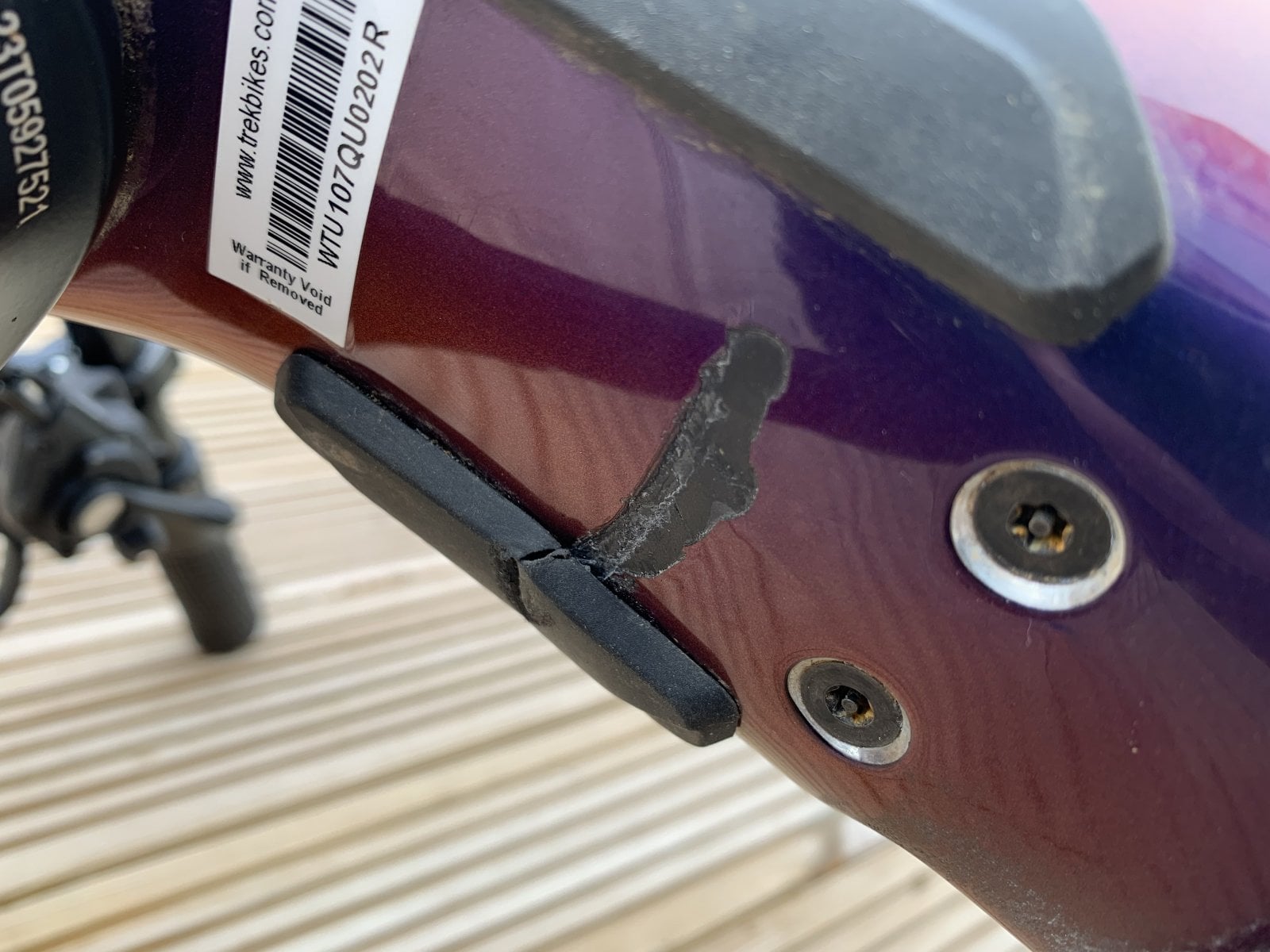

I’ve had the same issue with my 21 Rail 9, luckily the damage wasn’t too severe.
Still pretty disappointing on a bike of this value. Seems like the knock block design is flawed also the rubber blocks aren’t aligned with where the fork meets the frame ?
Probably going to file down what’s left of the knock block and fit a +3 Cane Creek race.

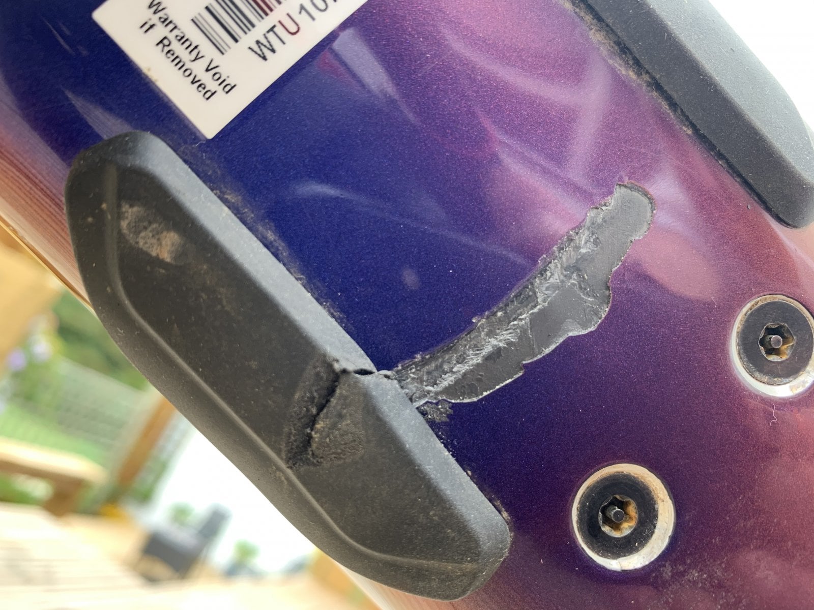

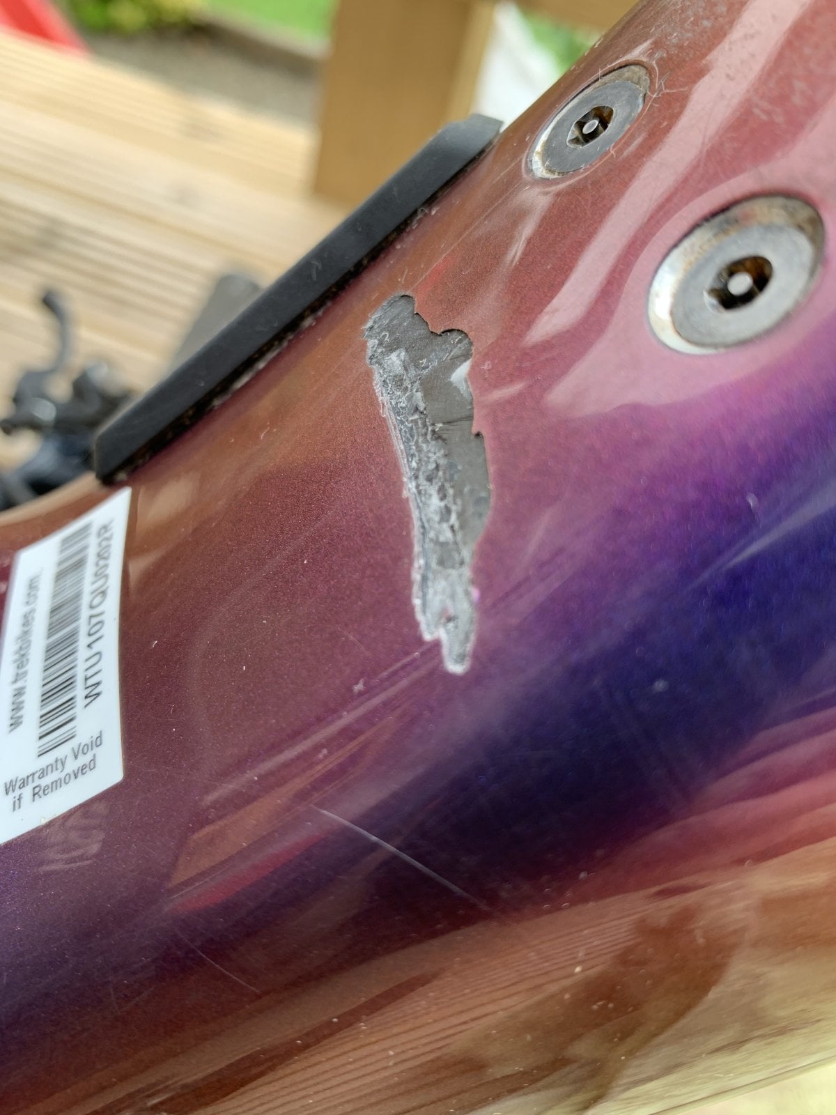

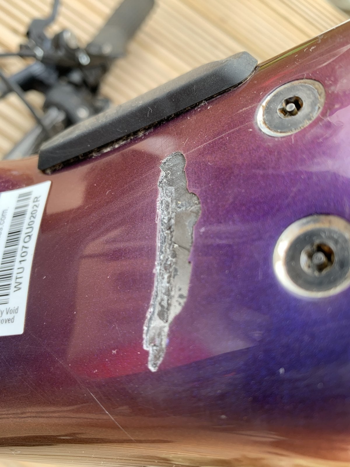

Bugger bugger bugger. I had a simple wash-out on a corner at Cwmcarn. Knock-block "feature" broke and the forks over rotated causing the knurled aluminium damper adjuster on the Lyrik's to scrape along the underside of the downtube.
Trek are stating it's not a warranty claim which I can't argue with but I would claim this "feature" is a design failure and the consequential damage has basically/potentially written my frame off.
The bike shop is offering me a replacement frame at cost or I look to repair the damage: thoughts and feedback welcome! Extremely upset if I'm honest; £6k bike, 200 miles in and looking at a massive bill for a basic wash-out. Not cool.
Quick question, is the Lyrik the fork the bike came stock with? I thought the 9.8's came stock with the Zeb. If indeed the bike has been "modified", that may be the reason for the claim denial. Just a thought. Also, I agree with the others, it's minor enough to be confidently repaired.

Mine’s a mk1 Rail which came with Lyriks so completely standard.
I’ve done over 1000km of pretty hard riding since the failure and it hasn’t killed me post my minor repair. Let’s hope that’s not now tempting fate, Final Destination style!!!

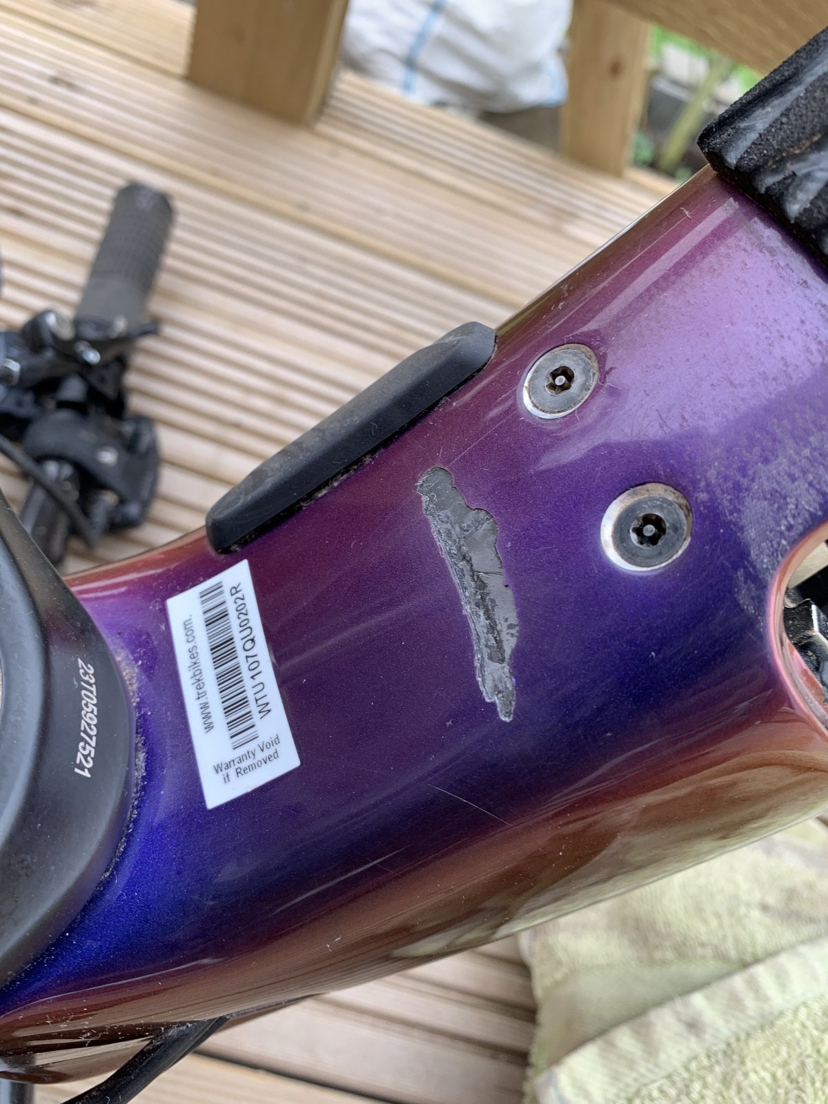

Good photos of the damage. I agree with others that some carbon fibres appear to be broken. It is in an area that would have high compressive forces, so the remaining unbroken fibres might buckle during a good hit while riding. Carbon is not particularly strong in compression. I expect that someone experienced in carbon frame repair could put a patch over that to make up for the severed fibres.
