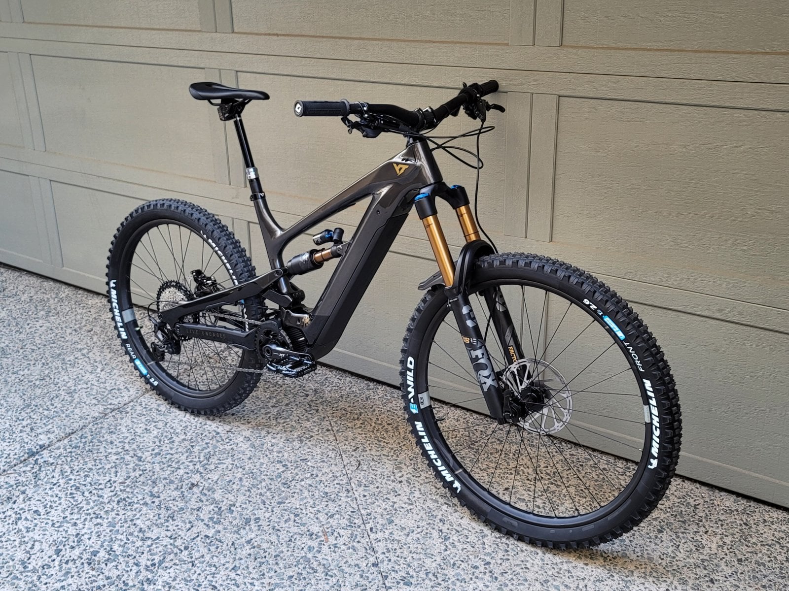

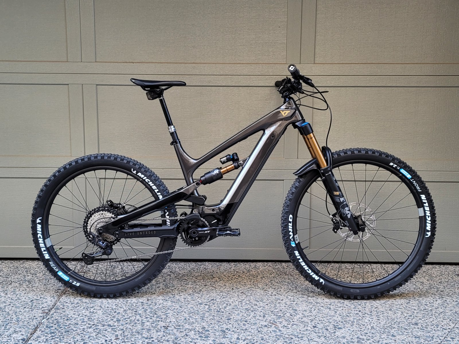

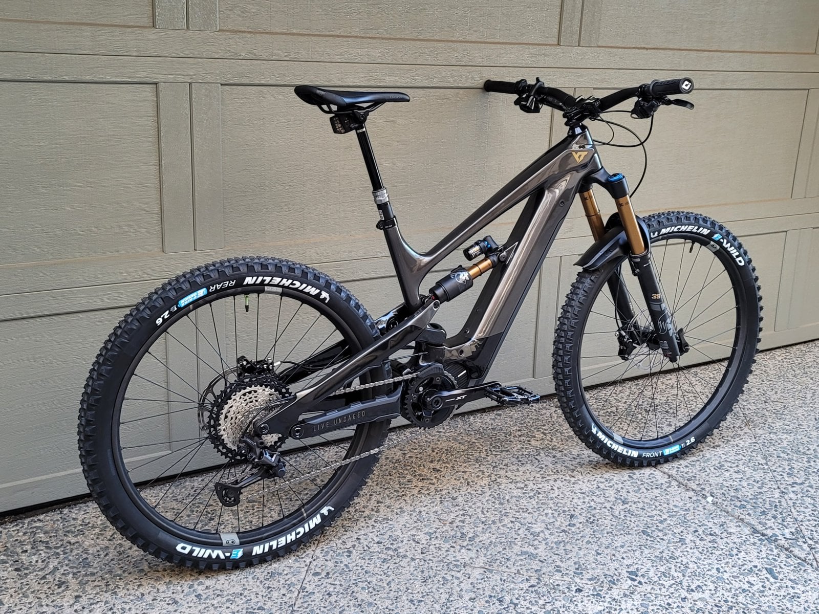

Finished with the upgrades and installation of Ridewrap. Upgrades tires, bars, stem, dropper, saddle & grips. 1st ride tomorrow!
TECHNICAL SPECIFICATIONS
2021 YT Decoy Elite
FRAMESET
Virtual 4-Link rear suspension
Mixed ("Mullet") wheels: 29" front, 27.5" rear
Internal cable routing.
CRANKSET
SHIMANO XT
FCM 8050 | 165 mm
WHEELSET
CRANKBROTHERS SYNTHESIS E11
Front 29“ x 31.5 mm 110 x 15 mm
Rear 27,5‘‘ x 35.5 mm 148 x 12 mm
HUBS
Industry Nine 1/1, 110x15mm Boost front, 148x12mm Boost rear with MICRO SPLINE driver
FORK
FOX 38 FLOAT FACTORY E-BIKE
29“ | 170 mm | 15QRx110 | 51 mm Rake | Grip2
REAR DERAILLEUR
SHIMANO XT
Shadow Plus | 12 - Speed
Shifter
SHIMANO XT 12 - Speed
SHOCK
FOX FLOAT X2 FACTORY
230 x 65mm | w/2-Pos Lever
MOTOR
SHIMANO E8000 70 NM 250 W
DISPLAY
SHIMANO E7000 Monochrome
BATTERY
SMP YT CUSTOM Removable 540 Wh 36 V
STEM
Deity Copperhead 31.8MM x 50mm
CASSETTE
SHIMANO XT 10 - 51T | 12 - Speed
CHAIN
Shimano XT
CHAINGUIDE
E13 TRS PLUS E8000 2 Bolt 34-38T Compact Slider
HEADSET
ACROS AZX-260 BLOCK LOCK High Cap
BRAKES
SRAM CODE RSC
Rotors CENTERLINE 220mm/220mm
CHAINRING
SHIMANO SMCRE80 | 36 T
WEIGHT
50.48 LB
SEATPOST
Rockshox Reverb AXS
Ø 31.6 mm 150 mm travel
HANDLEBAR
SQ Lab Carbon, 4-degree upsweep, 12 degrees backsweep, 45mm rise, 780mm, 31.8mm diameter
SADDLE
Ergon SM Enduro Comp Stealth
GRIPS
ODI ELITE Lock-On
FRAME SIZE
Large
COLOR
DARK SLATE
SWITCH
SHIMANO E7000
On-Bar | SWE7000L
WHEELSET
27.5‘‘ x 35.5 mm 148 x 12 mm
FRONT TIRE
Michelin E-Wild
29“ x 2.6
REAR TIRE
Michelin E-Wild
27.5“ x 2.6

How do you like those E-Wilds? They look good, that's for sure! Good looking set up.
I have some pictures on another thread if you're interested. I think it's in the "show your bike" thread.
I haven't had a chance to ride them on a variety of trails. They do roll pretty fast and corner awesome! Need a few more rides to form an opinion.

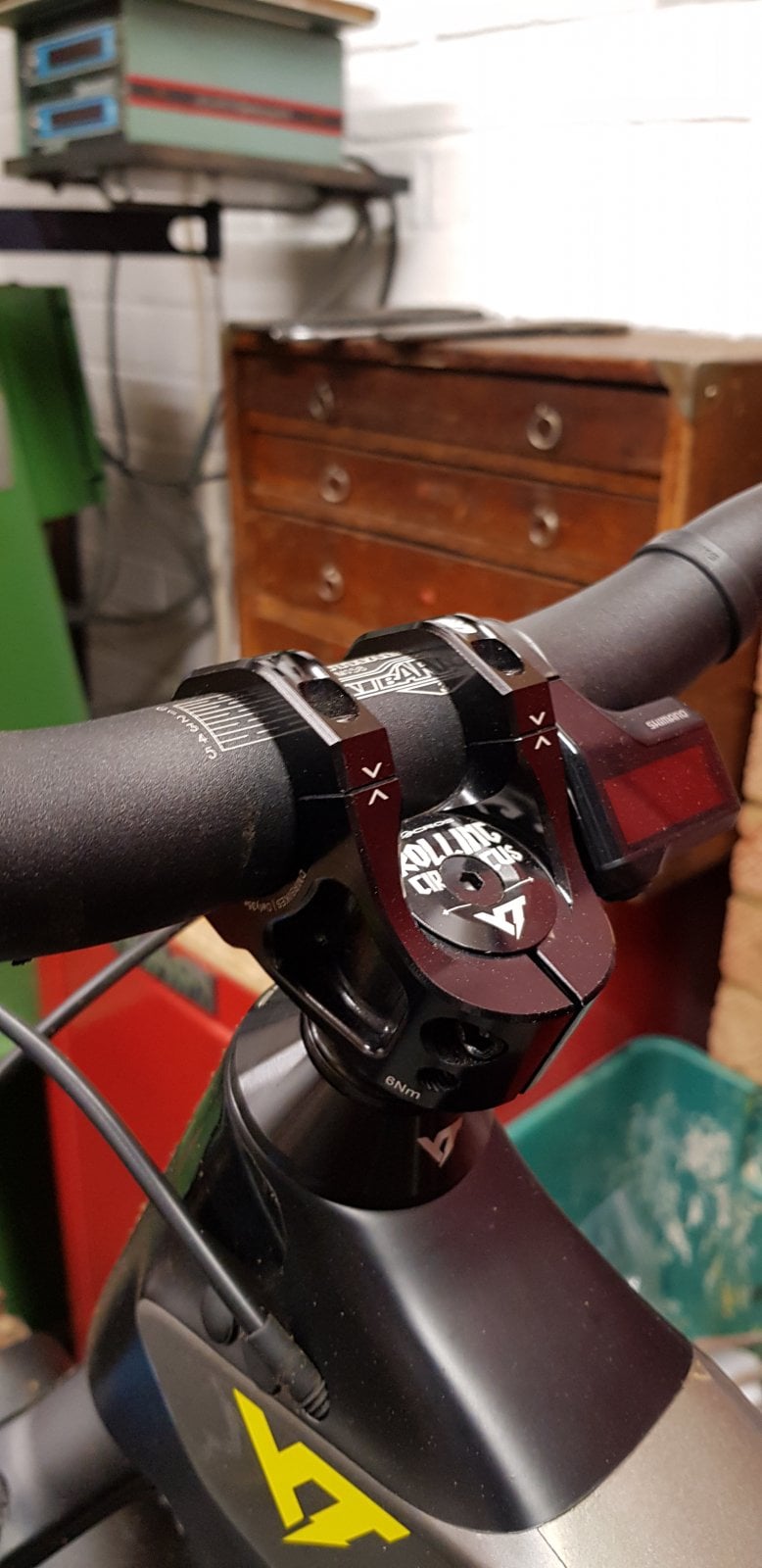

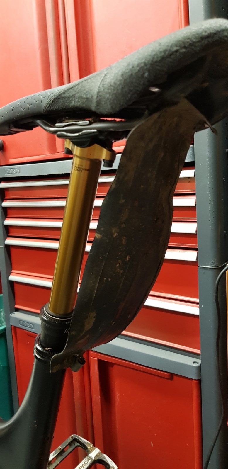

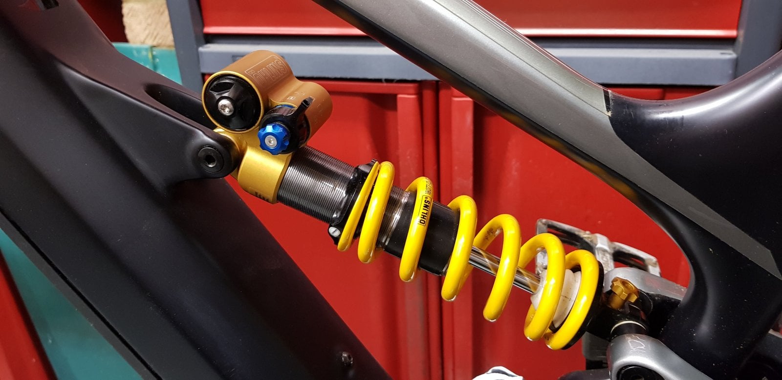

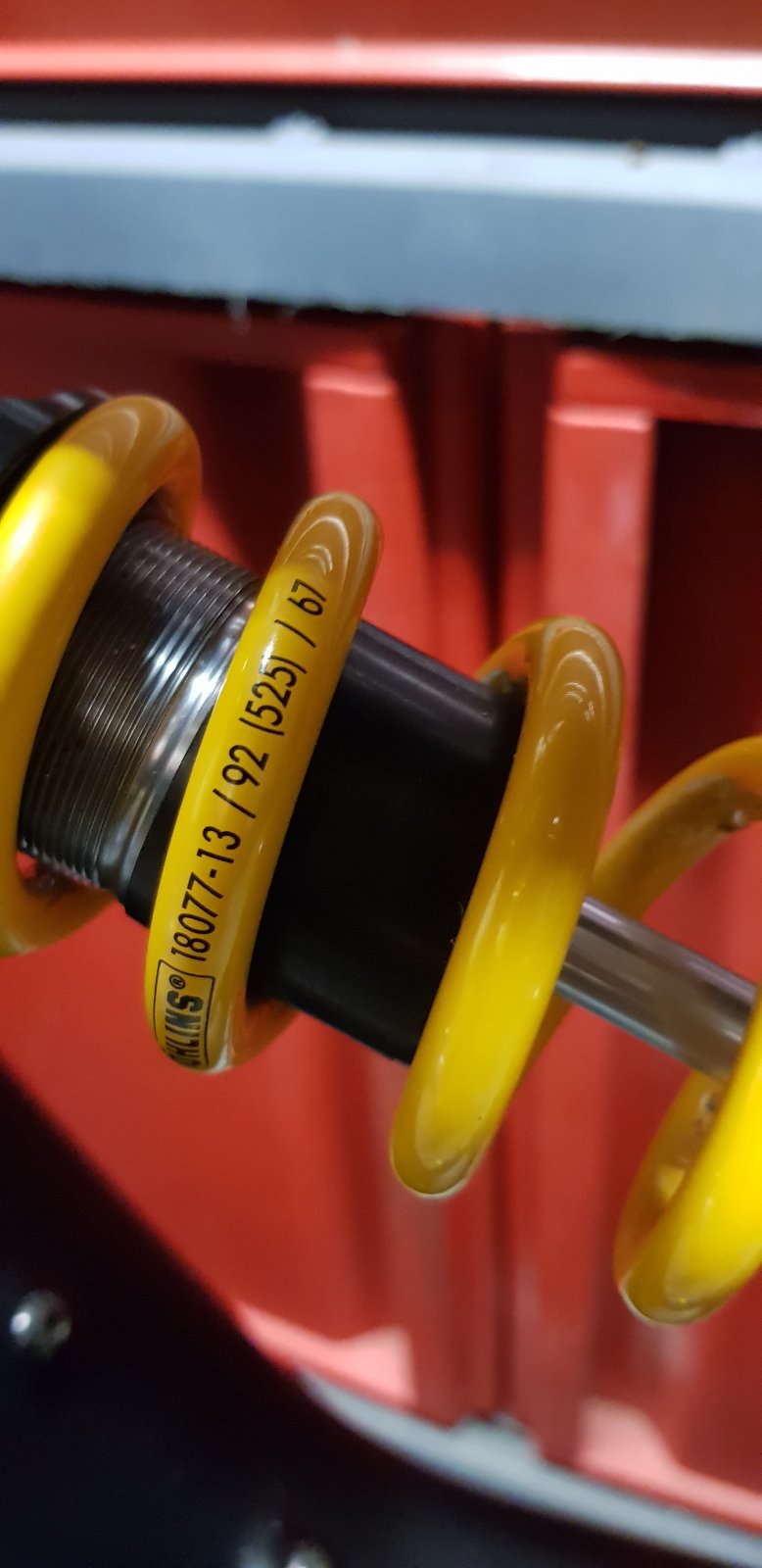

Hi,
I've changed:-
Riser stem to get the bars 25mm higher.
Ohlins shock, I weigh 102 kgs.
Eddy Current rear tyre.
Tubeless front and rear.
Old inner tube to protect the dropper.
The Eddy Current is great. Extremely hard to get on the carbon rim only using your hands, but it does go on.

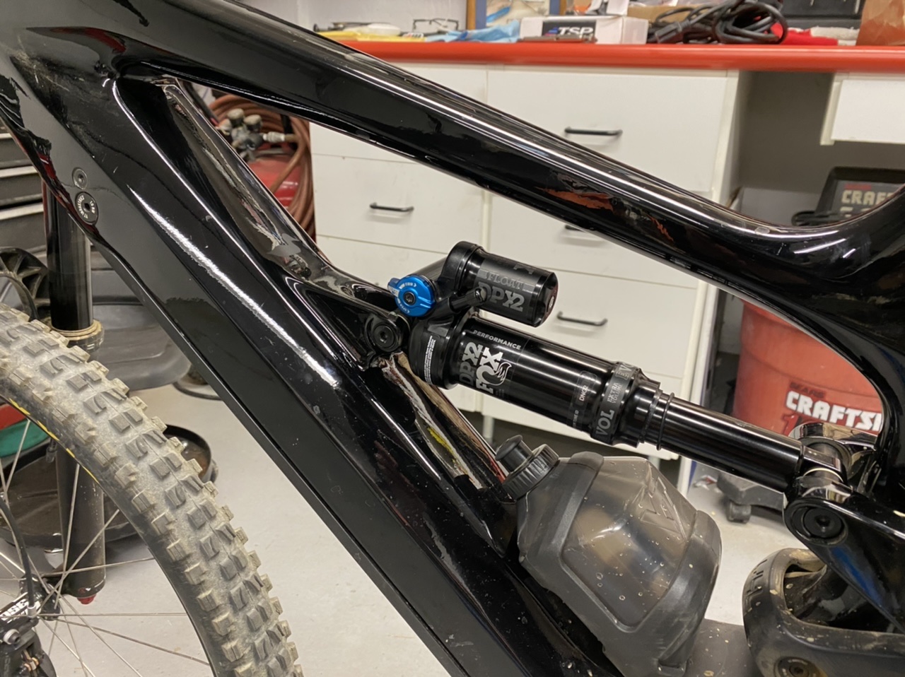

Dpx2. Nothing exciting since the pro 29 already comes stock with this shock, but should help a lot for the base model. Factory/Elite models are unnecessary according to a knowledgeable person at fox, since the shock works best in this “setting” anyways.
I upgraded to the same dpx2 (purchased from a Pro decoy take off) but I couldn't fit the white fox bushings, had to go buy the metal DU bushing like what was in the Rockshox I took off. Looks like you didn't have a problem with your from the picture, did you?
rb.
Apr 27, 2020
388
262
San Jose, usa
I had to order the fox mounting hardware kit as my shock was a take-off from a different bike so the sizes did not match. No issues with install.

Hi,
I've changed:-
I am almost the same weight. Would you mind sharing the specs of the shock? I am still using the stock shock and might want to change to coil!
Josey Wales
Nov 29, 2020
27
14
Sure, sorry for the delay in replying.
The shock is Ohlins TTX22M, 230 x 65
Spring is:-
Expensive, but worth it if you're jumping and riding aggressively. I'm not brilliant at either, but I can tell the difference.
At 102 kgs you have to put ~230psi in the original air shock. This preloads all the seals giving loads more stickshon.
The coil is great, easy to set the sag, and only a few settings to play with. The high speed compression adjuster actually makes a difference too!

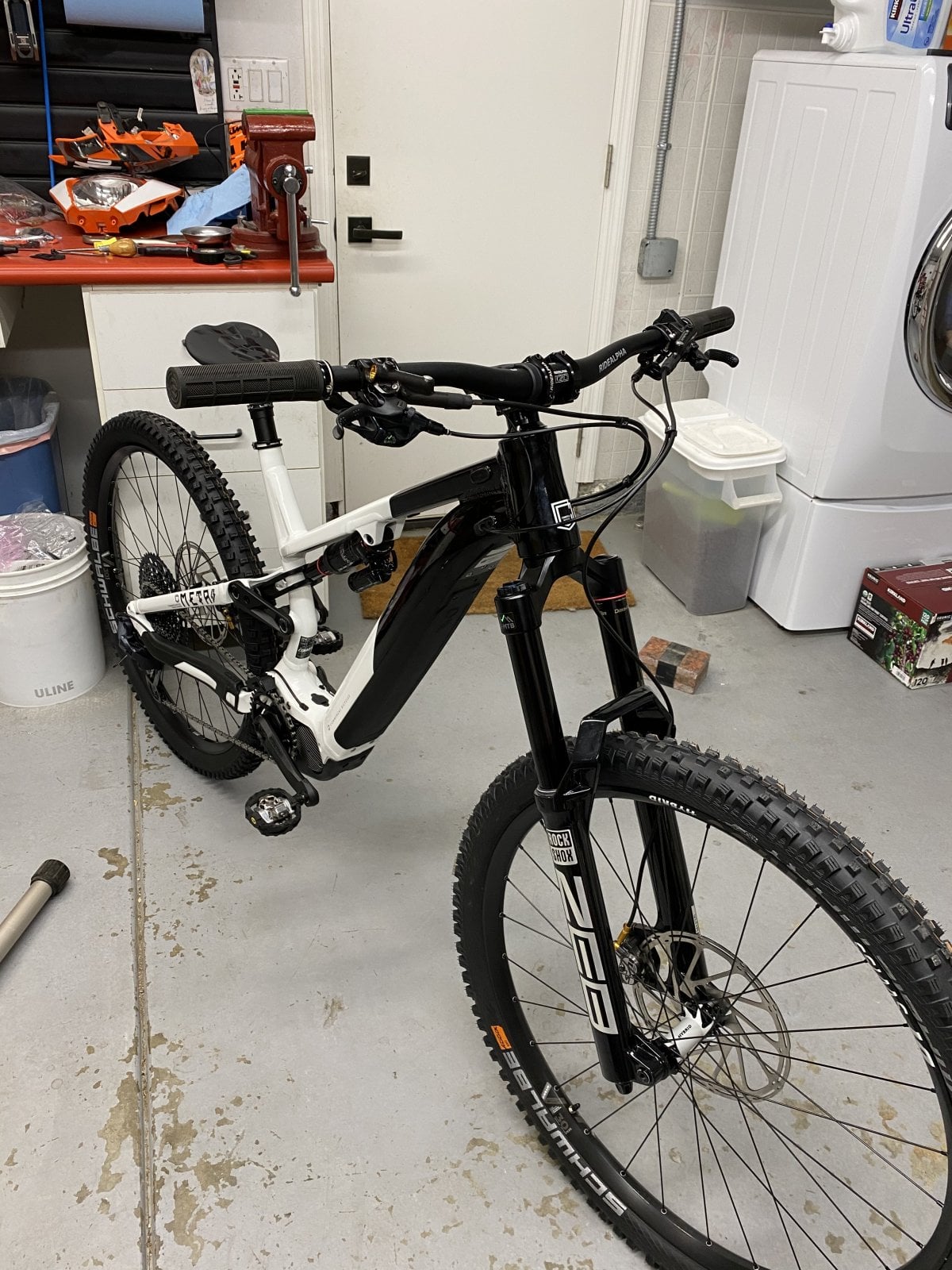

So much fun on my Decoy I have not been able to post my fine tuning - 2020 YT Decoy Pro Race - XL - as with any bike I'm still getting everything tuned. Love the way it handles the steeps here & plows through the chunk! This is it in action! Changes and pending below:
Done:
  • Ergon SM Enduro Comp - great saddle
  • Schwalbe Eddy Current (rear 27.5 x 2.60) - running 23 lbs - great all around grip
  • ODI ROUGE Lock on grips -super comfortable & lock on is right
  • “Pro tune” for 36 & X2 - Bike Co by “Bitter Joe”- Must have to get the most out of the travel!
  • Galfer 220 mm front rotor with Galfer pro compound pads - gotta stop!
  • Crank Bros Stamp 7 pedals
  • Additional battery - got to have power!
On the way:
  • Shimano Saint M820 brakes – the “Codes” just don’t get it done
  • Galfer 203 mm rear rotor - gotta stop!
  • Maxxis Assegai 29" Wide Trail 3C/EXO/TR (front 29 x 2.50) – can't wait to push into that tire!
Can't wait to ride again tomorrow! See ya out there!

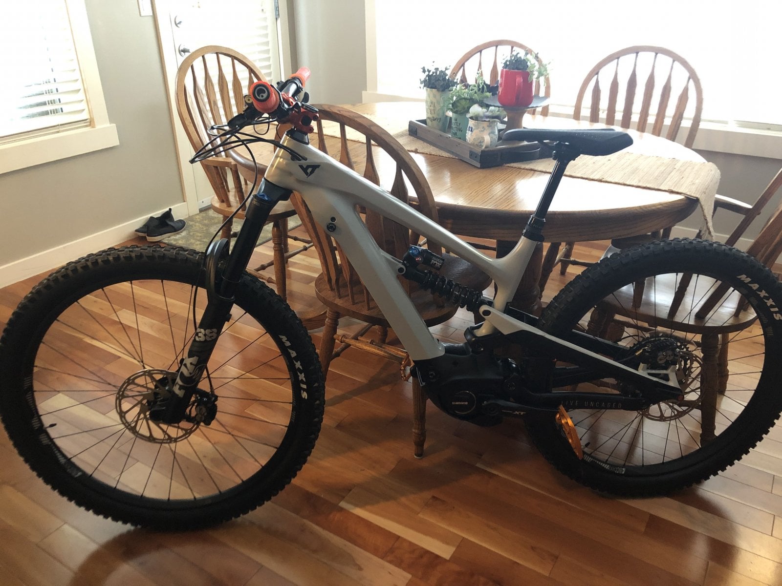

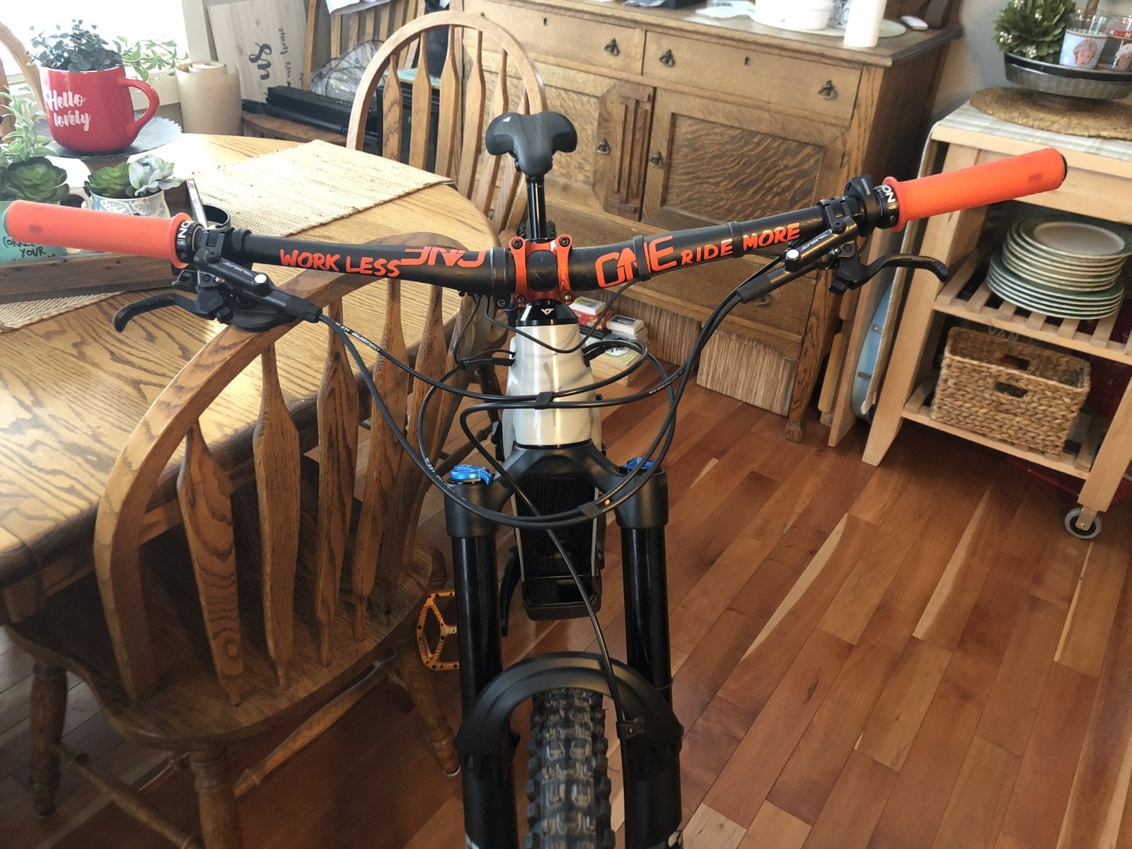

Decoy Shred in medium came in and it has been an awesome couple of weeks setting it up (taking my time!). Have done a few upgrades so far. Here is what I have changed out:
Completed Upgrades:
  • Race Face Turbine R 35 Stem Orange, 50mm Length
  • OneUp Carbon Handlebar 20mm rise
  • Wolf Tooth Dropper Post Remote
  • K-edge Gravity Garmin top-cap mount
  • OneUp Aluminum Pedals
  • Shimano Saint front and rear
  • Ergon MTB Gravity Grip
  • RideWrap (but I did a shite job on it - I am not patient enough for that type of work!)
To Be Completed (ordered and/or just waiting to be installed):
  • Nobl TR41 mullet wheelset with Industry Nine 1/1 hubs (can't wait to get these on)
  • 203mm Ice-Tech rotors
  • Cushcore front and rear inserts
  • Tubeless setup
Will also probably change the tires, but only once I wear the current ones down.
  • Tubeless setup
View attachment 51637 View attachment 51638

Thanks! Yeah really looking forward to the wheels! I have had Nobl wheels on my last analog bike and they were amazing.
Will do on the tire - I know you like those e-wilds so I have been trying to find them to do a swap . I am having trouble finding the 27's here in Canada. Seems we can only get the 29s here for some crazy reason. I'll keep watching.
