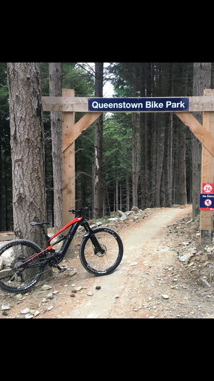

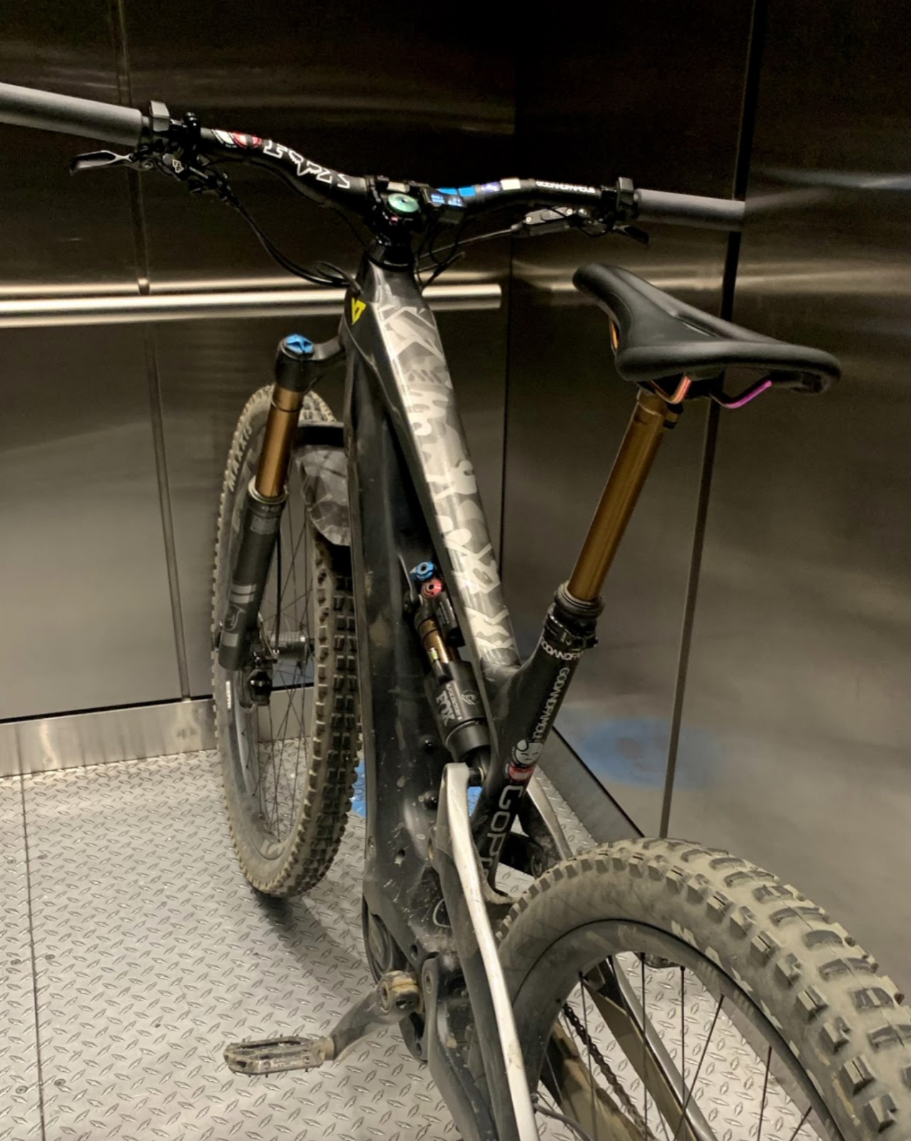

I had the first decent ride on my 2019 Decoy Base today and loved it. I’ve made the following upgrades...
1. Fox Float 36 Performance Elite Grip2 fork
2. Fox Float DPX2 Performance Elite shock
3. OneUp 800mm bars
4. OneUp 35mm stem + EDC tool
5. OneUp dropper lever
6. OneUp composite pedals
7. XTR shifter

Might as well got the 2019 CF Pro as it comes with those fork and shock as standard?

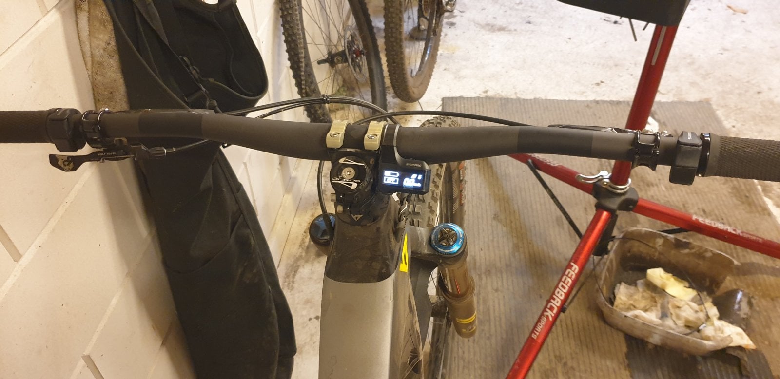

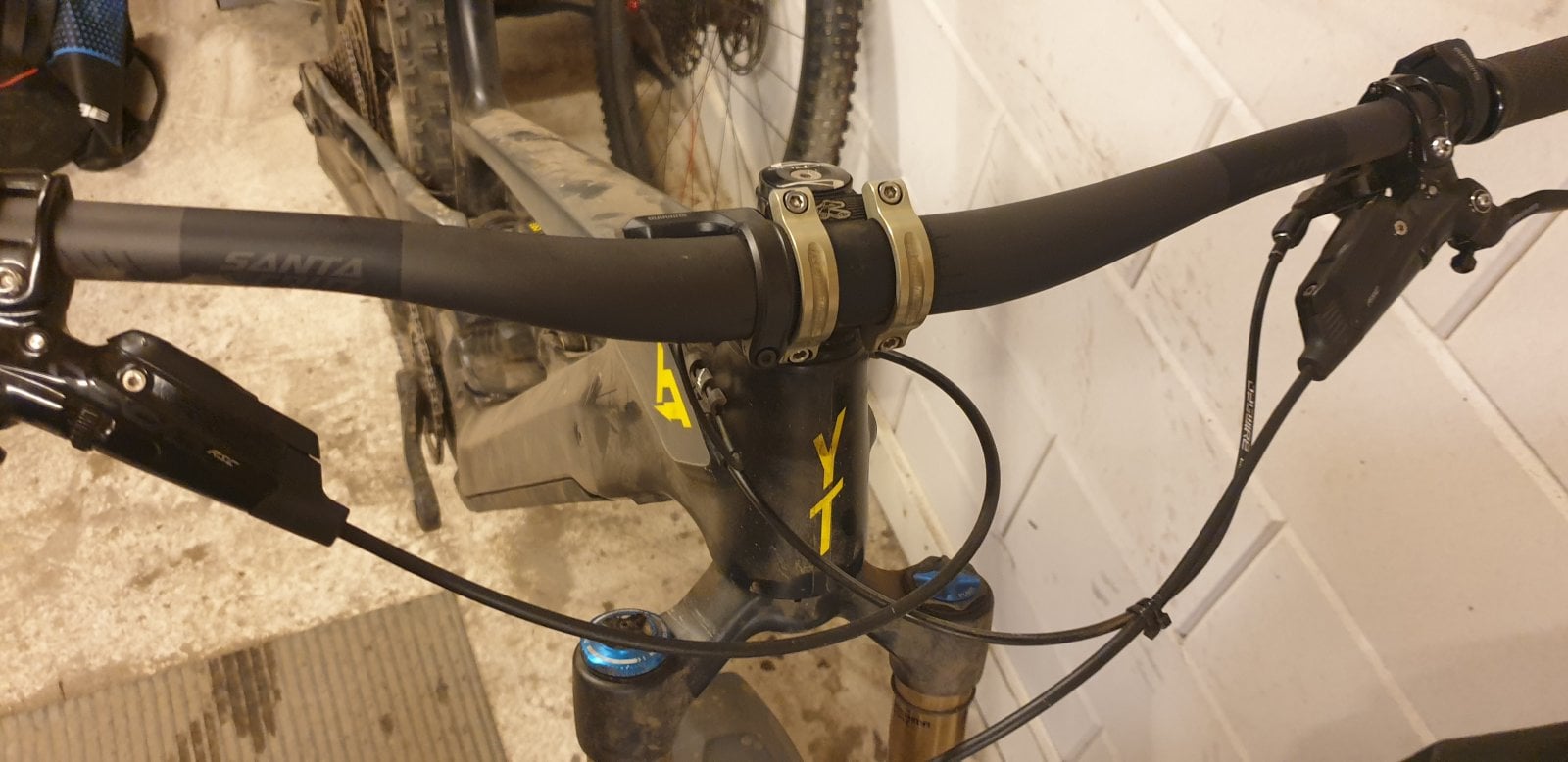

Replaced the renthal bar with a Santa Di2 bar....no more cables....
That clean look is soooo good. I hooe we see more options with bars like this. One thing i cant quite understand is the tiny little electrical cables with minimal protection for them. I dont think a little added weight for protection would hurt anyone.
Also the headtubes on the decoy are relatively short and i generally ride all my bikes with the bar the same height as my dh bike. Dh bike has 20mm rise so i like a 40mm on my single crown bikes, plus spacers to compensate for the short steerer tube.
Its all coming, along with gearboxes.......

Yeah it was a pain to find a specific carbon Di2 bar. This is the only one i could find. It is only 20mm rise though.....well for me it is a perfect fit.

Totally personal preference thing. Wish it was my preference. Looks great

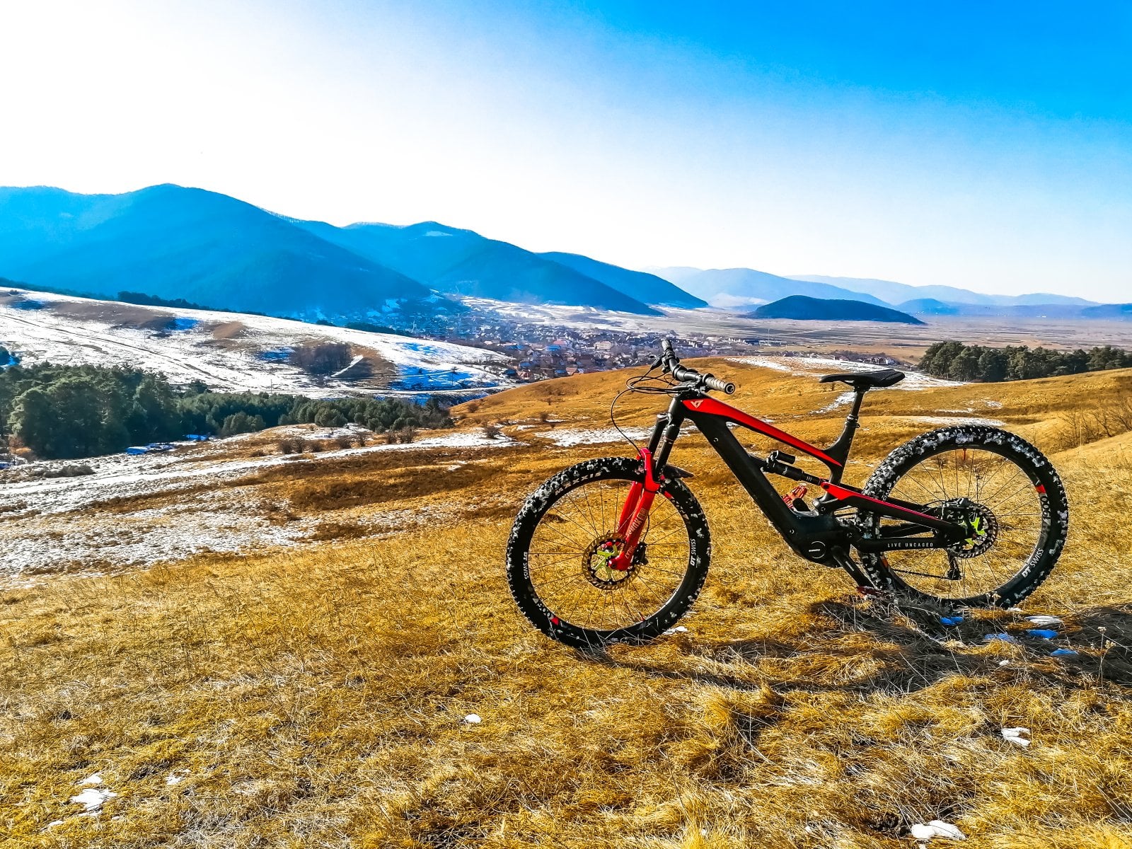

I have Magura disc 220 on fron with magura adaptor 40mm. On back i have Magura Disc 203mm with Shimano adaptor 203mm. My brakes are Sram CODE R with Trickstuff pads.

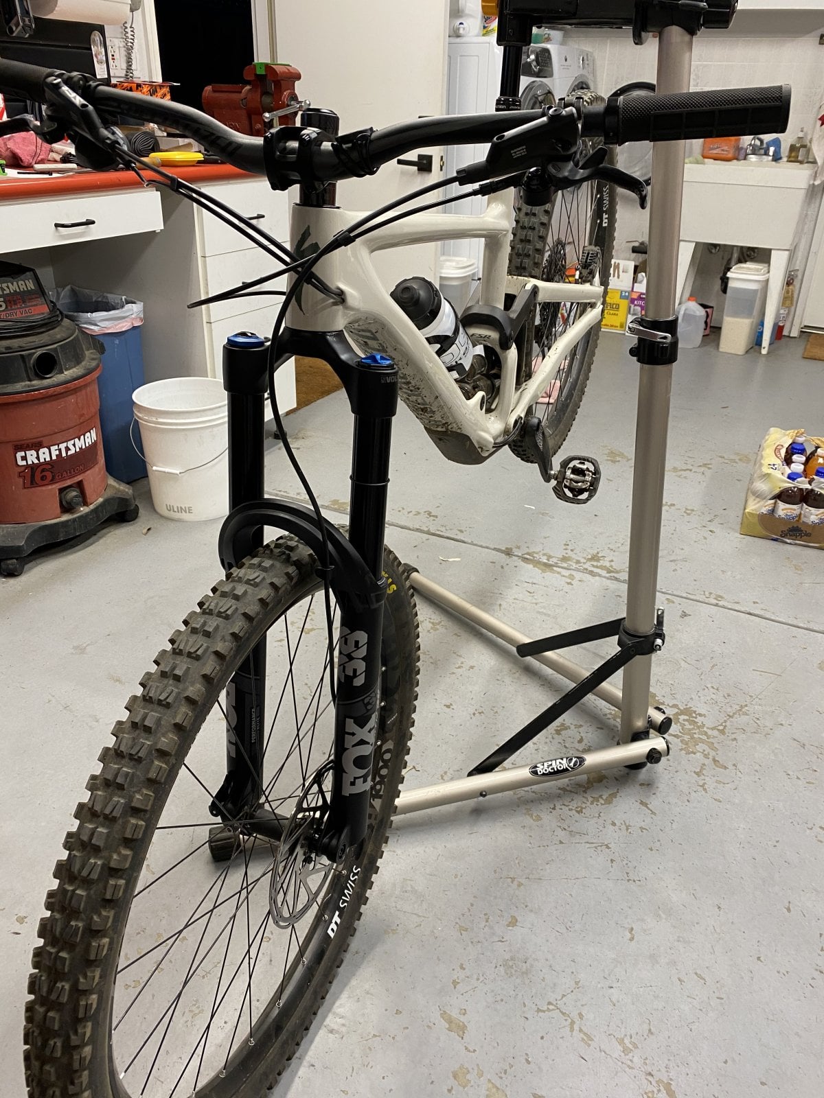

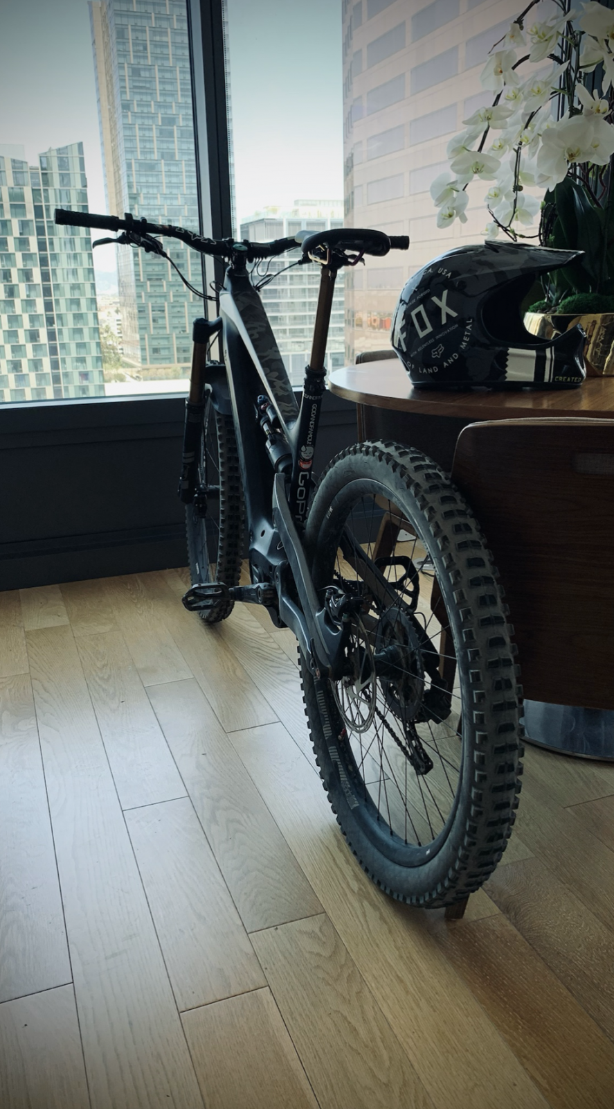

On my 2021 Decoy Pro 29
1. Santa Cruz Carbon Riser Bar - 800mm with 20mm rise (I love these bars and they are on all my MTB's)
2. I9 32mm Blue Stem (Chose this stem because it was what was available in blue and the length I wanted)
3. PNW Loam Lever for Dropper (Smooth as warm butter)
4. ANVL Forge Seat (Chose this seat because I own a Trransition Sentinel that came with one of these and I love it. Fits me perfectly)
5. Hope F20 Pedals in Blue (Chose these because I wanted blue pedals to match stem and these had very favorable reviews. I admit that the grip is amazing and still allows for position corrections when needed. Running Five Ten Free Rider shoes)
6. Swapped to Tubeless before riding (All my bikes are on tubeless. Can't see any reason to run tubes anymore, even on road bikes)
7. Installed new Air Spring to increase travel to 160mm (Wanted to match front travel with my Sentinel. Still working out Air Pressure and Token Stacks along with tuning, but I love this fork)
8. PNW Loam Grips (These are nice. Only changed grips because the ones that came with bike were a little harder than I prefer)
8a. Update on the PNW Loam Grips. These are decent enough grips when wearing gloves, but I forgot my gloves this morning and may hands are trashed after 30 miles of riding pretty flat roads on the way in to work. I really can't recommend these grips. They suck without gloves.
To do...
When tires need changing, I will wither upgrade to Assegai's or Eddy Currents for stiffer sidewalls. No problems with current tires (DHR's) as I run them on my Sentinel, but I'm ready to try something new...

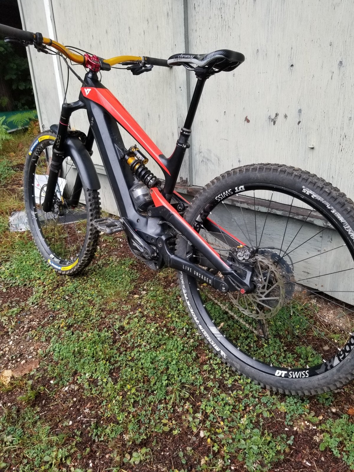

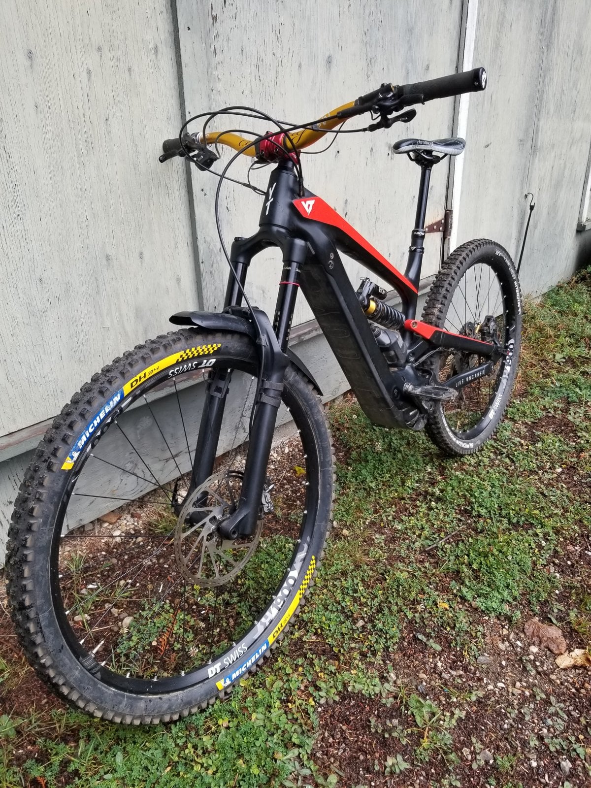

Back in action!! Added my new warrantee motor and put on my saint brakes(220f/203r avid rotors) and swapped out the rear ewild to a rockr2(gapped and put it on backwards oh well ill kill it in the bike park soon enough anyway). Rockr2 2.35 is michelins best tire evaaaarrr and theyve discontinued it. It measures like a 2.45 maxxis would and chainreaction still has stock. Id recommend people buy them up and message michelin on social media that you did and theyre making a mistake, a big mistake. They prob won't listen as they have shitmano ears ,and operate in a bubble,but worth a try.
Also props to yt north america, in particular Shaun in Cali, for stepping in and making a call to shitmano to get me another bic pen of motors. I appreciate his common sense and straightforward approach.I really hope yt can get a ytmill/demo/service centre in canada. Wish theyd go bosch too but that might be dreaming. Ill continue to send friends to buy their acoustic bikes but the friends ive sent to cube for a good bosch cx equipped bike are stoked. Ex nat champ moto trials bud bought 2 for him and the boy and theyre back on a mtb/emtb and super pumped despite having fancy new mototrials and enduro bikes.

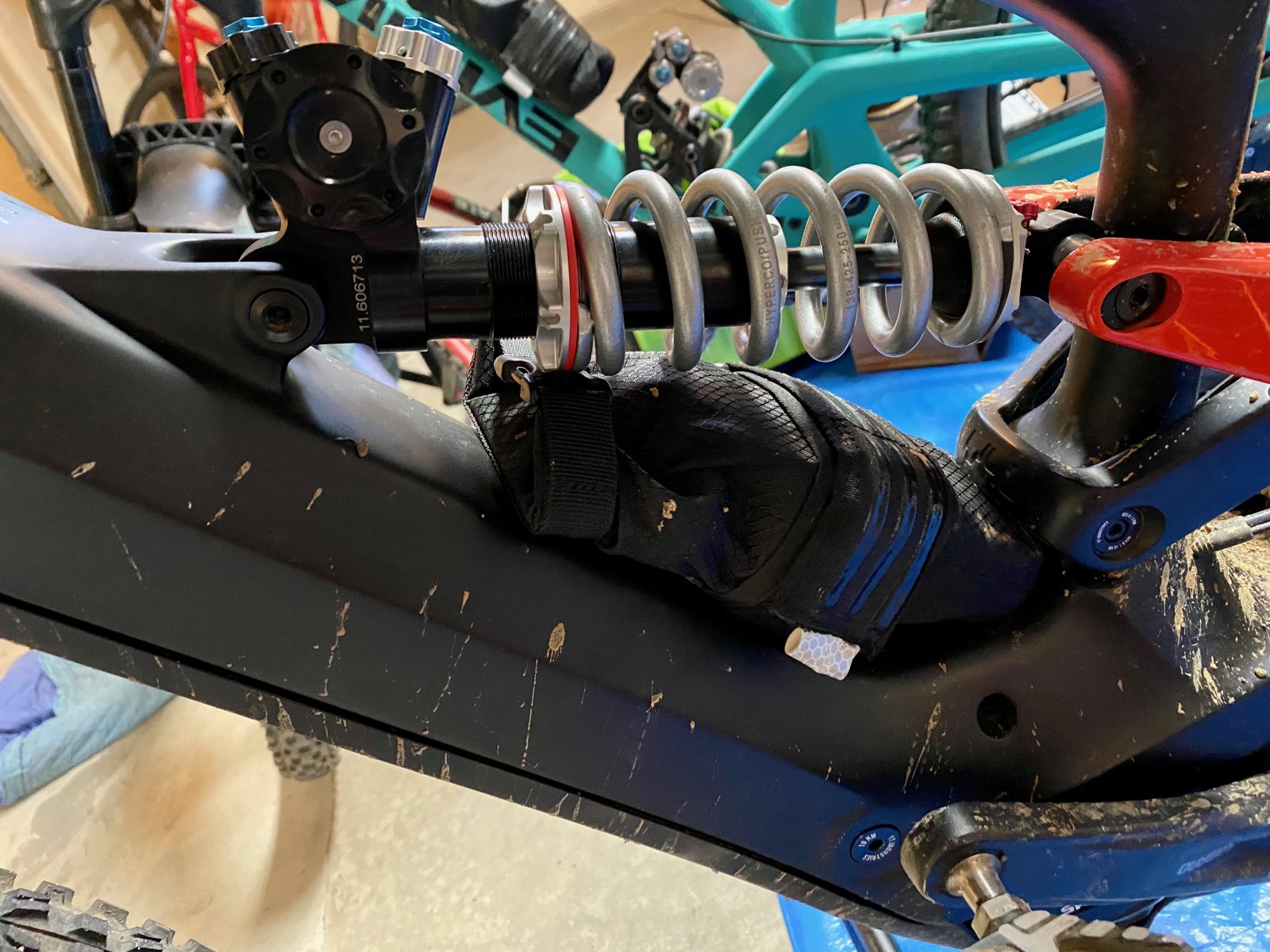

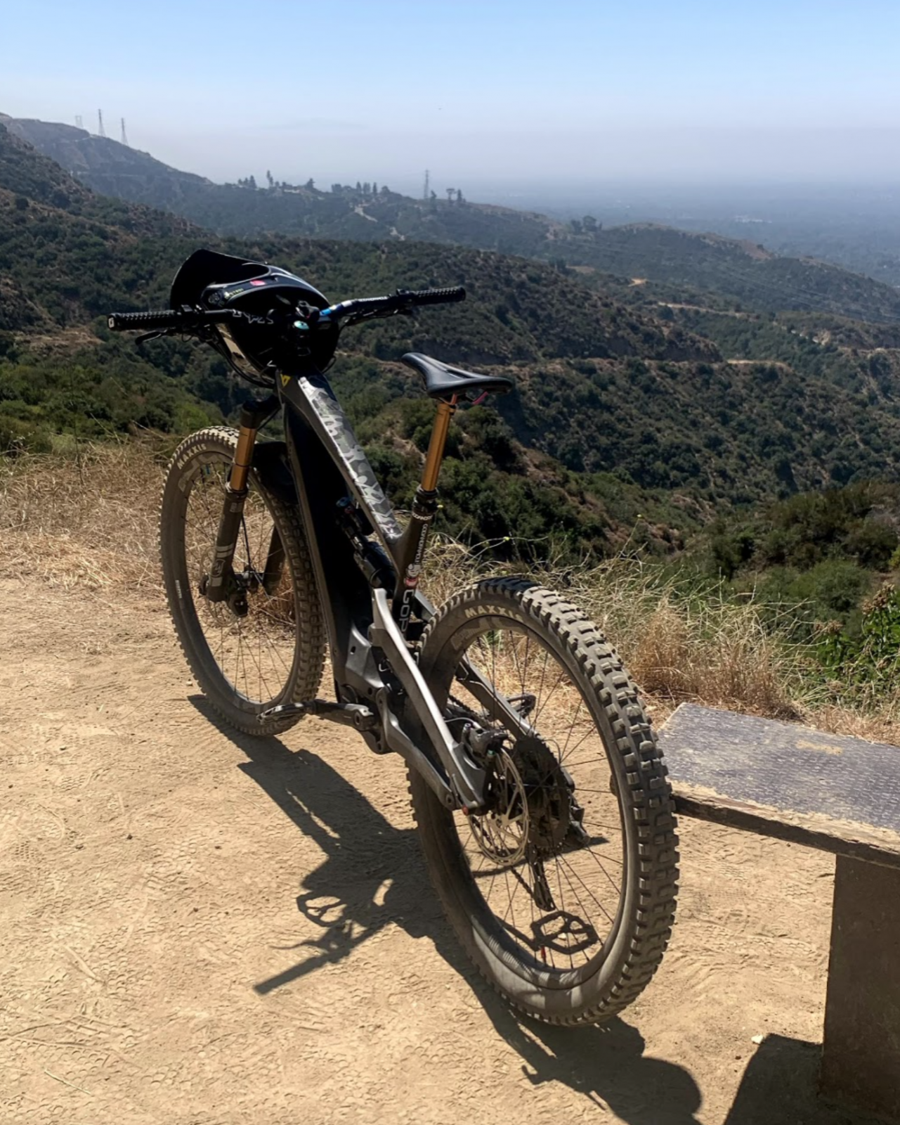

UPDATE:
1) Debonair Upgrade is so worth it on the YARI - Everyone needs to do this if you have the Base model.
2) Custom Decoy Ridewrap installed- Takes a while and I didn't do the best job but at least the Decoy is protected
3) New SQLab 12deg Bar and Chromag stem installed - First ride today and the first time every that my bad wrist did not go numb!!! Win.
4) Fox Float X2 installed and had 3 rides on it.. what a difference... (Also have the flip chip in High Setting) No more pedal strikes and bottom outs.. Feels like a DH bike on the steeps now.
Pics from my ride today.
About ride wrap.
How did they handle the weld bumps in seat and chain stays? I can't really tell by the pics and RideWrap seems to be ignoring my info requests.
