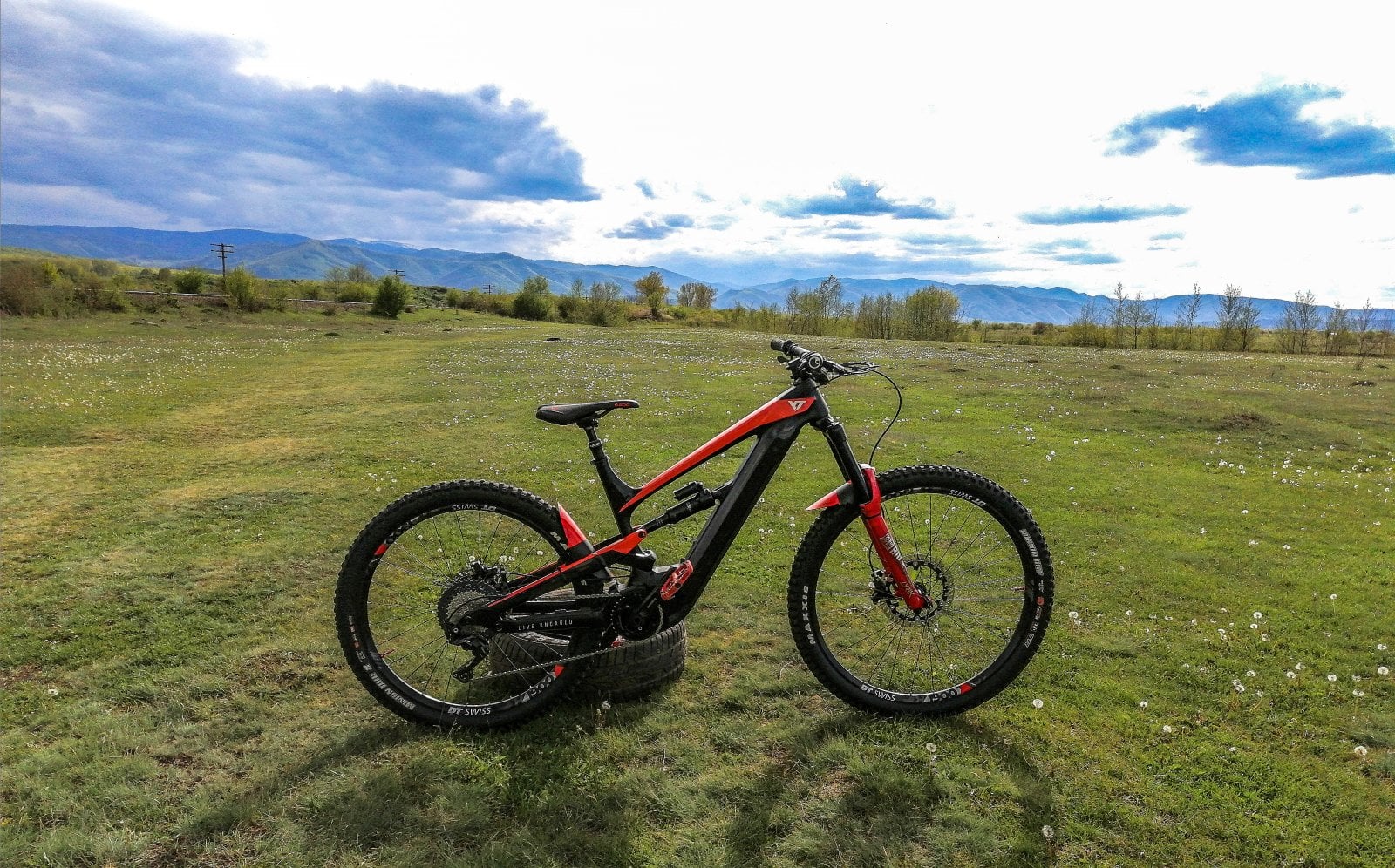

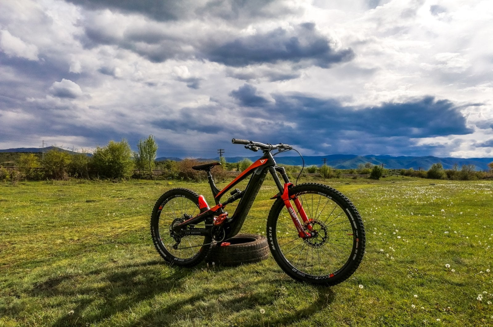

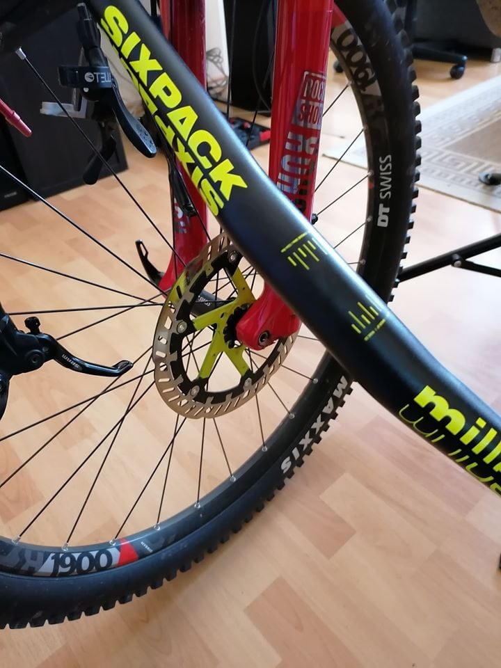

My Upgrades:
1. Fork- Rock Shox Lyric RC2- upgrade to 180mm- the bike its more plush, The BB is now with 1.4cm higher
2. Brake:- Magura Rotor 220mm Front/203mm back
-Trickstuff pads for Sram Code R- now i have more power with this pads and rotor disc
3. Handlebar: SixPack Milenium -800mm- I like wider bars
4. Rear Shock: Rock Shox Super Deluxe Select buyet with 200euro (new)- The bike is more stable on high speed, more confortable
5. Pedals: One Up nylon....super grippy
6. Rear Derailleurs: Shimano XT, more precisely, more durable
7. Grips- Ergon GA2- I have big hands

You got trick stuff brake pads, may as well get their full brake set now. Would be drool worthy.

Sorinok ...
Great job with the color matching scheme. Nailed it.
Modifying a bike and having it look great is a true form of art (not to mention expensive .. but that what money is for .. buying "essentials" .. aka bike parts :cool:(y))

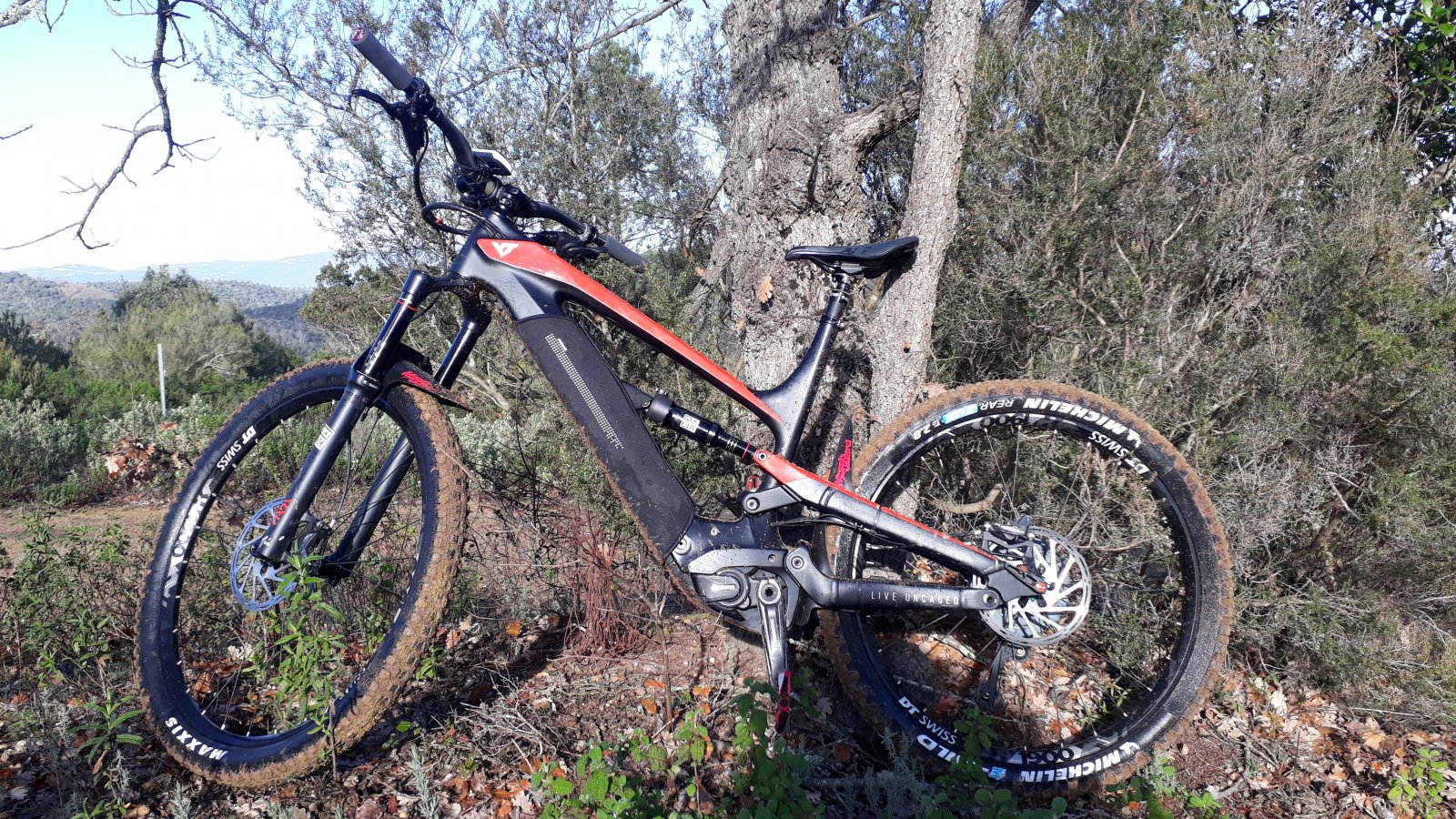

My XXL decoy base is upgraded or changed with:
* Specialized Power Comp sadel (one of the few that i really can spend some time on)
* Renthal Fatbar carbon 35mm Riser stuur 35.0x800mm 40mm-Rise
* Debonair upgrade kit Lyrik (170mm) + Charger 2.1 RC2
* Mashguard plus Mudguard (1-front, 2 rear to protect frame from pebbles crushing in the swingarm.
* Michelin 2.8 E-wild (back)
* esi grips
* Basil Integrated battery cover
* Crankbrothers Mallet E Enduro
* Leyzne Macro drive 1000 (enough light for me)
For me the upgrades to the fork were essential. It improved the performance of the fork so much and thereby my enjoyment. I am 1.93m and 100kg without gear so I generally have problems with shocks and fork being hars due to the high pressures I have to run. But that wasnt the issue here, the 2.1 damper is just so much better than the stock Yari one. I also wanted a little more bar rise since I need to elevate my saddle very high and this is just so much more relaxing position for me. Increasing the fork suspension lenght to 170mm enabled me to run in low setting while not have peddle strikes, because I am not that good without some height....
Changing to the Michelin E-Wild was a good decision for me as I do mostly technical climbing and descents, but high speed downhill I do not. I need to run 1.4 - 1.5bar to prevent that weird feeling in 'heavy' cornering. Tire has very good grip. Did some climbing whereI normally would have spun out. Have a feeling that the tire is also more economical battery wise, but I am not sure.
I also have a battery cover for if the weather is particulary cold, like in the picture (2oC) in December in France. You will have to cut it so the velcro can have a space for the rear suspension. It seems to work really well and it keeps dirt out of the battery department and when transporting the bike without battery on the bikerack!
Pedals from Crankbrothers. Best from both worlds for me. Can be clipped in, as I have been doing for the last 20 years (spd), but if trails become so technical I can still find a foot hold with the pins. Like the float and release also more than my Shimano SPD clips. And the red color is nice!

Nice, reminds me of Jordie Lunn's (RIP) Decoy, which was my favourite build out of the factory riders. Fair few of them run a 27.5 on the front.

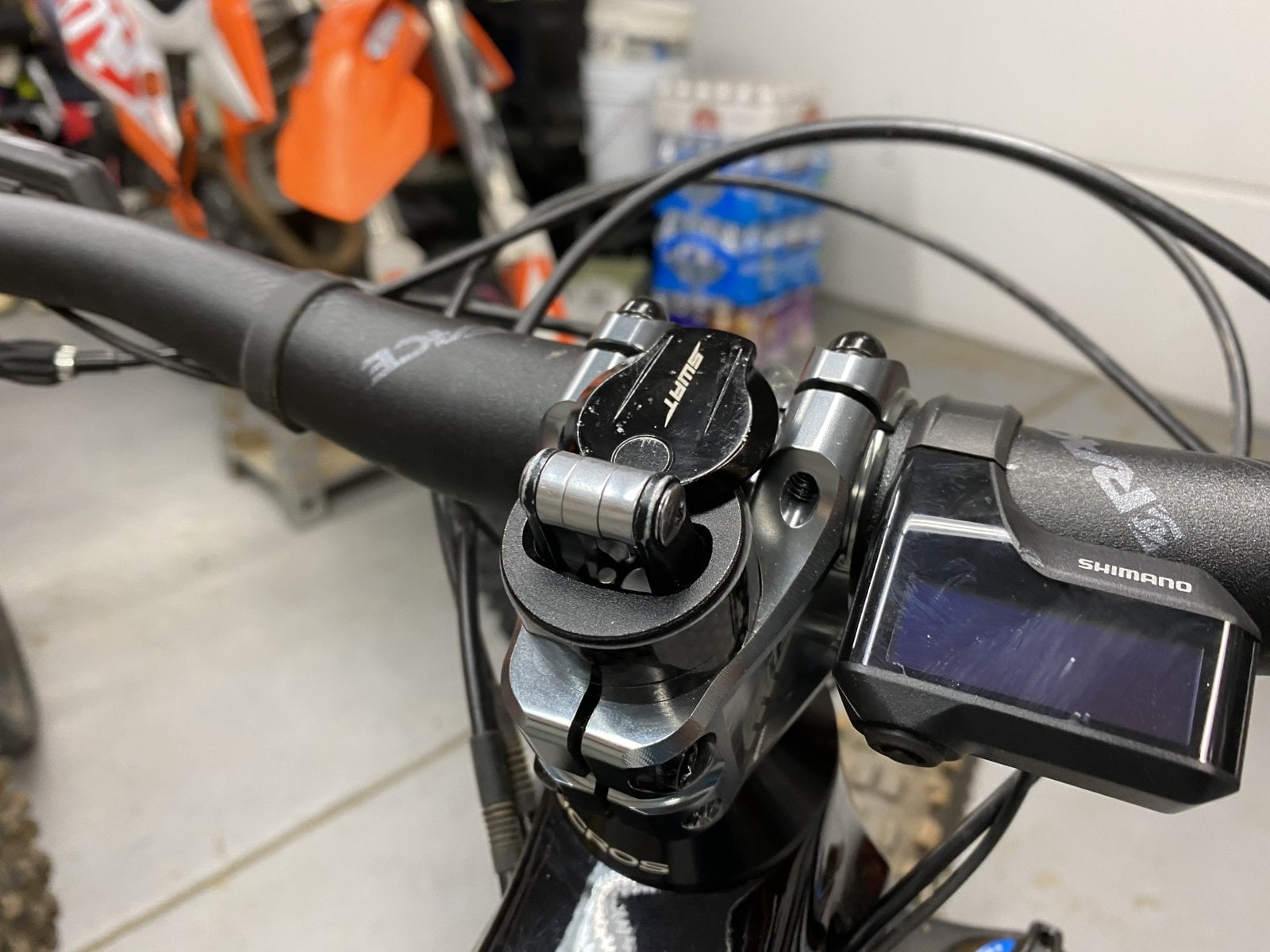

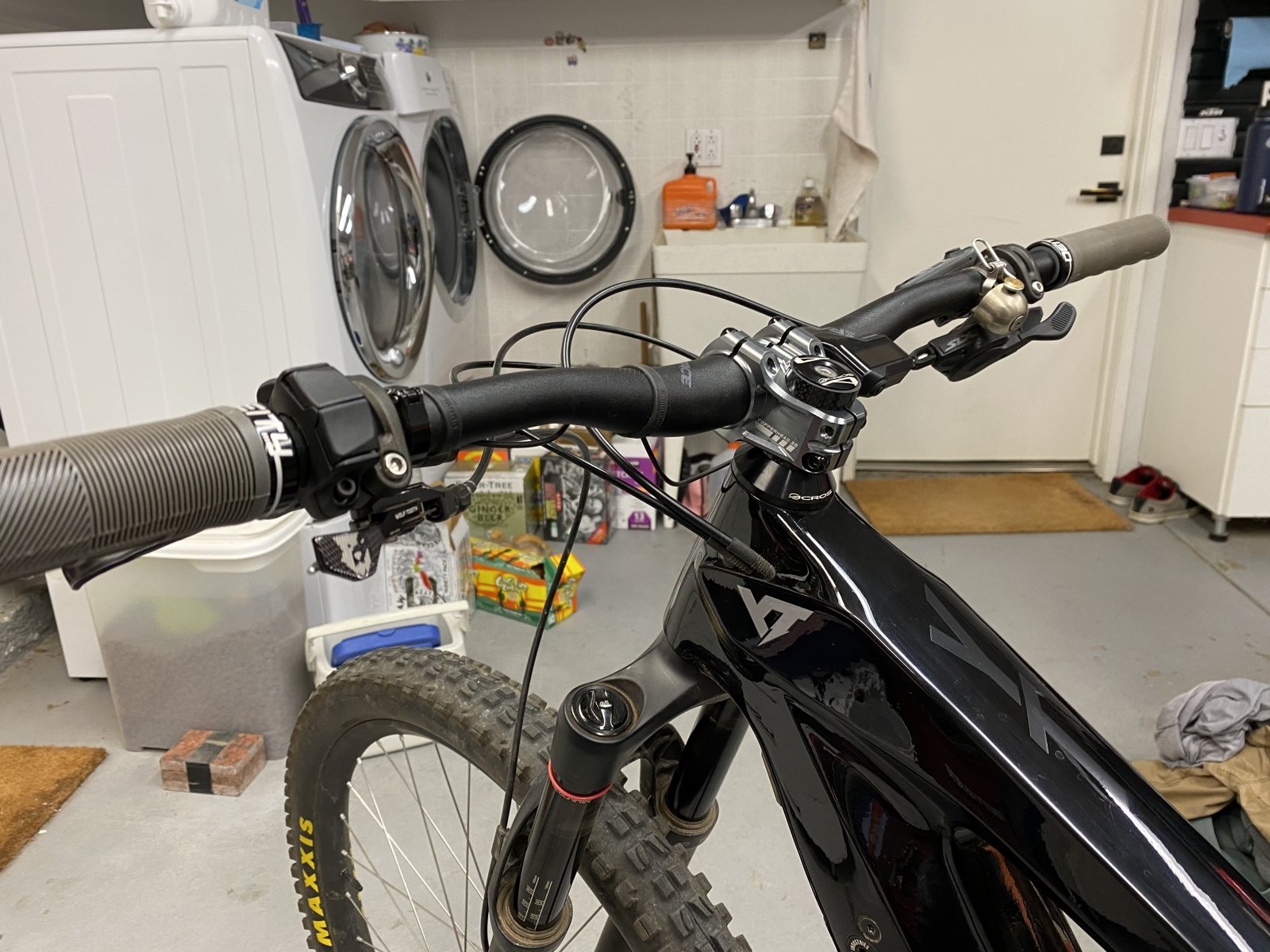

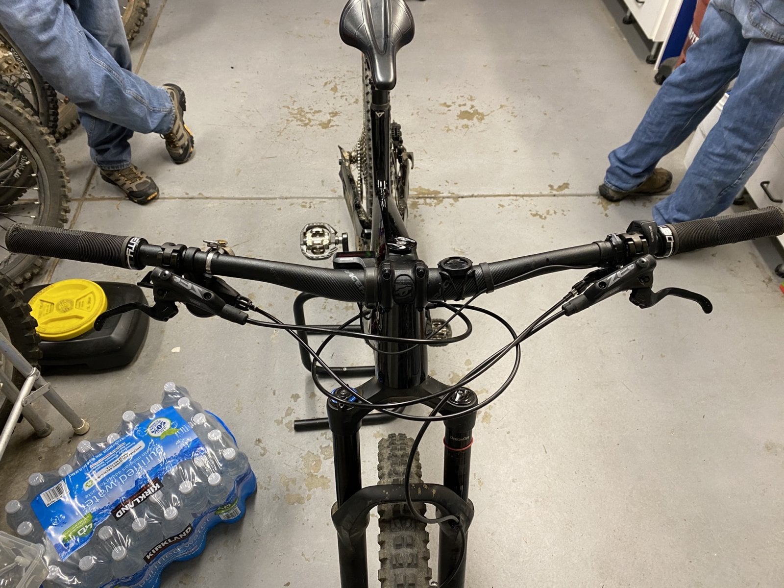

Deity 35mm length stem and new grips.
Will test out the shorter stem tomorrow, but kinda wishing I got a 31.8mm bar/stem combo, as I’m not sure I like the added stiffness of the 35.

rb .. that wolf tooth lever and deity stem blend in perfect. Nice work (y)
* like the bell too … our riding group used to use bells as well. We called it the "send it" bell (whenever a big trail feature was coming … ie jump … you would hear the bells ringing before sending it - lol. When you heard the bell ... you always knew something good was around the corner)

Look at the oneup bars, they are made to be much less stiff. I also ran the deity speedway bars which I also felt provided more flex.

Thanks. I’m liking how everything is looking and matching together, but still being subtle and stealth. Having all your components anodized purple is not my style. (Personally I’d prefer a loud solid colored frame, and then all black/grey/silver components).
And yeah, the bell is half for hikers and half for playing around with buddies. Unfortunately I like my brakes close to my grips, so there isn’t room for the bell in between. Right now I cannot really reach it while riding at a normal speed.

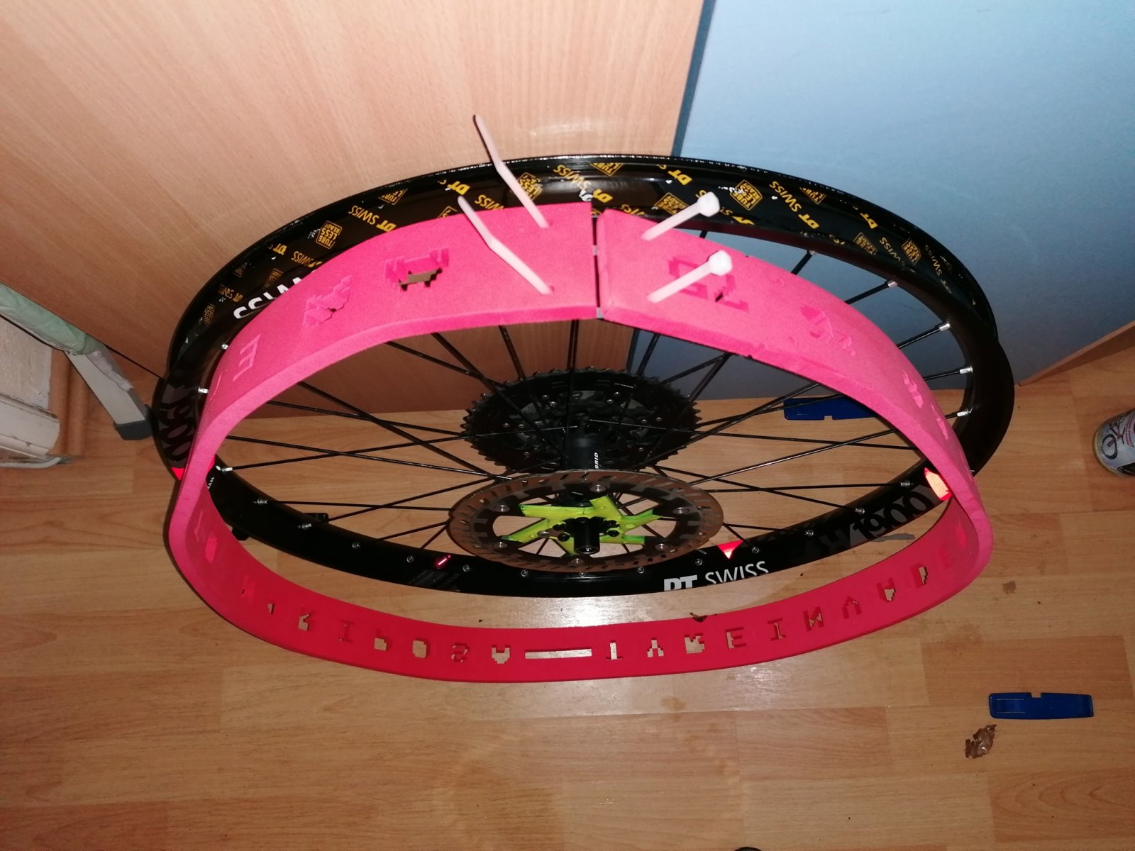

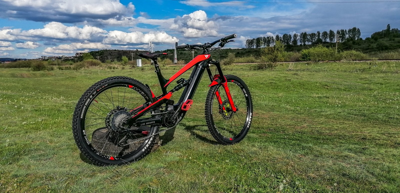

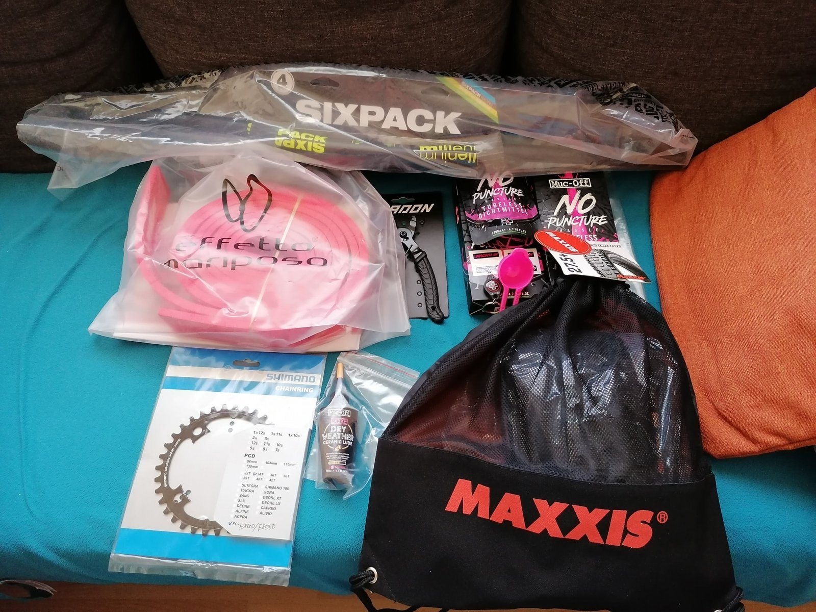

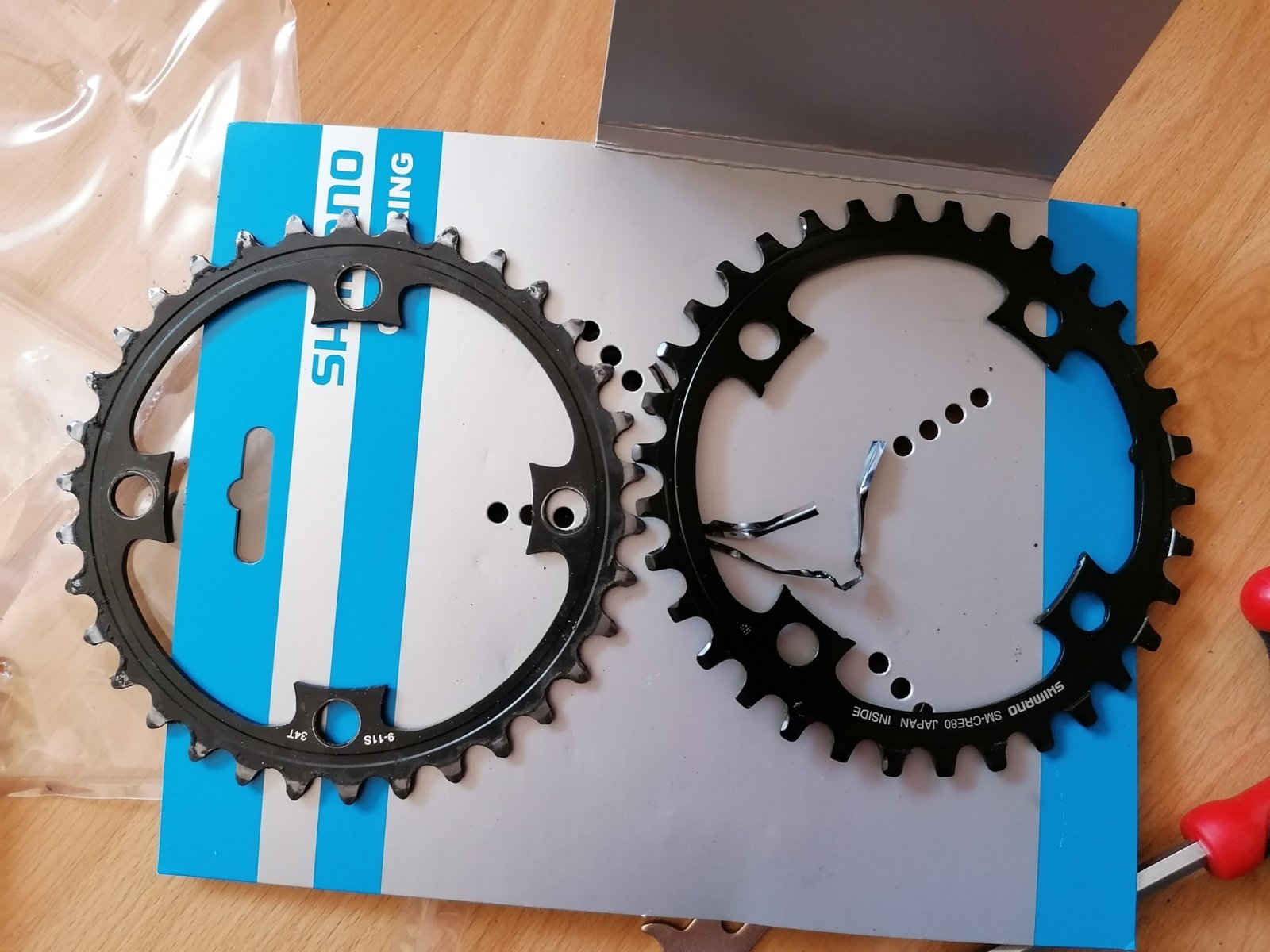

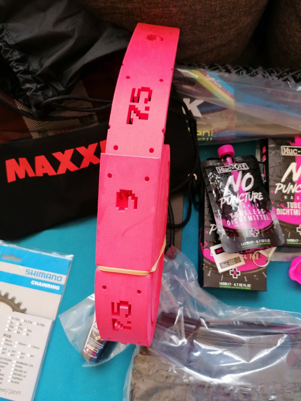

What i buy for my Decoy:
-Steps SM-CRE80/SM-CRE80-B Chainring - original is dead on 2800km
-Minion DHR II+ Rear 27.5x2.80" TR EXO+ 3C MaxTerra 120 - like original tyre....2800km end it is ok
-Muc OFF No Puncture Hassle Tyre Sealant 140 ml - i think is goog
- Effetto MariposaTyreinvader Puncture Protection55 (RIM: 30-40mm) - easy to put on rims, the tyres are now much stiffer. I still haven't ridden a bike so I can form an opinion on how it behaves.
- Handlebar SixPack Millenium 825mm- It remained at the original size of 825mm, I want to test how I feel on the bike

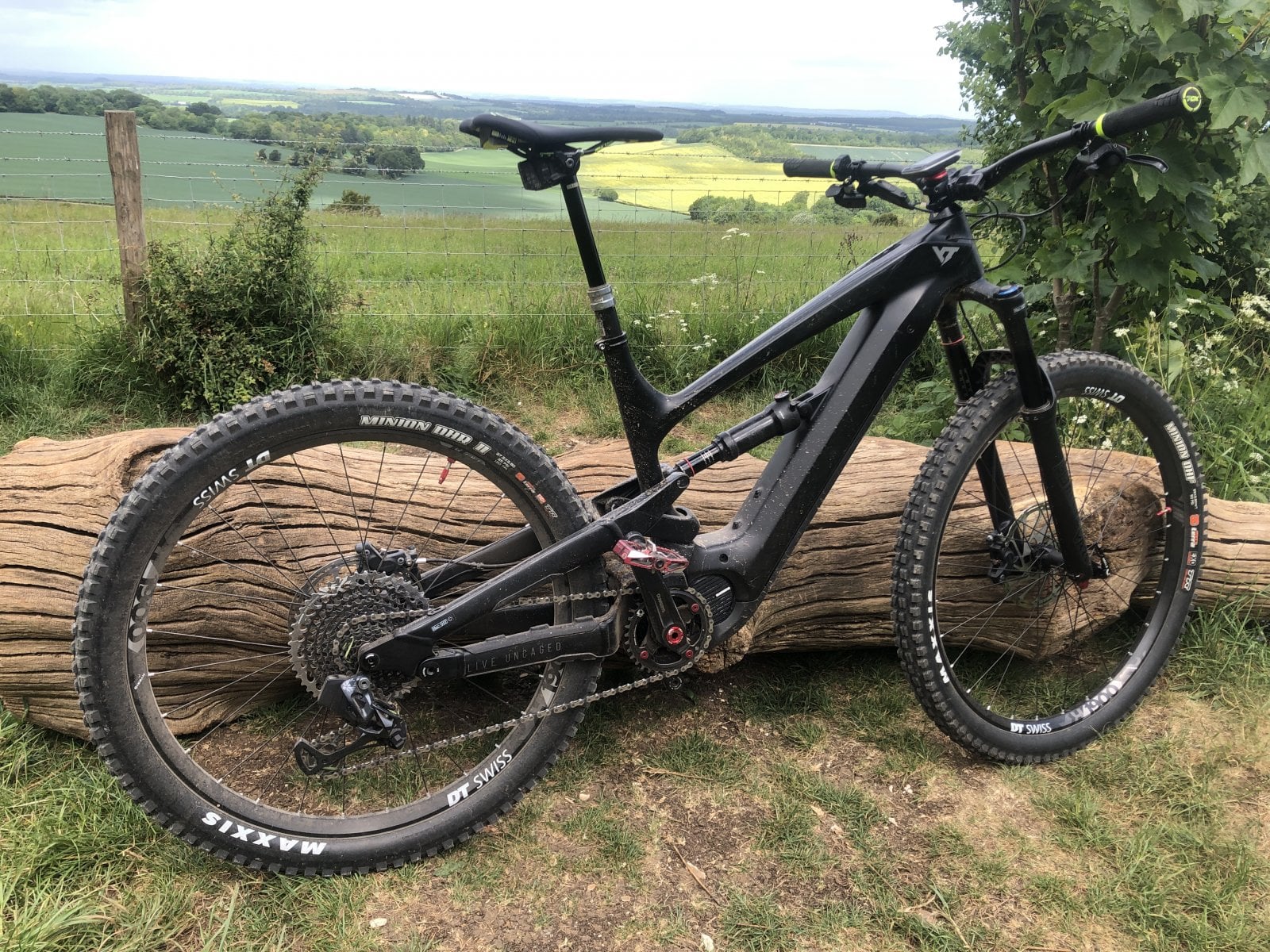

Upgrades to my 2019 Decoy Base
1. SRAM Eagle XO1 AXS Transmission - migrated from my analogue bike, flawless shifting and a clean cockpit.
2. SRAM Eagle 104BCD chainring - for maximum compatibility.
3 Rockshox Reverb AXS - also from analogue bike, again clean cockpit and instant dropper response.
4. One Up Carbon bars - Ali Race Face bars way too stif no more sore hands.
5. SQ Lab 611 ERGOWAVE Active saddle - Measure your sit bones, get the right size saddle whatever the brand, it makes a hell of a difference.
6. SQ Lab 70x grips - nothing wrong with stock but they do match my saddle well.
7. Crank Bros E Mallet LS pedals - avoids scuff marks on the crank arms and frame.
8. Red Crank and Chainring bolts - who doesn't like an accent colour?
9. Non brand Garmin top cap mount - red of course! Keeps the Garmin safer if when I crash!
Future upgrades when the cash flow is built back up again.
1. 2021 Debonair spring possibly 170mm.
2. Charger 2.1 damper.
3. SKF wiper seals - when I do the first lower service.
4. Hope E4/V4 Brakes - not getting on with the codes. when I pull the lever I like to stop in an instant. Guess what colour?
5. 220mm disc rotor up front - I am a large mass that requires a lot of effort to stop.
6. Garmin Edge 530 - upgrade for my Edge 800, better connected features and Steps/AXS capable.

I am new to this forum but I’ll contribute to the thread. Upgrades to my 2019 Decoy Comp (?):
1) ZEE brakes. The CODES just didn’t do it for me. Not enough power The ZEE’s are better but I’m going with the previous recommendation on this thread and going to add Galfer 223 rotors front and rear.
2) ENVE 780mm bar. I can’t stand aluminum bars.
3) Renthal 50mm stem
4) Cushcore. Need I say more? Possibly the best upgrade, period.
5) ERGON saddle. Why not?
6) OURY grips. Best grips I have ever run for my hands.
7) SDG 170mm dropper post. My 150 failed after 2 rides and YTUSA replaced it free of charge. But i asked , why not send me 170? Done! Now I want a 180 or more.
Planned upgrades:
1) drivetrain. Debating Shimano vs SRAM. I am of the opinion that the emtb puts a lot of stress on the drivetrain and cassettes will wear super fast. I want the strongest components available. But I do enjoy the 9/46 of Ethirteen.
suggestions?
2) coil the rear.
3) DSD (Diaz Suspension Design) Runt.

Best upgrade yet. Specialized steerer swat tool. When this first came out on my 2018 enduro I thought it was dumb. But once you own one (or a 1up) you’ll realize how convenient it is.
