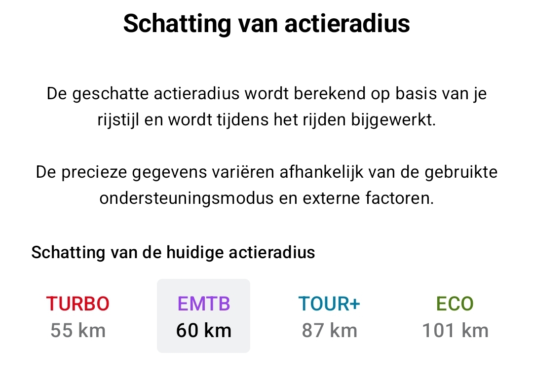

Yeaj, think you need to try and completely deplete the battery a few times too...
Mine was chared back from a 35k ride 2d ago. Tomorrow 60k's again... (battery was at 70% btw after that 35km road/xc mixed use)

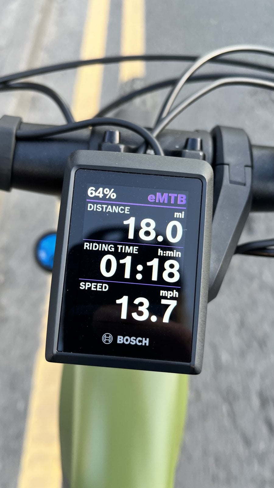

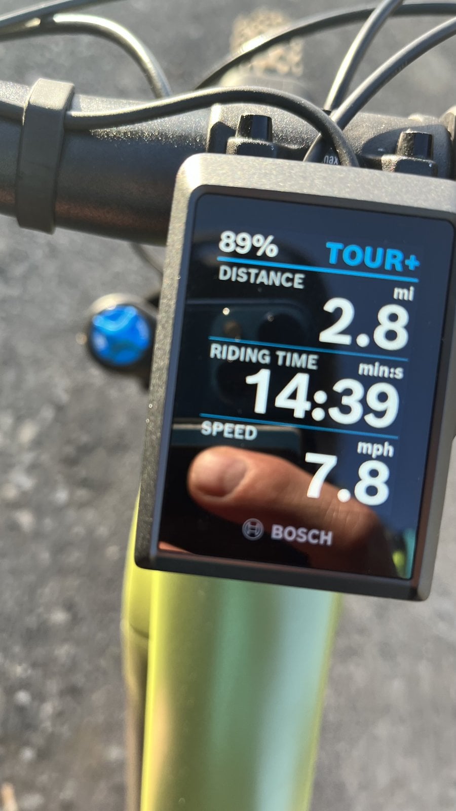

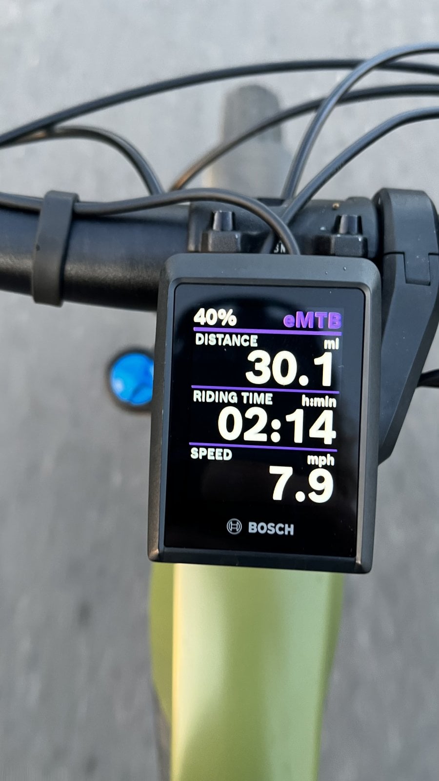

UPDATES. When I originally posted this I was very disappointed with the range! however! I’ve just been out for a good ride and surprisingly battery hasn’t done very well! Not sure if it’s anything to do with the amount of charge cycles or the Latest software update? I’ve managed to get 30 miles mostly in EMBT mode. With 40% left! I think it’s fair to say on a full charge I will probably get 45 to 50 miles. I’m happy with that. I didn’t notice the first 10% does drain extremely quickly but it seem to settle once I got into the ride.

UPDATES. When I originally posted this I was very disappointed with the range! however! I’ve just been out for a good ride and surprisingly battery hasn’t done very well! Not sure if it’s anything to do with the amount of charge cycles or the Latest softwareupdate?
What did you manage mileage wise? So still disappointing?
Edit - I see you’ve edited the post, was confusing as you mentioned battery hasn’t done very well but in fact it seems pretty decent!
Just under 3 miles in to ride and 11% battery down… It worried me at first but I just kept on going ….. I’m extremely pleased with the range. Next weekend I will full charge and ride until flat again to see what I get. when I did it before I got around 30 miles on full battery today about 30 miles with 40% left. !
Very interesting I wonder if it’s a software update?

For what it's worth, calculating the amount of charge left in a battery is a bit of art and science. It's possible that the gen 2 and gen 4 use completely different methods that make it difficult to compare apples to apples.

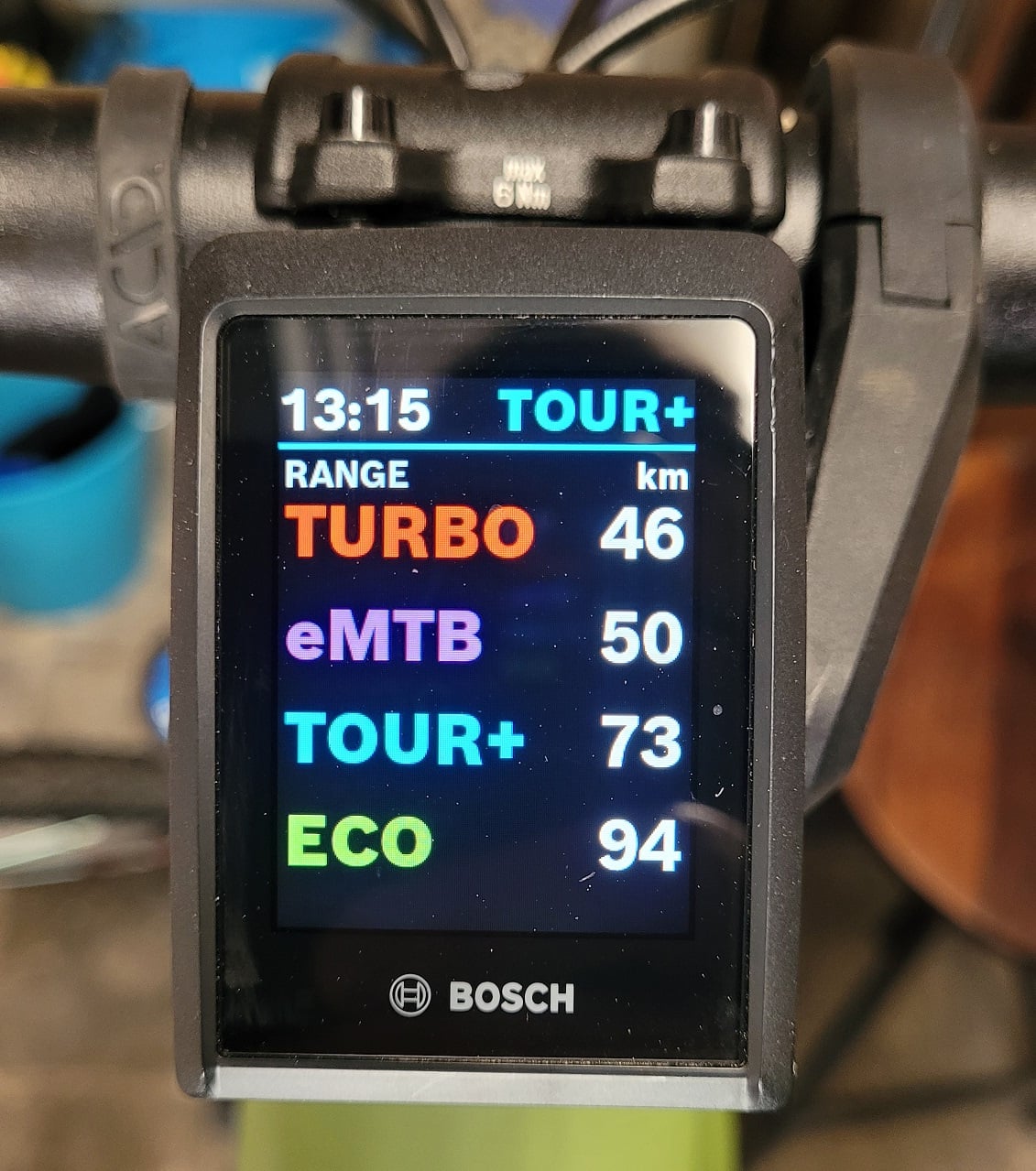

Can I ask when your bike is 100% fully charged , what are your ranges expected ranges Eco, tour+, EMTB and Turbo ? The highest mine has been in eco is 55miles ! According to the range calculator on Bosch , should be at least 72 miles ?
I’ve done 5 full charges and the ranges don’t seem to get any better
tommygun
Apr 3, 2022
12
8
Rome
Sure, I'll charge it back again at 100% and post the results here, didn't have the time to do it yet.
But I'm pretty sure that it will show a lot less than 55mi in Eco... but I'm also quite convinced now that it actually provides more juice in the real world than it declares on the display.

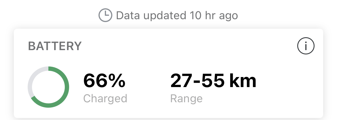

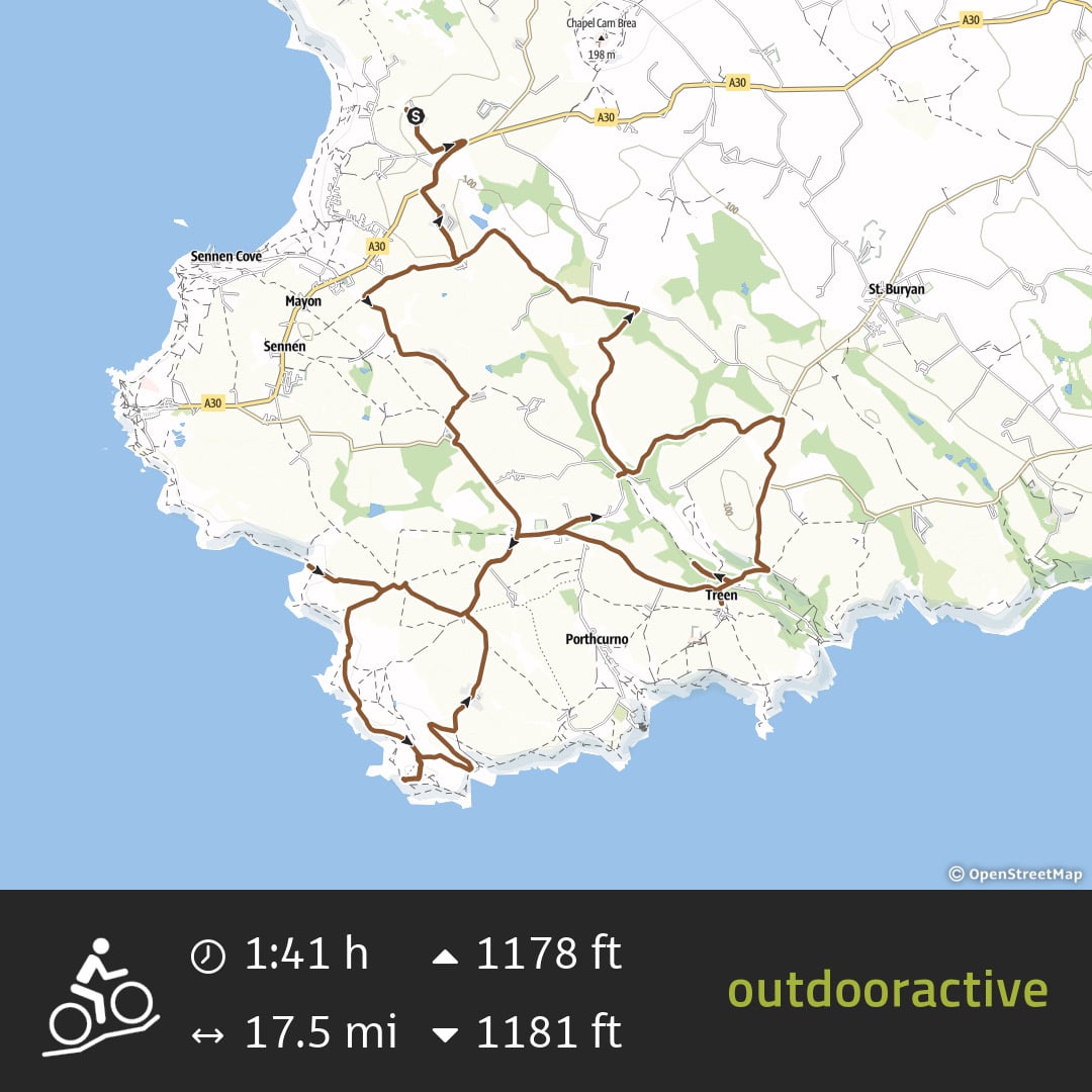

17.5 miles yesterday, modes everywhere from Eco to Turbo depending on the steepness of the hill in question. Mixed road and off road.
66% left in the battery, up to 55km range left.
Things are definitely improving.
