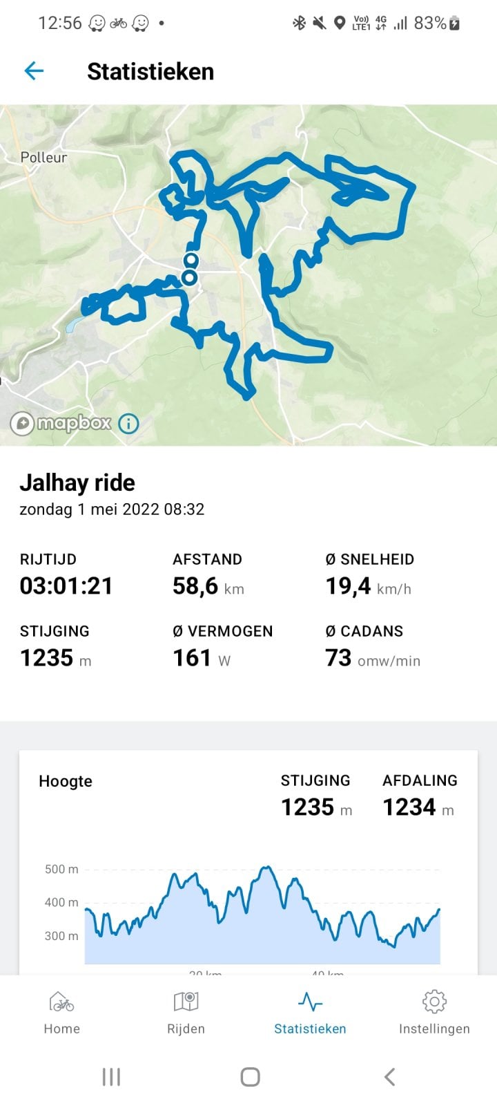

Did this tour today on tour+ mostly. Last 20km i went on emtb because why not :)
Quite happy with these numbers tbh
Cube hybrid stereo Actionteam 140, changed tires to nobby nic and made em tubeless
I only speak french and english. I undertand you did 58.6 kms in just over 3 Hrs but many words i have no clue what they mean.
Maybe your cadence was 73 on average? ???
What is your opinion about the Nobby Nic?

Was 1235m elevation avg speed abt 20km/h
Tires are good. Roll alot better then the original big betty and magic mary. For non enduro stuff they were overkill anyway...
I ride normal trails and the Nobby Nics do just fine for now. Only did 3 rides with them so far...
How much battery left after that ride?

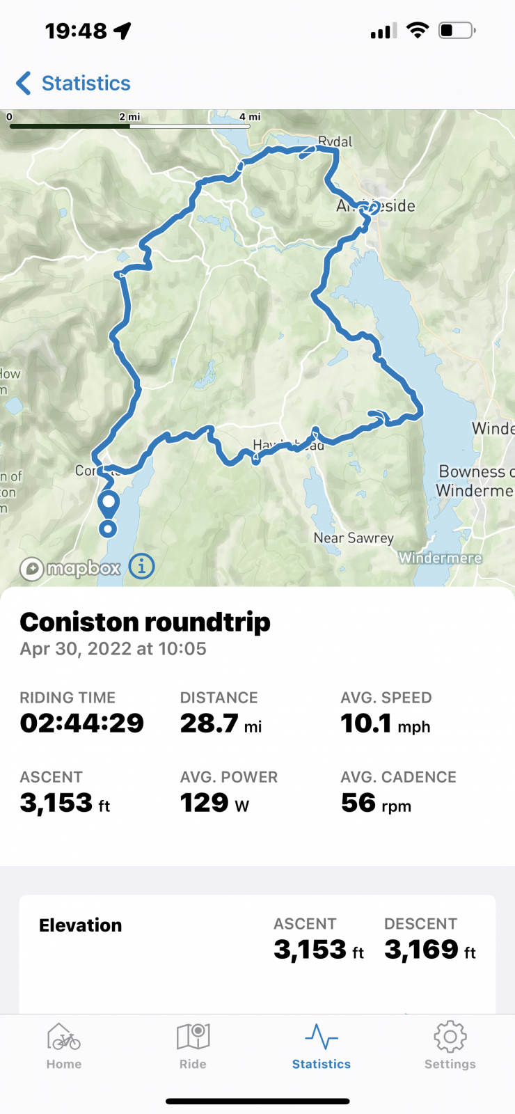

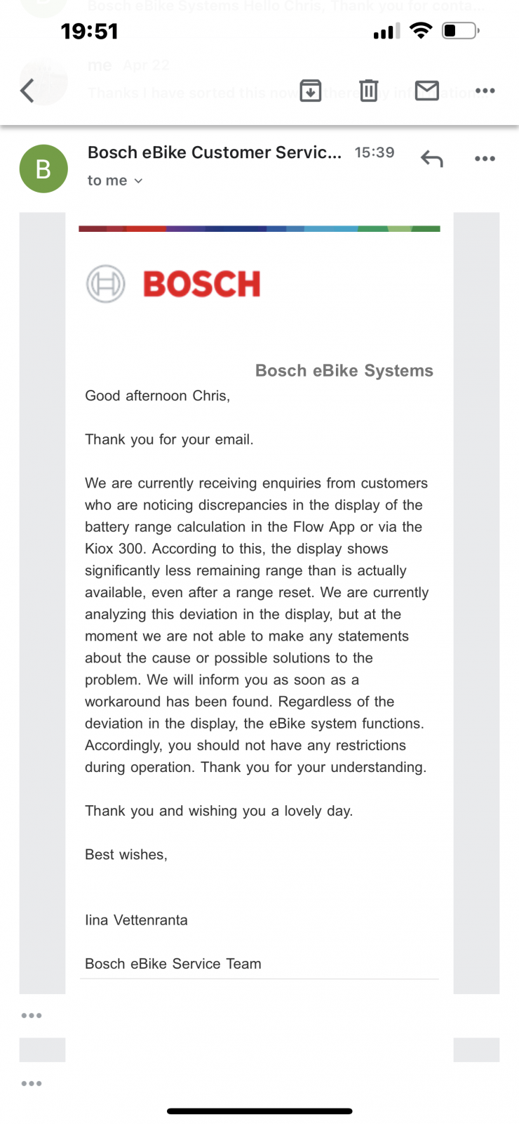

I’ve done approx 34 miles from 100-% on a 750 battery, battery now down to 35 %.
Bosch emailed me today …See pic
My battery drains rapid, even after 1mile , it starts to drop.quite frustrating after spending £5300 on an new eBike with Bosch smart systems. Really hope Bosch get there’s arsed into gear , and get this update sorted ASAP
How many charges did you do? I bet you get another 10miles easy from 35% to 0
Will be more after that. Battery needs to settle a bit too i heard
Did you also do the latest update?
Yeah I did the latest update that came out a couple weeks ago, think I’ve done 4 full charges.
If you go on the range calculator from Bosch , even with worse case scenarios , start up eco mileage is 77 for my weight and how I ride.
There’s a guy on here quoted he was 100 kg, and he’s done 69 miles and still had 23% left.
In comparison with my old bike, 500wh battery, there’s no way my battery % would drop as rapid as this new bike .
