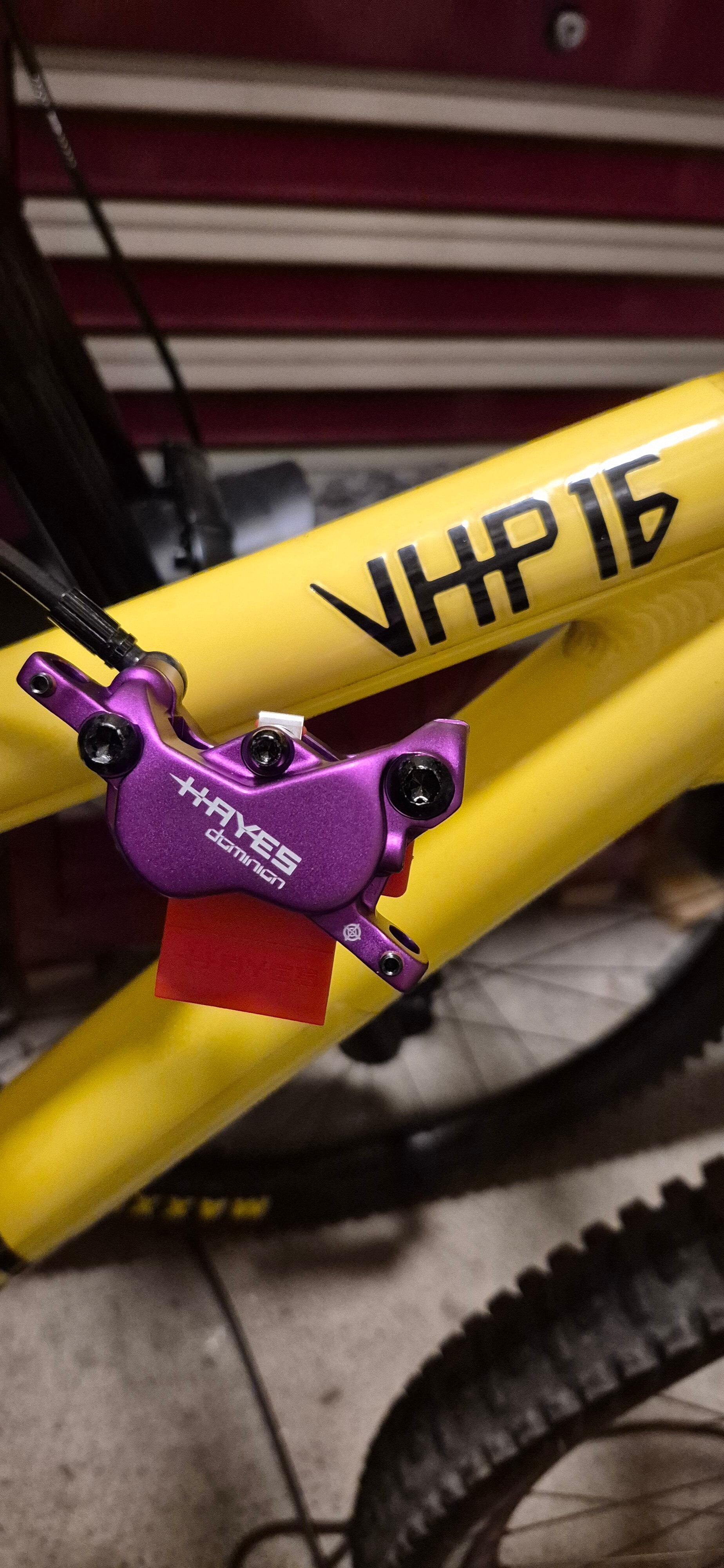

Go straight to Dominion A4s. I left Shimano behind and haven't looked back. Heaps of power.

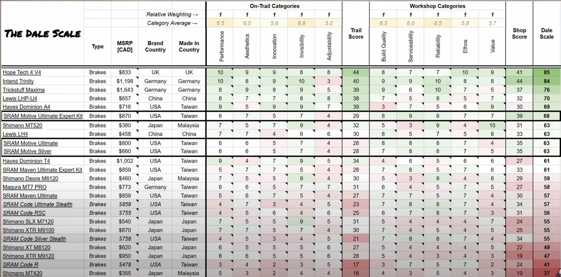

Check out this guy,
These are his latest recommendations..
Budget winner is obviously the MT250, but I would personally get the Lewis LHP, i absolutely despise dot fluid and it is a dealbreaker for me, so no Hayes and no Hope

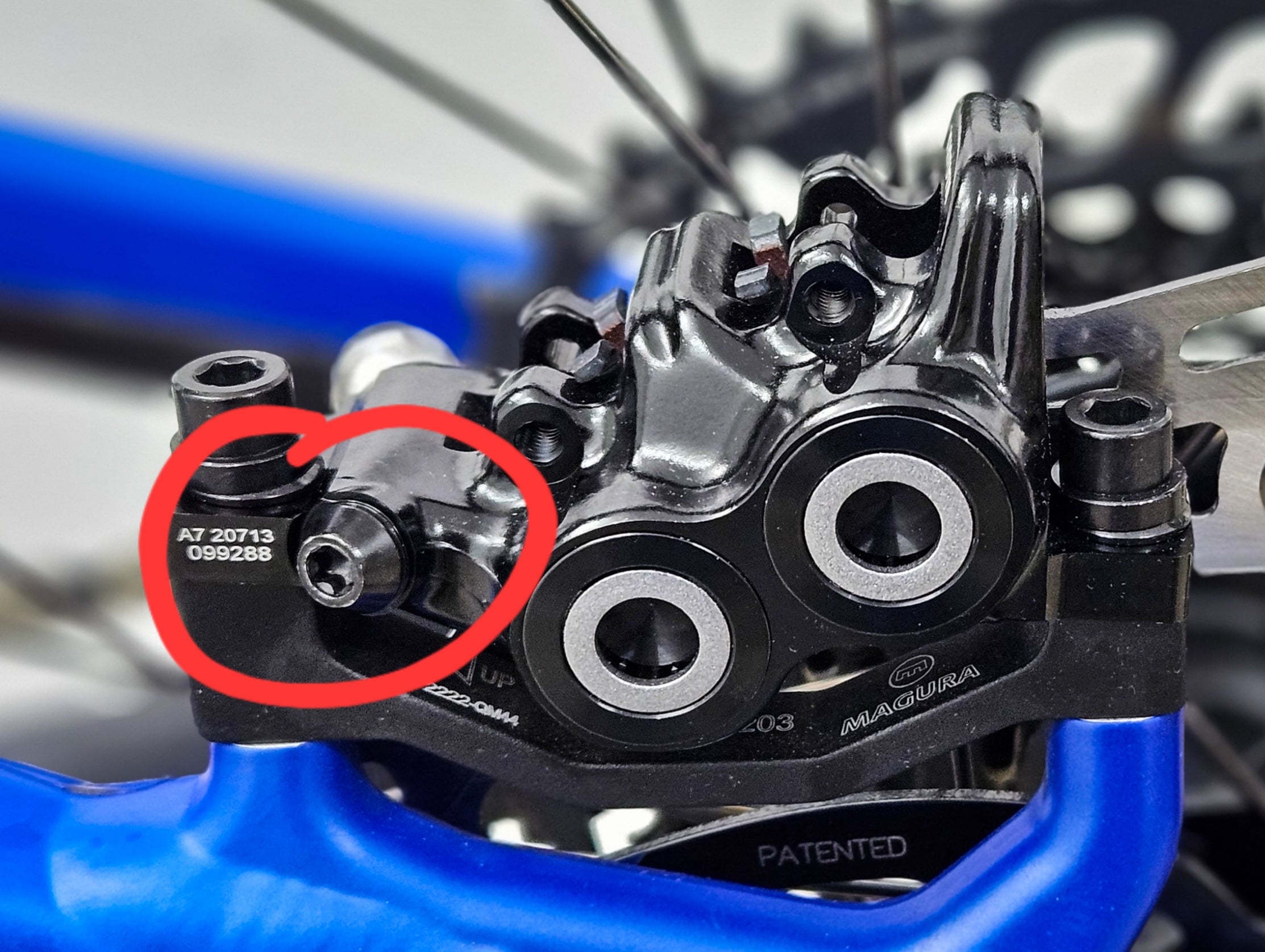

I made Shigura brakes (Saint levers + MT5 calipers) for my wife's Specialized Levo last year. Everything worked perfectly until I bled the brakes this year before the start of the season. Two weeks later, I noticed that the rear caliper was wet and leaking brake fluid from the bleed port (under the bleed screw). The bike hasn't been ridden at all this year.
I removed and inspected the bleed screw (everything appeared fine) and reinstalled it. After applying pressure to the master cylinder, no leak was visible. However, a week later, I noticed the bleed screw was wet again and slightly leaking.
1. Any idea what might be causing the leak? Are there any steps I can take to stop it?
2. Where exactly is the sealing point of the bleed port; at the tip of the bleed screw, or at the surface of the caliper under the screw head? Was contemplating to throw an o-ring or copper washer under the bleed screw to stop the leak.
3. If I’m unable to fix the leak, is it possible to replace just the caliper without having to route the brake hose through the frame again? Can I simply unbolt the banjo and bolt the new caliper in place, or are additional parts like o-rings required?
Any input much appreciated!
1. Are you 100% sure that the leak is there? There is no rubber sealing on the bleed port of the Magira calipers and having leak in that sopecific place is extremely uncommon. Maybe try to replace only the screw. They are easily available.
2. No o-ring is needed. Actually it can be even counterproductive ad the screw will not go entirely in.
3. Yes, you can do that. Pay attention to the very small seal connected to the banjo. Of course, after you need to properly fill the system with oil and... bleed. So good luck :(
