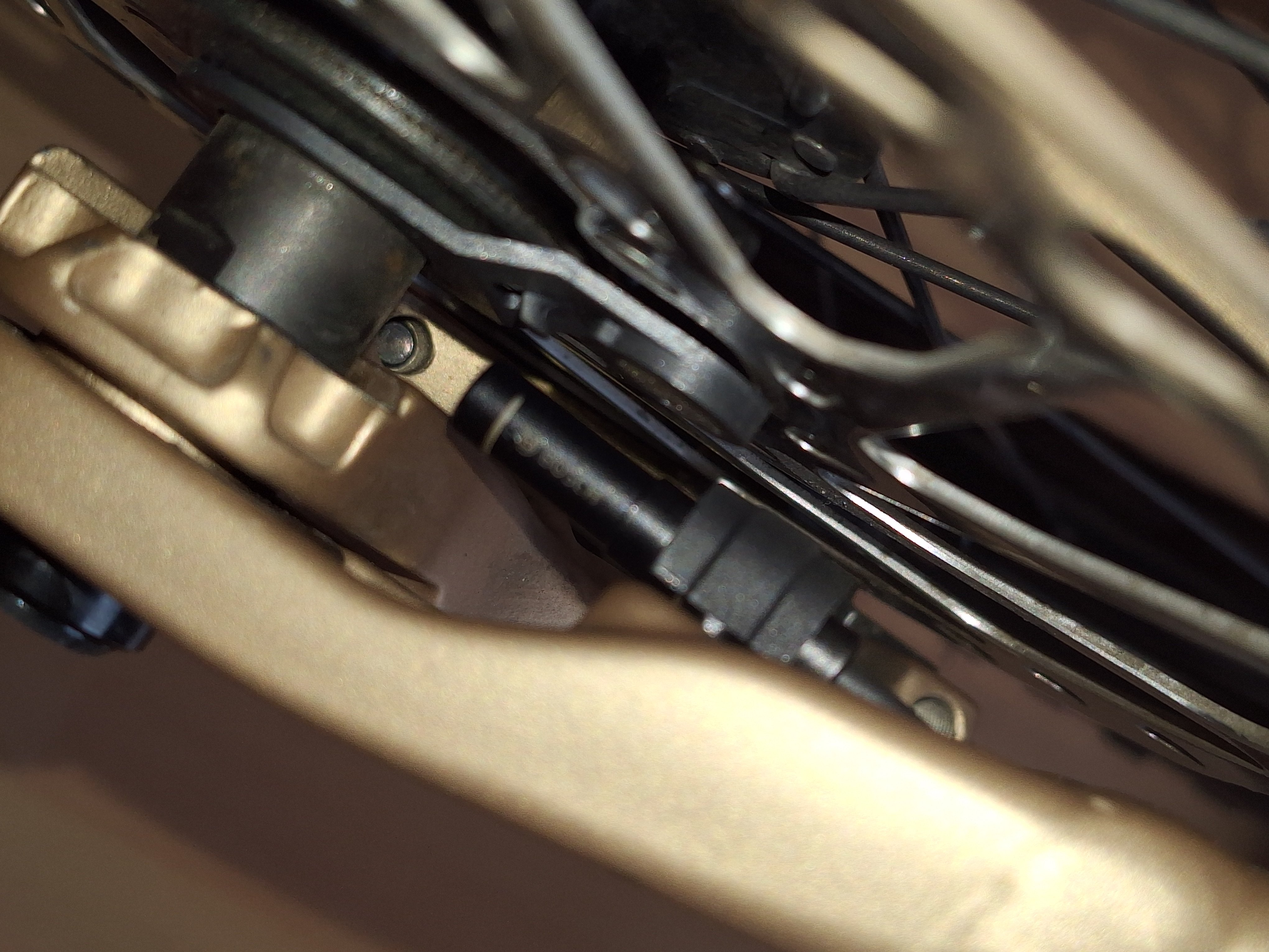

Hi Michael,

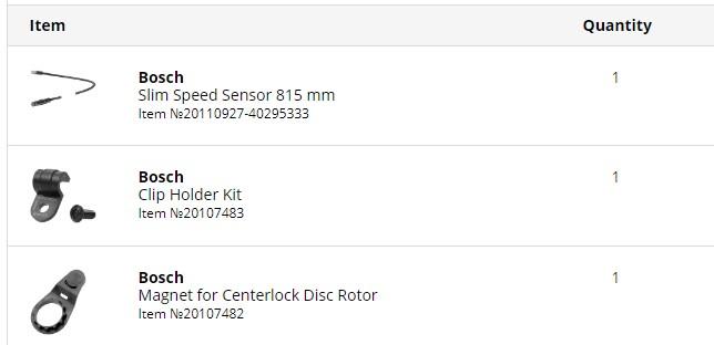

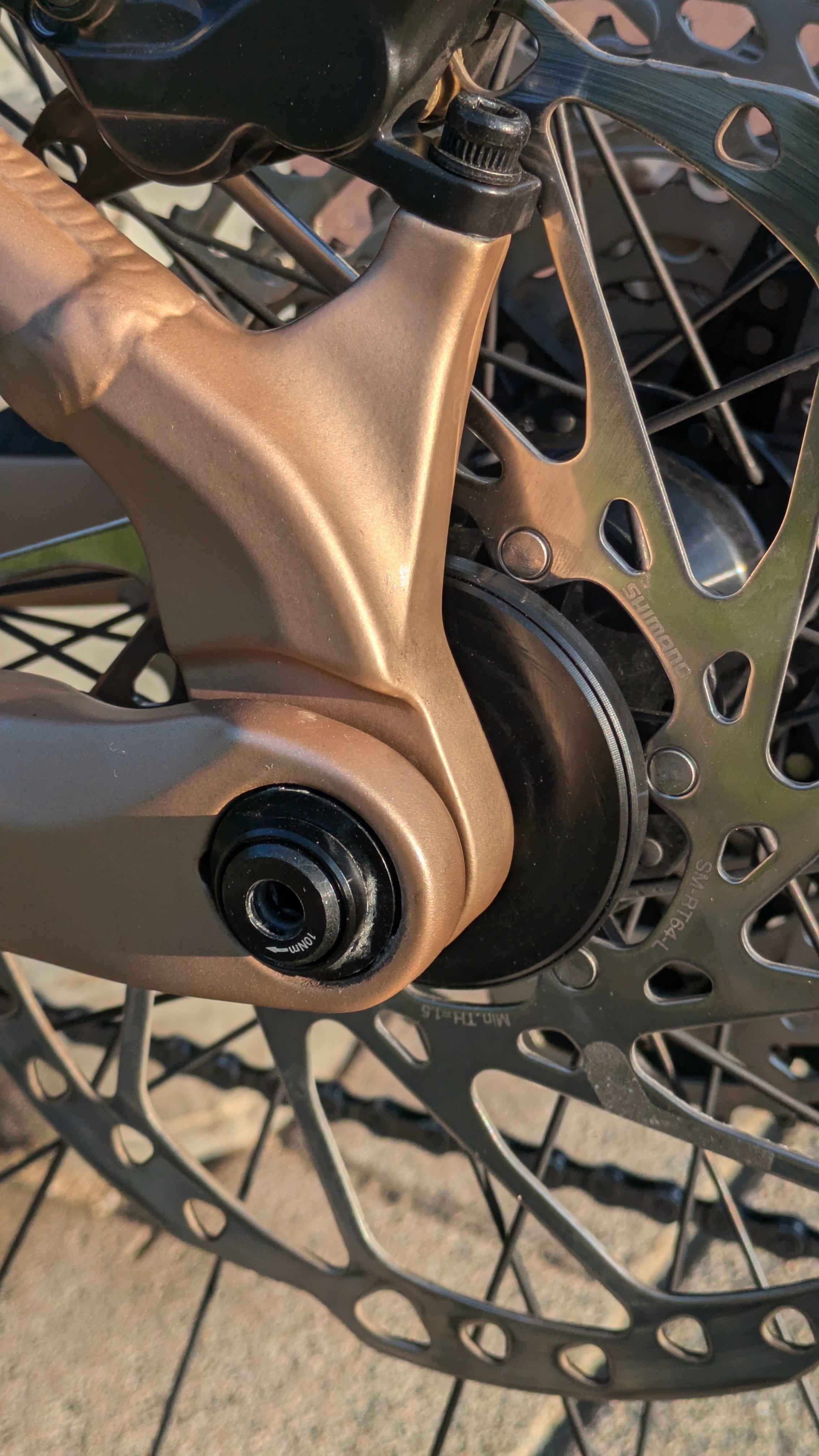

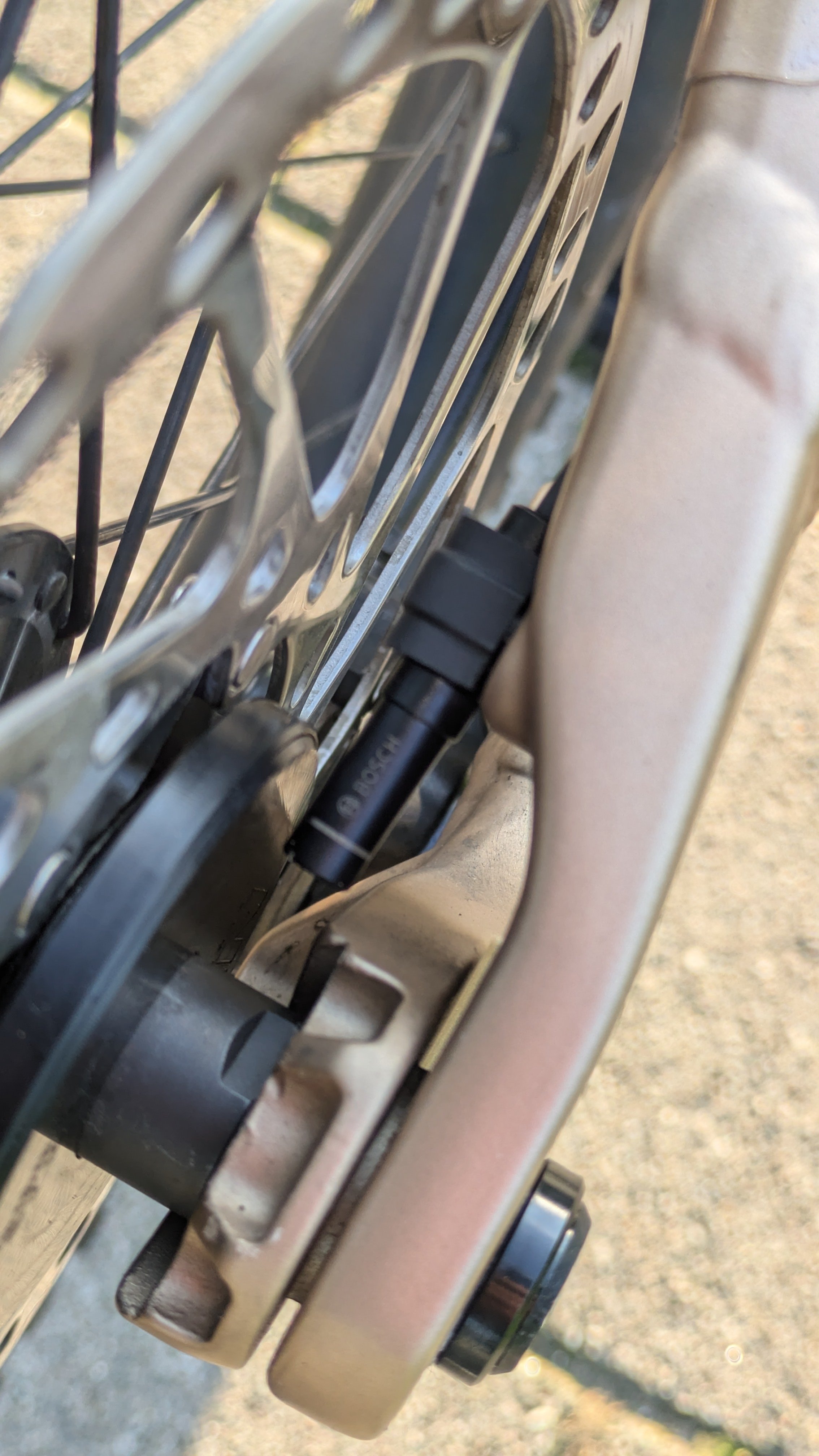

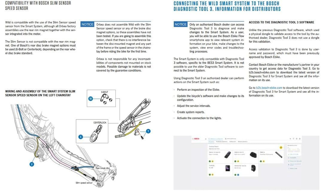

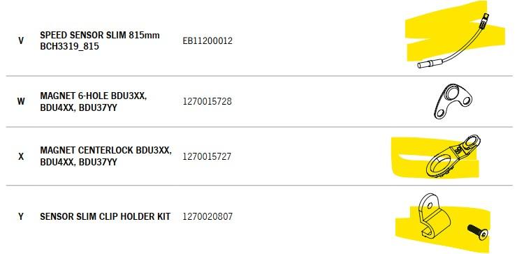

The hardware was easy to install, need to take the motor out for it (did it myself) After that Orbea change a setting at the dealer. I asume its the same for Alu or carbon, there is only one blue paper on Orbea's site. I have an Alu.
Attach some pics, part numbers and the final result (with the speedi mounted also)
Hope it helps ;-)
IMG_20240929_170101_285.jpg IMG_20240929_170110_029.jpg IMG_20240929_170105_536.jpg PXL_20240915_162733214.MP.jpg PXL_20240915_162524326.MP.jpg 20240905_100428.jpg

Hi Xsurfy
That's exactly what I needed to know. I bought the parts already, I just hope the carbon frame (my bike is arriving in a couple of days) has the same thread where I can screw the clip on it.
Appreciate all the pictures 👍

Hi Xsurfy

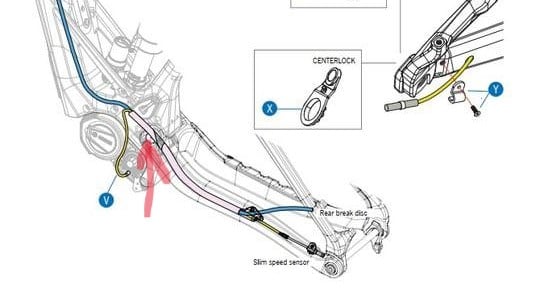

last thing: to run the speed sensor cable inside the chainstay did you have to remove the brake line and use it as runner? Of course this would require a bleeding at the end.

i did route the cable inside the chainstay, didin't have to remove the brake for it.
forgot to mention, you need to remove also the chainstay (single pivot bolt) to route the cable and fish it at the back where the sensor should be mount (best way for me). officially the cable goes inside that rubber, i choose to do it next to it. You will figure it out ;-)
