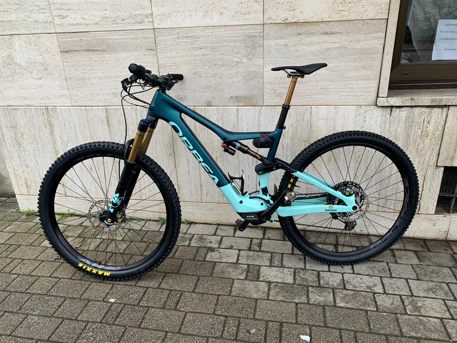

Hi! This is my Rise M20 size L from Italy. Only M20 frame... :) . Brake Magura MT7, bar Pro carbon, cassette XTR 10-51, shift XTR, chain XT, WCS grips, saddle SLR superflow boost , pedals Look Xtrak carbon, Fox 36 Factory, Fox DPx2 Factory, Fox Transfer Factory, screws wherever. I'm waiting wheelset CarbonCore with hubs DT350, rims 29 mm inner and 35 mm external ( and disc brake Magura 180+180 HC). Original weight 19kg, target weight 17.8 kg. Stefano.
