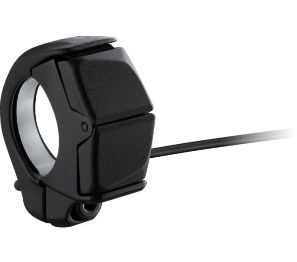

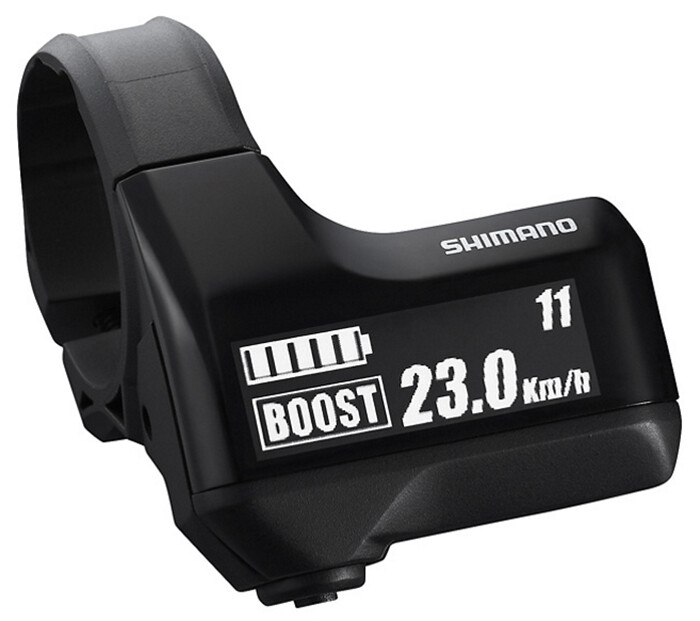

1) Mode or motor control wire unplugged/loose at the display or junction box. Unplug and re-connect.

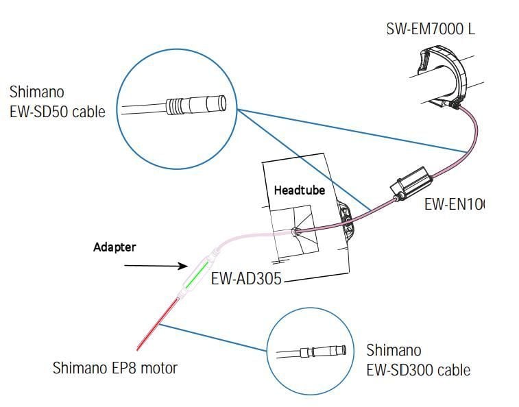

2) SD300 motor control wire or SD50 wire unplugged/pulled out of the EW-AD305 adapter, located in a foam pad and tucked inside the down tube where it meets the head tube. Must drop the fork to check connection. Unplug wires and reconnect.

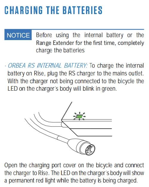

Battery Charging:
The charger for the Rise will blink green if the charger is not plugged in OR if the battery is fully charged. The charger will display a red light while charging.

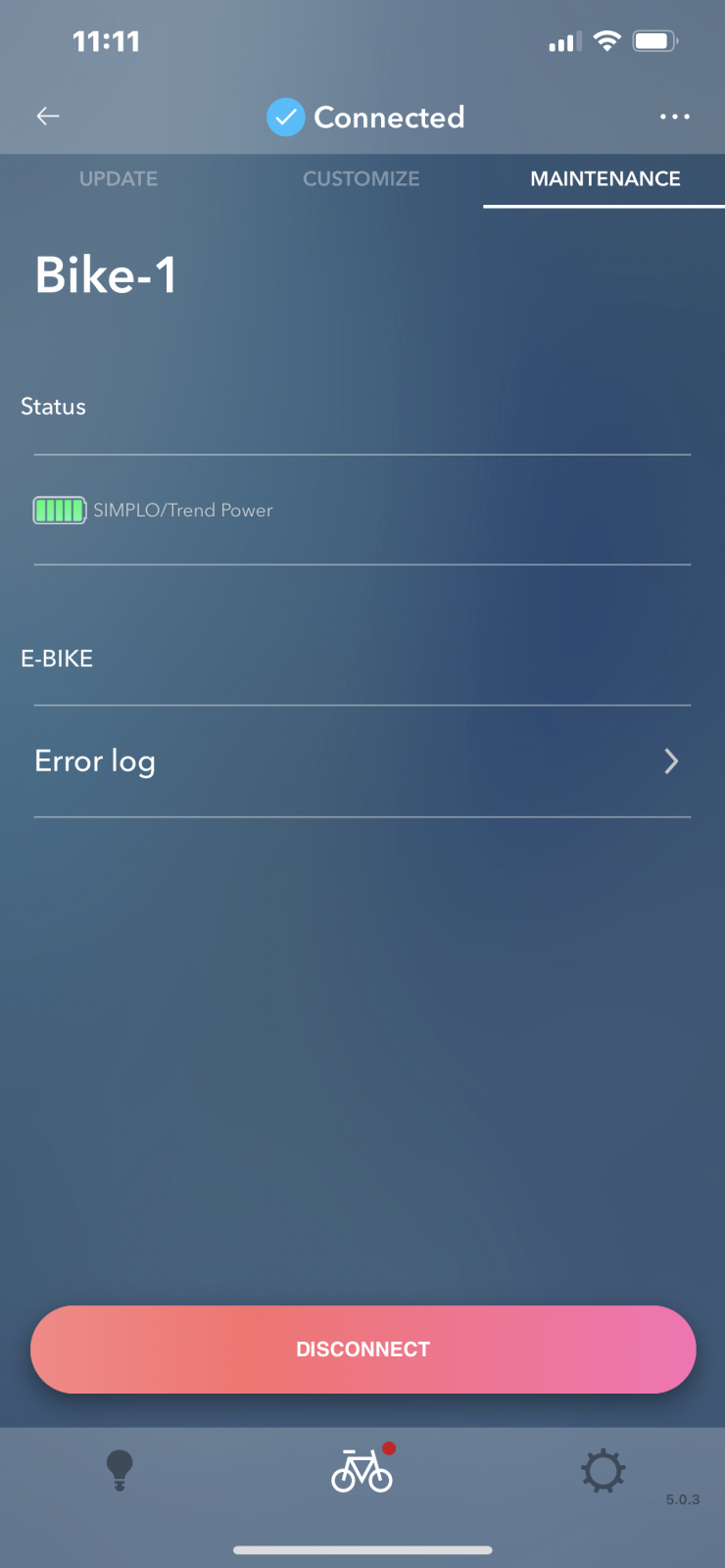

There can be multiple reasons why your bike is not powering up. As an example, the battery is fully charged however, if a wire has come unplugged, your bike will not power up. If you haven't done so, start the trouble shooting process by installing the Shimano eTube app on your phone.

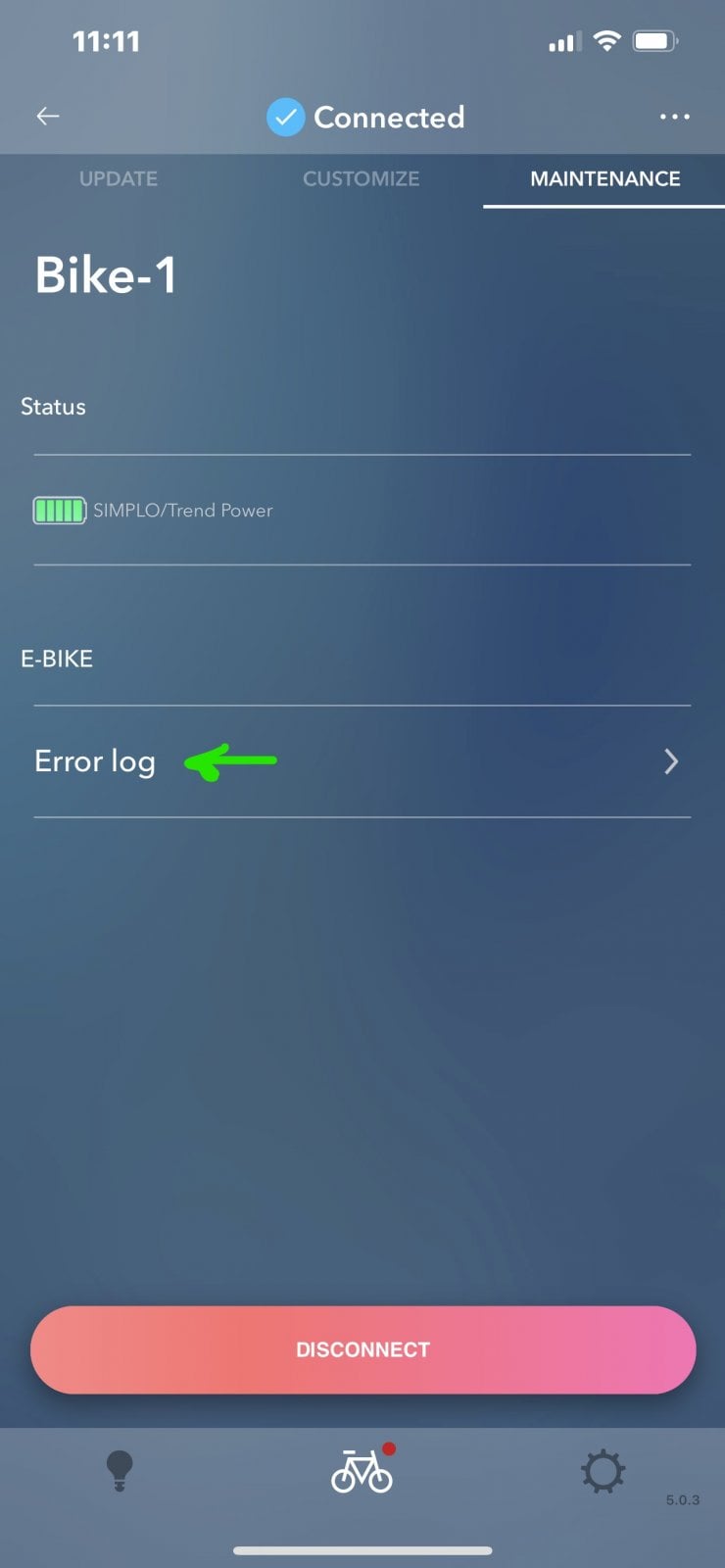

Once the app is installed, try connecting to your bike via Bluetooth. Check for battery level, updates, error codes, etc. I'm attaching several screen shots from my phone which show the eTube app, update section, battery level check and error code log.

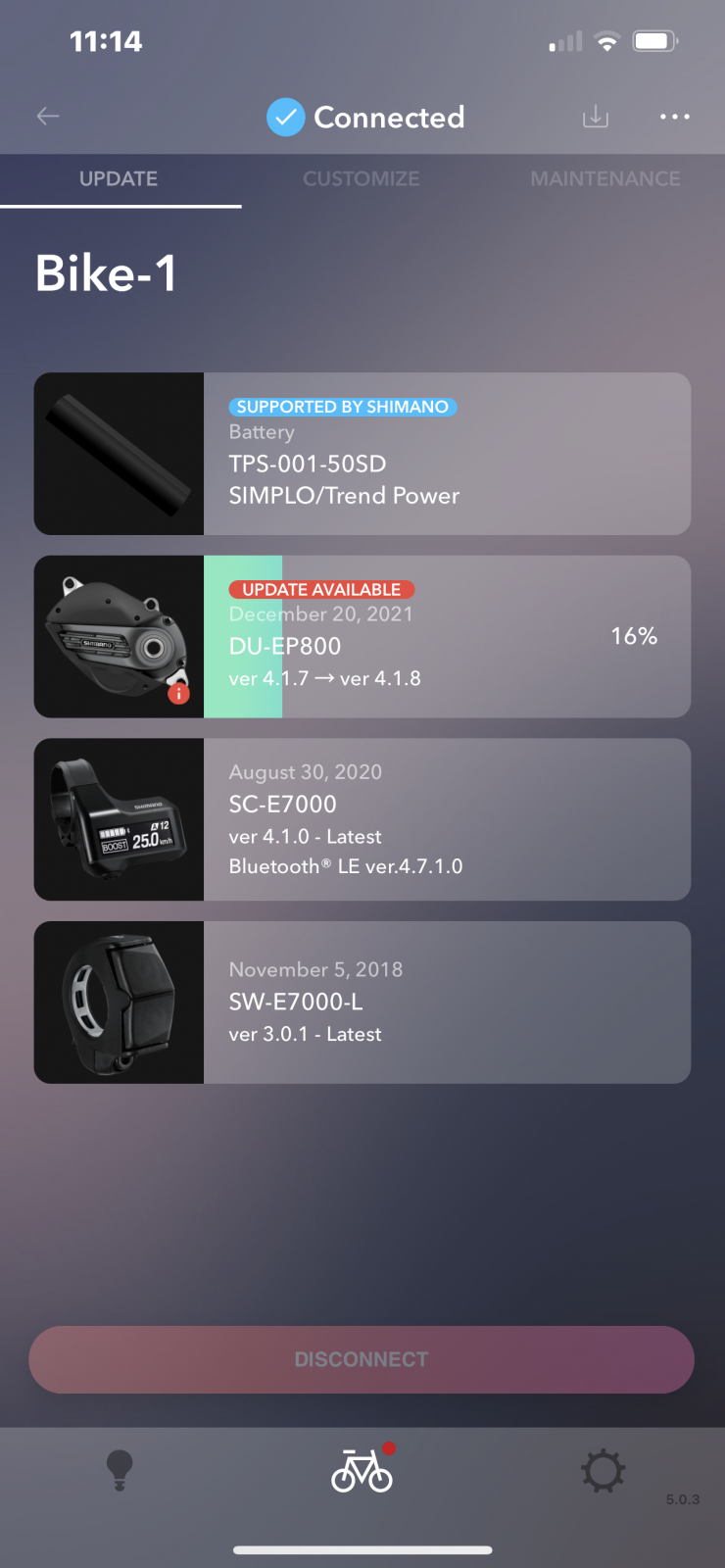

Picture # 1: eTube app home screen showing an update is available on my Rise.
Picture # 2: The maintenance section will display battery level.

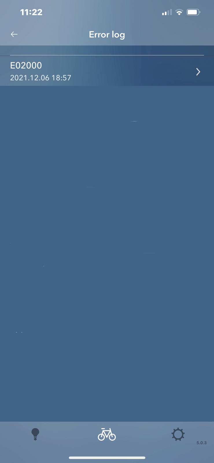

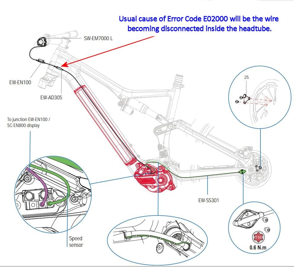

Picture # 3a: Open the "Maintenance" section and click on error log. If any errors have occurred on your Rise they will be displayed in the error log.
Picture # 3b: The error log on my Rise displays an "E02000" error code. Error code E02000 means "Communication error detected between battery and drive unit." It's a fancy way or saying something has come unplugged on my bike and it will not power up. Note: I'd installed a new dropper post and cable. During the installation process, the wire connector located inside the head tube became unplugged.
#1 #2 #3a #3b
If you are unable to connect to your bike via Bluetooth because your Rise is dead and won't connect, then you'll need to start checking physically connections on your bike. Start with the easy connections first.

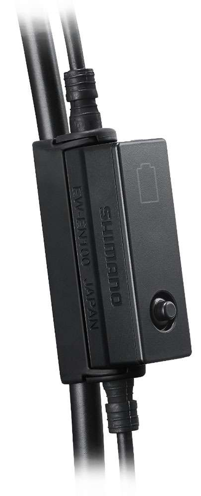

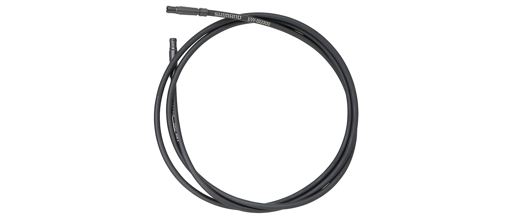

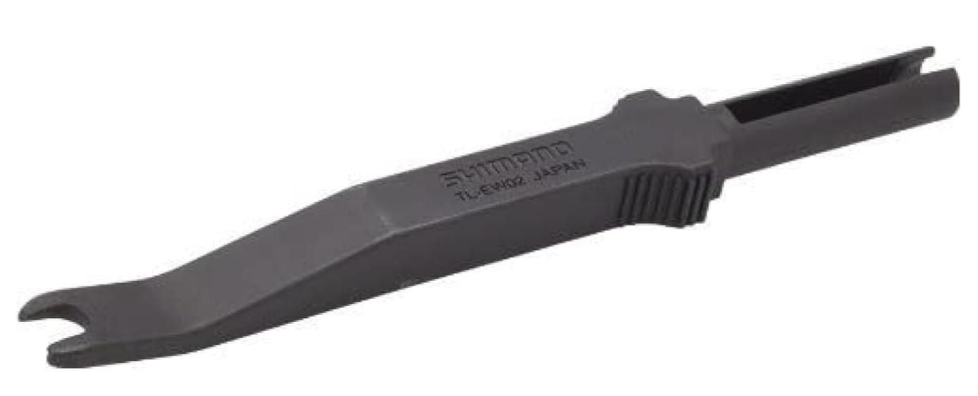

1. Check the two wires which plug into both sides of the black box at the front of your bike. Make sure they are both fully pressed into the black box connections. These can be easily unplugged while riding or moving the bike about.
2. If the two wires are fully connected and the bike doesn't power up, drop your fork tube and check the two wires which plug into both sides of the EW-AD305 adapter located inside the headtube. If the adapter connections are secure,

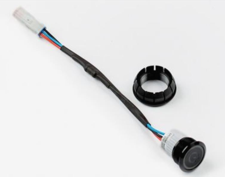

3. Check the on/off power button. The button is a press fit into it's housing and can be removed. Pull the button out of it's housing and check the plastic connector where it plugs into the wiring harness.
4. All connections other connections i.e. speed sensor, motor, battery, etc. require that you drop the motor to gain access to them. If you are not skilled mechanically, take the bike to your dealer and have them troubleshoot the connections and or error code. I'm attaching several drawings below which show various connections.

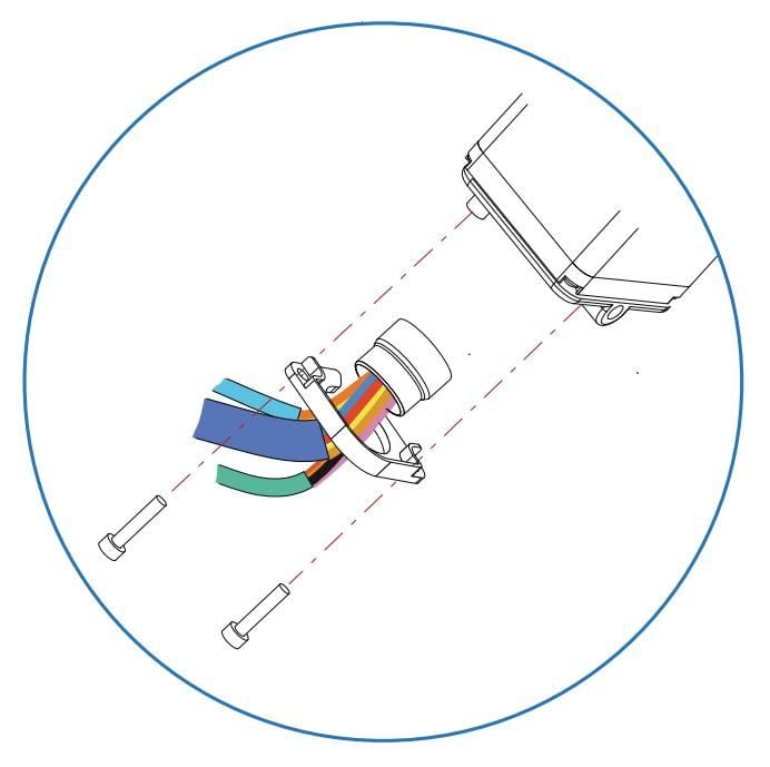

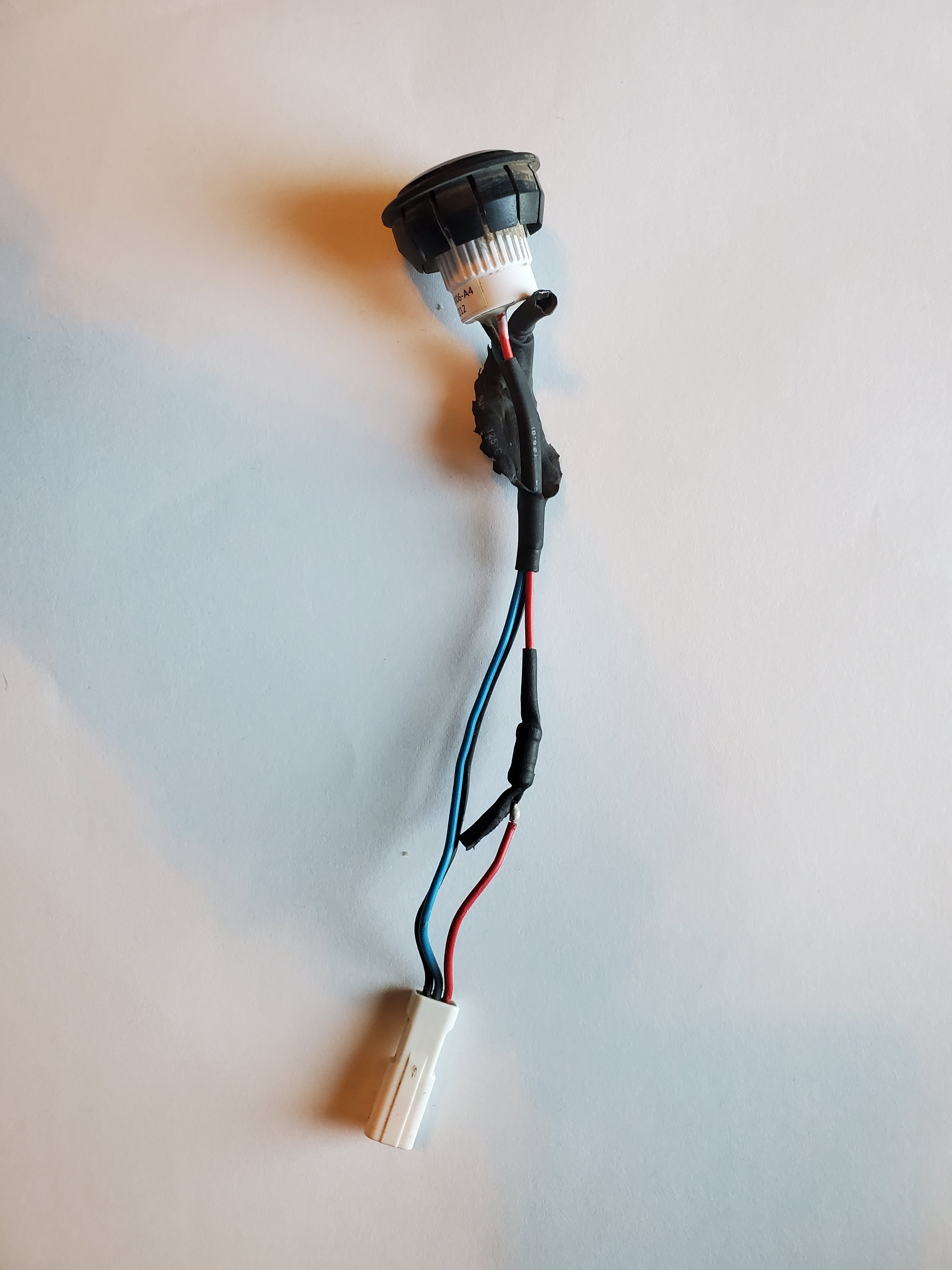

Hello everybody, I did some further reading on the Rise wiring charging system and found some additional wiring diagrams which I modified and attached for your review.
My thought is you may stumble upon this thread because you're experiencing a charging or connection problem with your Rise and may not have the resources to take your bike to a shop to get it fixed. The diagrams may help you diagnose and fix the problem yourself.
I've also attached at the end of this message my process for dropping the motor. If you have any questions, send me a message.

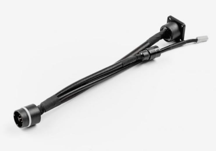

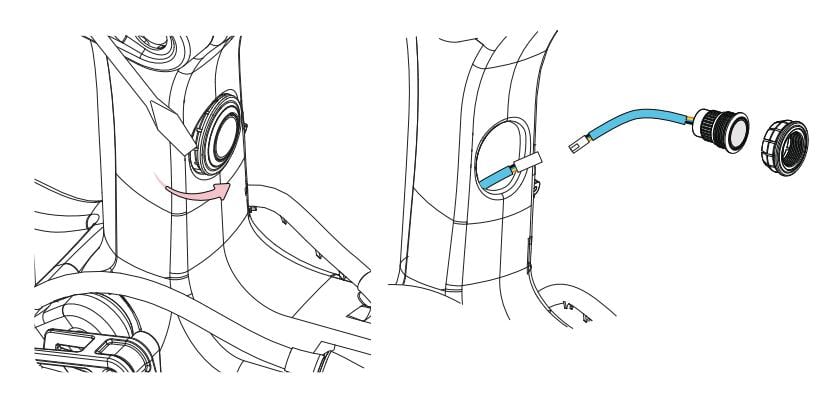

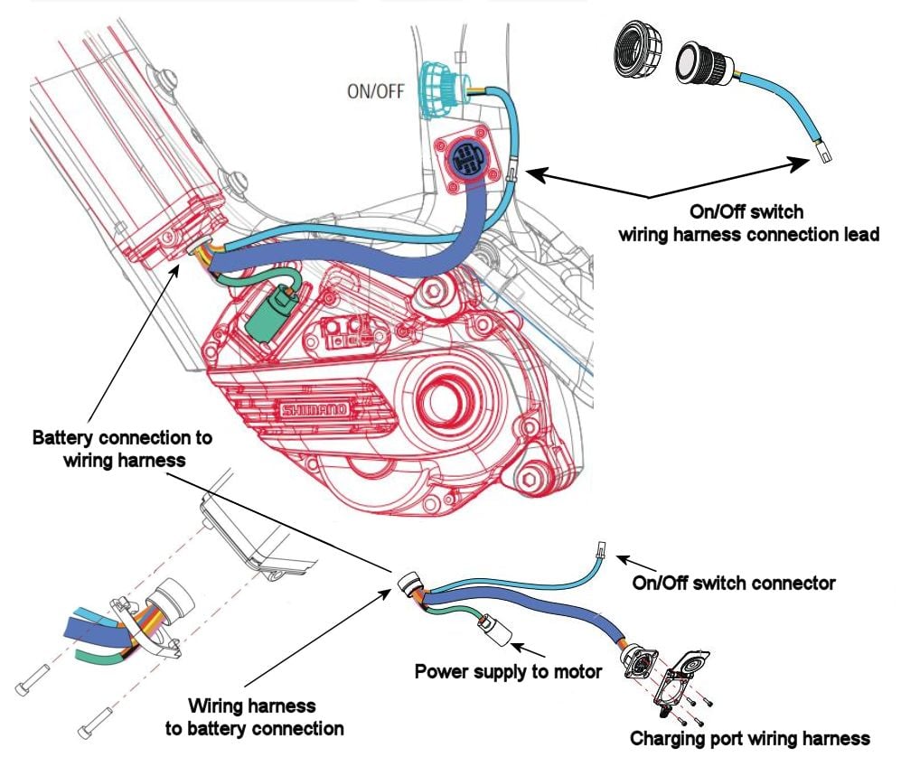

Here is a detailed blowup of the Rise charging port wiring and clamp connection to main battery:

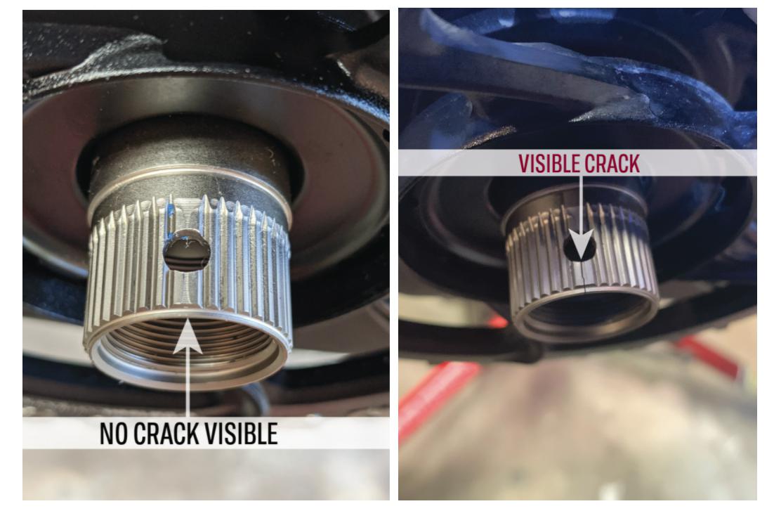

10) With a rag, clean the splined motor spindle. Now is the time to inspect the spindle for cracks. If you are not aware, there is a E13 tech bulletin on spindle cracks developing on some Shimano EP8 motors. Refer to the attached tech article.

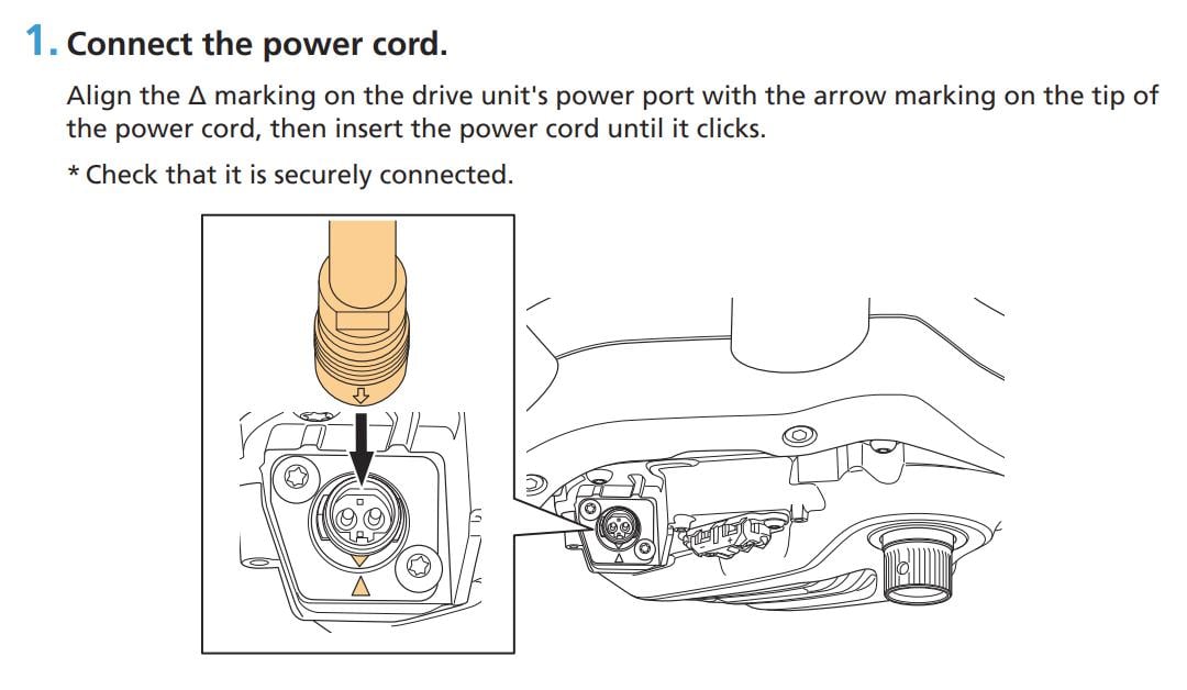

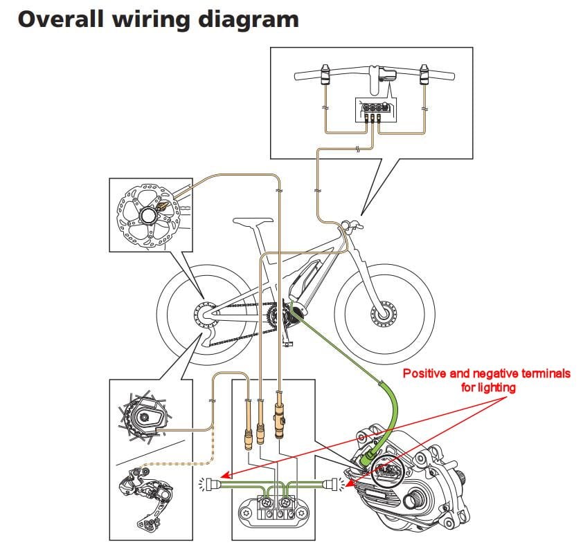

Hello, here is additional wiring diagrams obtained from Shimano's EP8 dealer manual. They identify what each connection port on the EP8 motor is. I hope you find these useful in fixing any electrical issues.
1) Shimano generic EP8 wiring diagram for an eBike.
Note: The screw terminals on the side of the EP8 motor are used for auxiliary power use, i.e. lighting. I have not used the auxiliary screw terminals on my Rise for any function, however I wonder if it might be possible to use the negative and positive terminals as a power feed for a GPS Theft Tracker mounted inside the Rise frame.
2) Main power connection port to the motor from the battery

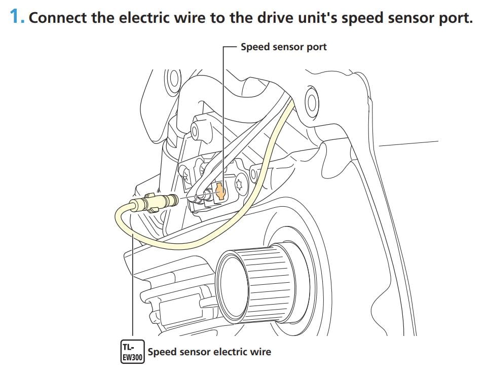

3) E-Tube port connections (EW-SD300 wire) from the various motor controls, i.e. Speed Sensor Switch, Mode Selector Switch, etc.

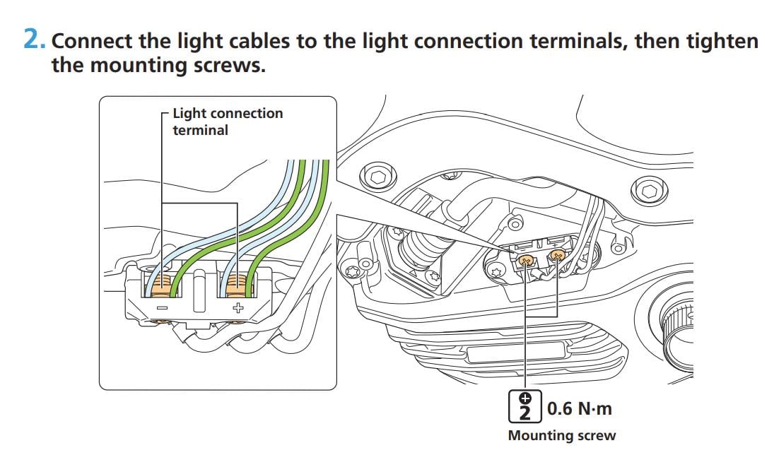

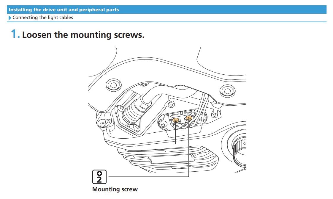

4) Auxiliary screw port positive and negative wiring connections. Typically used for bicycle lighting power supply.
5) Each manufacturer uses a different wiring system to power their eBikes. Here is the Orbea Rise wiring diagram. The on/off switch (Light Blue wiring) mounted on the lower seat tube controls the main power feed from the battery to the motor. The charge port wiring (Dark Blue) located on the non-drive side of the seat tube provides power to the Rise's battery banks located in the downtube. The main power feed (Green Wire) provides power from the battery to the motor.

Battery Charging:

The Orbea Rise Carbon and the Orbea Rise Hydro have two different charging systems with differing colored lights to signify charging status. The two charging system are not compatible. In other words, you must use the Rise Hydro charger to charge a Hydro model and a Rise Carbon charger to charge a Rise Carbon.
The Rise Carbon will show a red light when charging and switch to green when fully charged. If the Rise Carbon charger blinks red, then the charging system has detected a system fault, i.e. charging plug not fully connected or a loose wiring connection on the bike and it will not charge the bike.
The Rise Hydro charging system will show a blinking blue light when the charger is turned on but not plugged into the bike. Once the charger has been plugged into the charging port, the blue light will pulse by fading in and out as it charges the battery. When the frame battery or range extender has been fully charged, the blue light will become a solid blue light. If the Rise Hydro charger shows a solid red light, then the charging system has detected a system fault, i.e. charging plug not fully connected or a loose wiring connection on the bike and it will not charge the bike.
I've attached diagrams from the Rise Hydro Blue Paper which goes into detail regarding the charging process.
